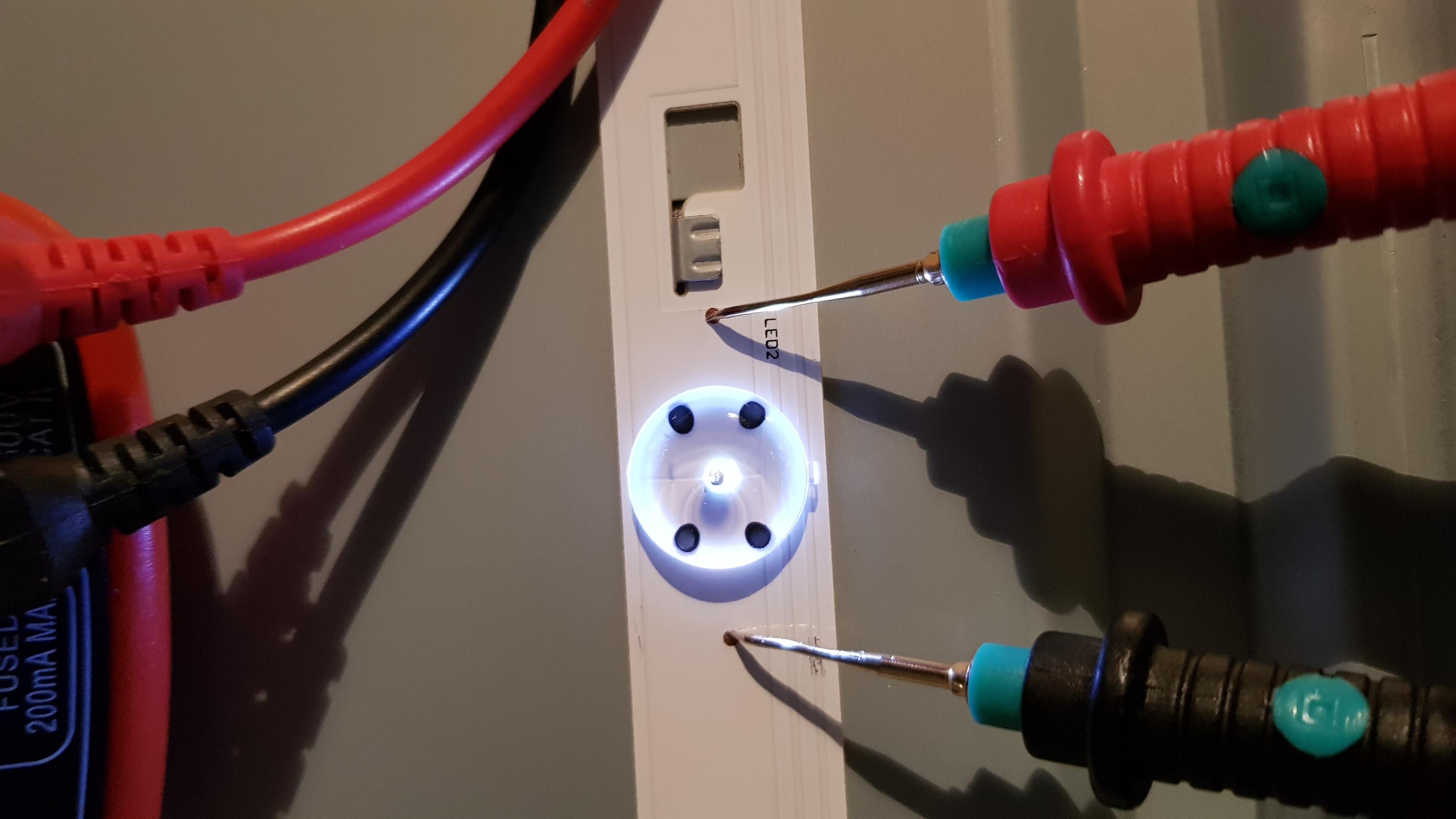

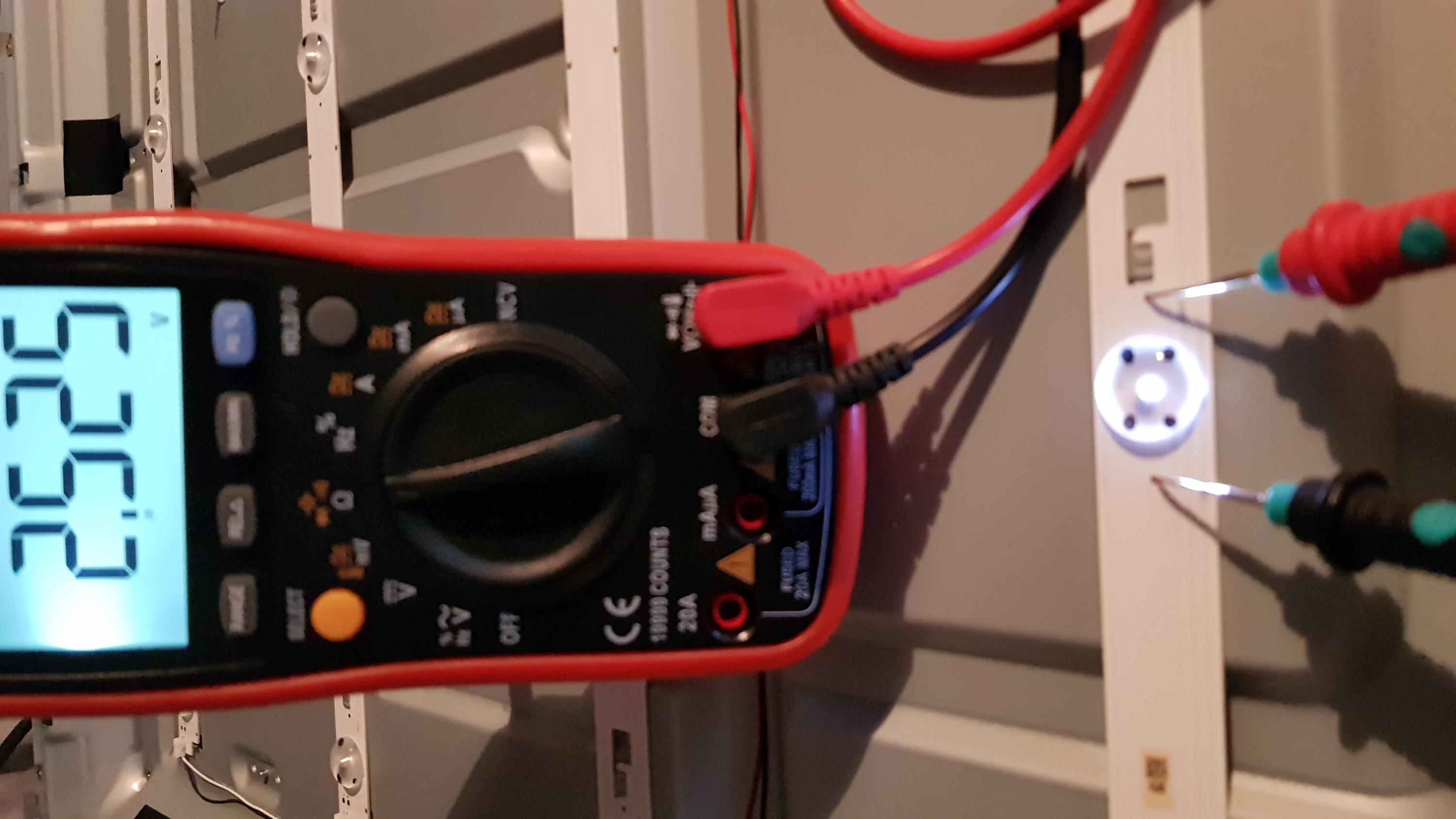

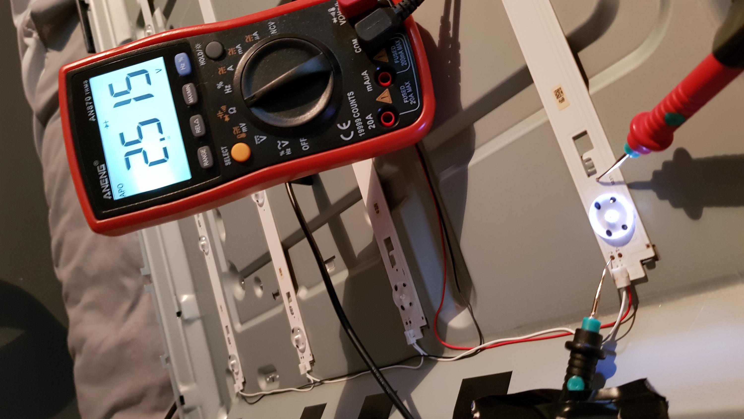

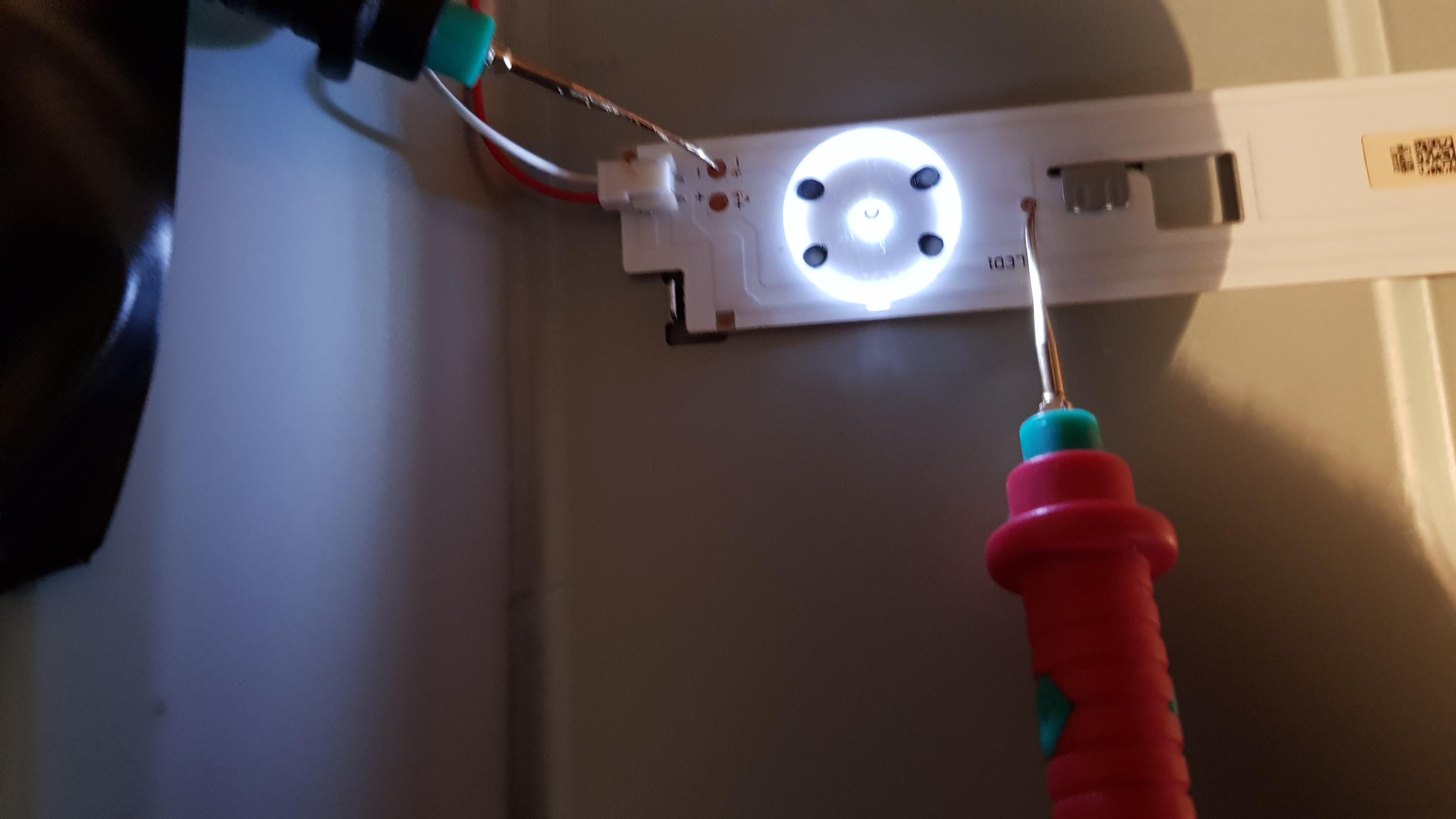

                          #52
                          Re: Sony KD49X8005C Assistance Required Please.
                          The first picture is with the Black probe on the negative rail and the Red probe on the first test point after the first LED.
                          With the meter on Diode mode, I get a reading of 2.515v.
                          This LED lights up.
                          When I reverse the leads, the meter shows OL
                          The 3rd picture shows testing the second and all other LED on this string.#
                          I place the Black lead on the test point before the LED and the Red probe on the test point after the LED.
                          The meter shows 2.525v
                          This LED lights up.
                          When I reverse the leads the meter shows OL.
                          All LEDs are about the same value.
                          I'm so sorry if I have misunderstood your instructions.
                          Share your knowledge with others,
                          And the gesture will be returned tenfold.

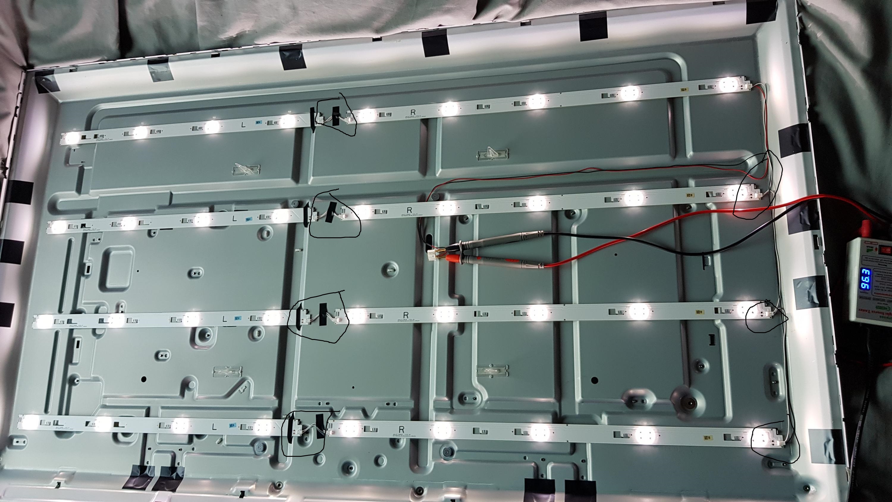

                                        All the wire connectors solder these direct
                                        either new wire or just snip the plugs off and solder
                                        i have circled them for you
                                          #60
