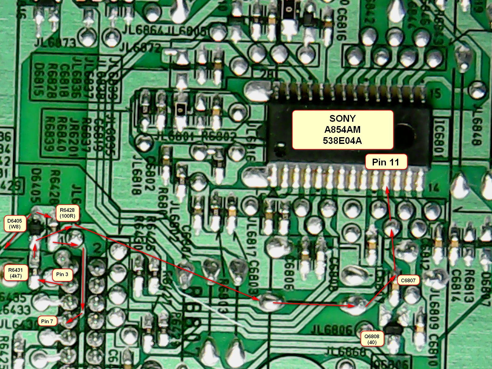

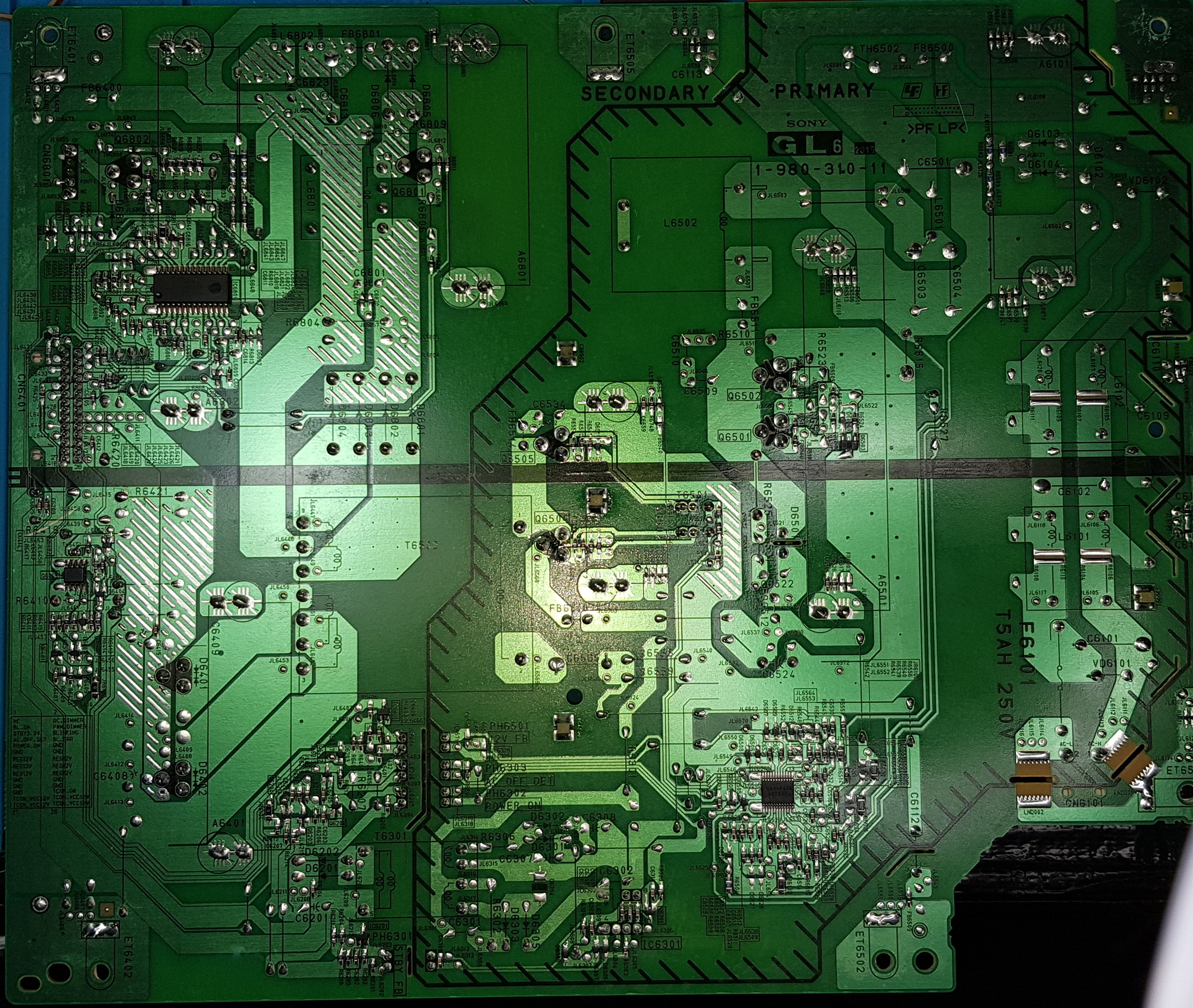

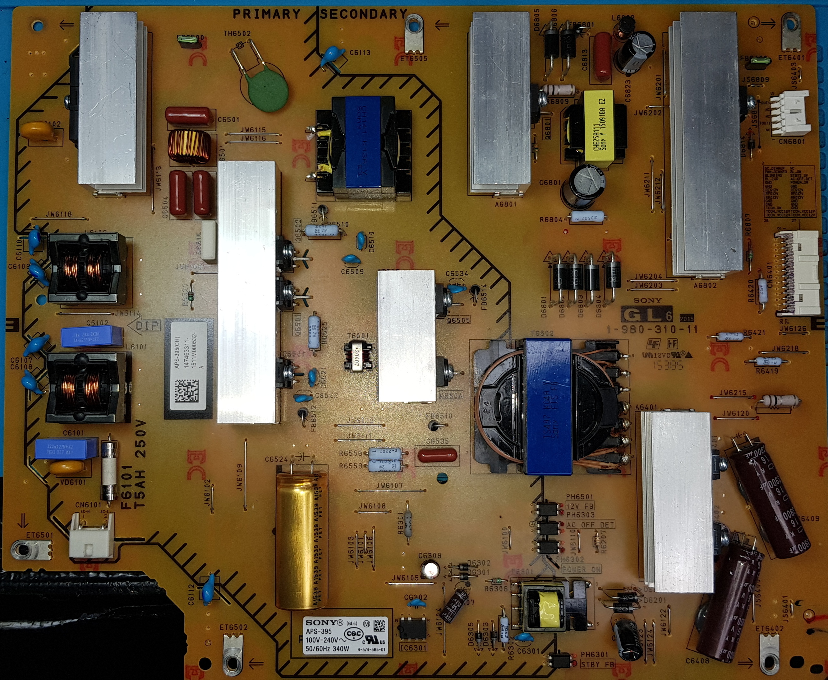

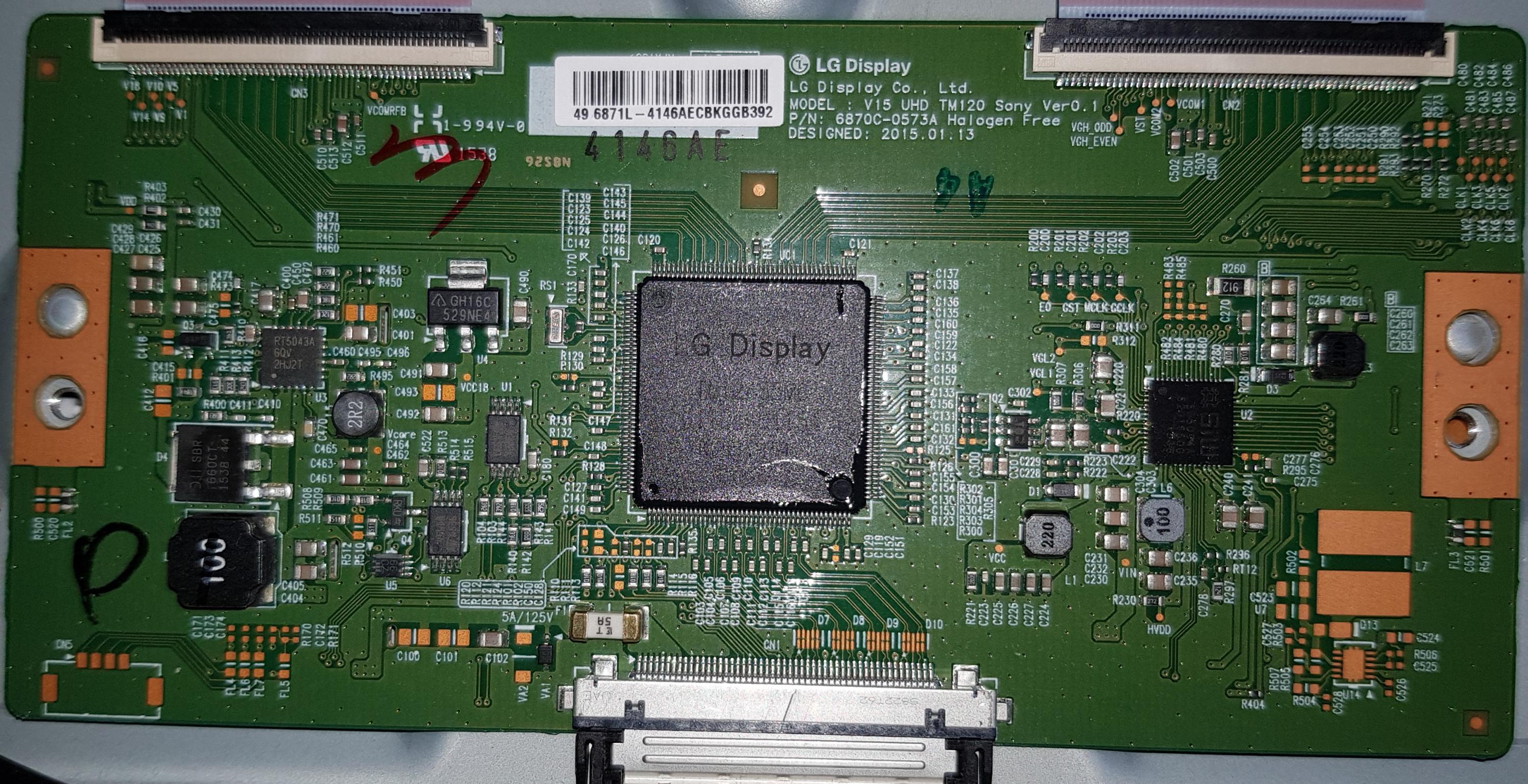

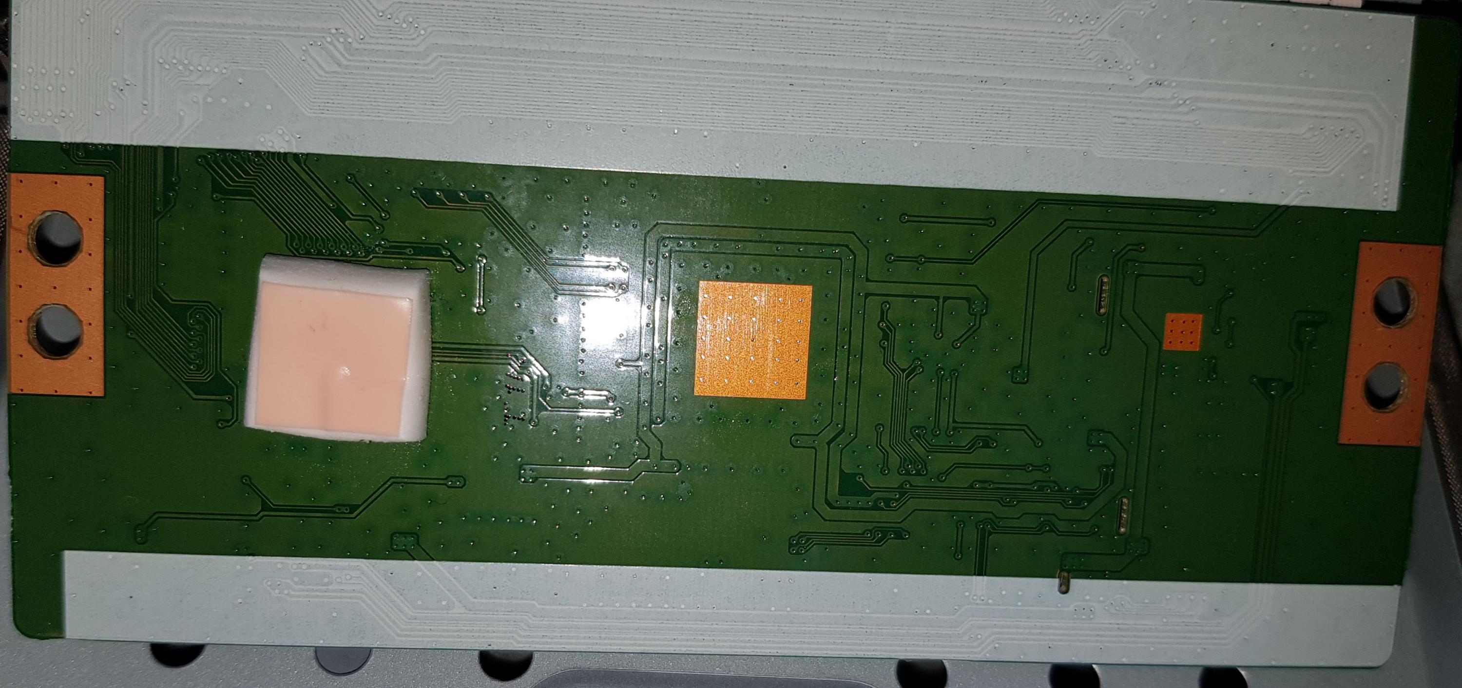

                3- BL-ON------------0.0v Pin 7. What is this pin 7 showing on the reading?
                7- AC-OFF-DET----3.49v pin 3. What is this pin 3 showing on the reading?
                Pin 3 and Pin 7 are connected together on the back side of the SMPS board via R6431(4k7), D6405, R6428(100Ω).

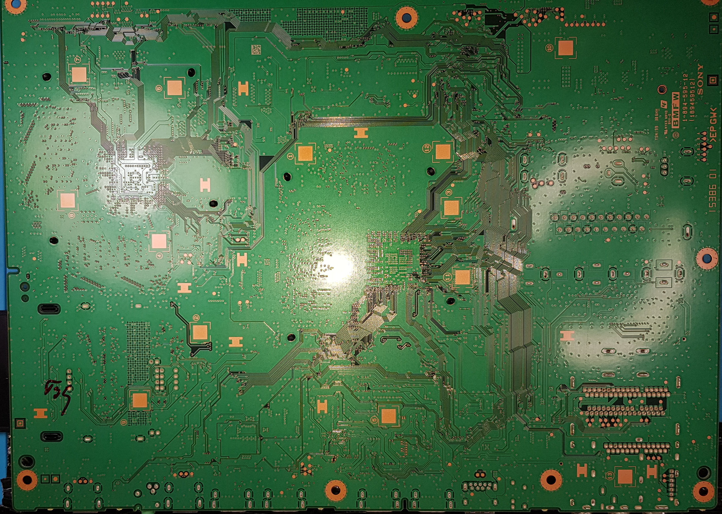

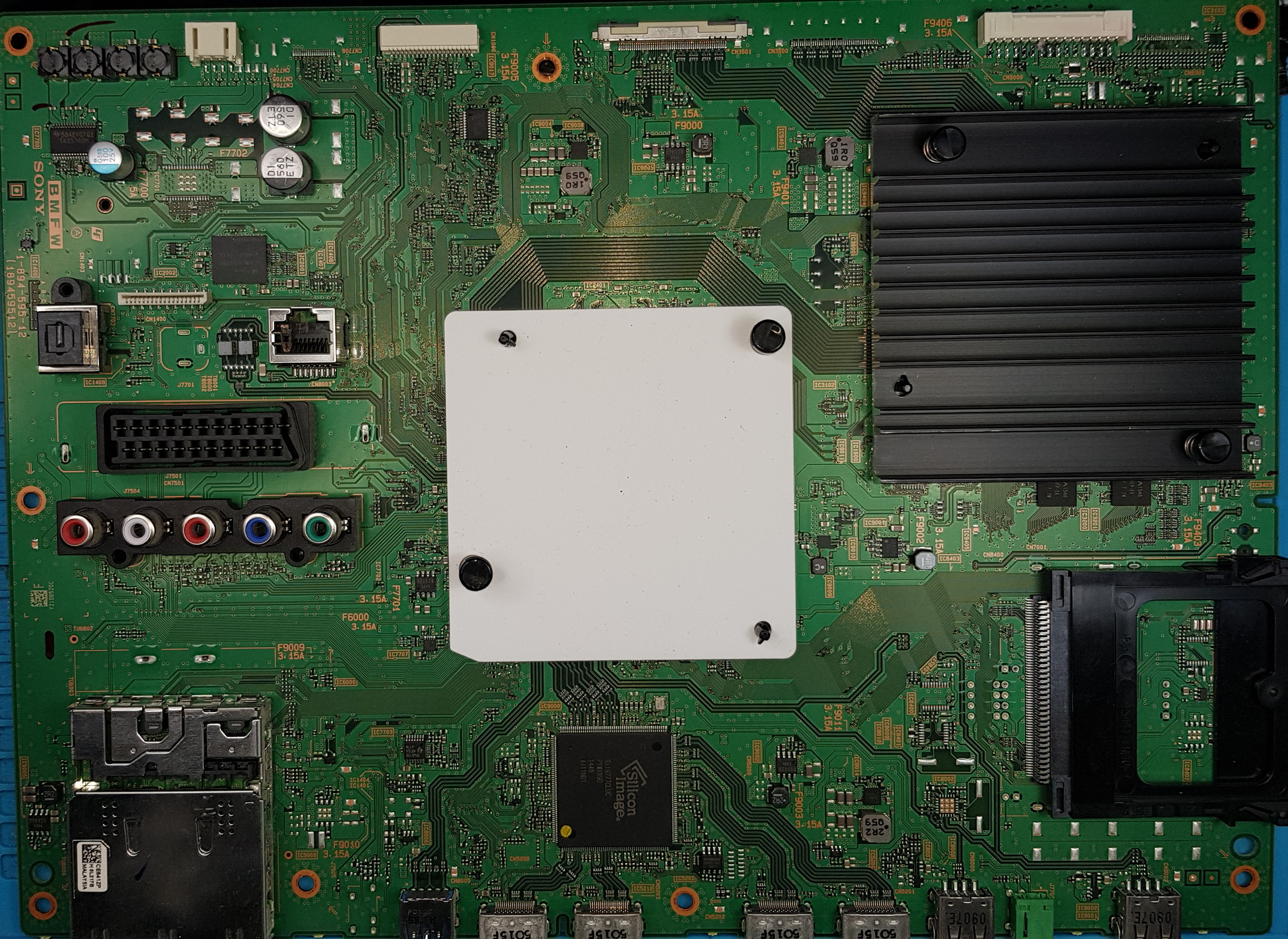

                Below are the pictures of both sides of the SMPS, MAIN and Tcon boards.
                It's quite hard to fit the full board into the shot and make all the text easily read, as some of the text is pretty small.
                If you need me to focus on any part of the board, I can zoom into that section to make it more legible.
                I have now checked the Tcon fuse F1 (5A 125v) OK
                How would I go about verifying if 3v is the normal or fault condition?
                I have searched the net for a schematic, but I'm unable to locate one for this model.

                          from here looks like bl_err is connected to ic 6801 thru a transistor, check for the part no, find out what that pin does?

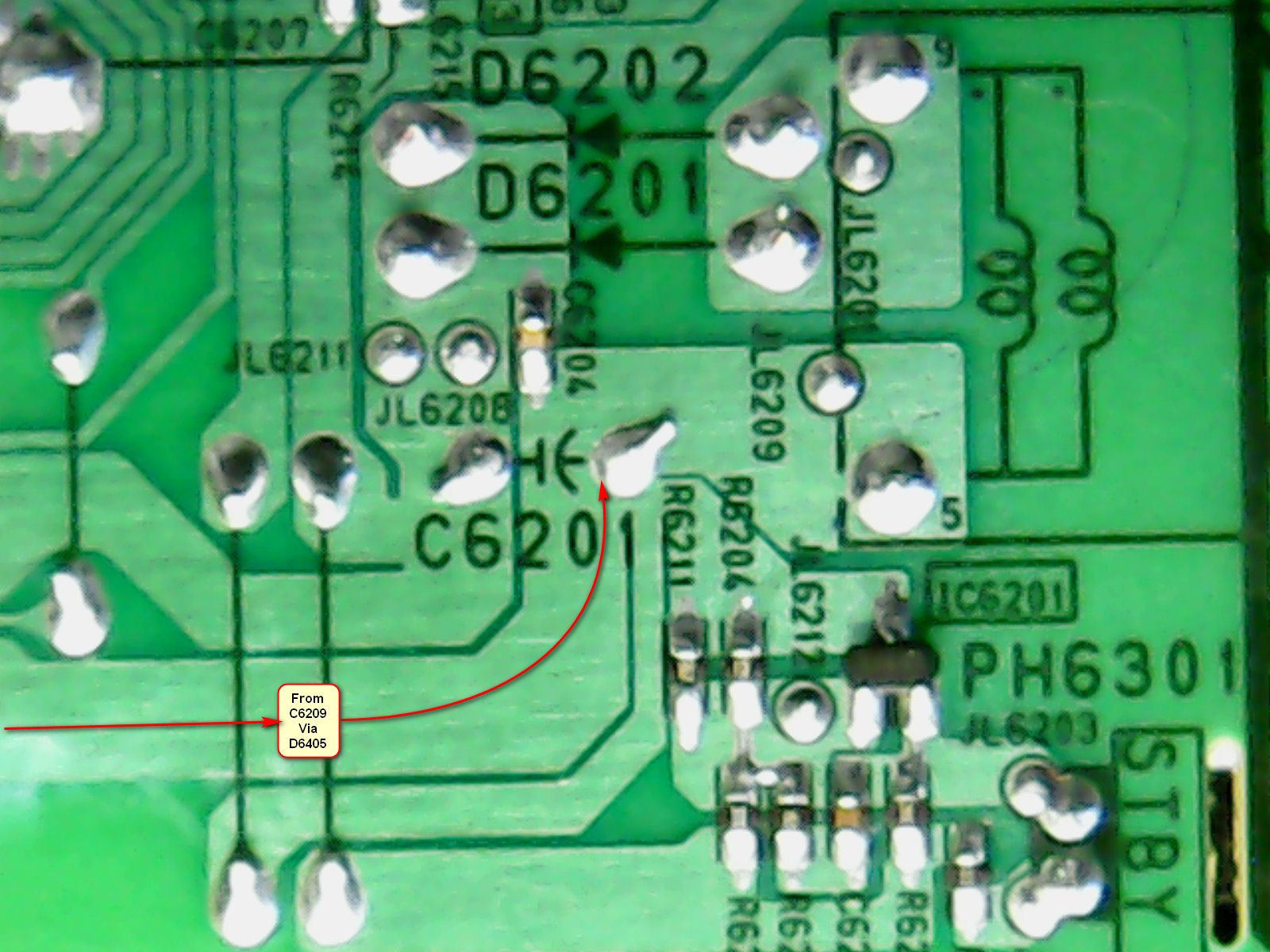

                              The Transistor from IC6801 has the marking (A4T5Q)
                              I have attached a couple of pictures showing where Pin 3 goes to.
                              I will test voltages again, with tv in standby mode, and after pressing the power button.
                              I will also report back with info of where BL_ERR (pin3) branches out to.
                              Regards Stevie.
