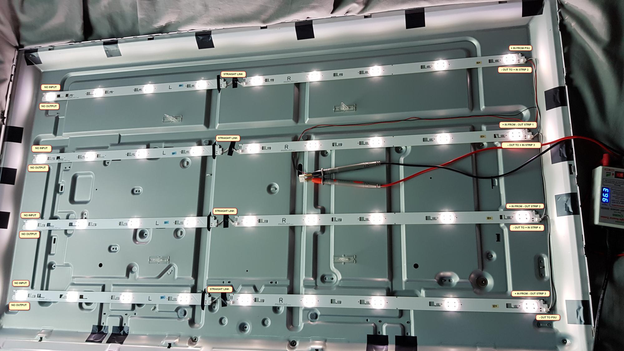

    Originally posted by Diah
    also at end it should be so as this photo
    This was how the original wiring was, and all LEDs were working when I connected my LED tester to the plug from the PSU.
    I still can't understand how some of the LEDs blew when they were all working fine.
    Share your knowledge with others,
    And the gesture will be returned tenfold.
    • Diah
      • Feb 2013
      • 6435
      #102
      Re: Sony KD49X8005C Assistance Required Please.
      here is the wrong you failed on.. i will draw it for you how your string are
      • Diah
        • Feb 2013
        • 6435
        #103
        little hard to draw,, but let me explain on your photo and comment you wrote
        take first string forexample
        on the right side you have + and - on the left side the end of the string extention of 4 led you wrote no input no out put.. actually the end of The last LED are - and it contact line on the string which go back to the first string as -
        look on it and put in mind the photo i posted before to be clear for you
          Yes I understand what you are saying, and also agree with your explanation, but there are no wires which can come from the ends of the LED strings. (the extensions).
          All plugs come from the wires on the right-hand side of the strings, and can only connect to one place as in the example of the picture I uploaded.
          It is like there are only 4 strings each with 9 LEDs on them.
            So the 4 strings are connected in a loop from + to - daisy chain loop.
            correct... then only your soldering IRON had current leak. so LED damaged or maybe cold contact at them. when you removed out the string they became open. you ordered strings, you can play now with them to find the reason. for example turn each one string alone and if there off try press the one are off.

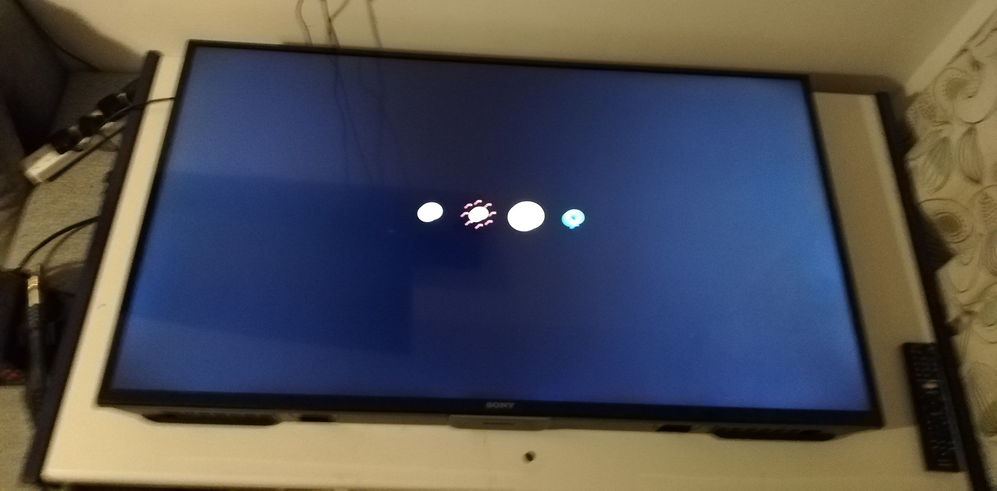

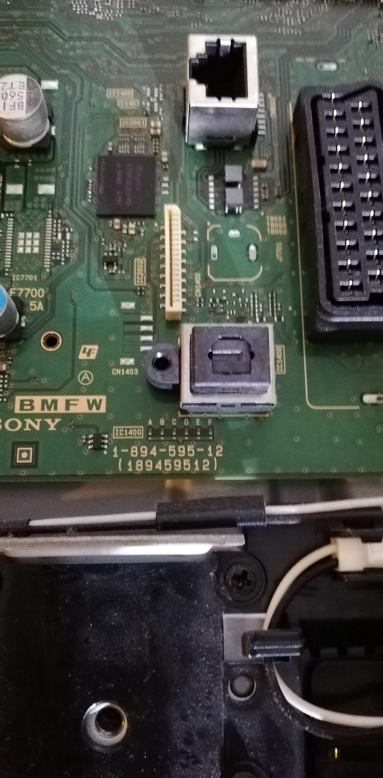

                    same for me - i have exact the same Symptoms on an KDL-65W855C.
                    Not the defect Leds - all LEDS are ok, all Voltages seem ok, but Poweroff/Restart About 10 s after turning on the BL, during the animated Android Balls.
                    Then after a few seconds starting again, White led on again, BL on, Android start .. and again.
                    Tried hard reset_ (Power & Vol-):
                    White LED -> after About 10 sec: green led -> still Pressing keys -> after 5 Seconds: Led off. same game, restarting.
                    Any Ideas ? Is it Bricked, and some Kind of watchdog restarting after 15-20 sec ?
                    Is there anywhere a Serial Console pin on the BMX to "see" Android boot Messages ?
                      this is wrong.. as soon after the led change from white to green you need to release power&volume -
                      try one more time till the set remain on even the screen black..when you reach the point it remain on... play firmware.
                      UART to trace boot... you can try at many places.. you need only one pin from yours TTL to GND and the RX of it try it on many point such USB or VGA socket. TTL TX you don't need right now just track the TX of the set with TTL RX

                        #111
                        Hi Diah,
                        yes thats what i did ..
                        Still no success.
                        The only difference, when i press Power/Vol- is, the white Led is getting green without a picture on the screen.
                        If I dont Press any keys:
                        Plug to power, 5 secs later white led, 5 secs later Screen comes with android balls, animation begins, 10 secs later (the yellow dot gets oval..) -> Power off, restart.
                        With pressed keys: same timing .. led goes to green (without screen on), some seconds later puff, restart.
                        Will try to find a TX signal now ...
