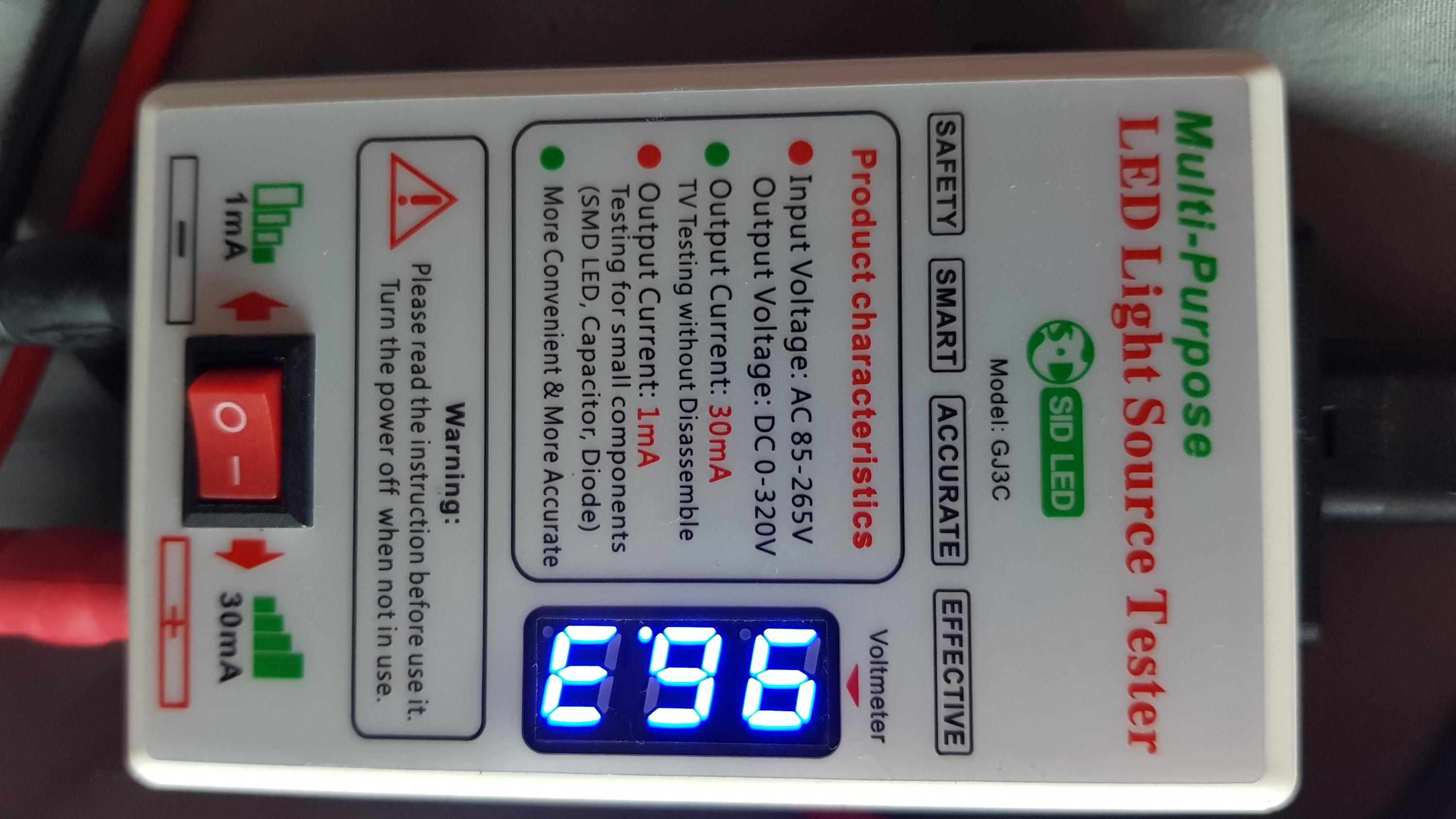

    in this 15 second was the screen blank and no BL as budwich write LED tester not enough. we have here bricked Android Sony TV, there are Hard Brick and soft Brick MB.
    TAKE THE Panel apart and check your LED BL.... if they are fine as yours statement before then you have Hard Brick.MB need reprogramming
        I will strip it back to the led strips and test properly, and report back. Thanks

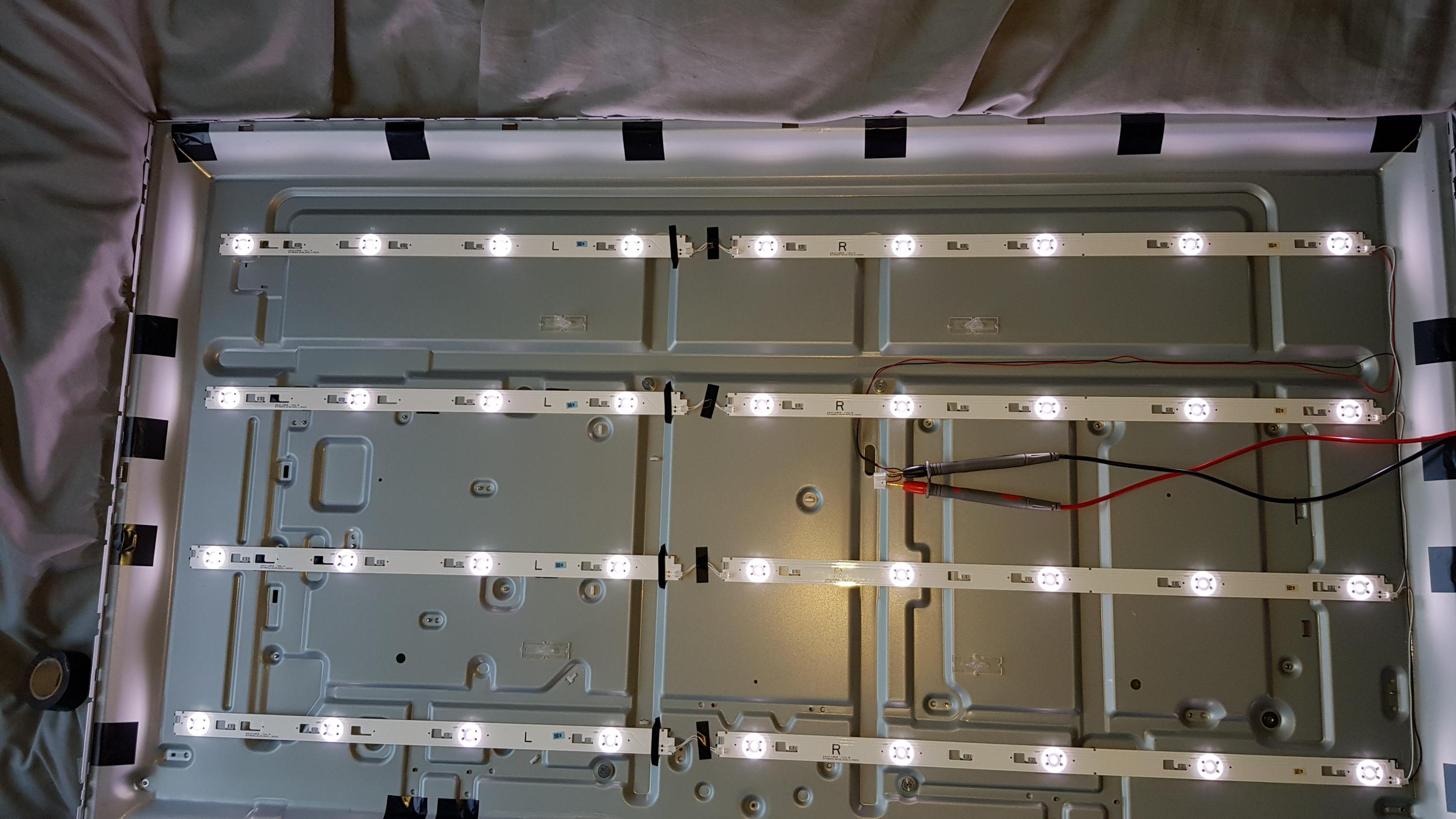

          Re: Sony KD49X8005C Assistance Required Please.
          Checked the BL and all light up as expected.

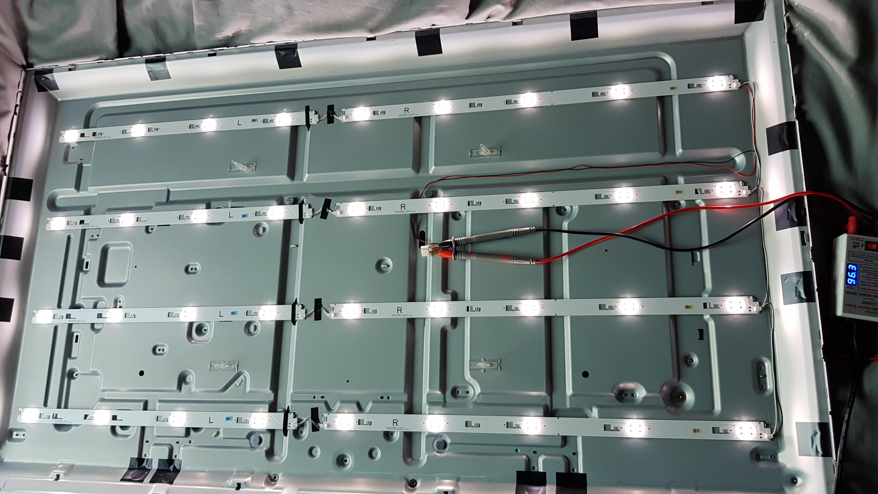

                                I have just checked to see if the BL flash when first powered on.
                                Only the top row of LEDs flashed at power up.
                                  BINGO this is the error ... you have shorted LED diode
                                      put your volt on meter on the LED socket and read the up and down when you power the tv on

                                        be aware always. LED testing with just they turn on not enough. as each led had build in diode opposite to the LED light to limited the current. so led turn on but the diode shorted or some time open too
                                          I Test the LED+ from the socket with plug disconnected, at power up 93.44v
                                          And LED- 0.23v
                                          I'm not sure I have taken the correct measurements you wanted.
