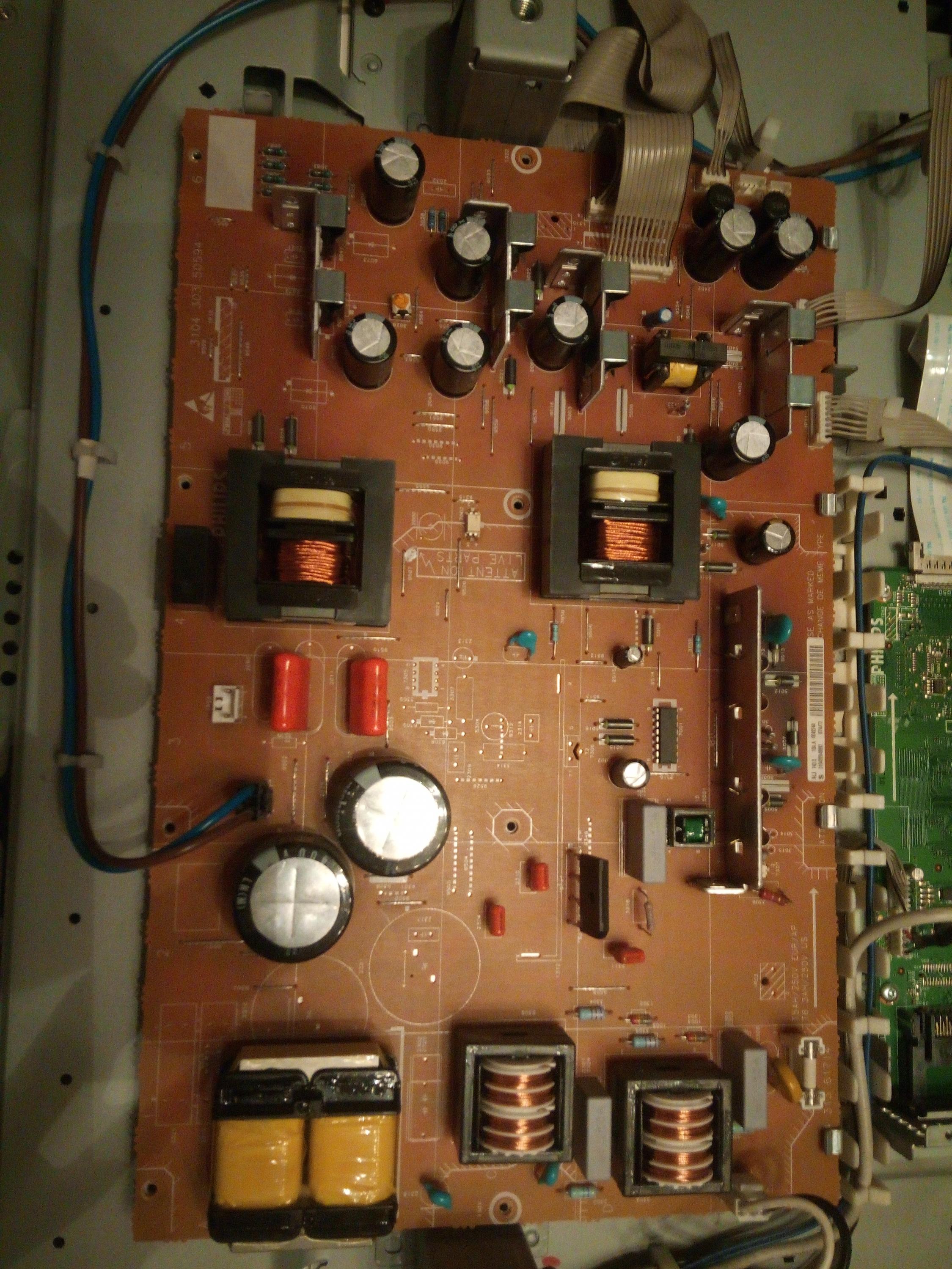

    Re: Philips 42PFL9732D slow startup
    That dark area is just due to heat over the yeras that discolored the board, give some pictures of the complete board, Also have you checked any voltages? they could be labled near the connectors.
    It is likely a weak cap and could be one of the small ones that will look ok but bust be checked with a esr meter.
    Start by removing the board and check for poor solder connetcions on the board, especially where the heat is around those transistors, also check any connections to the transformers and parts mounted to heatsinks

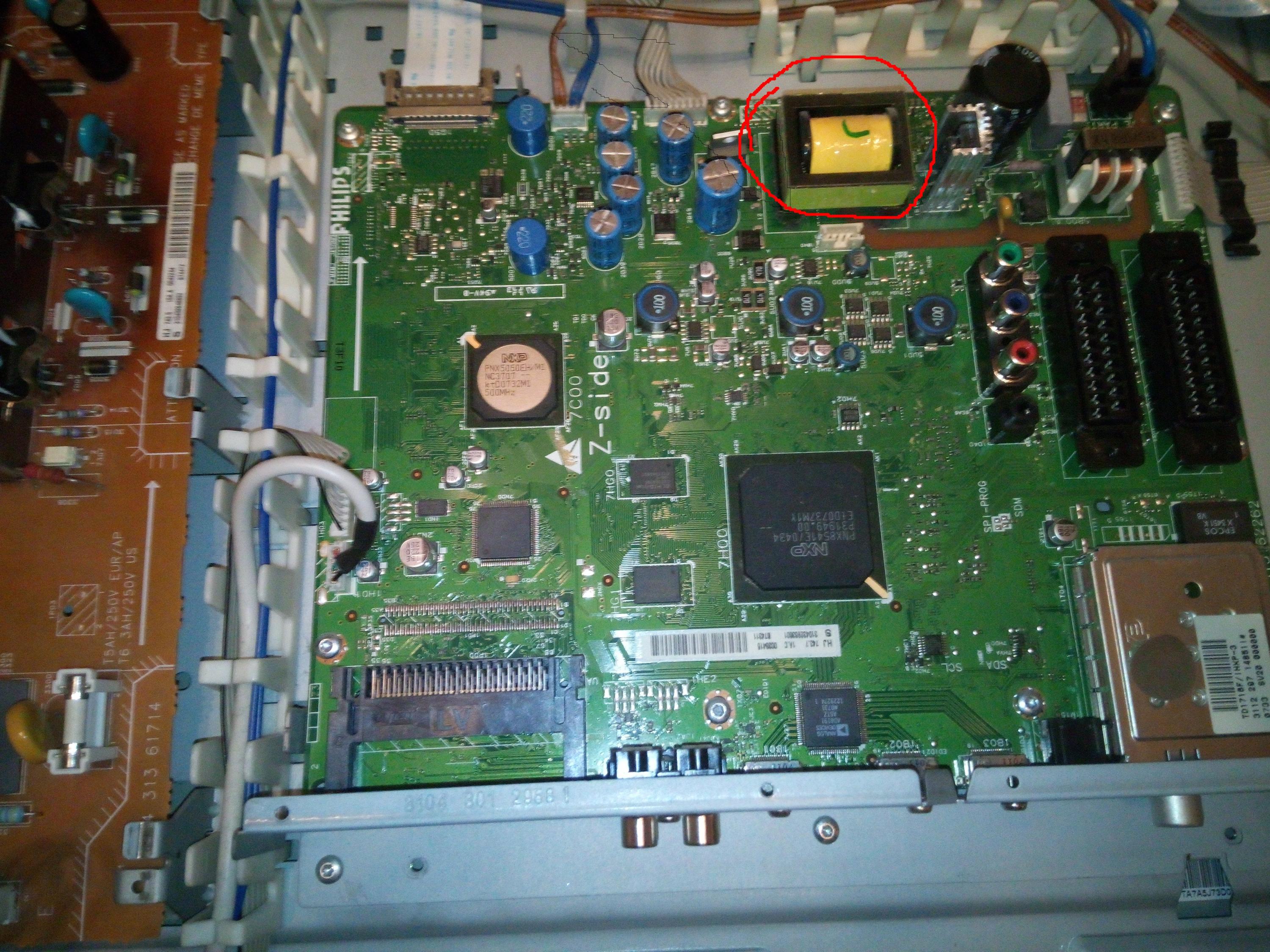

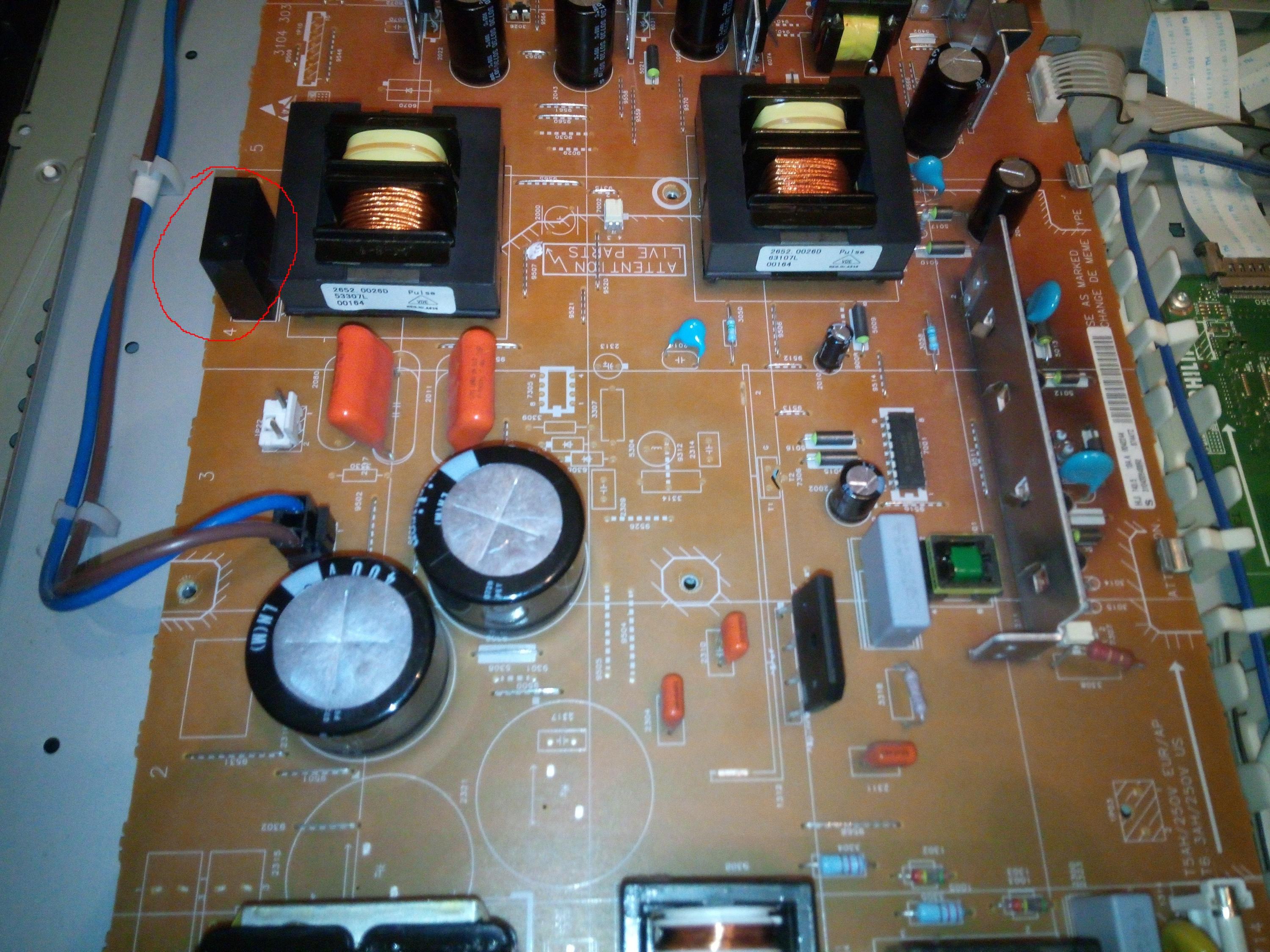

            Circled the relay that's clicking when TV is trying to start.
            Found a PDF with some diagrams etc.
            https://mega.nz/#!bRFhzIZZ!7S2X77zwl...4mw_FoDsimmNyc (too big to upload) Diagrams from pg. 58
            Could it be the relay that is going bad, or some other component?
            Tried to touch up some solder joints etc too, but no change.
            The solder pads is breaking off super easy, but easy to follow the traces with a flashlight from the back side.
            Remember I had a technician here many years ago replacing the inverter boards under warranty. Opend and looked at the slave one that's easy to get to and caps looked fine etc, Rev 1.3 board.

              Do you have a stable +5V2 standby voltage? Looks like the standby supply is on the main board

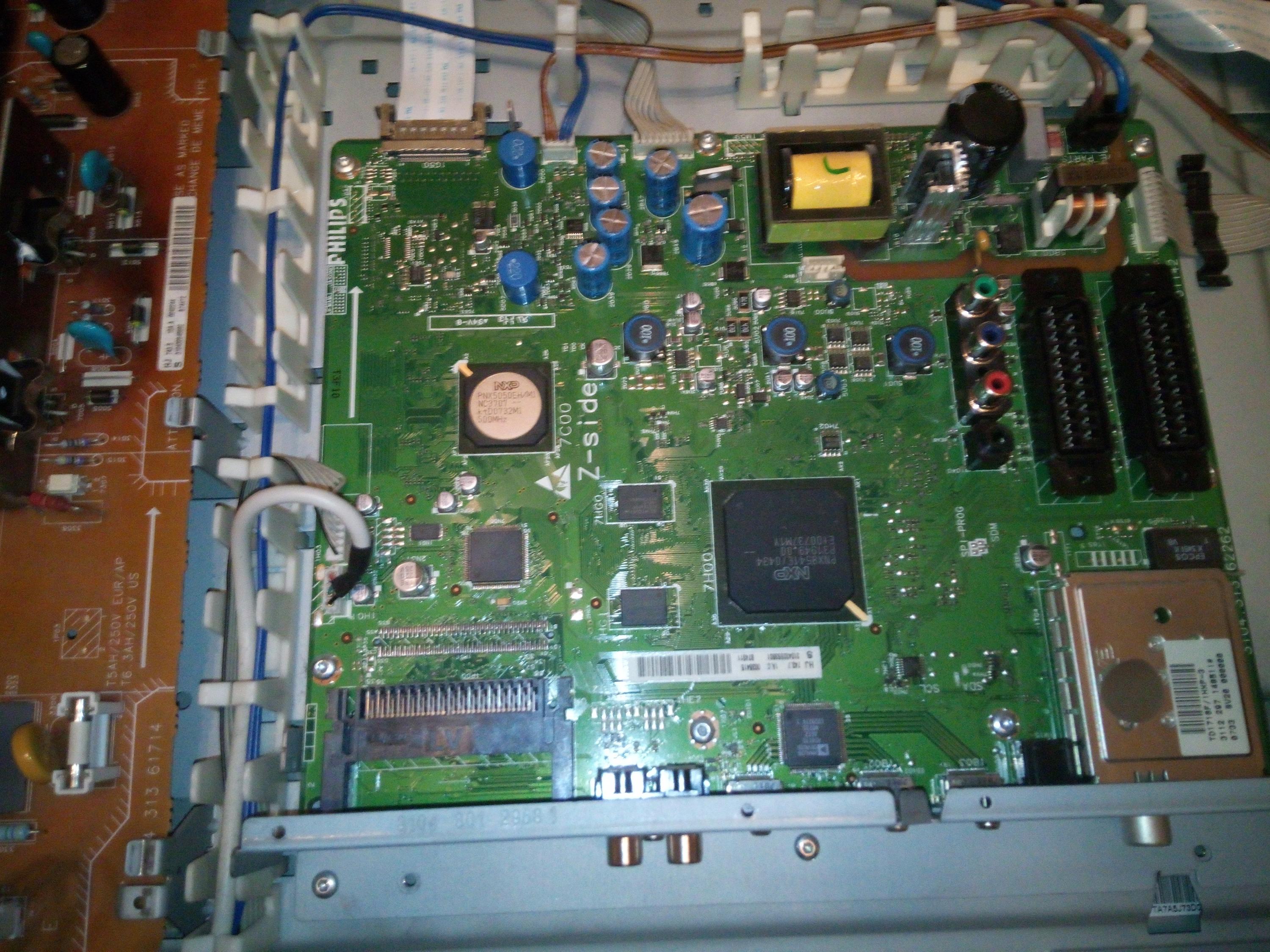

                  Tried some more, and got some error code blinking. 5 long red and 3 short.
                  That mans: PNX 8535 doesn't boot (SW cause) from the manual.
                  Could it be that the problem is on the other main board?
                  7 lelon caps on the board. The big one is maybe a little suspect, can feel a tiny bit of bulging. I have ordered replacement 450v 68uf.

                      The voltage I have tested on the power board looks good, error code seems to link to the PNX8535 on the other board. So why not?
                      After pushing a bit on the top of the 450v cap I am even more sure I feel a bulge. It seems the board gets AC from the power board via 1P02 as far as I understand.

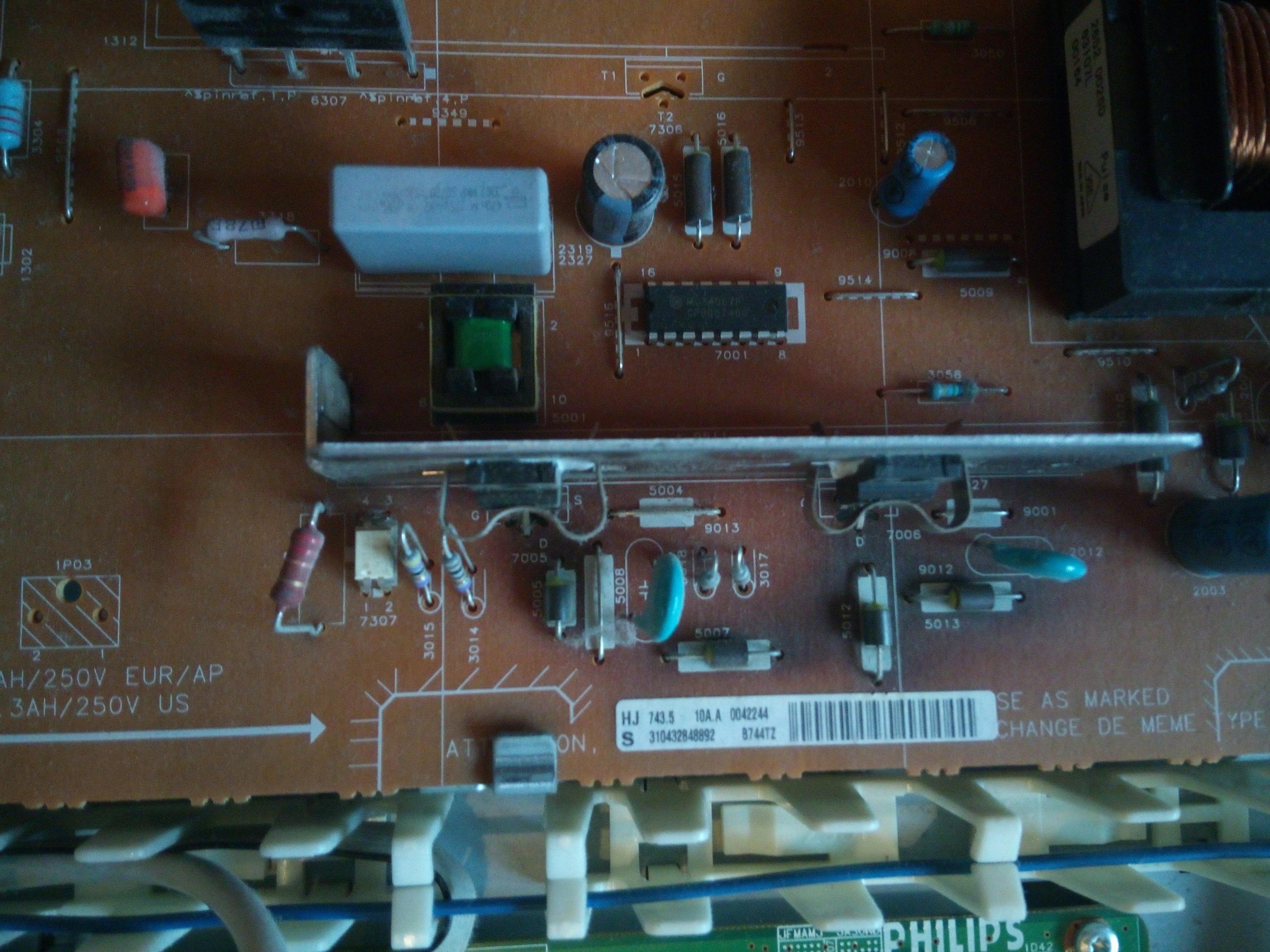

                        Noticed that the transformer circled is making noise. After the relay clicks on and off the sound goes up and down, else is a constant buzz.
                        What should I do next? ..
