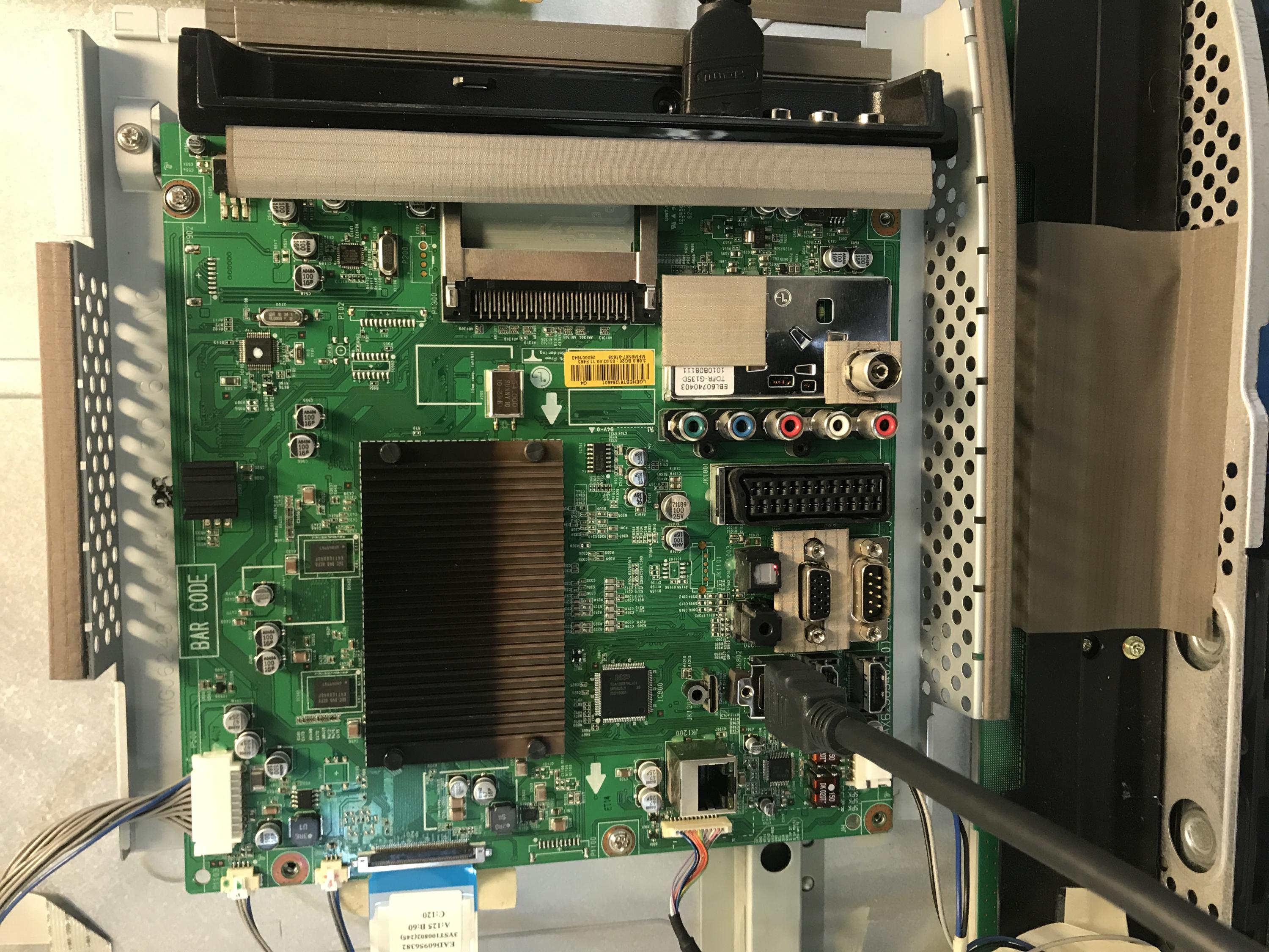

    Got this GIANT and HEAVY old plasma TV - No USB, and no HDMI.
    USB fixed, a SMD ferrite, and changed IC800 HDMI Switch TDA19997 - after this, the TV can "see" HDMI when I plug sources, but when selected it just says "Connecting" and after a few seconds "no signal" - this is true on all inputs.
    ( I am almost certain that no detection took place before changing IC800 )
    Checked 1V8 and 3V3 for HDMI chip, is OK.
    Cannot go into service mode, since this requires a special remote ( I can buy if it helps )
    Any suggestions from the clever people here ?

        Now got service remote - and can enter service menu, but not much to do.
        Found the correct software, but it is the same version as already on the set, I am not allowed to re-write.
        Can see signals go in to the HDMI switch, and out - so I guess I probably faces a main processor failure.
        Unless someone has a reall good idea....

            Well - I took the chance - and it worked
            Procedure :
            Removed heatsink
            Mainboard placed on toaster, driven by my vario, slow heating until thermometer said approx. 80C
            Put a lot of flux on the edges and let it boil ( Chipquick )
            Used hot air gun ( SUNKKO 850 ) on the chip, carefully until flux started to boil heavily and smoke
            Let it cool, tested - works
