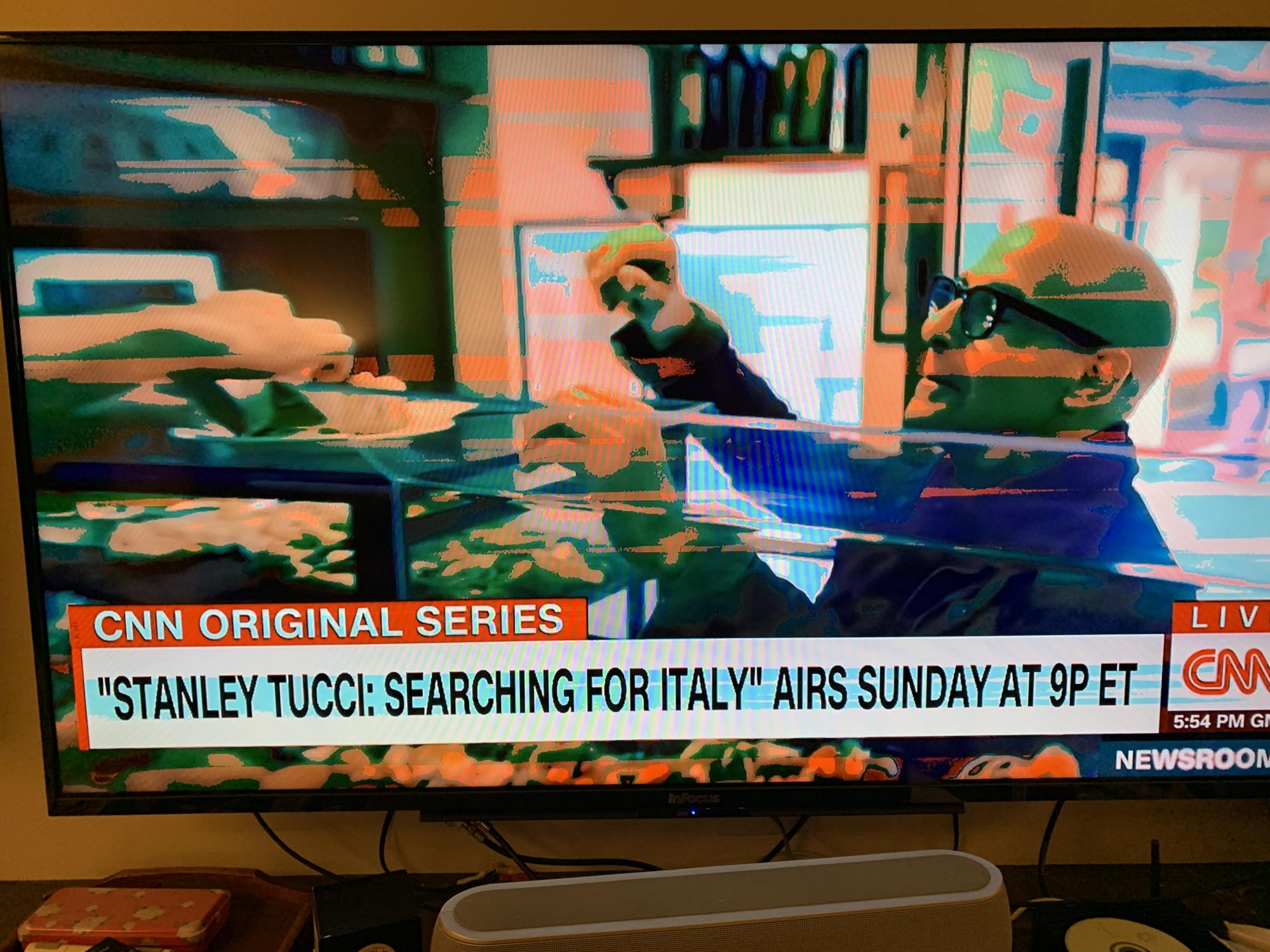

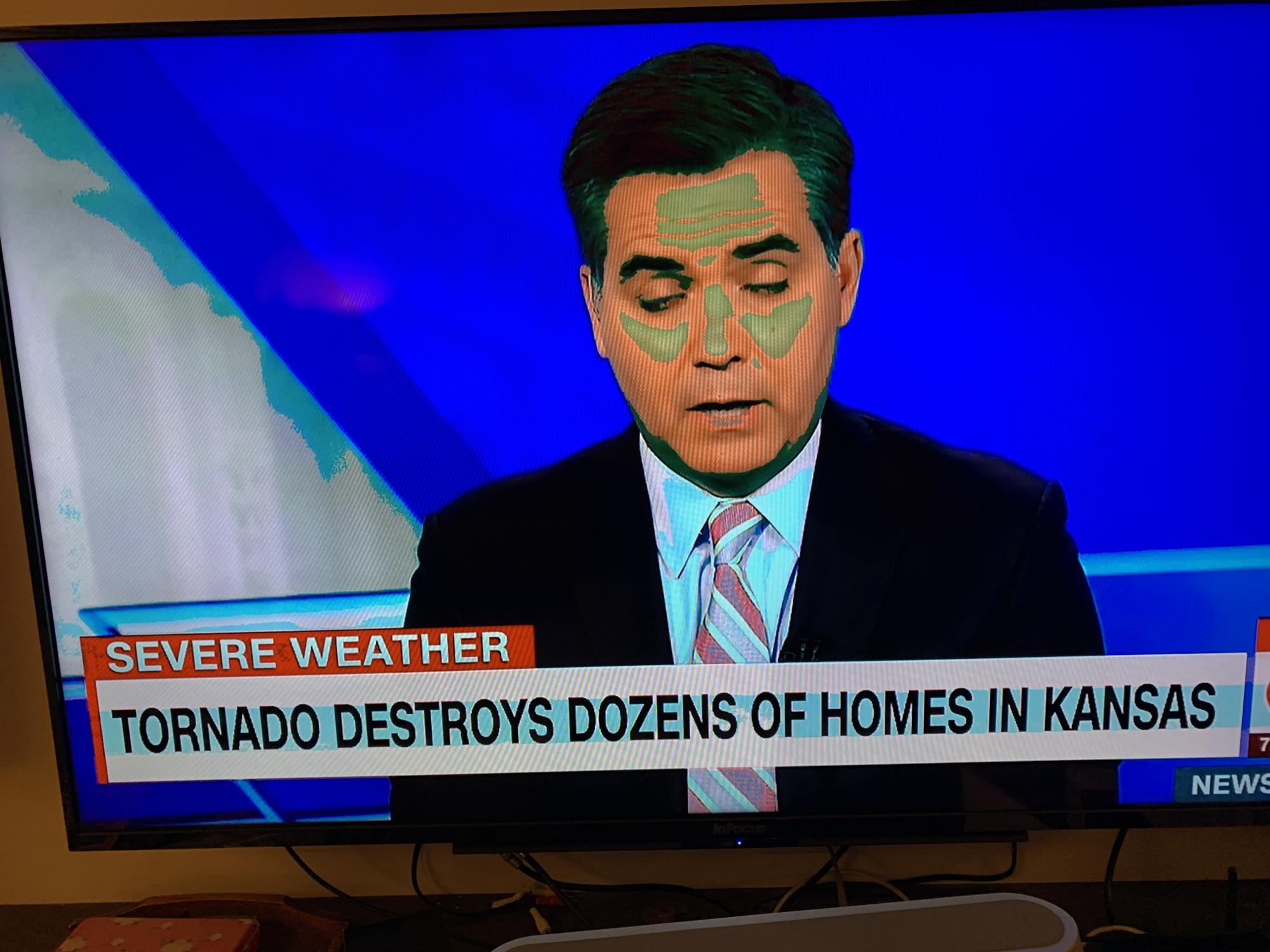

    I have problem with my AVR(Marantz SR4003) HDMI board issue. I connect to my TV but screen color distorted,see attached picture.
    Connection as below:
    Set-top box HDMI output >AVR 3 HDMI input/one HDMI output>HDTV HDMI port
    If I bypassed AVR then HDTV screen color be good.
    I take out HDMI board from AVR and check services manual the schematic shown the HDMI signals path:
    3 HDMI input port > SIL9185 chip(HDMI switch) > SIL9033 chip(HDMI receiver) > SIL9030 chip(HDMI transmitter) > HDMI output port
    I replaced all of these three chips but no change. Power to chip 1.8Vand 3.3V is fine. I have no idea what the next I can do.
    Anybody has experience to deal with such problem, please advice, thanks!

    probably already tried it but did you try a different hdmi cable?
    • aliougm
      • Oct 2021
      • 11
      • Taiwan
      Re: AVR HDMI board issue, seeking for help
      Yes, replaced HDMI cable nothing change!
      • aliougm
        • Oct 2021
        • 11
        • Taiwan
        Solved:
        I found one pin of SIL9033 non-wetting. soldering all of pin once problem was solved. Share it may help for you.
