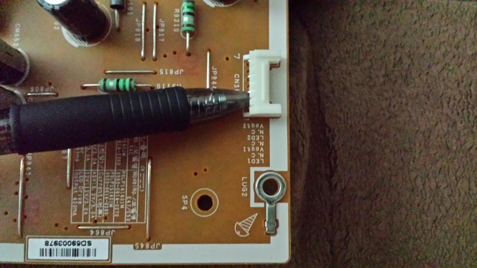

    I have a Vizio E470i - A0. The TV was hit by lightning and is completely dead! Nothing happens when I try to tun it on either by remote or by the power button on the back. I was referred to Badcaps by ShopJimmy.com. Shop Jimmy, as you may know, offers YouTube videos of how to check your TV then sells you the parts to fix it.
    The test they referred me to do was checking for voltage at the Vout 1 and Vout 2 pins on the Main Board. Both they said should have at least 100 volts. Both mine had 0 volts. This would indicate that my board needed replacing. The board is # 0500-0614-0270.
    My question is, would the lightning strike cause the same thing as just a failure of the Board itself? Is the test I did for voltage accurate for a set hit by lightning?
    Thank You

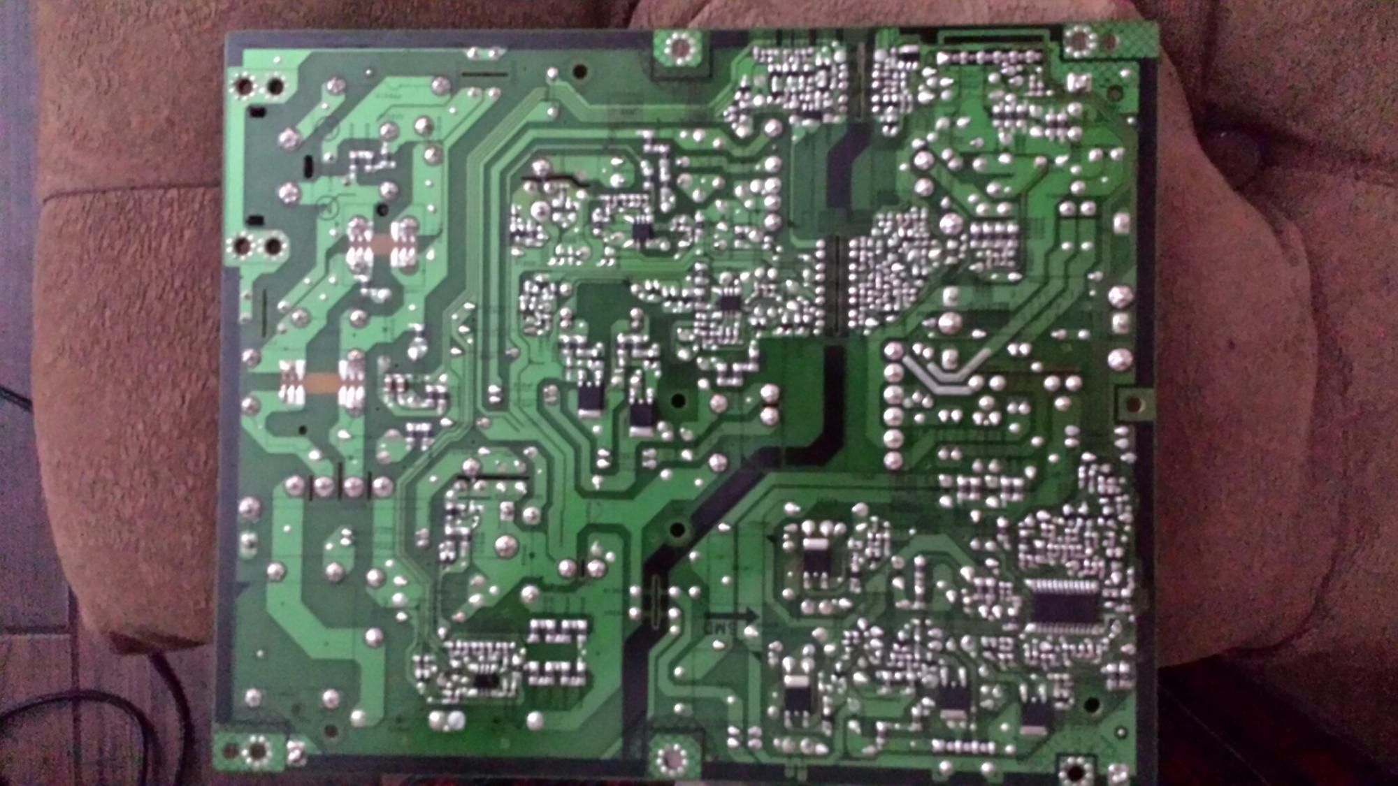

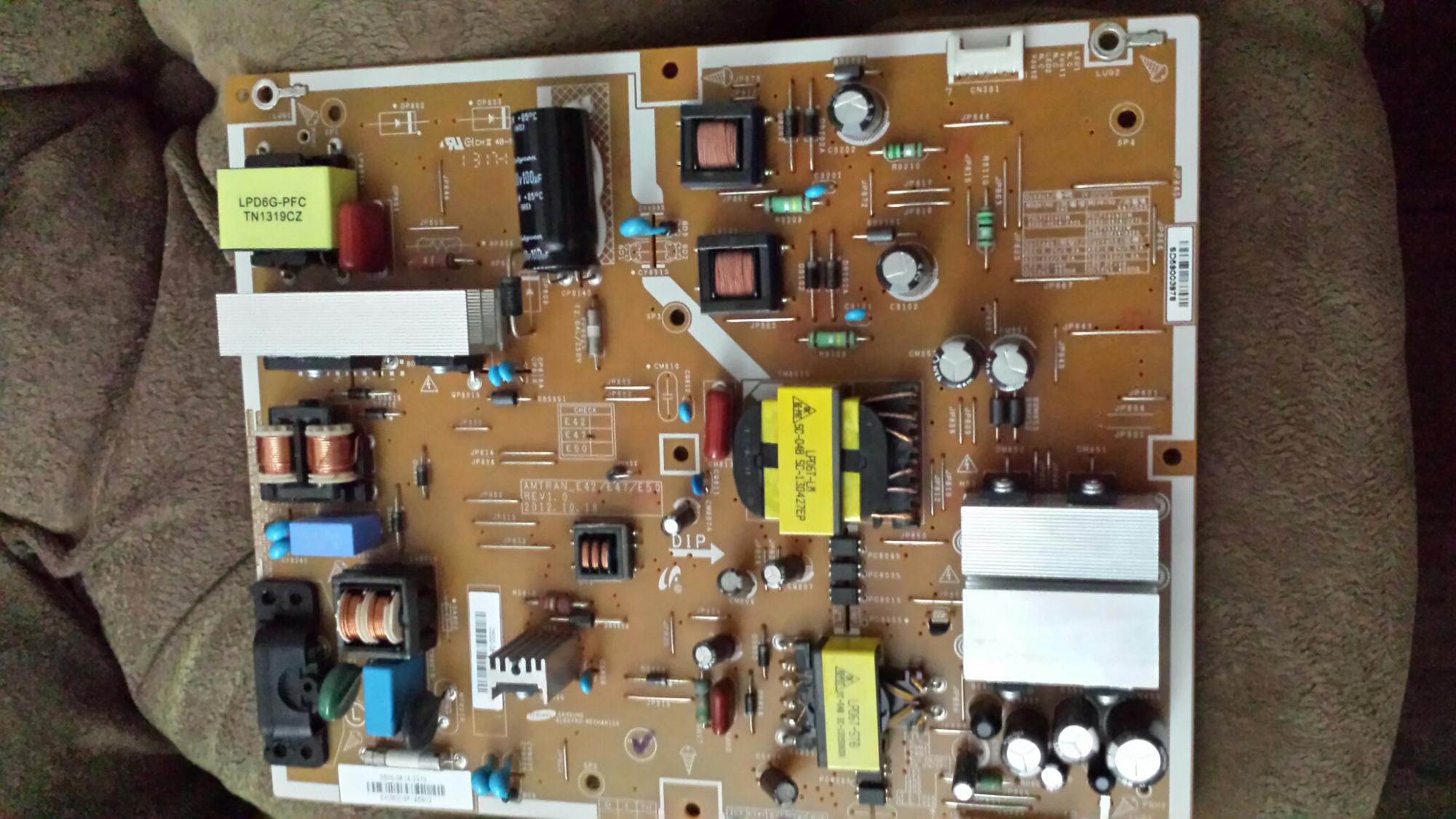

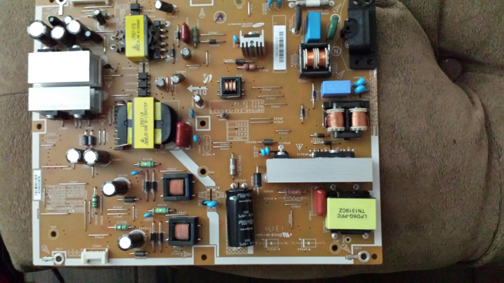

              Re: Vizio E470i - A0 hit by Lightning
              These are of the board I am dealing with. The only test I had been advised to preform was a test of 2 connections that I am pointing to in the third picture.
              I read and watched a video that said test for voltage at Vout1 and Vout2.
              Each should be 100 volts. Mine are zero. The number on the board is:
              0500-0614-0270.
                Lemme help you a little with the troubleshooting process:
                With a unit like that, you always go and check if the PSU is making STBY Power that goes to the main board. Then you try to turn the TV on and check on the PSU the PSon and the BLon that come back from the main board to the PSU to turn the PSU fully on. That tells you where the problems are. Just checking the backlights like that is the wrong approach here, since you don't know of the main board works or not.
                My hunch on this is what budm said. Probably lightning has gotten into the main board through the HDMI port, which could leave the main IC either partially or totally fried. You are somewhat in luck here, since the main board actually has an hdmi switching IC. It could be that it got fried and nothing else on the main board. Anyway... check the STBY power, then the PSon and BLon. Then we proceed from there.
                ... and better pics, please.
