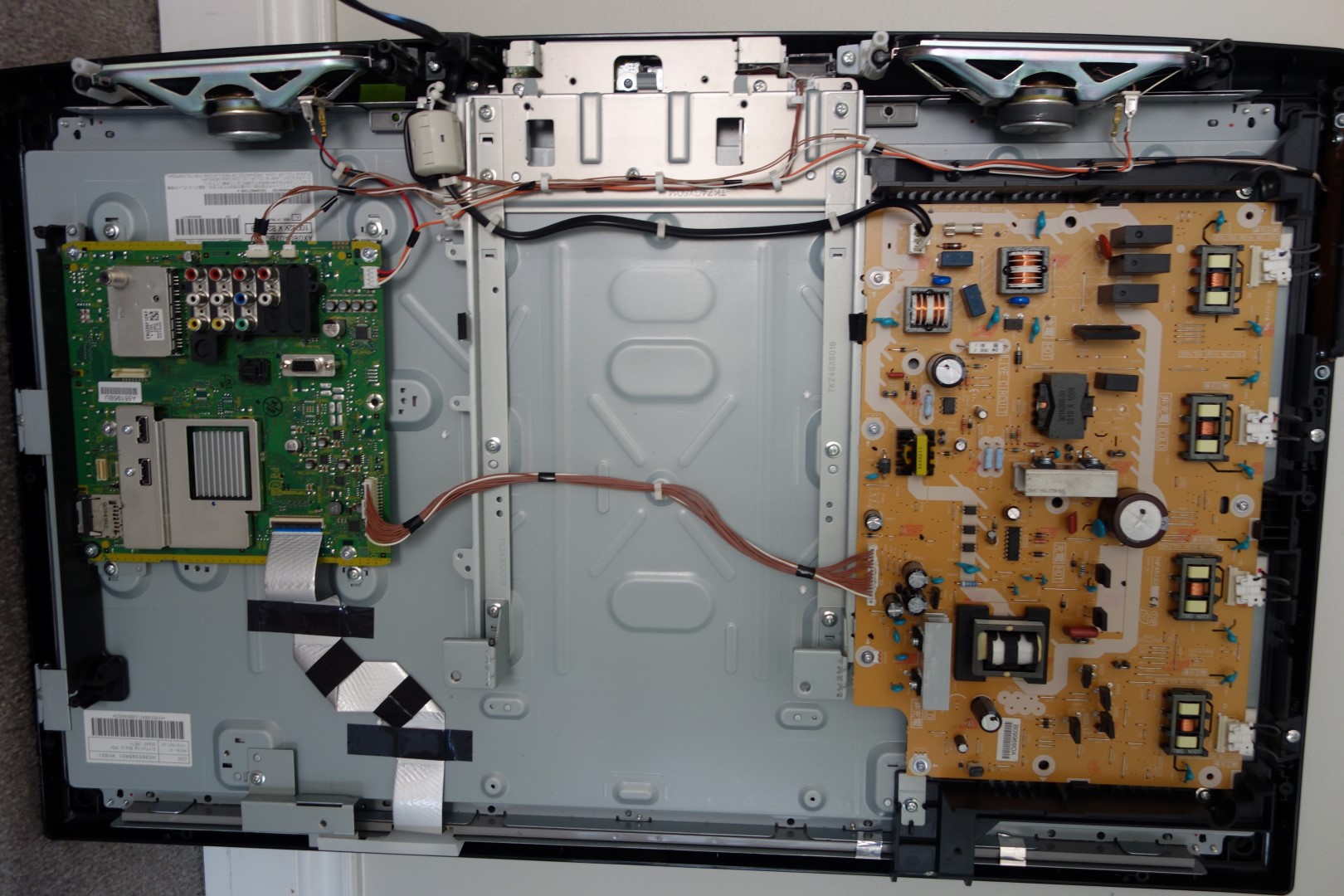

    TV doesn't have standby LED but has standby voltage and does attempt to turn on when the power button is pressed. It shuts down in a second possibly detecting an error. TV does have diagnostic blinks but since the front LED is off, I'm not sure if it is blinking. If I had a scope, I could probe that line.
    Service manual and schematic can be found online.
    When on, PFC circuit which powers (12V, 17V, 32V) gets around 390V before shutting down
    connector pins off/on
    ADIM
    INV-PWM
    INV_ON 0V/0.05V
    INV_SOS 3.3V/3.3V
    RELAY 0/6V
    TV MAIN_ON 0V/.005V
    TV SUB_ON 0V/2.3V
    17V 0V/18V
    DTV12V 0V/5-6V
    TUNER6V 6V/6V
    5VS 6V/6V
    Measured with the ccfl connectors off but same behavior when connected. 12V, 17V and 32V lines aren't shorted.

      TV_SUB_ON drops to 0V when it shuts down. I remeasured DTV12V with a non-autoranging meter to get a quicker reading and it is only reaching 5-8V. I suspect this is the main problem since this voltage is used on the main board and regulated down to lower voltages which also trigger error detect signals (low/no voltage). Checked the cap on the 12V output line C7508 and it tested good. Also reheated the transformer pins. The other outputs from the transformer (17V and 32V) look ok.
      Also checked OVP circuit (R7750/J13) on PS board and it doesn't go high.
      Tried a 10K pullup on the TV_SUB_ON line to 5VSB with connector off and power supply didn't turn on. May need a load or some other signal.
      The connector to the IR/front LED board is broken which is why I'm not getting a front LED. Will have to wire the 3 signals I need (R_LED,3.3V standby, and GND) directly. G_LED is not populated and no wire.

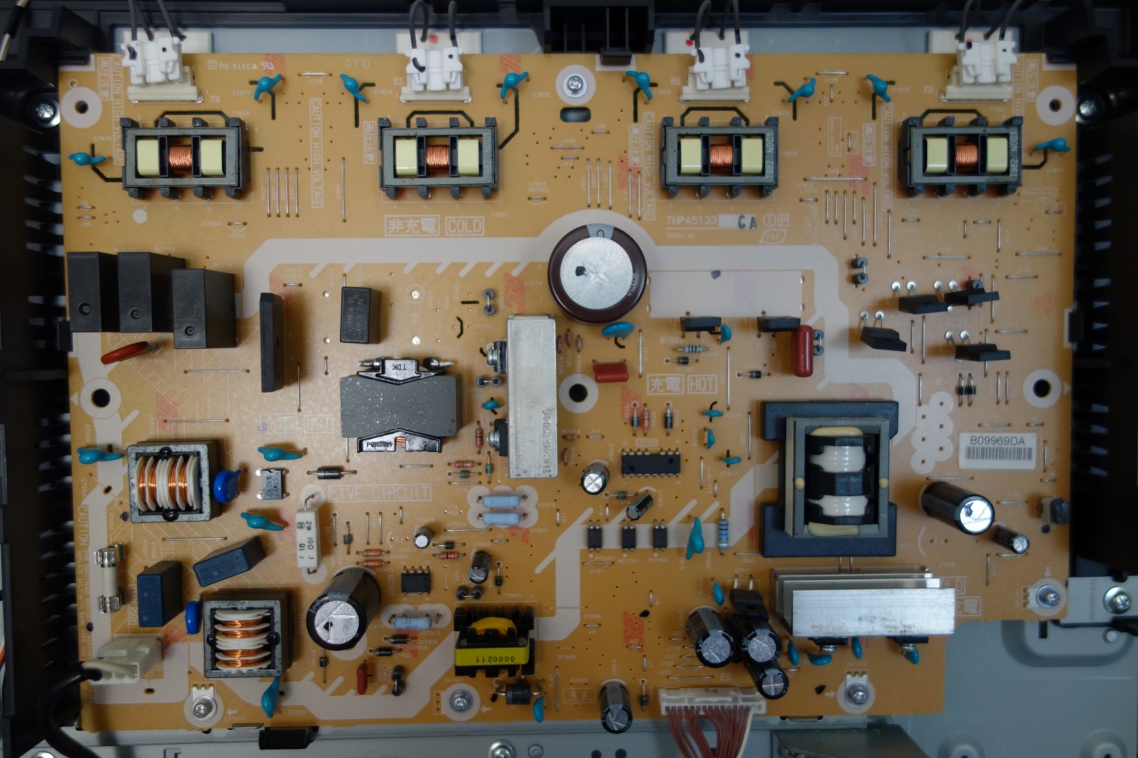

        Got the power supply to turn on without the main board connected. I was missing the 6V on the RELAY pin. With PS forced on, PFC voltage peaks around 416V on before settling at 390V. When monitoring the 12V and 32V outputs, they peak up and then slowly drop even with no load and the PFC steady. This leads me to suspect IC7301 (SSC9512) is shutting down.

          I searched SSC9512 and found this post.
          https://www.badcaps.net/forum/showthread.php?t=30457
          Check R7303, R7305 and R7306 by lifting one leg up and R7306 measured a bit high. 1.3M instead of 1M. Replaced it and TV powers up!!!
          Power supply board number is TNPA5123CA.

            Great job, those resistors with high resistance tend to drift off in value a lot.
