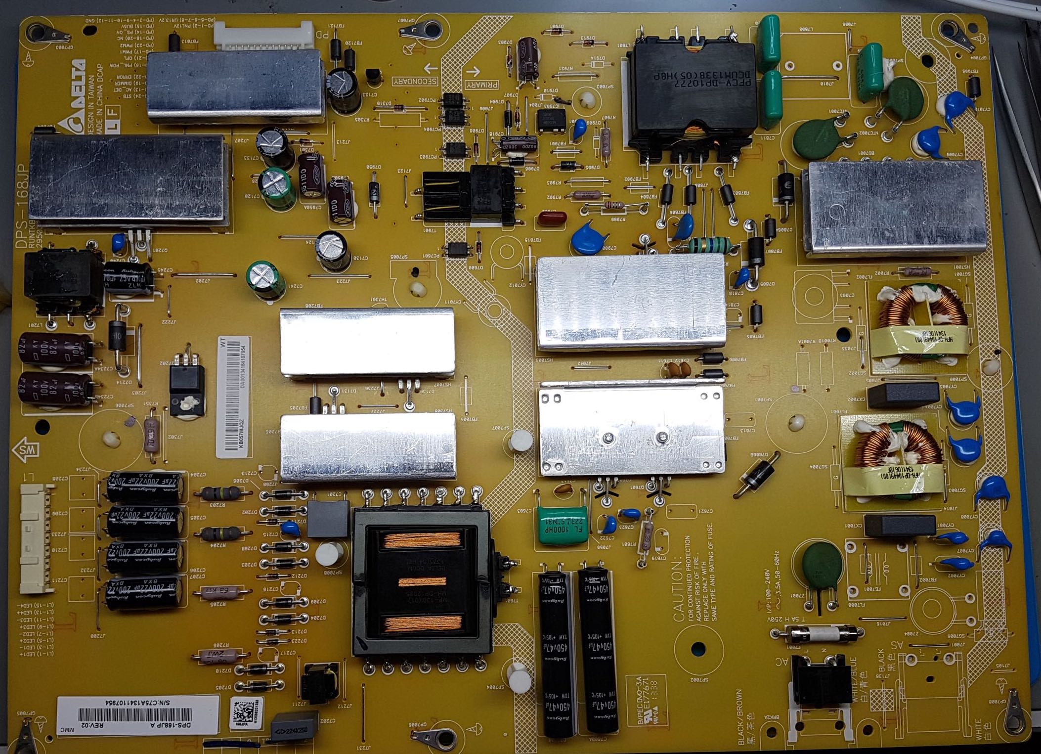

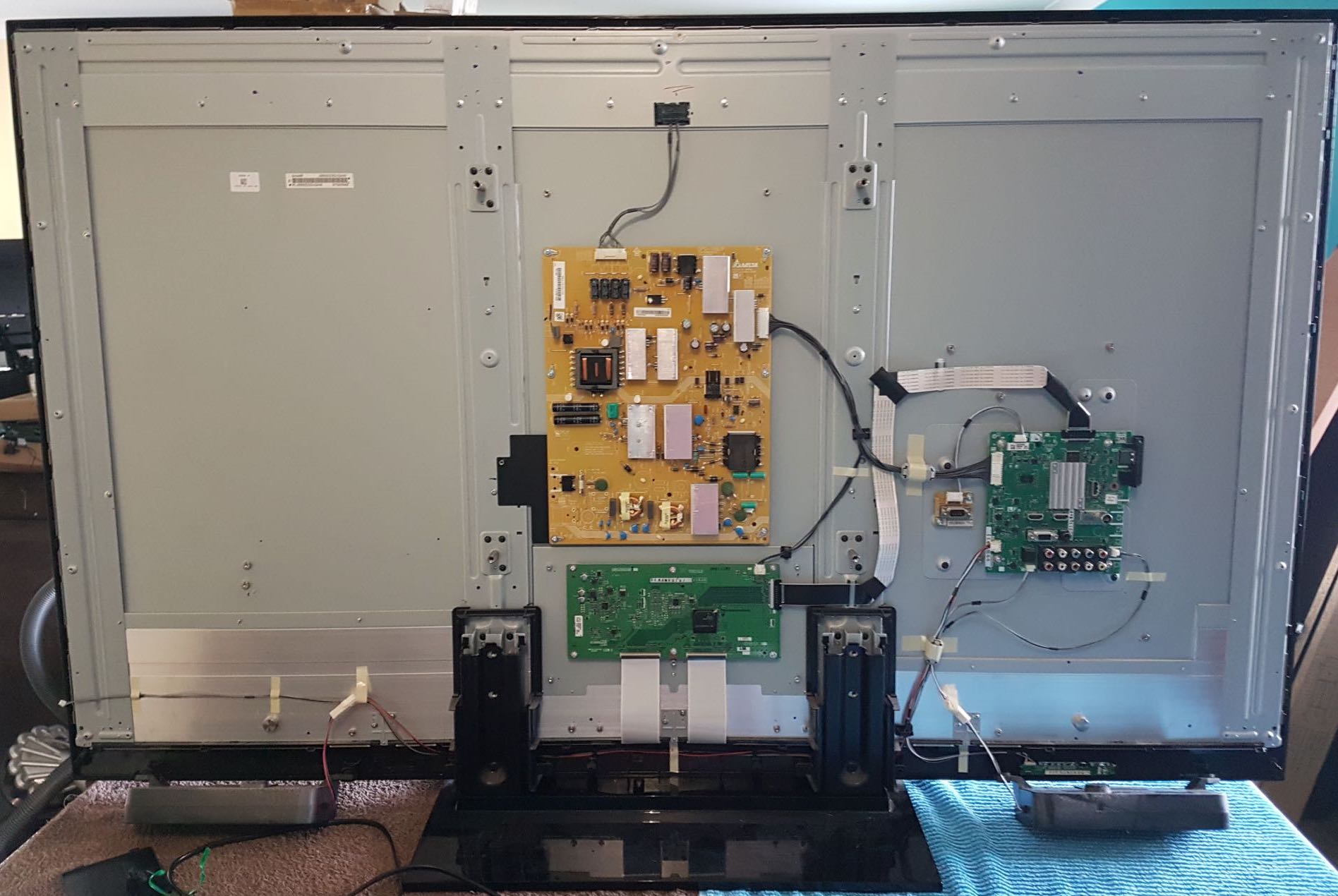

          Can we see the pictures of what we are dealing with?
          Show the back side of the TV so we can see all the boards.
          Power supply board P/N and good clear straight shot pictures of the whole board?
          Main board P/N?

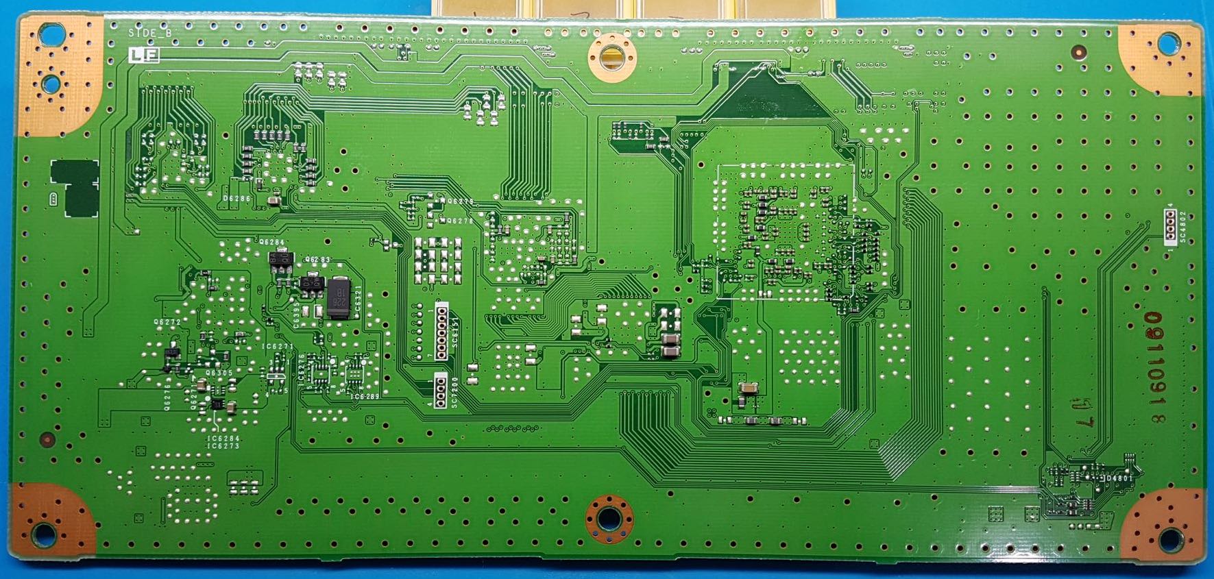

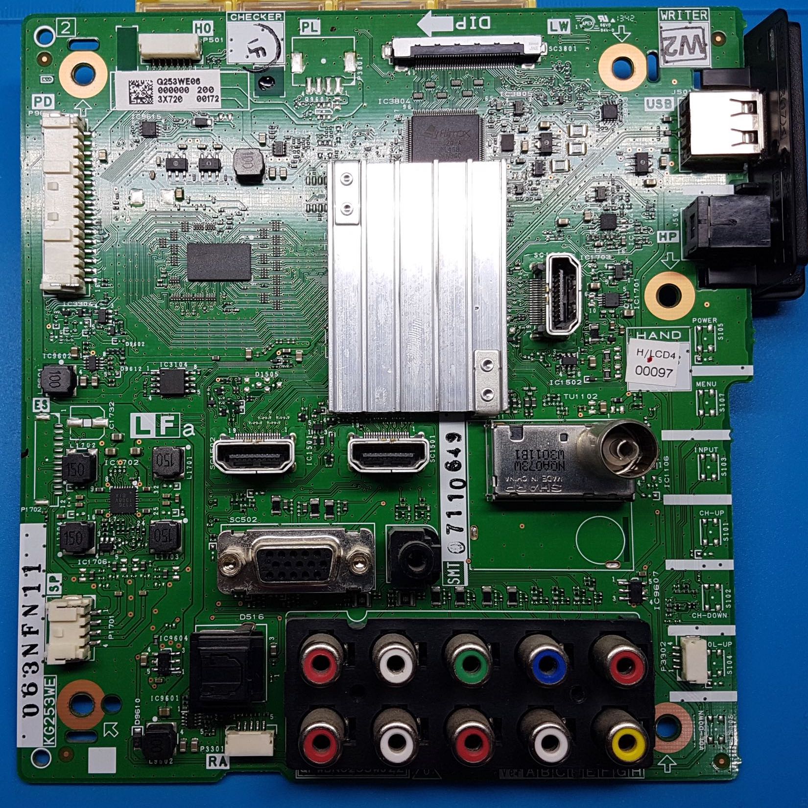

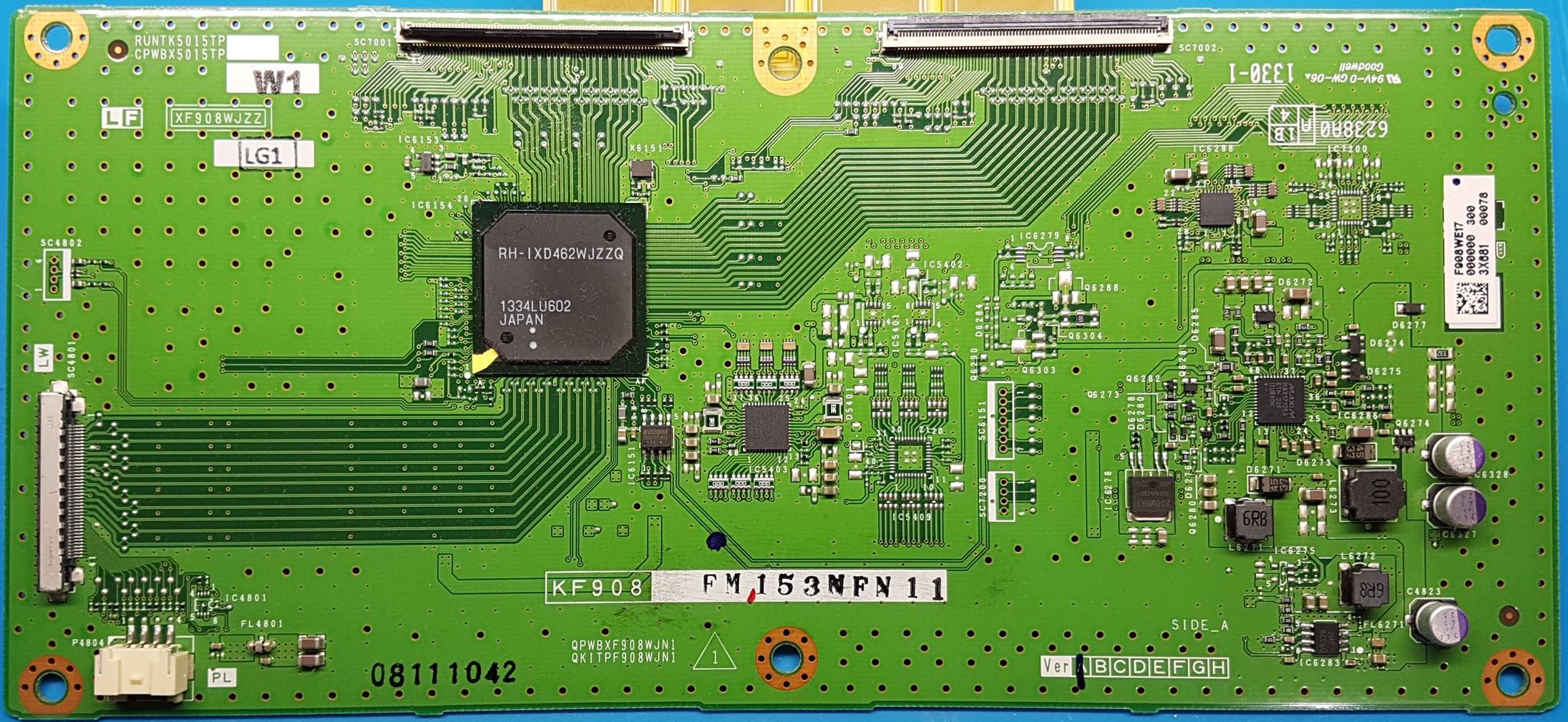

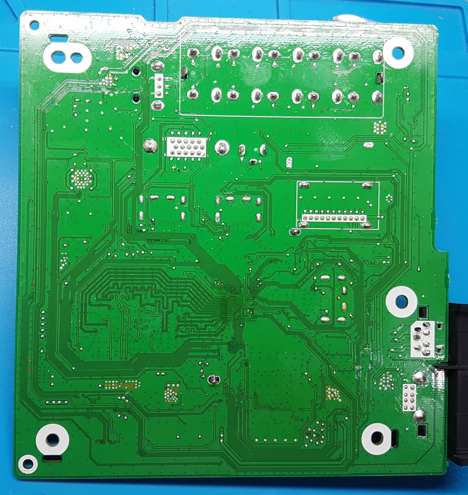

            Re: Sharp LC-60LE650X - Temperature warning
            I took a pic of the rear but where I have the TV, the lighting is not great for photos so I took each board out and snapped them individually. I'm not sure which number on it is the p/n.
            Incidentally, I noticed that there appears to be some liquid running under the large BGA chip on the tcon board. I wonder if that is the source of my problems. That chip has a really thick thermal pad to couple it to the metal chassis of the TV so it must generate some heat.

              I have a proper sweep freq ultrasonic cleaner that I use for macbook logic boards. Can you think of any reason why the tcon board shouldn't be cleaned in the same way? I'll fire up the heater now cos the tank takes a couple of hours to heat up.
              • Logic West
                • Oct 2018
                • 10
                Never mind, I couldn't find any sign of liquid on the inside of the rear cover. It looks like the liquid under the BGA ship is just liquid that has leached out of the big thick thermal pad and it has come through the vias and onto the balls. I doubt that liquid is electrically conductive.
                      You can try cooling the main board with compress canned air upside down or have the fan blowing on the main board for a while then power up the TV to see if the error will still show up or not right away.
                      "Perhaps the TV flexed and a trace was broken or a SMT chip pad became disconnected. I'll put the boards back in and do as you say, it's a good idea." you may be correct.
                      I am still looking through the pictures of the boards.
                      There is nothing in the user manual either about the Temperature warning message.
                      BTW: Sharp RUNTKB057WJQZ (DPS-168JP A) Power Supply / LED Board LC-60LE600U
                      is used in LC-60LE600U so I look at the service manual for the Temperature warning message:
                      It will show 4-blink code.
                      'Judged by monitoring temperature with the temperature sensor.
                      When the panel temperature is 63°C or more, caution is displayed.
                      If the panel temperature is 65°C or more, error standby is
                      activated.
                      [Released]
                      Reduce the value of TEMP CAUTION (temperature caution
                      threshold) and TEMP SHUTDOWN (temperature protection
                      threshold) in the adjustment process mode menu."
                      The main board of the LC-60LE600U, it has Thermistor TH3301 that feeds the main MCU IC, so you may want to look at your main board for part with TH** designator.
