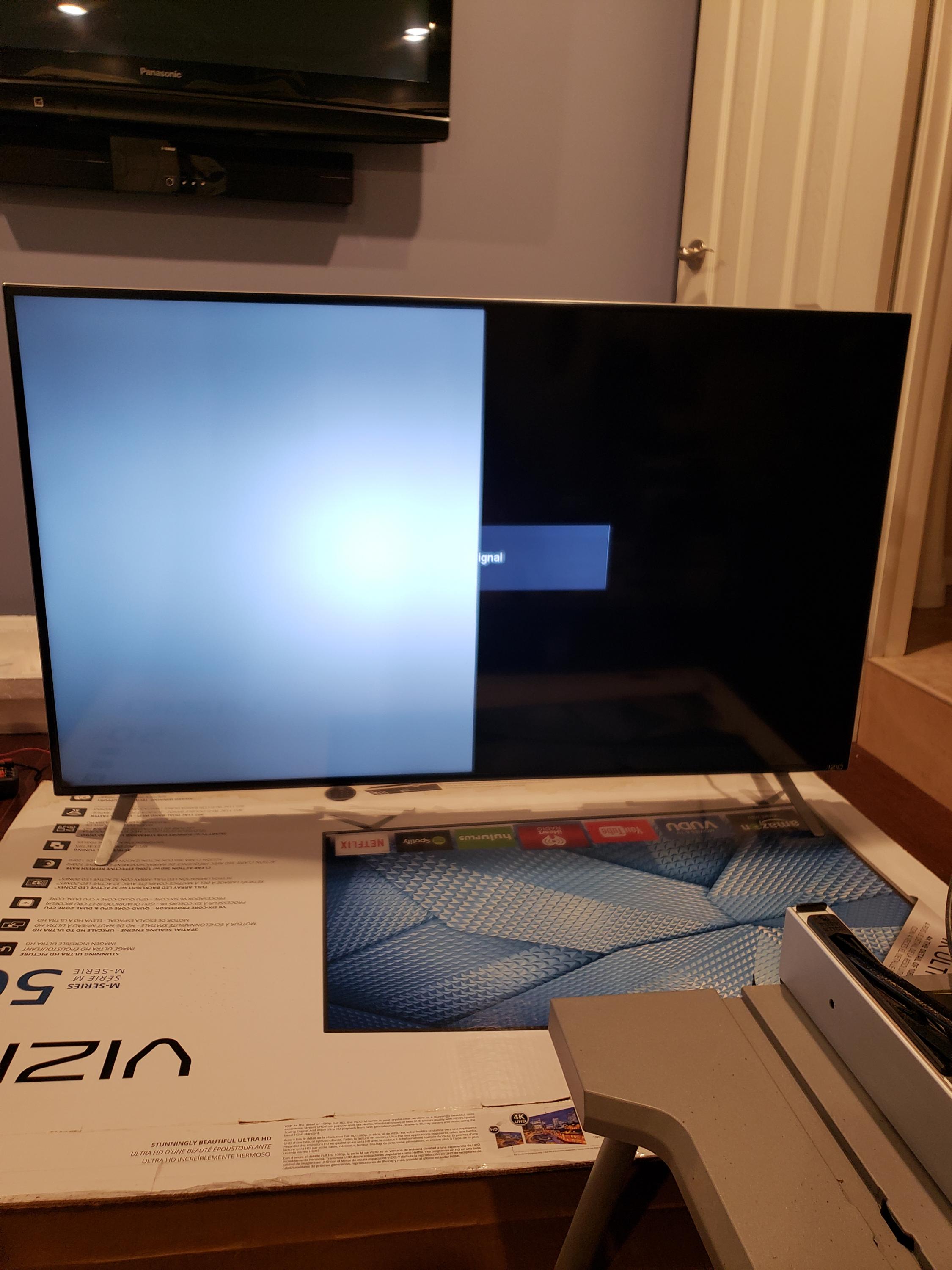

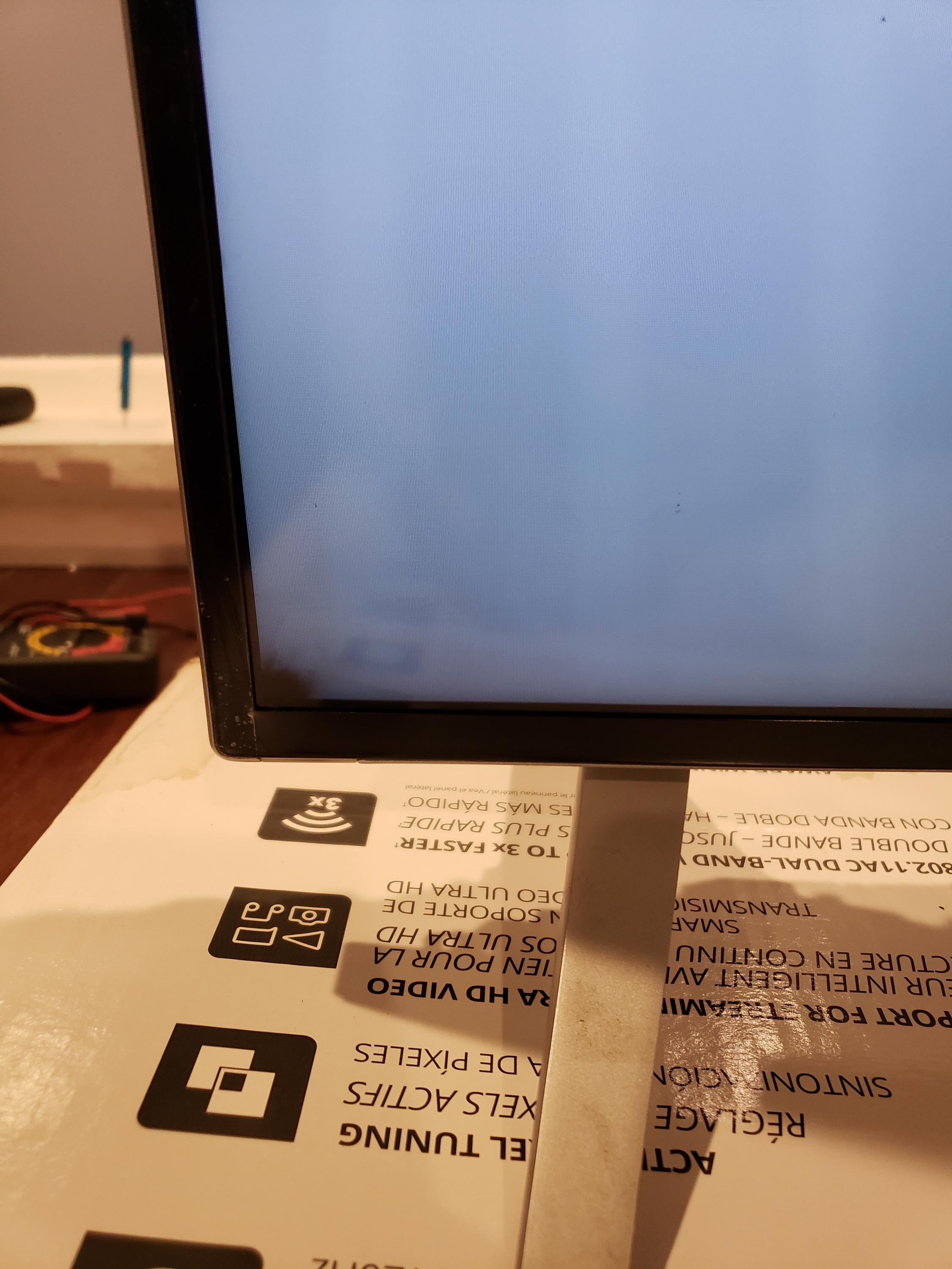

    I have a model Vizio M50-C1 that powers on fine with back lights but no picture. I removed the back and didn't see any obvious signs of damage. I replaced the t-con board with a known good board, same model as original. No change.
    I did notice that when you push a button like menu or volume the screen brightens in the area where you would normally see the picture. It just makes a slightly brighter whitish area. So it does respond to inputs from the remote. Out of curiosity I unplugged the t-con and powered the tv back on again. Odd thing is it functions the same. So the area that was getting brighter with hitting the inputs on the remote must be from the back lighting as the t-con was unplugged and the led panel was not powered on. So now I'm wondering if I have a bad logic board and it not feeding power to the t-con. I've been trying to locate a service manual or test points for checking voltages going from the logic board to the t-con so I don't end up buying a logic board only to find out that doesn't fix the problem.

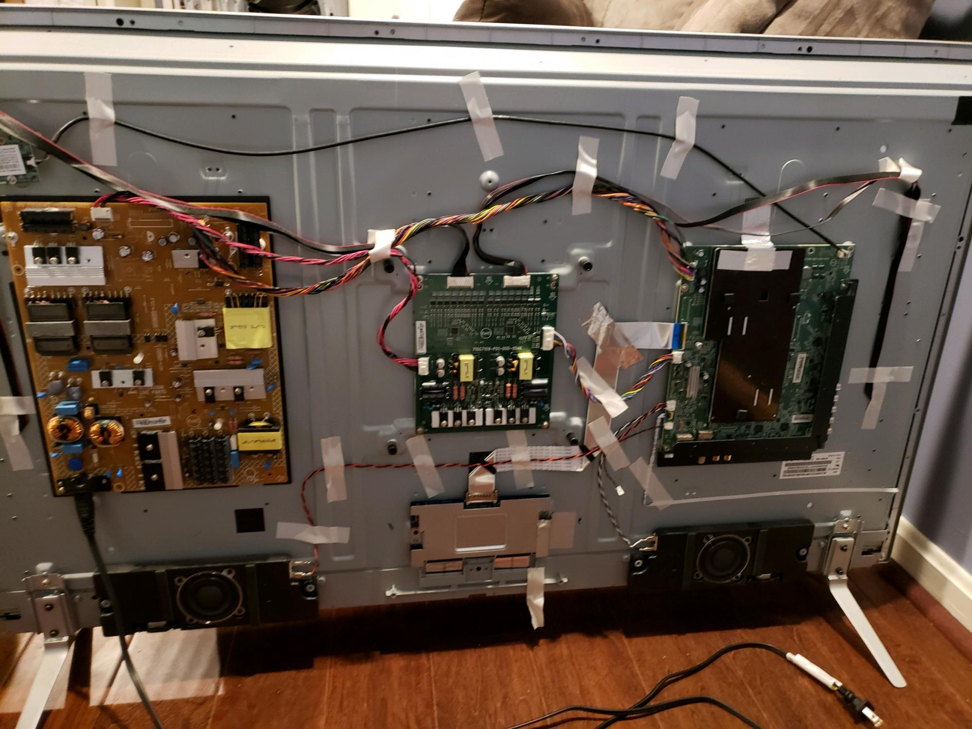

    Can we ate least see the pictures of the whole backside of the TV so we can see what we are dealing with?
    How many cables between the TC-ON and the LCD panel does it have? You may have to have those cable connected one a time to see what happen and also need to check to see if the T-CON is getting 12VDC for it to run or not.

      I'll see if I can have my wife take some pics and send them to me so I can post them. I can tell you two cables from t-con to panel. I wanted to check for 12 volts at t-con to see if the logic board was powering it on but wasn't sure where to test.

        Here is the back.

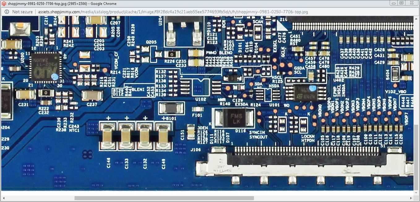

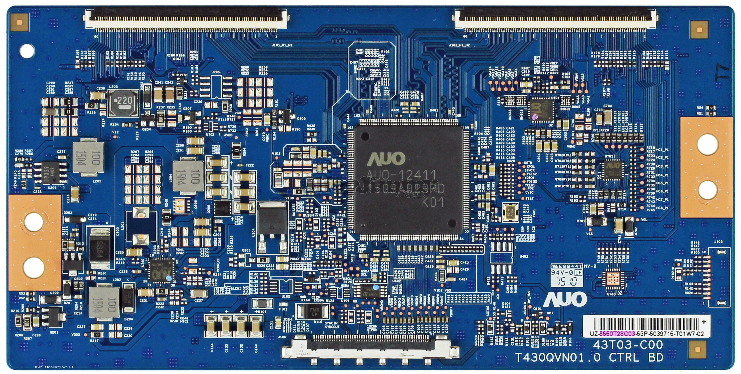

          The best place to check for the voltage is on the t-con is the fuse, If this is your board it a white smd marked as F101
          Depending on your tv's serial number, shopjimmy has complete board sets for around $80.00
          This kit is compatible with TVs with serial numbers beginning with LTM6SRAR or LTC6SRAR
          although the t-con by itself is only $15.00

            Is it the part labeled F101?
            • R_J
              • Jun 2012
              • 9611
              Re: Vizio M50-C1 no picture
              Yes

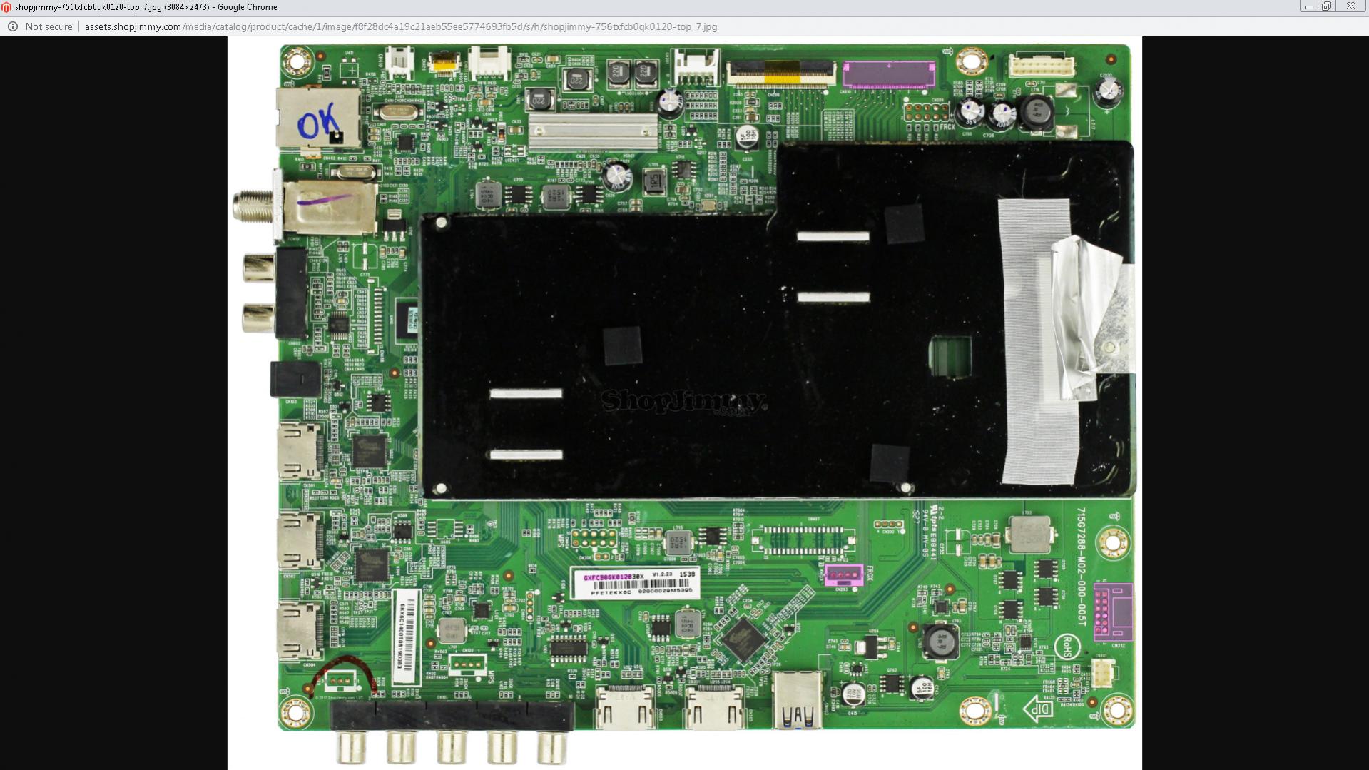

                O I feel dumb I didn't notice you posted the picture. Yes that board is the one I have. I did replace the board and that didn't change anything which is why I'm leaning towards something else like the logic board not powering up the t con board.
                I assume I'm looking for 12 vdc on the fuse to see if the logic board is commanding it to power on? If I don't have any power on either side of the fuse then next step would be to troubleshoot the logic board?

                      This is the main board I have. Currently not available from Shop Jimmy but I have found some used ones on Ebay.
                        I have purchased used boards from e-bay and they were all good, as long as you match the Part No., the one on the white label, with the one you are going to buy.

                              Thanks for all who replied. I checked for voltage at the t-con board and confirmed I had 12 volts. I also tried running the t-con board with only one ribbon cable at a time to see what happened. When I ran it with the right side unplugged I got picture as you can see in this image. So the one side of the screen is toast I'm assuming and from what I can see getting a new screen is not worth the hassle and cost.
                              • budwich
                                • Jul 2015
                                • 3097
                                The tv may still be saveable as there are methods to get the full picture back. Are there bonded tab along the side of the panel... much like the tabs at the bottom of the set which connect bottom edge boards to the panel.... on the side, you may only see tabs and no boards.... might have to take the front bezel off to see the side tabs.
                                IF there are side tabs, you may be able to remove them IF the issue is with one of them... perhaps the bottom one if the picture is showing the dark spot in the corner and its not a crack in the panel itself. Lots of threads with this type of issue (side tab problems) and the resulting "save" by removing the tabs on the side.
