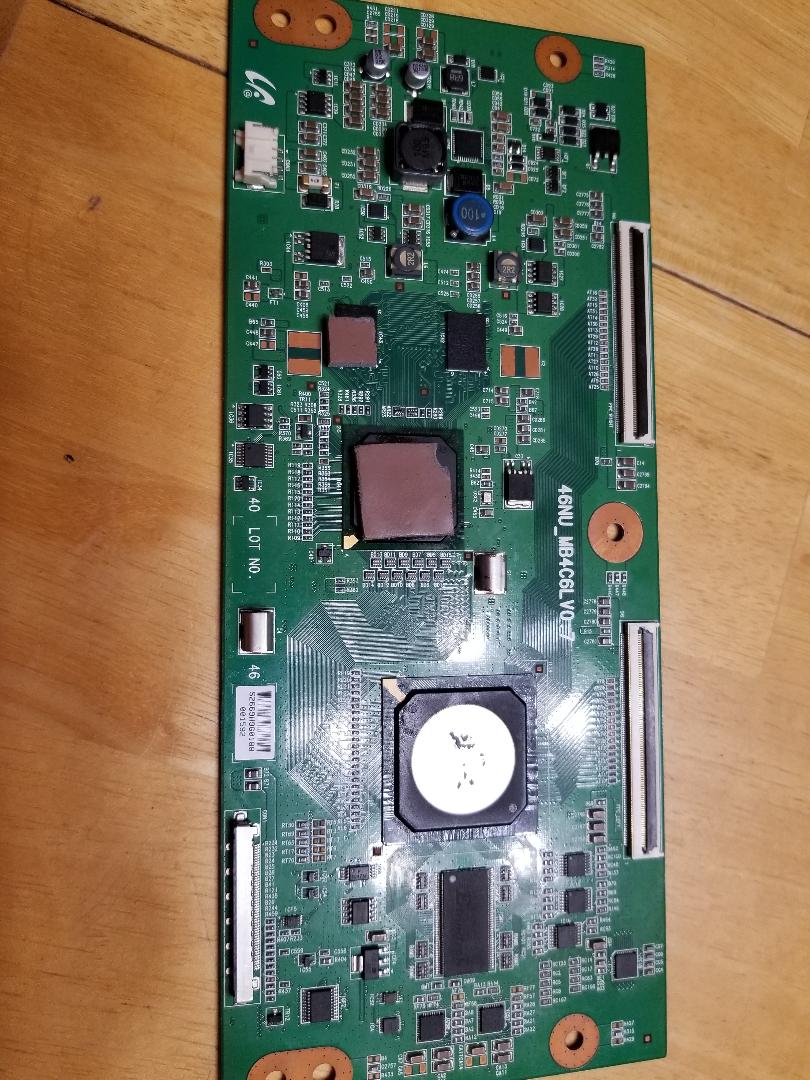

                    I upload the t-con boad i suspect 2 resitor on the top and the bottom the same position from it
                    R16 and R315
                    tested with ohm metre 4k,40k,400k,40M,4000M and continuity but no sound no reading any number just OL
                    you think the resistor on t-con board shorted?
                      #50
                      Re: sony kdl-46w5100 no red light standby, on green off red light flash 14 times
                      BTW, can I see good clear straight shot pictures of the T-CON board?
                      I still think you have problem with T-CON board after searching about 14-blank code.
                      I.E. https://www.badcaps.net/forum/showth...4+blink&page=5
                      https://www.badcaps.net/forum/showth...ink#post667463
                          R16 and R315
                          Those two parts have white body, correct? They are capacitors not resistor.

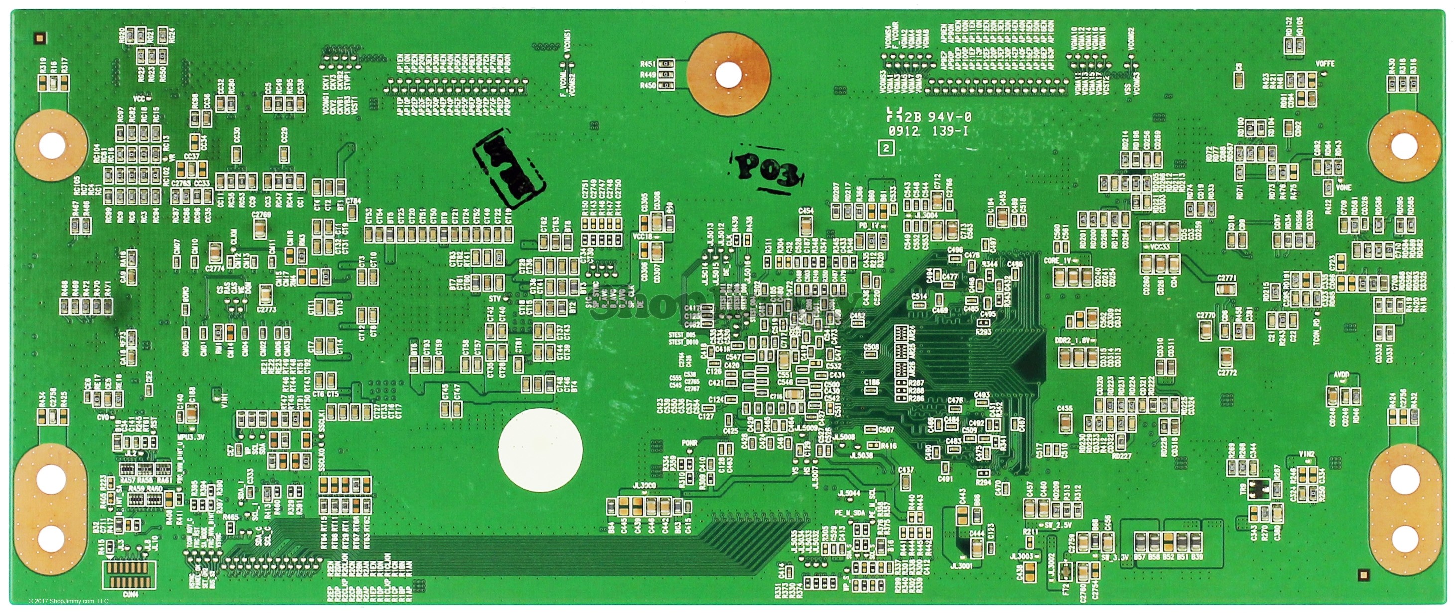

                            If you look at the T-CON board both sides you will see many Voltage test points, I.E
                            http://assets.shopjimmy.com/media/ca...69h-bottom.jpg
                            VCC, SW3.3V, VS, AVDD, core_1v, etc.
                            http://www.shopjimmy.com/samsung-lj9...con-board.htm#
                            Samsung LJ94-02669H (46NU_MB4C6LV0.7) T-Con Board
                            Pictures provided by shopjimmy.

                                  #56
                                  I still think you have a problem with T-CON board after searching about 14-blank code.
                                  I think almost like you but one thing i am not sure that is if I disconnect T-con completely at least when I turn on the tv I have to see backlight light up but otherwise, I see a just black screen
                                  give me idea Budm, i will take more time to test then will make a decision
                                  one more thing is how to check volt at HV from D1N board?
                                  Thx
