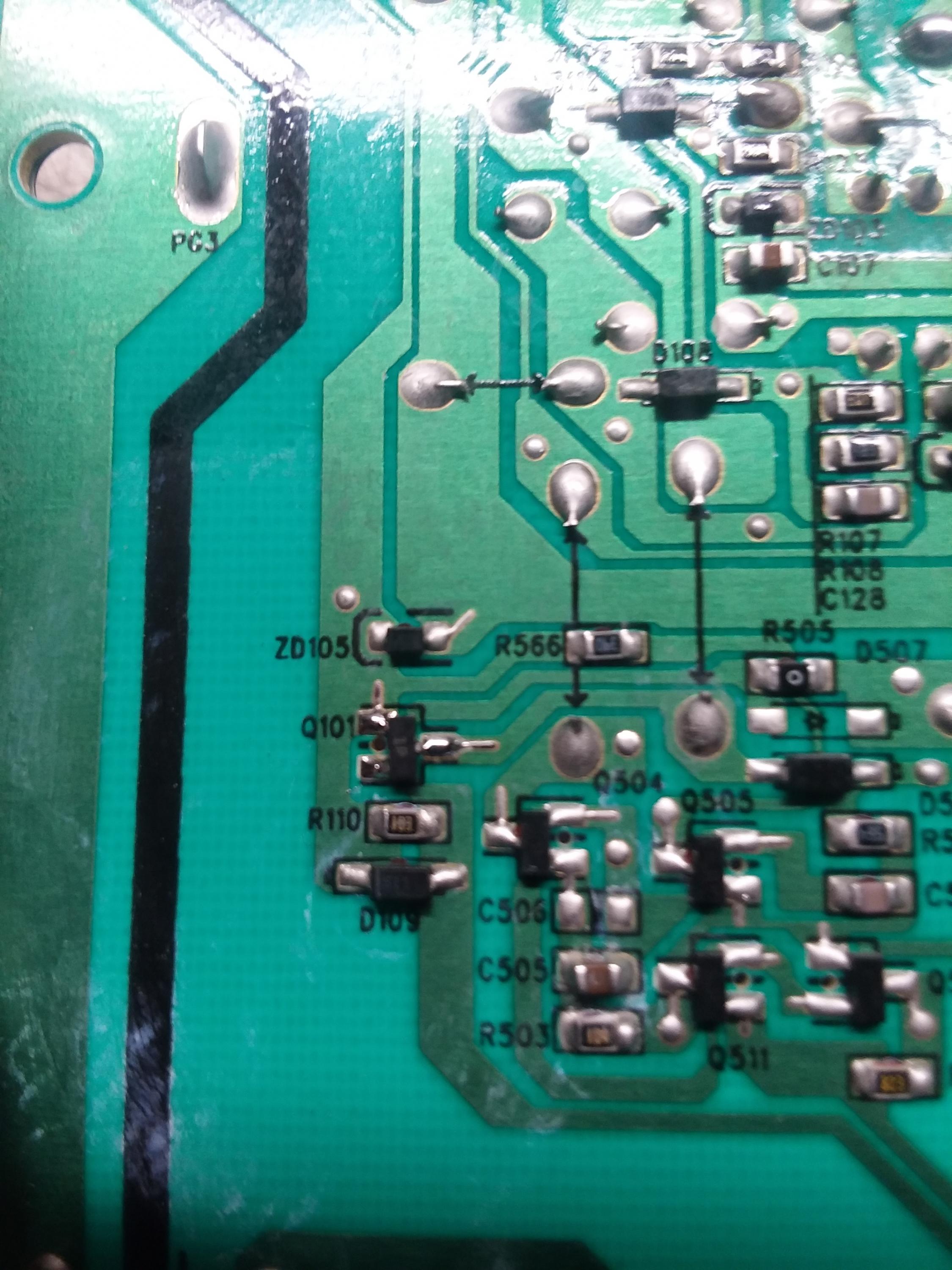

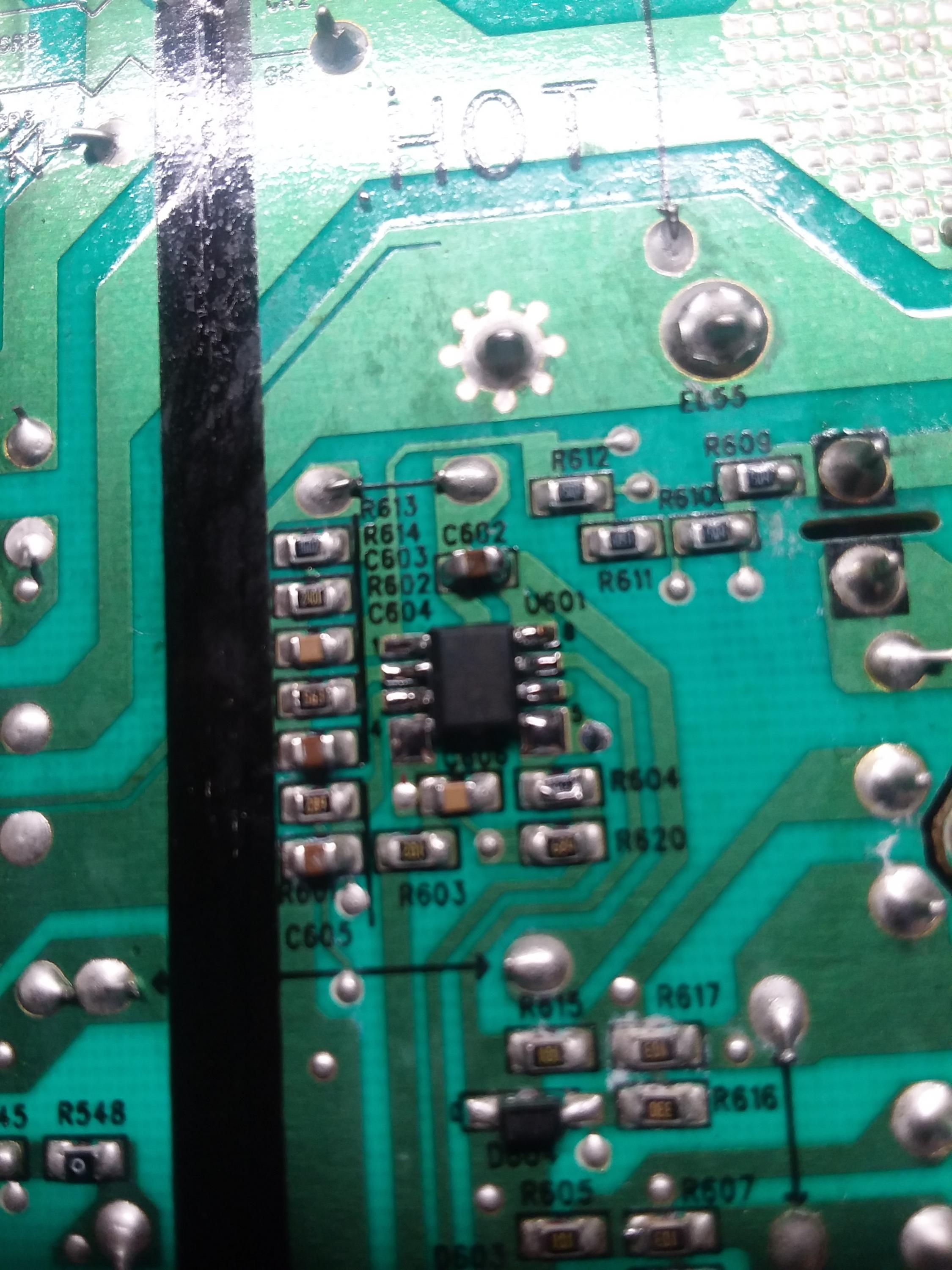

    Ok it's U601 ( you have the board, we have a picture). 30Ω seems low, I suspect the fan7530 is bad. and Q101 will also be bad.
    The fan7530 has an internal zener and should run at about 12 volts VCC
    I would also check the two fets that the fan ic drives, make sure they are not shorted.
    Q101 is likely a KST2222a

      Yes, the IC U601 (PFC IC), it is either internal shorts or the filter caps on the VCC pin, especially the MLC Cap type, i.e cap c602 on pin 8. So check the caps connected to the VCC pin.

        Parts showed up today. The PFC IC U601 was a Digi-Key P/N FAN7530MXCT-ND and the transistor Q101 was a KST2222AMTFCT-ND. I ended up using a different cap from a parts board for C602. Just finished installing them and I now have 12v!!! Thanks guys for guiding me threw this step by step. Tomorrow morning I'll install it in the TV and let you know if we have success.
