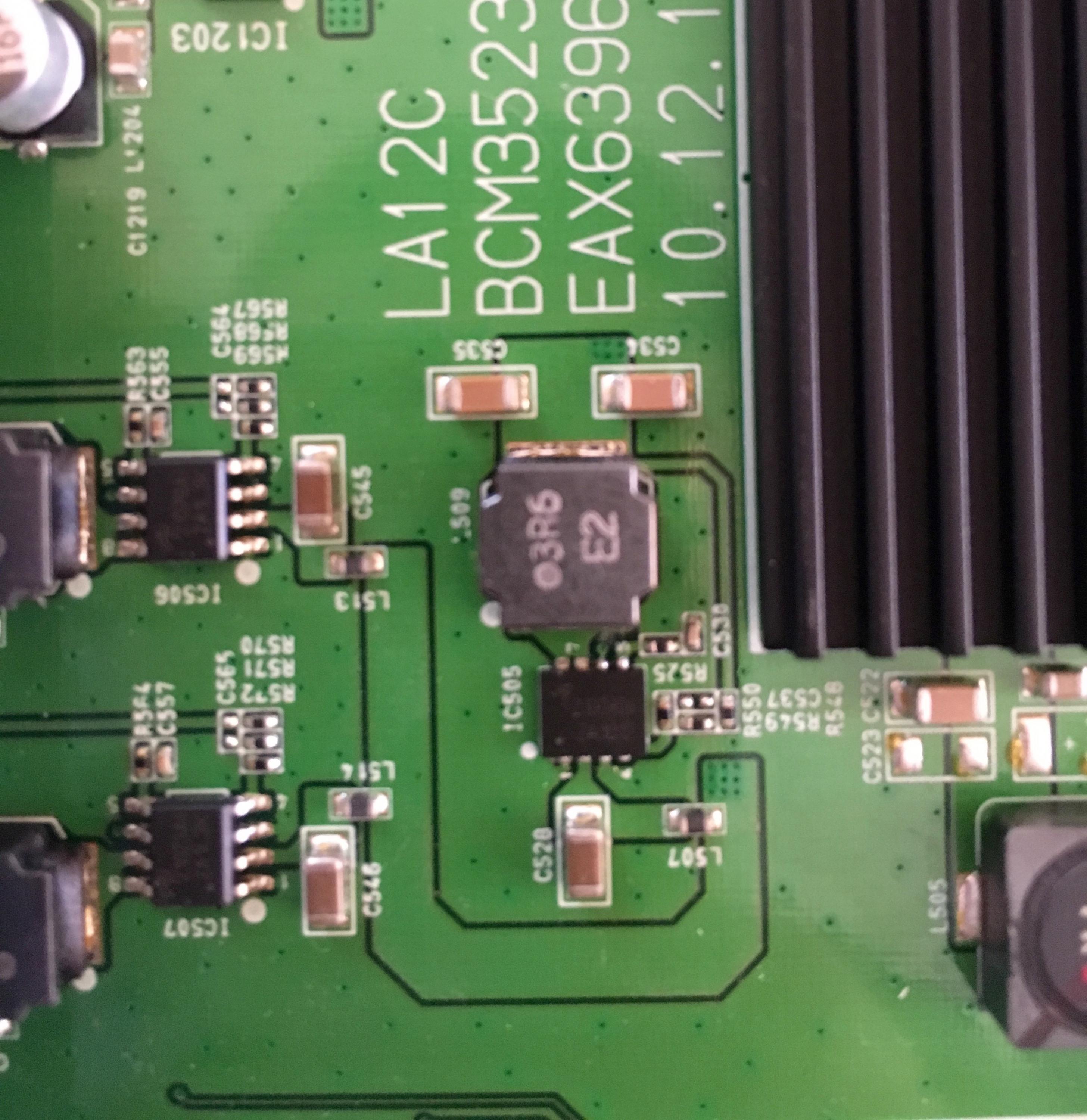

LG 55LW5600 No Video No Sound
Re: LG 55LW5600 No Video No Sound
Black probe on pin 1, red probe on pin 8 = ?? Ohms.
Red probe on pin 1, black probe on pin 8 = ?? OhmsNever stop learning
That is not normal to me, it should be in 100's or 1000's Ohms range.Never stop learning
http://www.badcaps.net/forum/showthread.php?t=24809Comment
That's with the TV unplugged. It was higher when it was plugged in (but off).Comment
Is it safe to say the main board is the problem? I'd be willing to replace that (if I can find one) to get this back up and running.Comment
Being able to turn the TV on and off but with no picture, no sound, and no backlight is a very common issue we see from these TVs and it is caused by a bad main board. The BGA chip which is located underneath the large heatsing, is no communicating with the board properly. Generally performing a reflow or reball of this module will take care of your failure.
Could you post a picture of IC505 and the area around it. As well focussed as possible.Willing to help but I'm no expert.Comment
The AOZ1024D can supply an output current of 4 Amp continuous according to the data sheet. If the resistance at pin 8 is 13 ohms then at 3.3v out would be a current flowing of 253mA.
The AOZ1021 can provide a continuous output current of 3 Amps. I think the IC or the components around the IC is faulty.Attached FilesLast edited by dick_barton; 07-31-2018, 04:37 AM.Willing to help but I'm no expert.Comment

As mentioned in the original post, I did the heatgun method and oven method to try and reflow the board initially with no success. What is the best method to do this? I followed advice from a few different sources I found around on the interwebz. Like for the oven - what temp and for how long? The heatgun really made me kind of nervous.Comment
Pin 7 & 8 connect to the coil. Does the other side of the coil connect to a ceramic capacitor?Willing to help but I'm no expert.Comment
I think that IC505 is faulty. It creates the 3.3V_Normal supply from the 12V input to run so many other parts of the set as shown on page 104.Last edited by dick_barton; 08-02-2018, 03:52 AM.Willing to help but I'm no expert.Comment
Late to join this discussion, but my TV just failed. This case is almost identical in part to mine. I also measure ~13 ohms from 0.9_core rail to ground. I also measure the same ~12-13 ohms from 3.3V_norm rail to ground. Replaced IC505 no luck.
All connections between the two are through at least two resistors. Another common point is the main controller. Any other ideas? Thanks youComment
