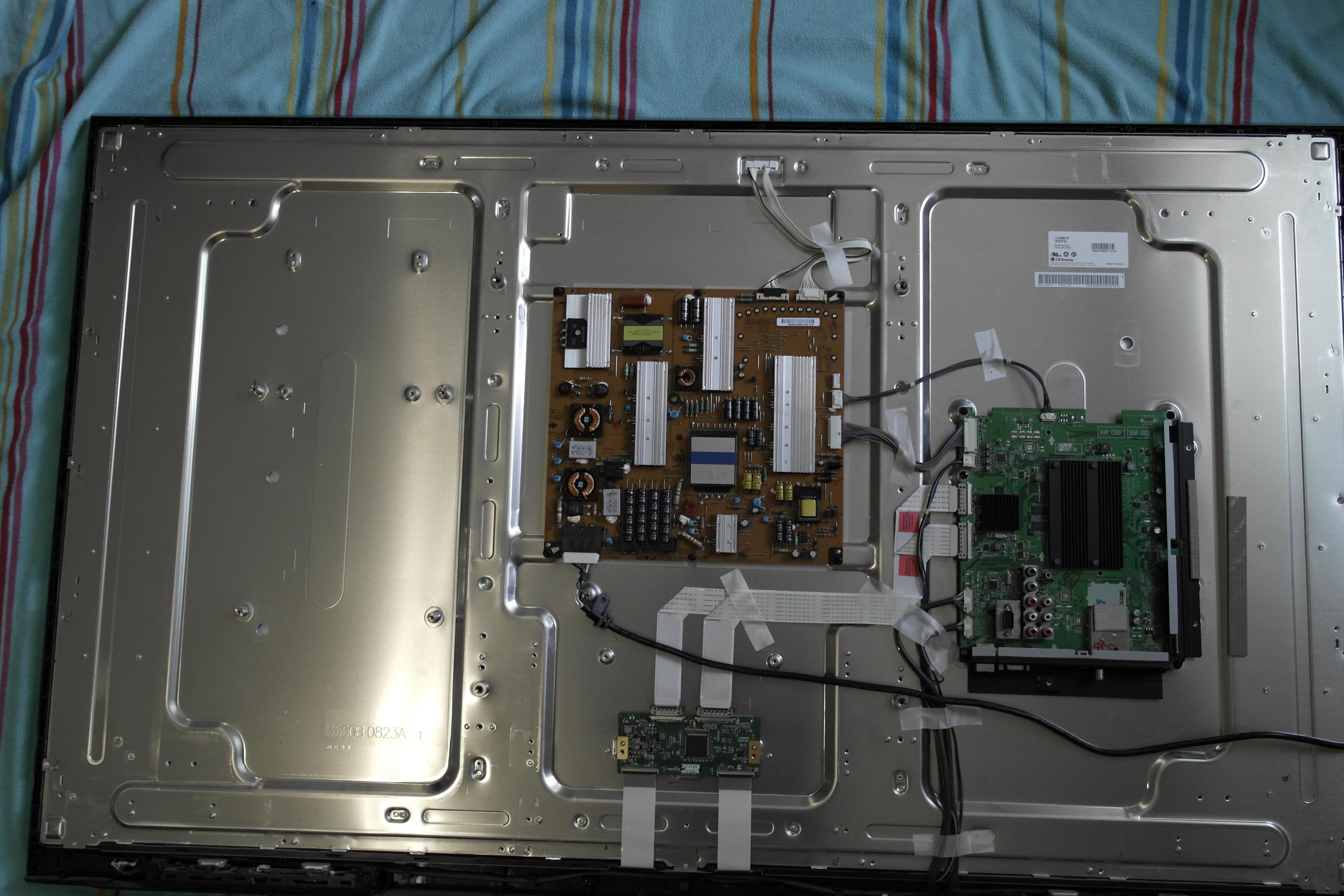

    I'll start by saying I'm not much of a techy, but my TV is dead and thought I'd pull the thread of repairing it. So keep in mind my electronics knowledge is very limited.
    I've spent the last few days reading threads and doing research on what might be wrong with my TV. I did try a reflow (both heat gun and oven) of the main board based on a number of people with similar symptoms with no change.
    So there is no "standby light" on when the TV is just plugged in but off. I believe there used to be but I can't be 100% sure. When I turn the TV on (touch panel or remote) I get a "click", the power indicator lights up red, fades off, lights up red again, fades off, then lights up blue/white and stays on. No screen flashes and I can't see any signs of an image with a flashlight in a dark room. I get a "click" when I turn it off.
    I have a multimeter and checked P201 (power out from power board to main board) while the TV was on.

    Rather than hope that my symptoms where "close enough" to others and keep tinkering, I was hoping to get advice from the experts here. Any help is appreciated. I'll add pictures in a bit.
  • dick_barton
    • Aug 2015
    • 6642
    • Wales
    Re: LG 55LW5600 No Video No Sound
    Can you post pictures of your boards and voltage measurements are easier to read if posted similar to the following.
    Without the set in front of us, the more information you can provide the better chance of finding a solution.

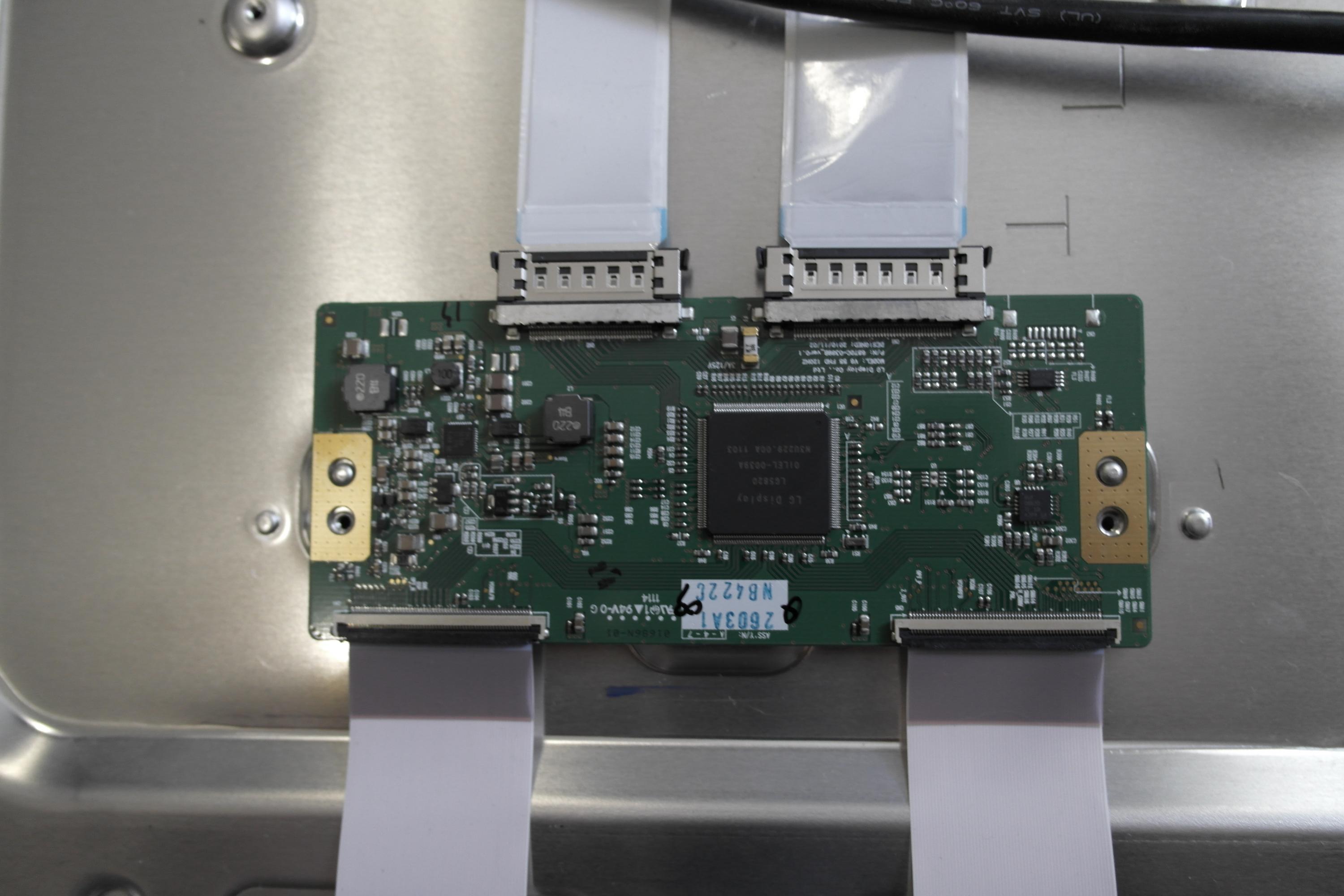

      I have attached some pictures of the set. In your example, are those readings on each end of the ribbon or what? I was a bit confused on what the tho columns meant. At any rate, the only that jumped out as odd to me was the last one. Labeled as 24v and I measured 3.3v.
                DRV_ON is missing which I believe turn the backlights on and is controlled by the main board.
                On some sets if you disconnect the main board from the power supply and switch on, the backlights come on and stay on?
                Are you certain you have no picture. Keep pressing the menu button on the remote and check the screen carefully.

                            It does look as though you have a mainboard fault with DRV_ON not switching. Can you post photo's of your main board.
                            Check the voltages on Q504 on the mainboard (Page 76)
                              Picture of the mainboard is pic 3 in post 3. I can get better pics of anything specific. Also page 71 of the link you posted has details on it. I'm working on reading through that.
