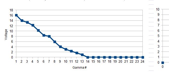

    Before doing anything like that I think you should open this puppy up and take some voltage measurements on the T-CON Bd. they are the Vgma voltages.

        1 16.08
        2 14.02
        3 13.34
        4 12.30
        5 10.31
        6 8.40
        7 8.02
        8 5.91
        9 4.05
        10 3.039
        11 2.372
        12 1.666
        13 .981
        14 .002

            Did you short out any thing? All the cables back in correctly? I think those readings are good, though. Anybody wants to concur on this?
              Re: LG 55LW5600 Solarized Picture T-Con Board?
              They don't look right to me, but give me a minute and i'll stick them in that spreadsheet to confirm.

                Thank you very much, diif

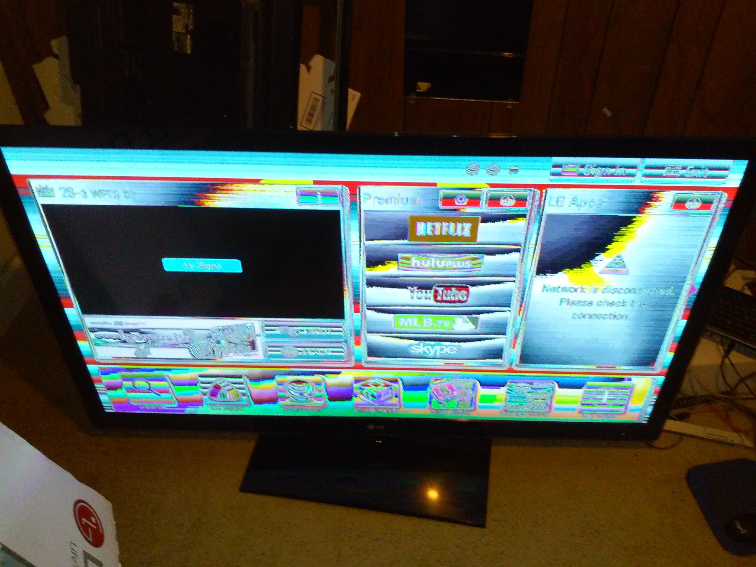

                  Here's a picture of the lines present on the display. T-con board still shows the same voltages as what were previously measured. Didn't slip with my probes or see sparks/smoke. Stumped on how this has happened.
                    I re-seated all the video ribbon cables lines still present. Absolutely no picture is displaying. I was extremely careful measuring the voltages. Never know though I could have caused a short somehow. Since the problem is now worse than it was it had to be my touch. lol
