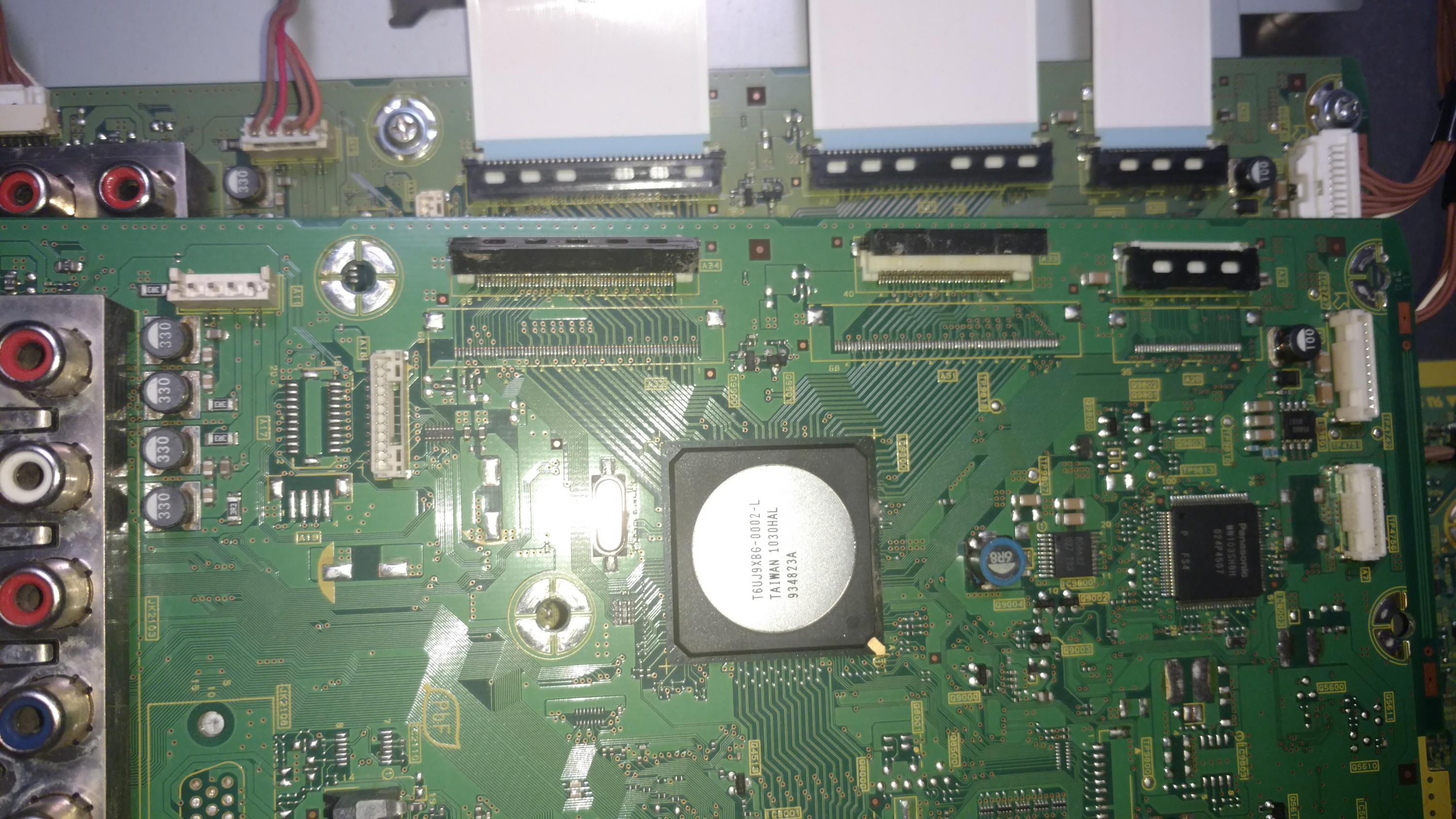

    Hoping there is still someone around that works on Plasma's and knows specifics about the 50S2... I bought one used with issues and want to replace the A board. Service manual says board model number is TXN/A1LQUUS. So, I look around and find a used pull from a working set(came from a TCP50C2 but said it was compatible). I get it home and the board is identical..., except for the ribbon cable mount. To of the three are a different size. My S2 are wider than the board I received. After looking on the internet, other companies are selling the same thing.
    https://www.tvpartstoday.com/TXN-A1L...sh-a1lquus.htm
    What gives? If i can attach a picture of my board I will but would anyone know the issue here? Did they make two different boards for the same model year? Thanks in advance for any help!

    It is likely the board would work "electronically" but the cables are different, Your model has the connectors mounted on the other positions that are available when it was manufactured to be used with a different main and cables
    So main board and ribbons would also need to be replaced
