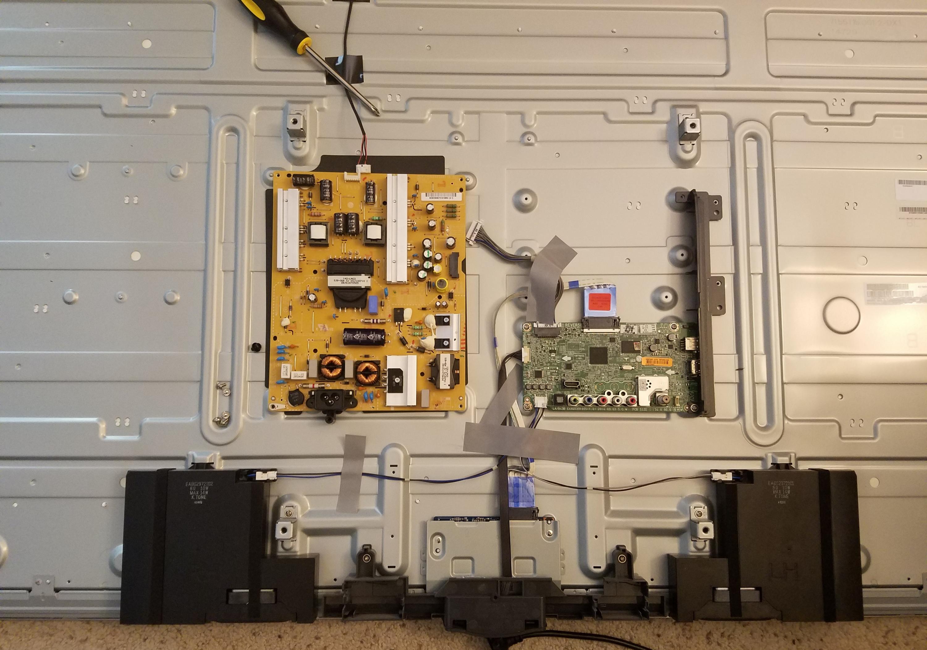

    Hi folks,

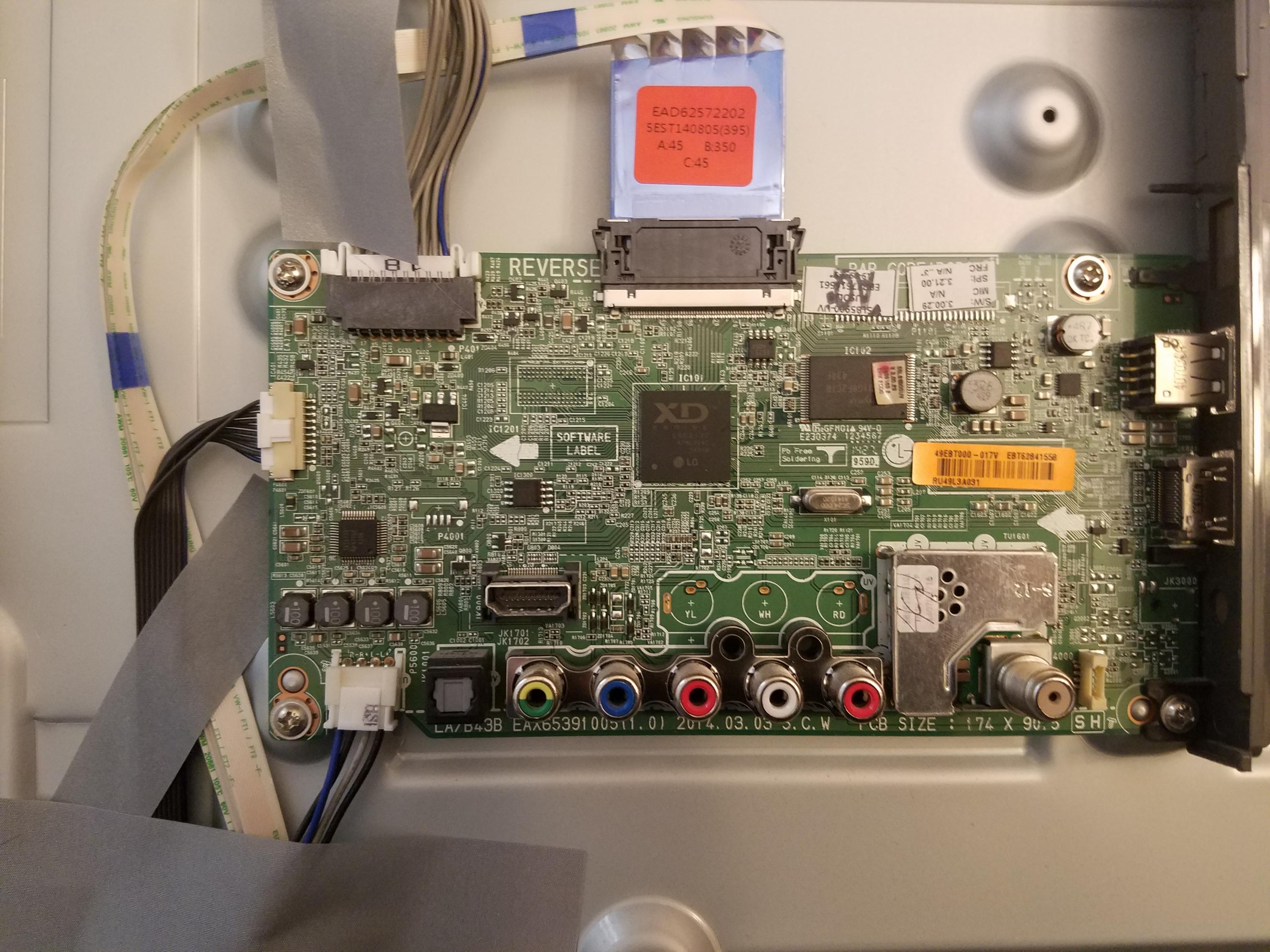

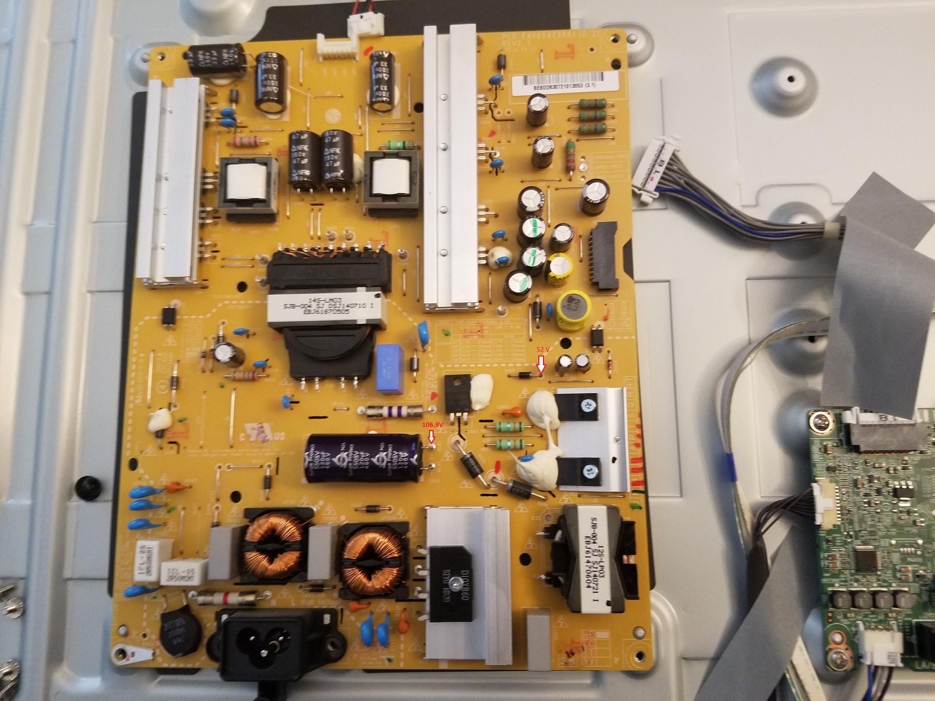

    Got this LG 55LB5900 TV that's totally dead. I thought backlight as always, but no display with flashlight.
    Took it apart and everything seems in order, visibly, no Power to the main board it seems. Can someone help me identify which is the Standby voltage on the connector? The power supply connector is labeled as shown in images, however no Standby. Is the PWR_ON or DRY_ON it? it's a 2-row connector so tricky to measure the DRY_ON, but PWR_ON has nothing.

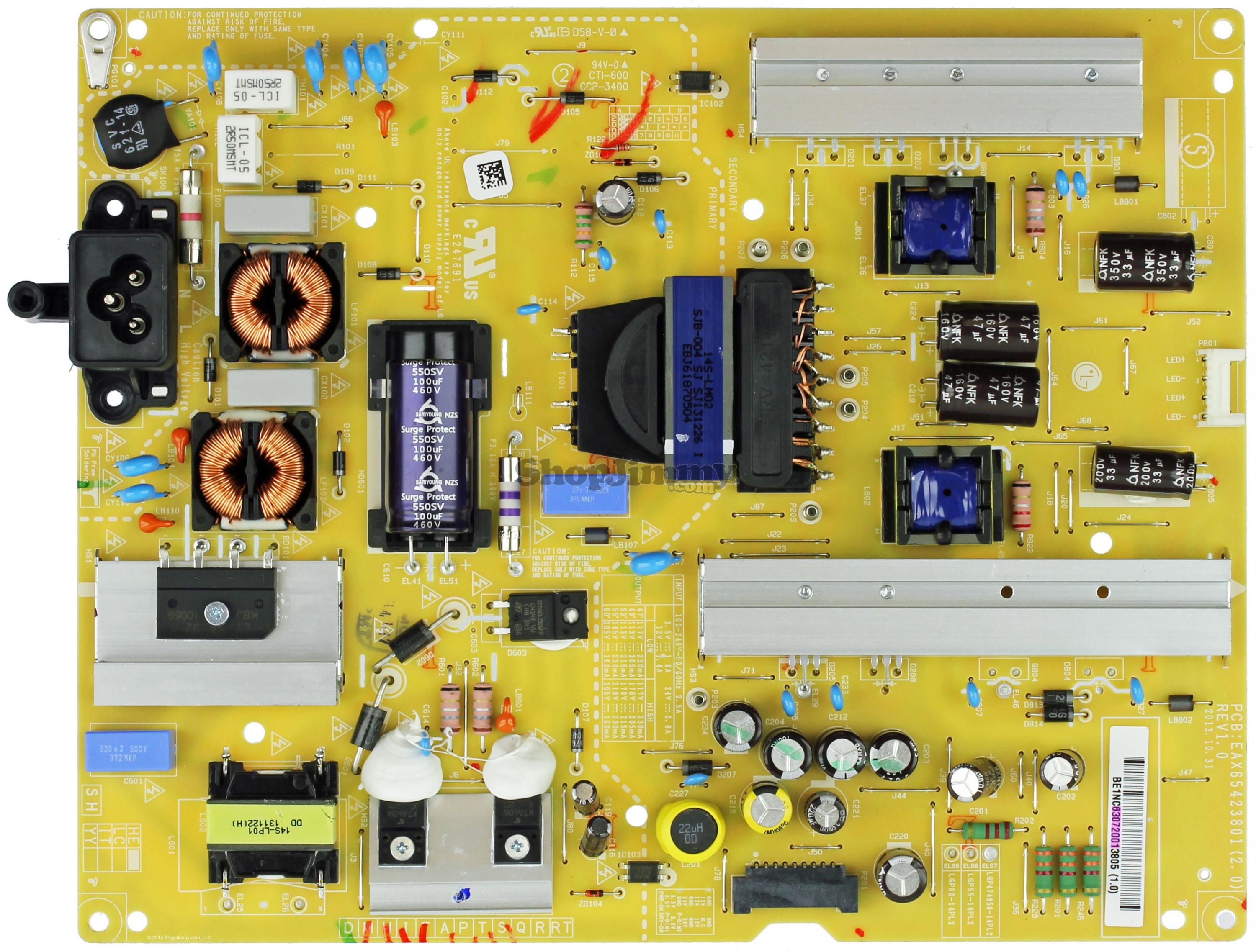

    Anyone has a schematic for this power supply, assuming it's what's bad?

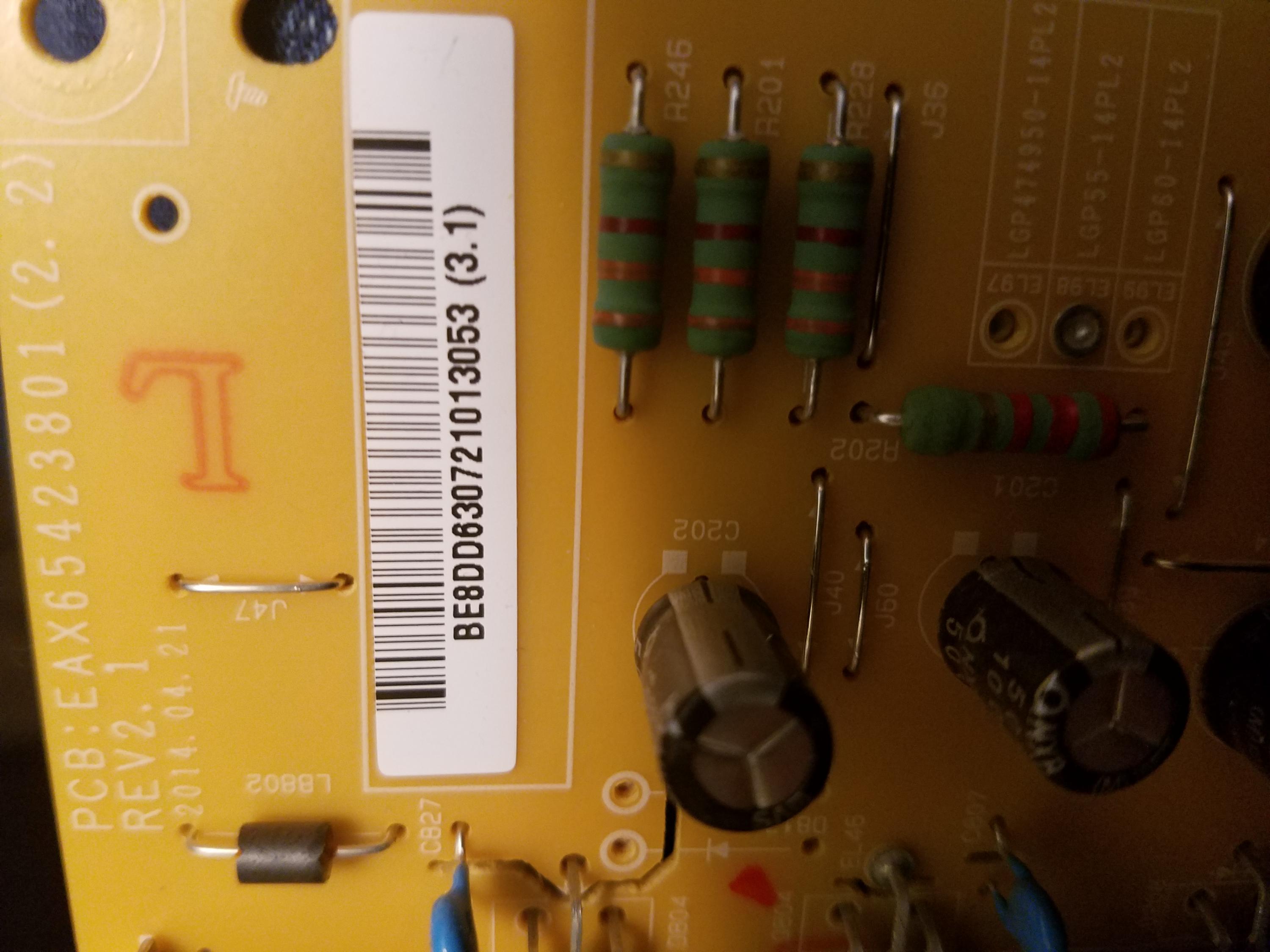

    Power supply board is EAX65423801 63072101

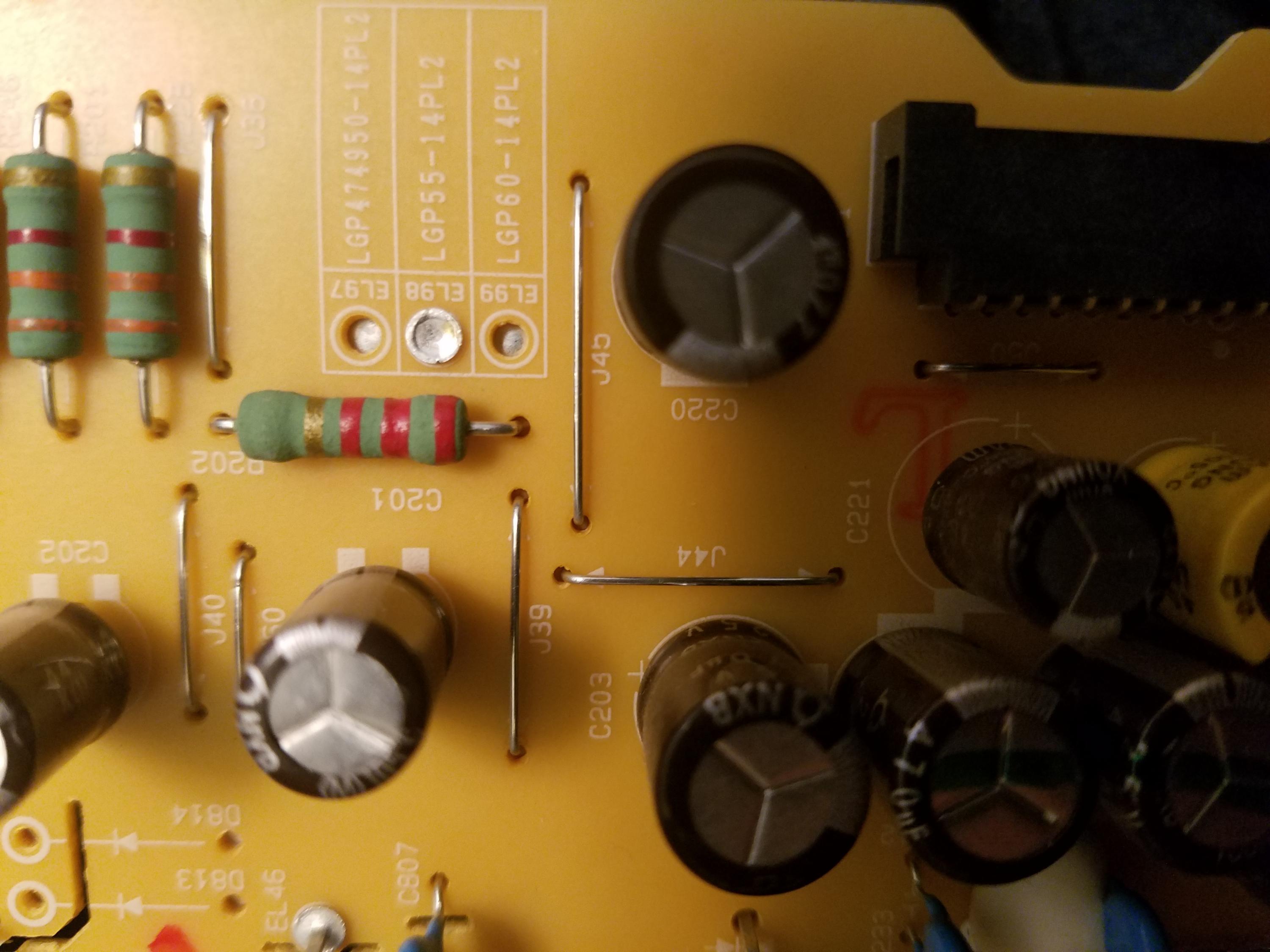

    Measured the ceramic resistors and rectangular caps that I've seen go out in the past, and they check out. Checked all Transistors and Diodes, and none seem shorted. Fuses are ok on the power board. Any help is appreciated.
    Thank you

  • vinceroger69
    • Mar 2012
    • 6714
    • uk
    Re: LG 55LB5900 Totally Dead!
    what voltage do you get across the large capacitor laid on its side on the hot side of the psu
    • jason123
      • Oct 2015
      • 1068
      106.9 v

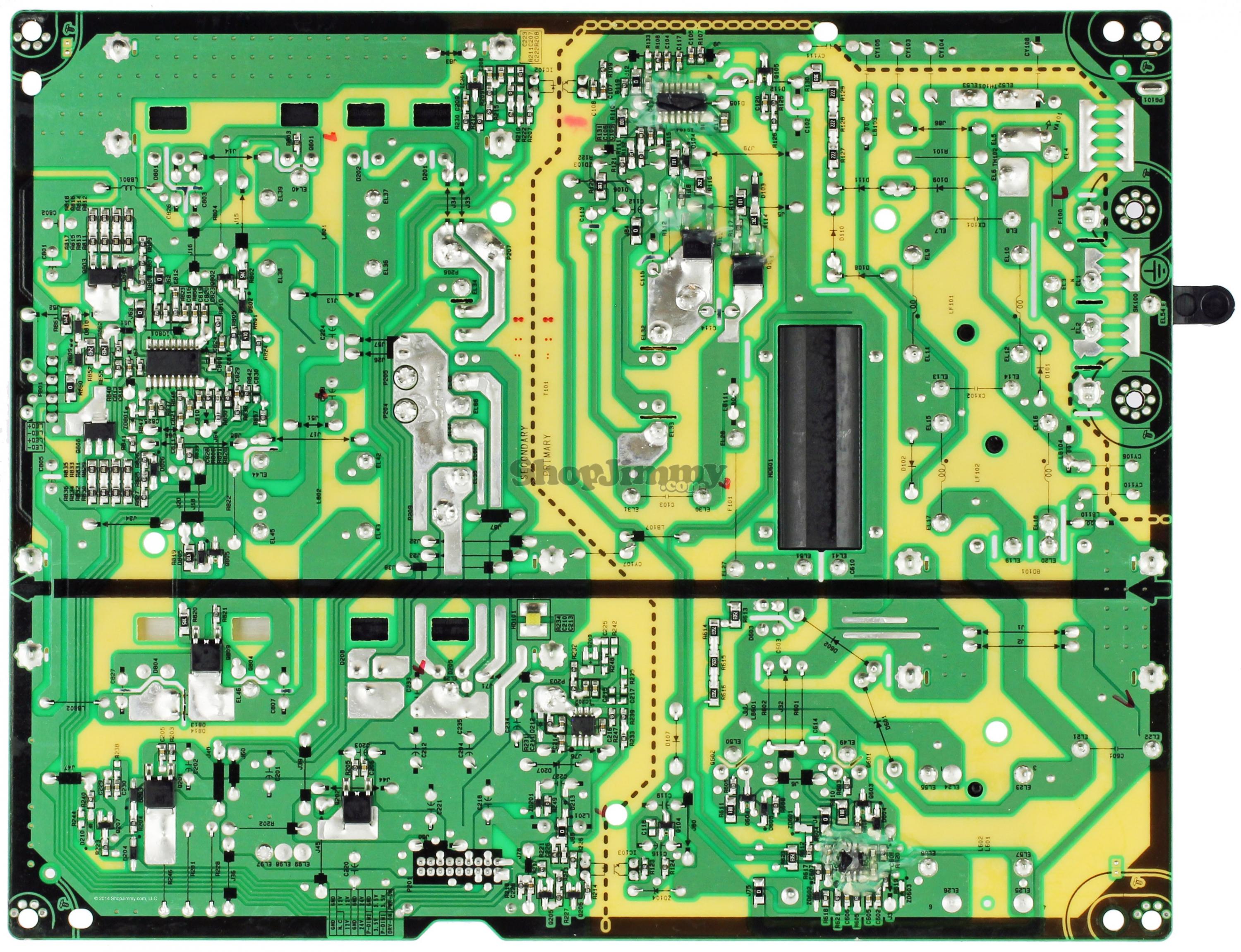

                          You can test the power supply board by itself without having connecting to other board.
                          Put Black probe of the dcV meter on the negative leg of the main filter cap C610, then use the red probe on each end of the fuse F101 to see if you do have about 160Vdc on each end of the fuse with ref. to the negative leg of C610.
                          Pictures provided by shopjimmy.

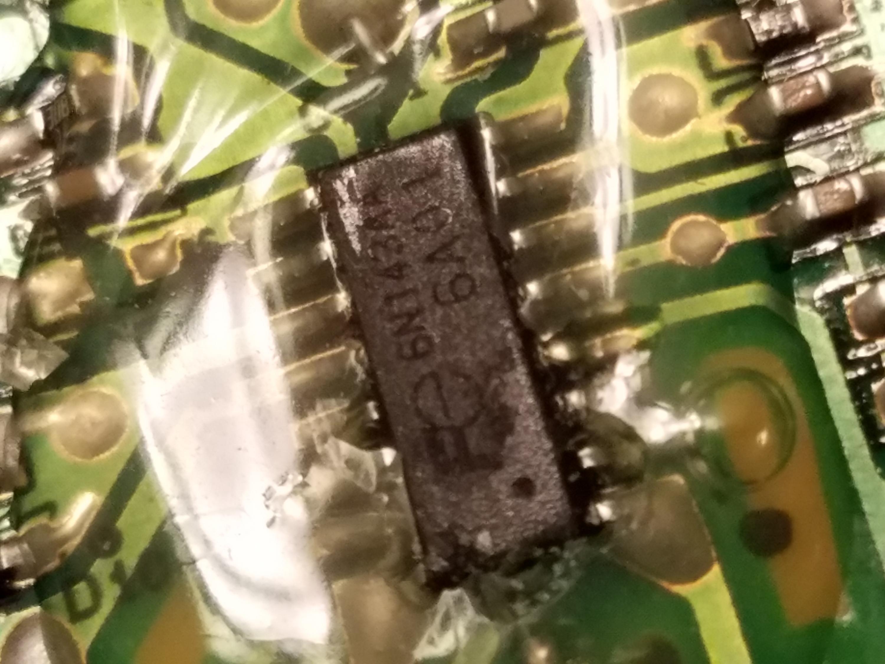

                              You need to get the P/N of that 16-pin SMD SMPS IC in the hot side to find out if it has VCC for it to run or not.

                                Originally posted by budm
                                you need to get the p/n of that 16-pin smd smps ic in the hot side to find out if it has vcc for it to run or not.
                                +110
                                • jason123
                                  • Oct 2015
                                  • 1068
                                  The IC has "Fe" as marking, then number 6N143AA then 6A01
                                  Assuming part number is 6N143AA.. I can't seem to find any datasheet on it.
                                  Pin 8 has 52V, Pin 7, 5 and a couple others have 51.x V
                                  Pin 9 through 16 have no voltage (few mV on some)
                                      FUJI: FA6A01
                                      https://cdn.badcaps-static.com/pdfs/...dc74a503b7.pdf
                                      Based on your Voltage reading: it looks like you use the wrong GND for your meter, you are making Voltage measurement in the hot side so you cannot use the chassis GND for your meter, you need to use negative leg of the main filter cap as you gnd point for the hot side of the circuit.
                                      You need to report Voltage readings of all the pins, except GND pin.
