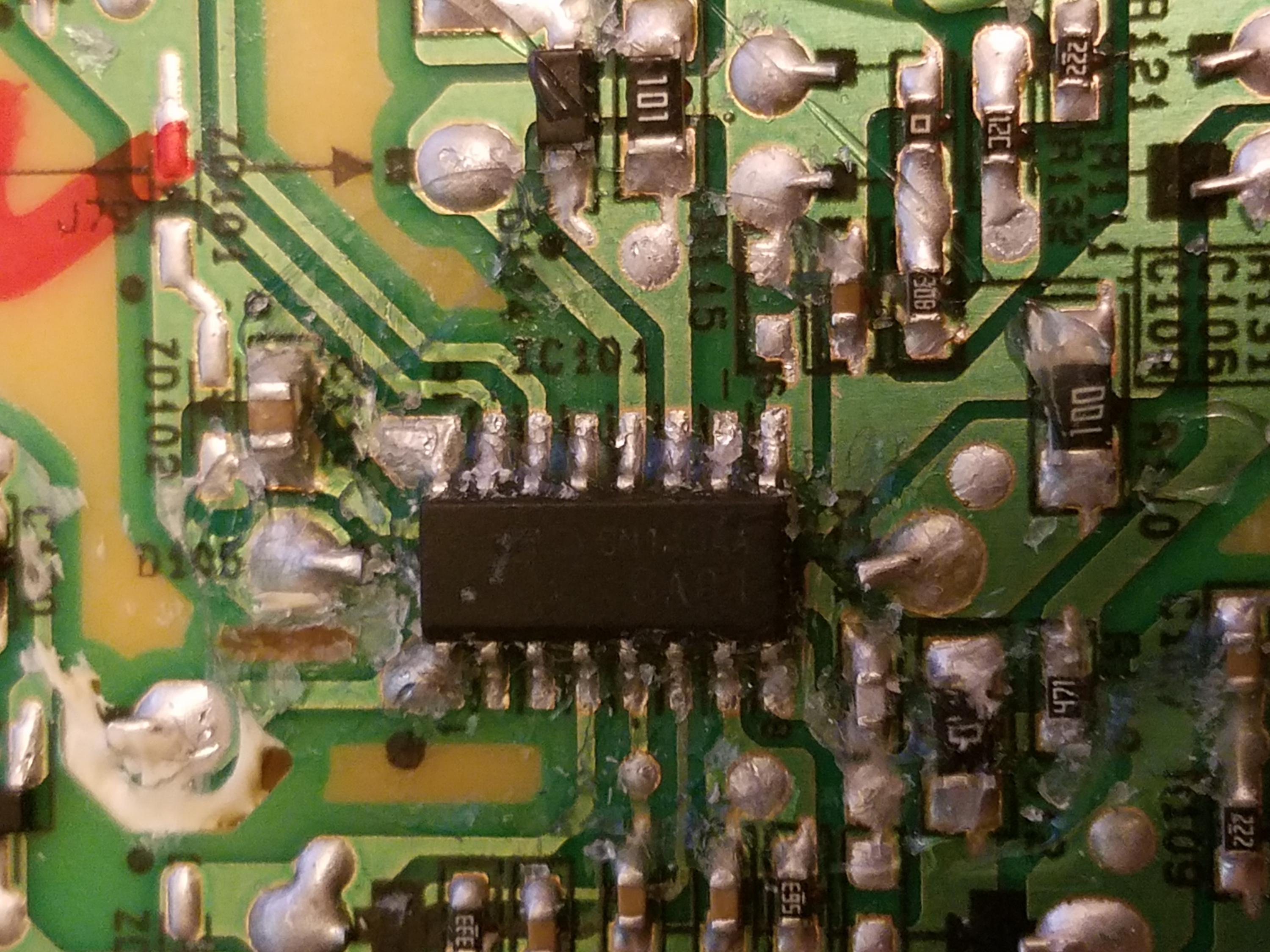

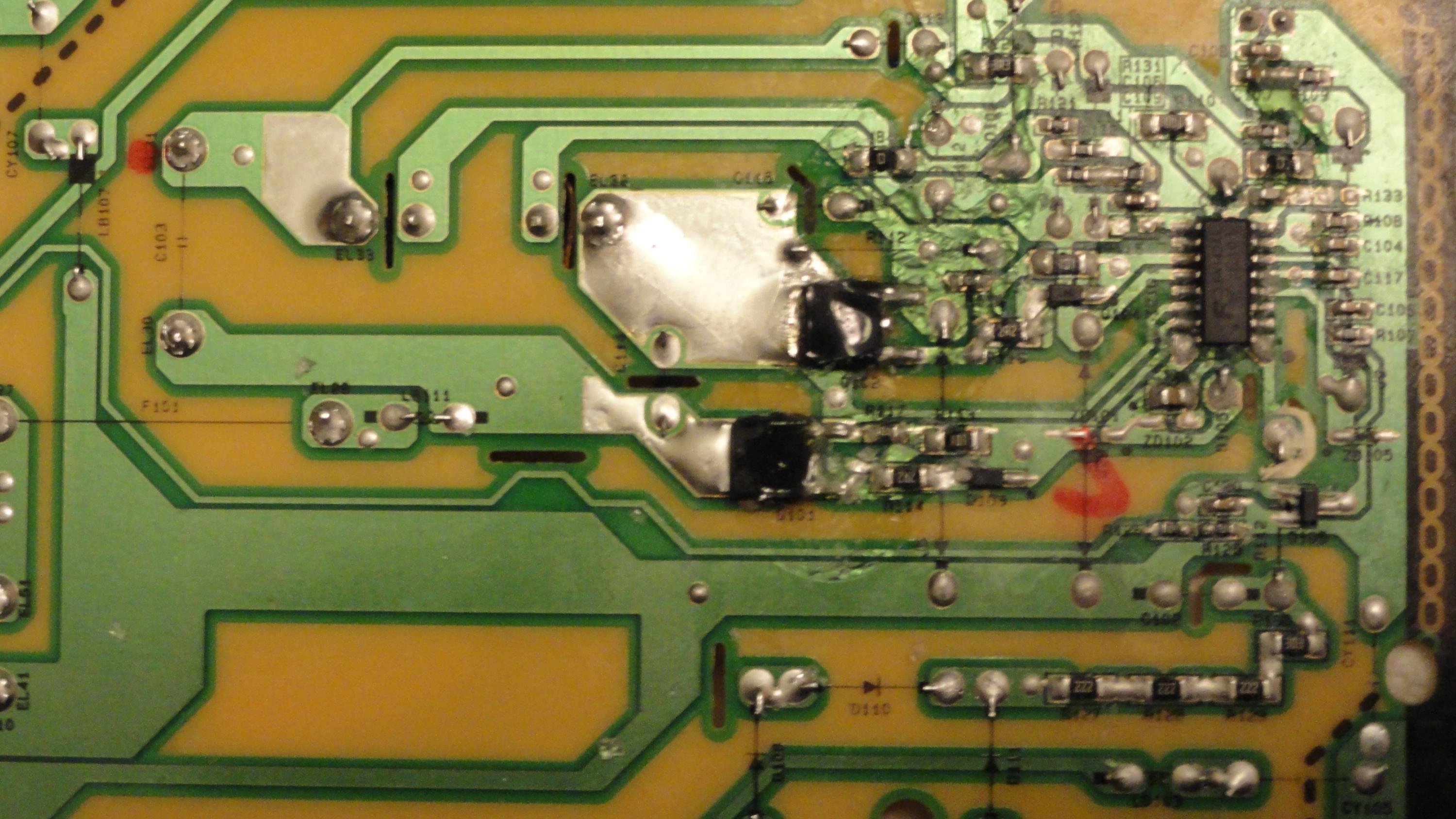

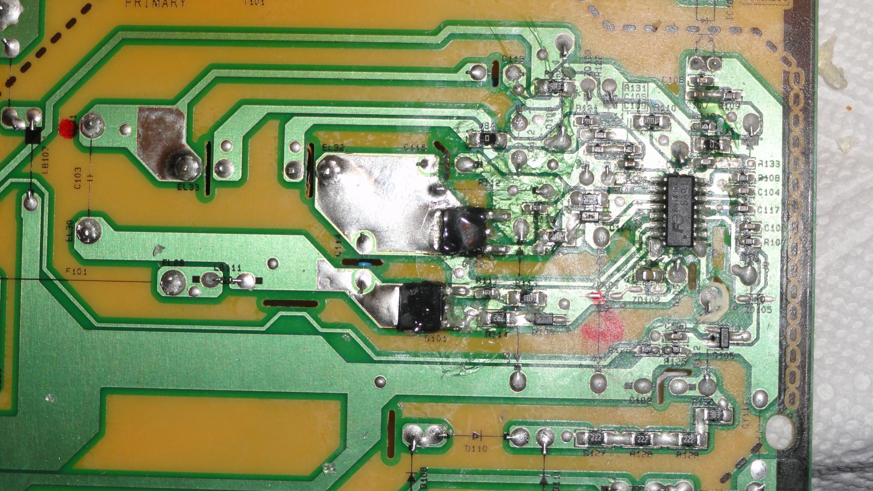

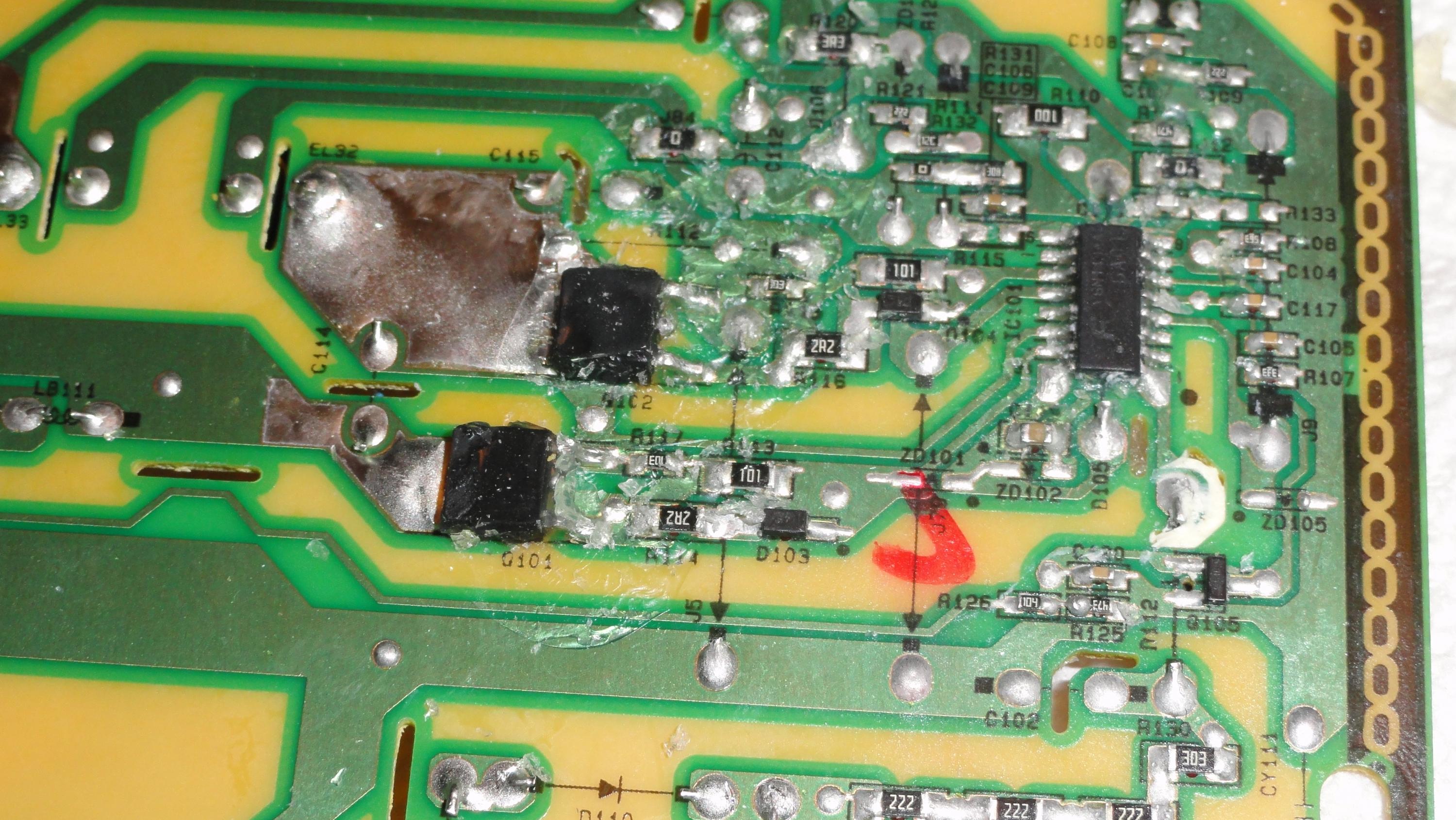

If you look at the application circuit:
1) Try to locate the string of resistors connected to VH (pin 1) to see what resistance they are.
2) Check the resistance between VCC (pin 10) and GND to see what it is.
