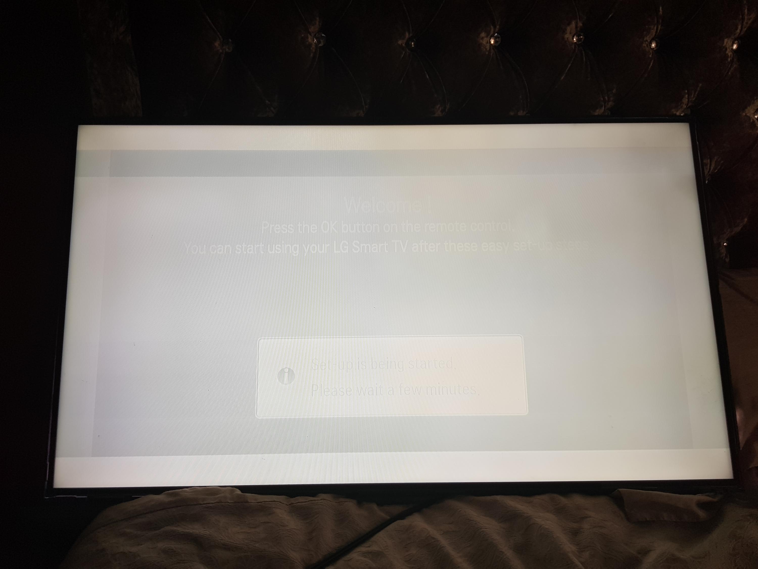

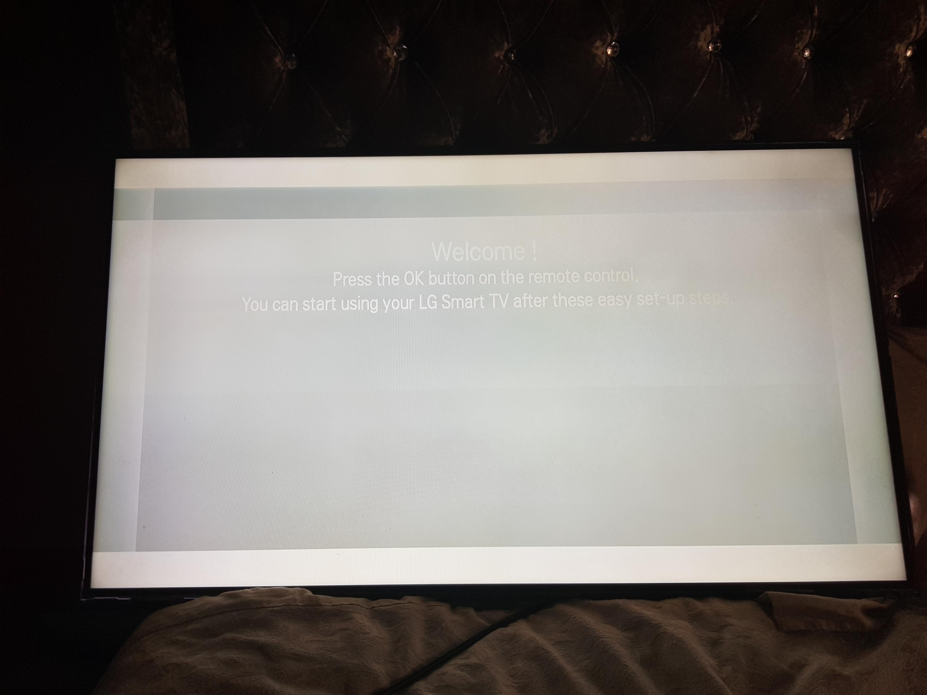

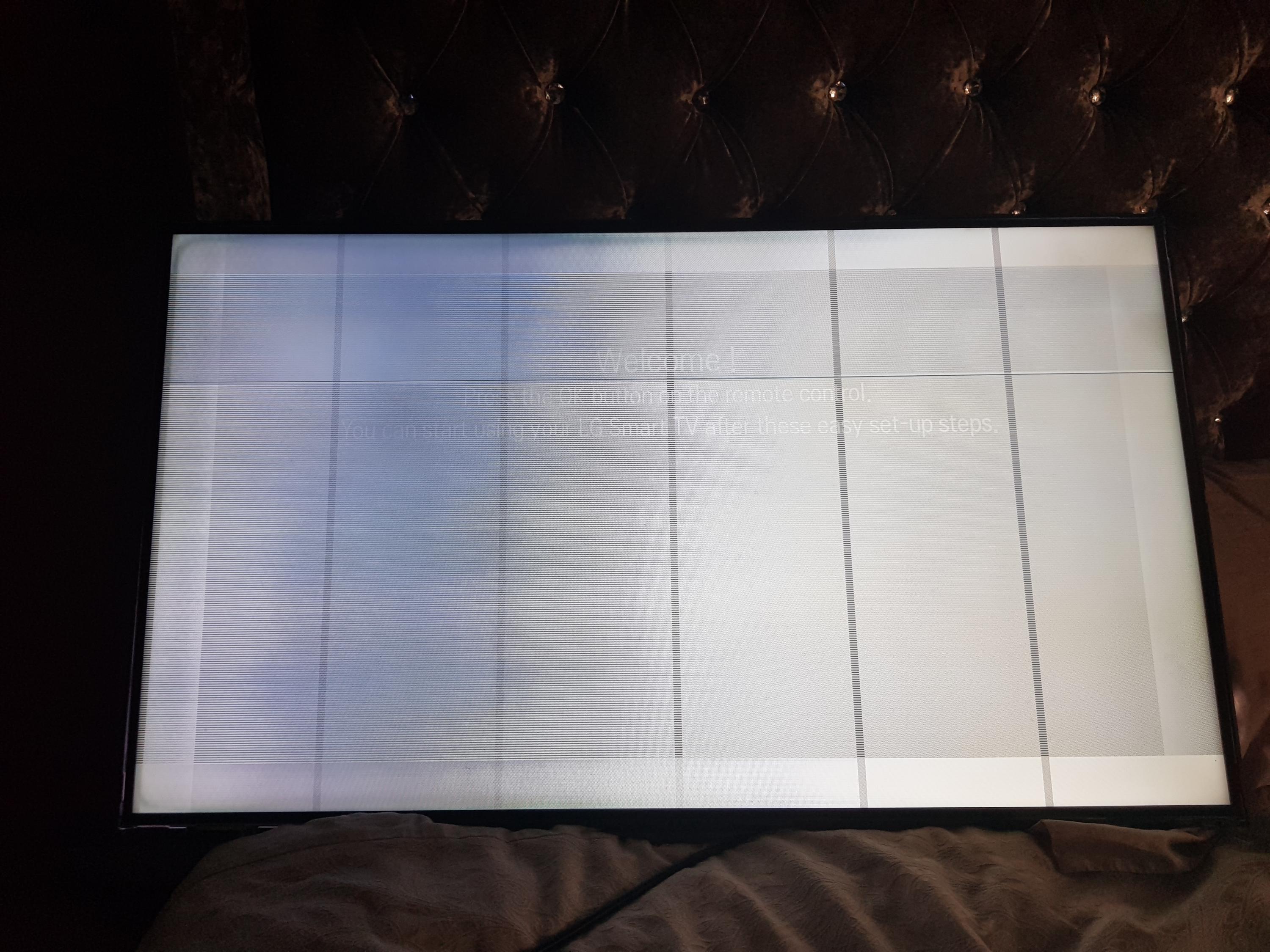

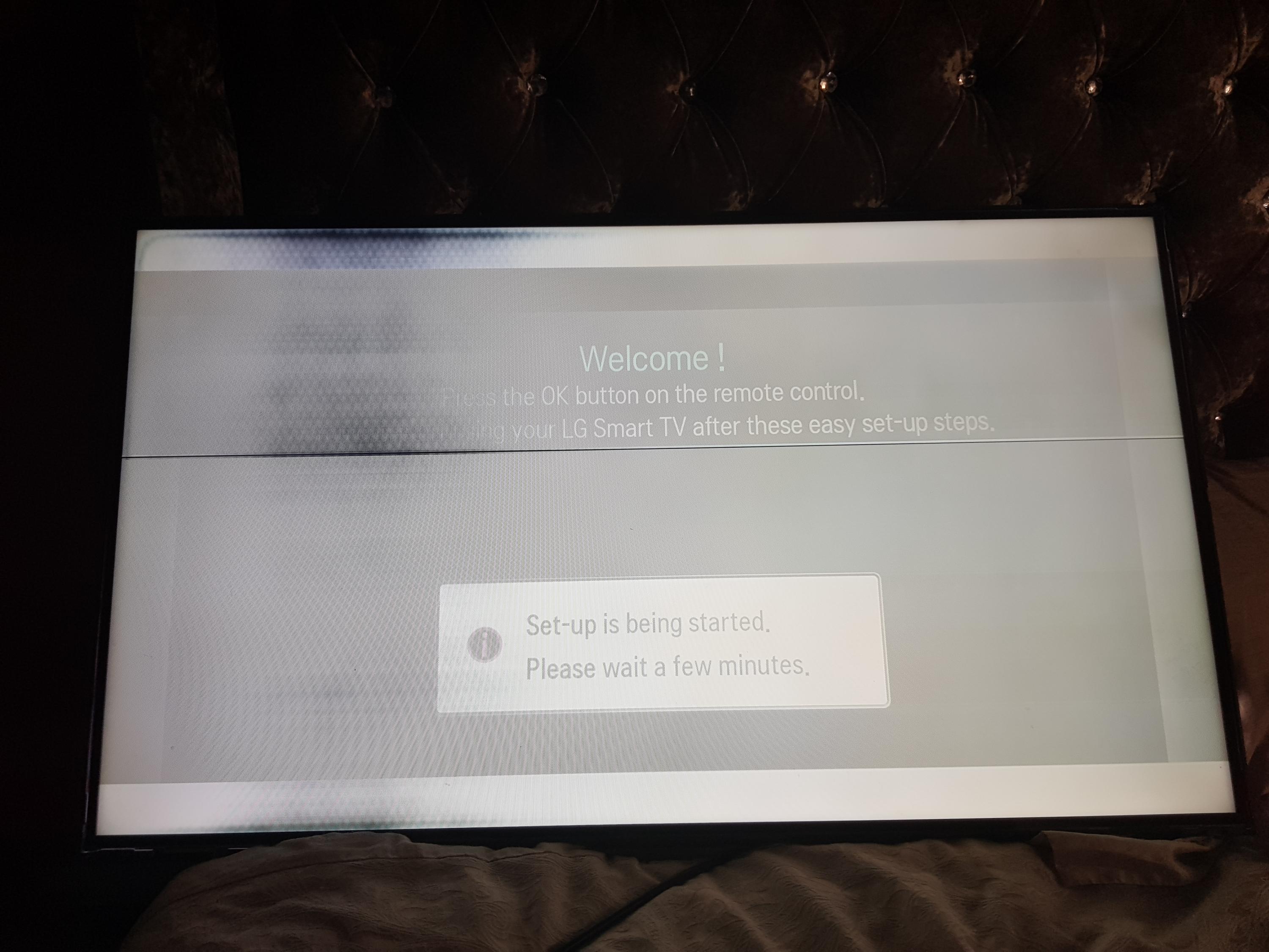

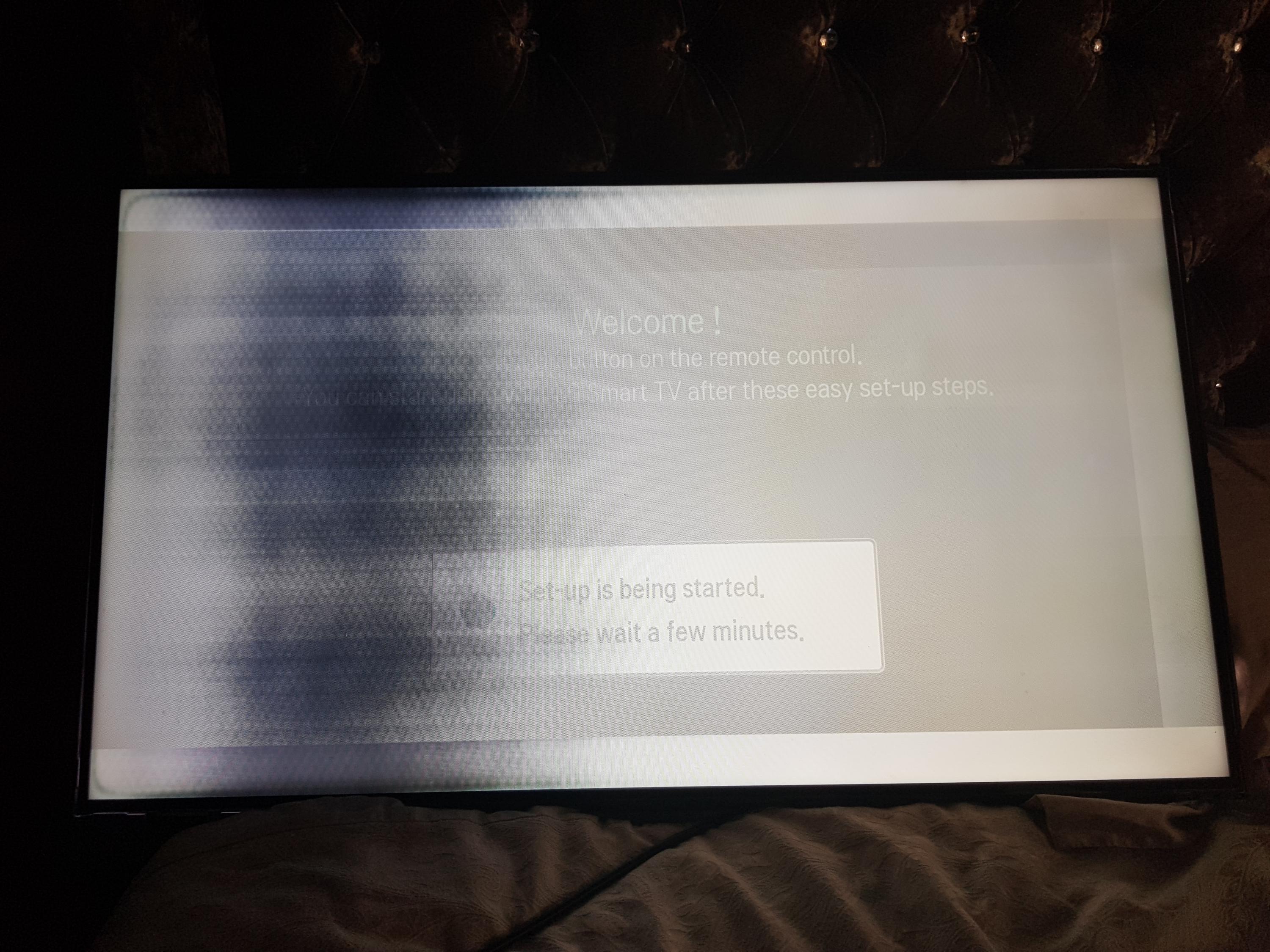

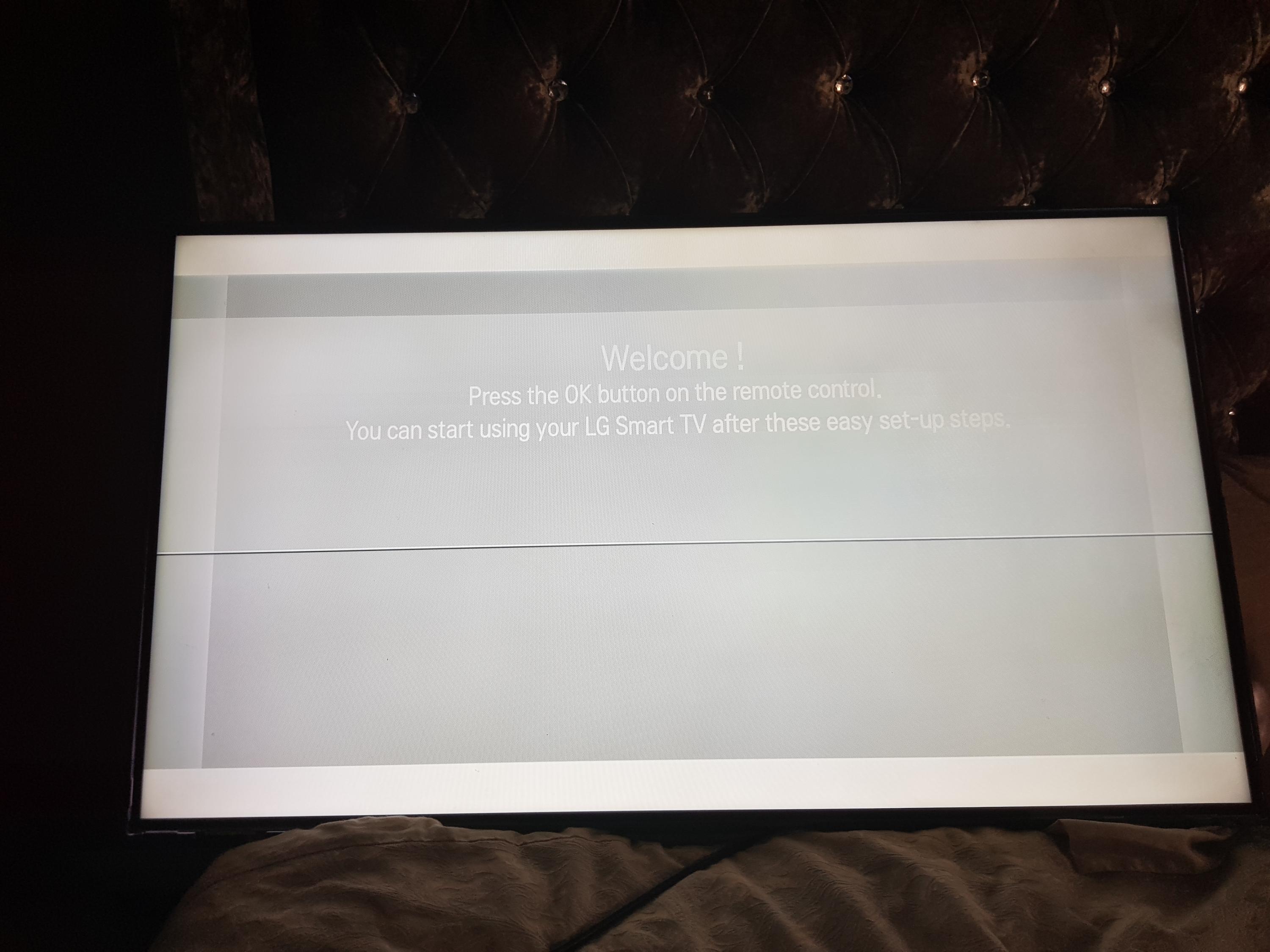

    Hi, I have an LG 42LA620V had a backlight issue, when powered on the logo flashed up briefly then screen goes off, sound present. So replaced the LED strips at fault, backlights come on as they should, so put it all back together, and now it has another fault! When turn it on now screen lights up but ..... pics attached

    Have you put the various panel layers back in the correct order and way round?

      Re: LG 42LA620V another problem now
      Theyre deffinately in the correct order, as I taped the corners together before lifting them out, however they were out a while so I wonder if they the right way round now lol, the thickest rigid one is on the bottom if I remember correctly

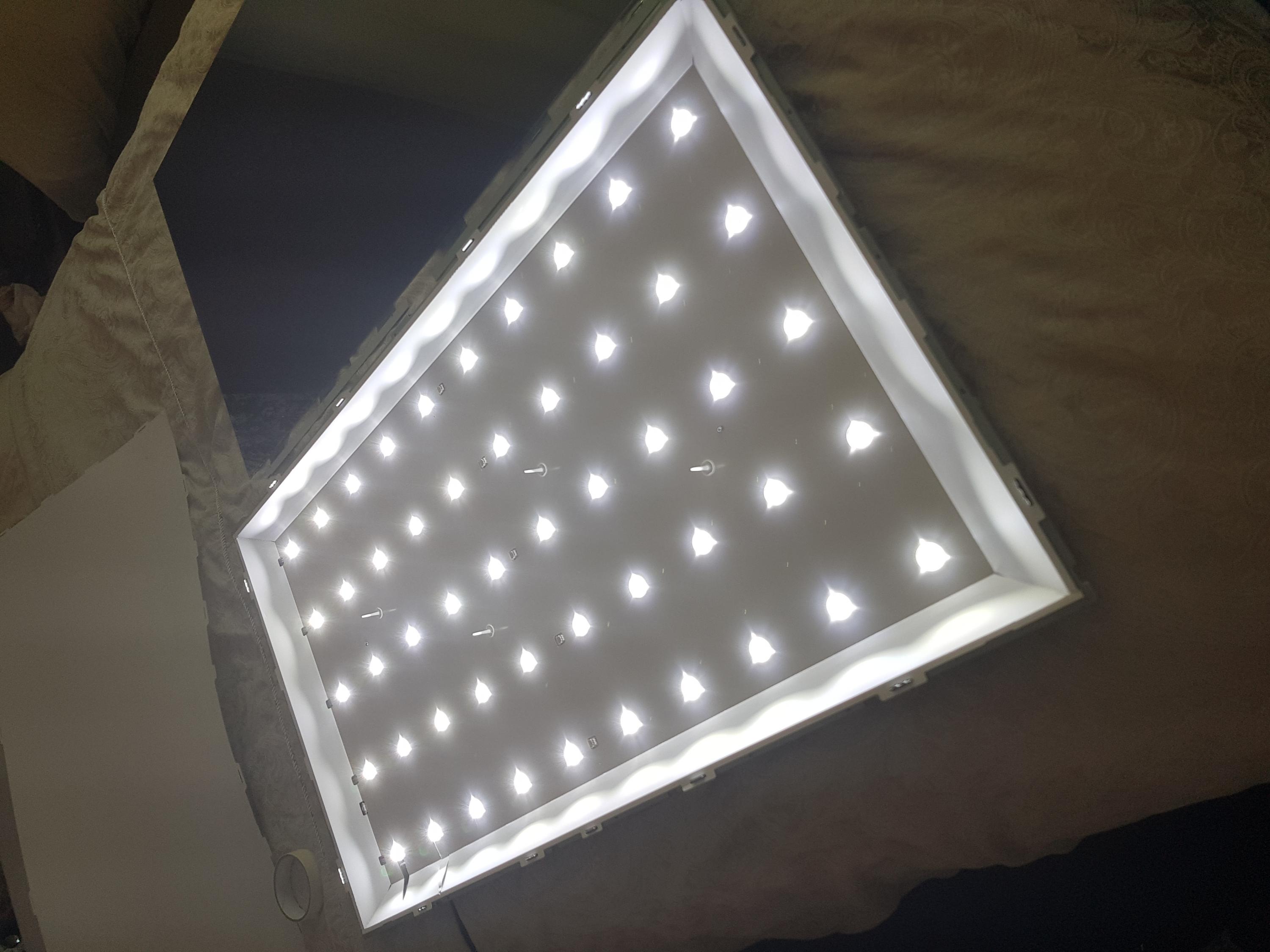

        The pictures look like backlight LED failure but you did change them all out right? Check the sheeting again
          when you change inputs, volume, channel, menu etc. does the image change quickly, crisply. ignoring the colour issue that is.
            Theres pic of backlights without the screen in
              Ive done a factory reset to see if that would rectify, so only screen that comes up is the 1st setup screen, I cant change between inputs
                interesting. since you have no inputs, the main board would most likely be the issue.
                i was actually concerned as to if you may of damaged the panel during your previous repair attempt. hoping it isn't multiple issues.
                  I probably can select inputs if I go through the setup, ill have a look when im home later, taking an engine out of an Insignia atm :/
                    tcon board? it looks like a pattern overlaying the signal Ive seen that on a few samsungs. do the dark patches expand and move or is that a photo artefact.
                      https://www.badcaps.net/forum/attach...0&d=1530822670
                      It looks like damaged panel.
                        Its hard to show exactly what its like with pics, is there anyway I can upload a video?
                          Upload to Youtube and give the link here.
                            one time friend of me tried to change defect LED on same brand 55LA6208, before he replace the LED he told that LG Logo flashing at first start complete with color too, and after he replaced was the issue much like to you.. the first things i went to check for him the ribbon cable, and exact was one the pins Brocken and make short contact. this old TV because of heat the ribbon cable pins easy getting out from its place. also check them under magnifier from both sides
