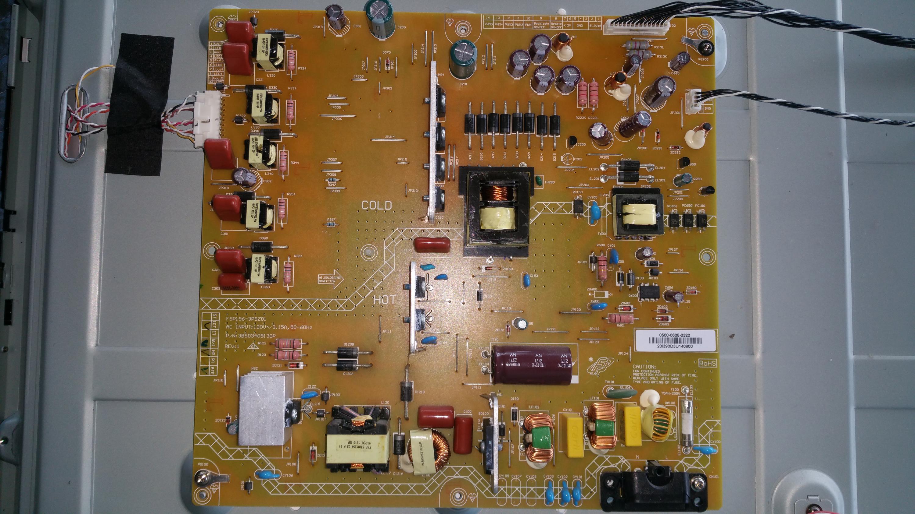

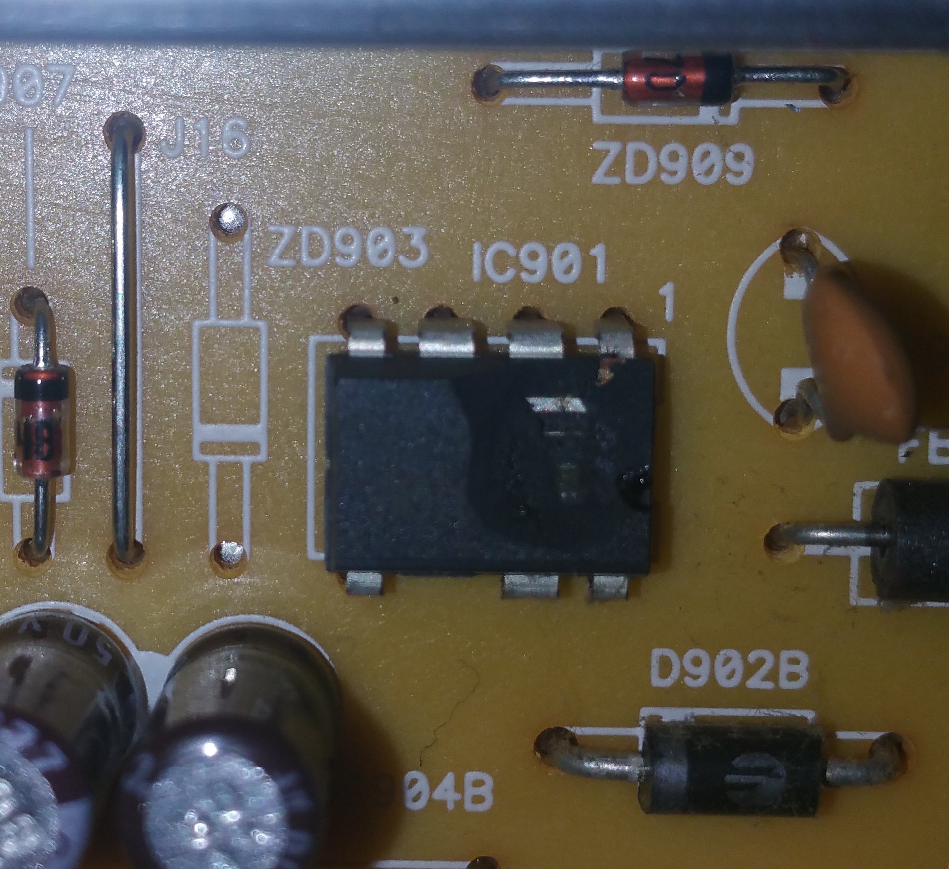

    Got in a Vizio Smart... Dead as a doornail.. Fuse checks out..
    Inspection of power board shows this problem..
    Any idea what that chip might be?? IC901???

    Re: Identify The Chip??? Vizio E480i-B2
    Ld7913 , R915 is likely open as well
      Like this??
      https://www.ebay.com/itm/5PCS-LD7913...gAAOSwJwpajh~N
      • R_J
        • Jun 2012
        • 9624
        Looks like it, LD7913JGM6 there are some sellers selling for less
              Its not a voltage regulator ic, it is a pwm controller, here is the datasheet

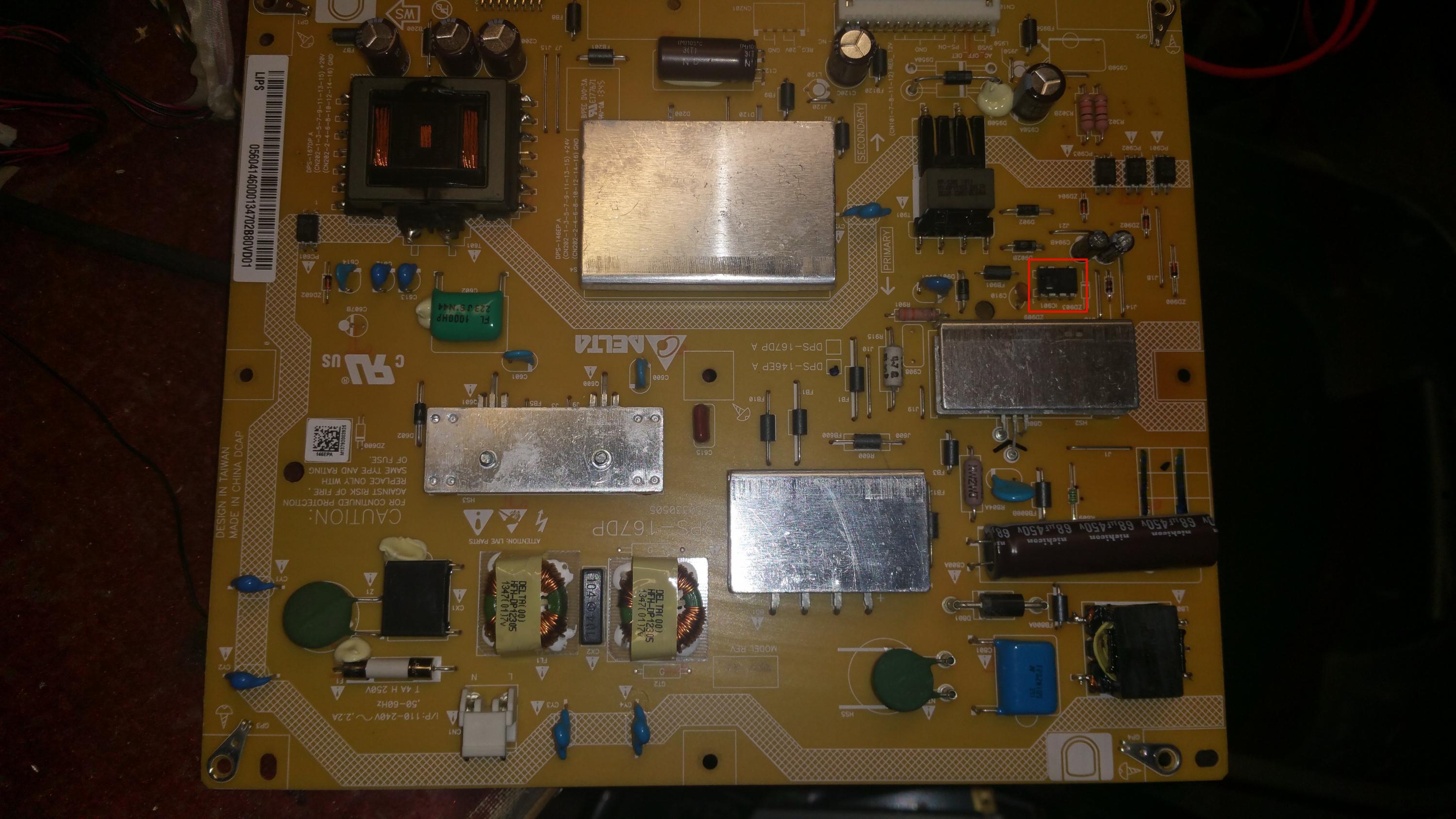

                Followup on this, as I just got another Vizio in with the exact same problem..
                Replaced the IC but still dead as a doornail..
                RJ, you mentioned R915... Could you elaborate??
                  does r915 test ok? 4.7 ohm i think maybe its a fusible resistor that feeds that ic?
                      i can see it in post one i guess that isnt your board i cant see it fitted in post 10 picture of the psu

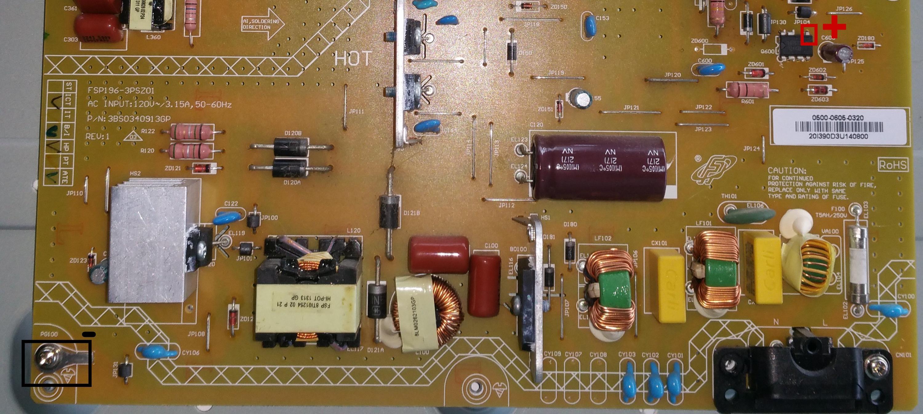

                                      1) What did you use for GND ref. for the meter?
                                      2) Which board are you working on, the one on post 1 or post 10?
                                      3) If it is the board is post 10, then check the Source resistor R601 to make sure it still show <1 Ohm.
                                      • Michale32086
                                        • Nov 2011
                                        • 1453
                                        See Pic
                                        Post #10...
                                        Probably should start a new thread, eh??
