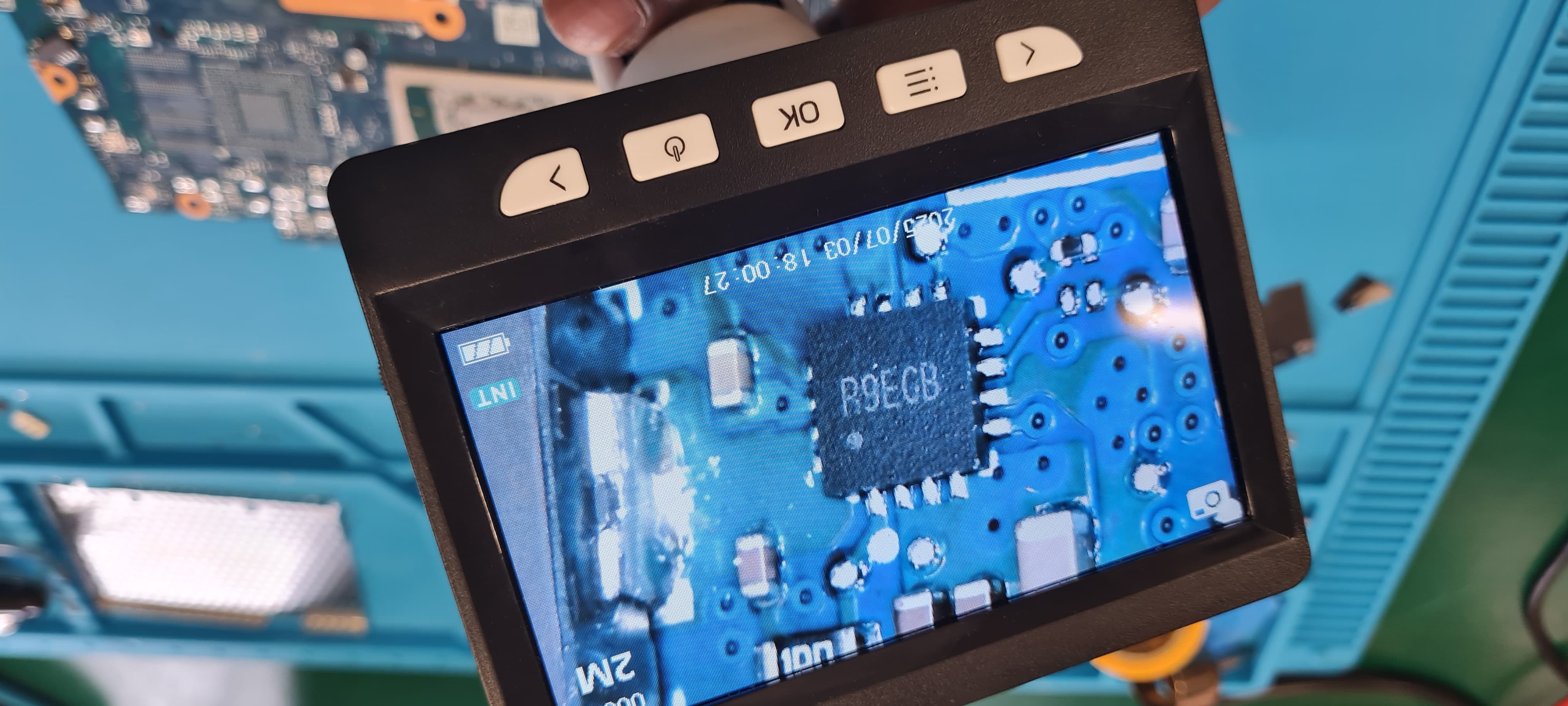

    Hi folks,
    Hope everyone's doing well.
    I have a HP ProBook 450 G9 came in for repair. This driver is shorted and im looking to buy a replacement. But i cant identify this chip.
    I checked our BadCaps sticky on following site
    https://www.badcaps.net/forum/troubl...and-datasheets
    But the name of the chip is wrong. I checked based on GND on chip.
    If you check on above link, you'll think this chip is SY8388ARHC, but if you search for it on the web, you'll see a different chip.
    Any help is appreciated.
    I love you all,
    I love this site
    Make HP ProBook
    Model 450 G9
    ProdID 6W856PA#ABJ
    SN# 5CD2257NJD
    • 22180
    That was a mistake in the list .Now it`s ok R9*** SY8388B3RHC N/D (NM-C771)

      Here is the datasheet for silergy SY8388B3 with top mark R9xyz
        Hi SMDFlea,
        You're the man.
        Thanks a million.
