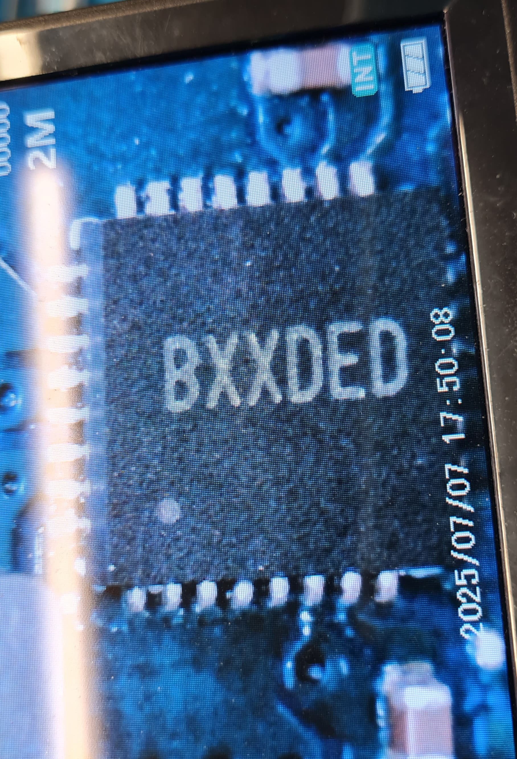

    Hi folks,
    Could someone help me identify this chip please.
    It was found in HP OMEN Gaming laptop.
    Chip marking BXXDED
    HP OMEN 16-c0161AX
    SN 5CD215BDKJ
    ProdID 4ROOOPA#ABJ
    I checked our chip identification link on BadCaps, but no help.
    Any help is appreciated.

    BXX*** SY9329CQFC
    Datasheet

        Originally posted by m1ch43lzm
        BXX*** SY9329CQFC
        Datasheet
        Michael, You're the man.
        Bulls eye bud.
        Thanks a million
