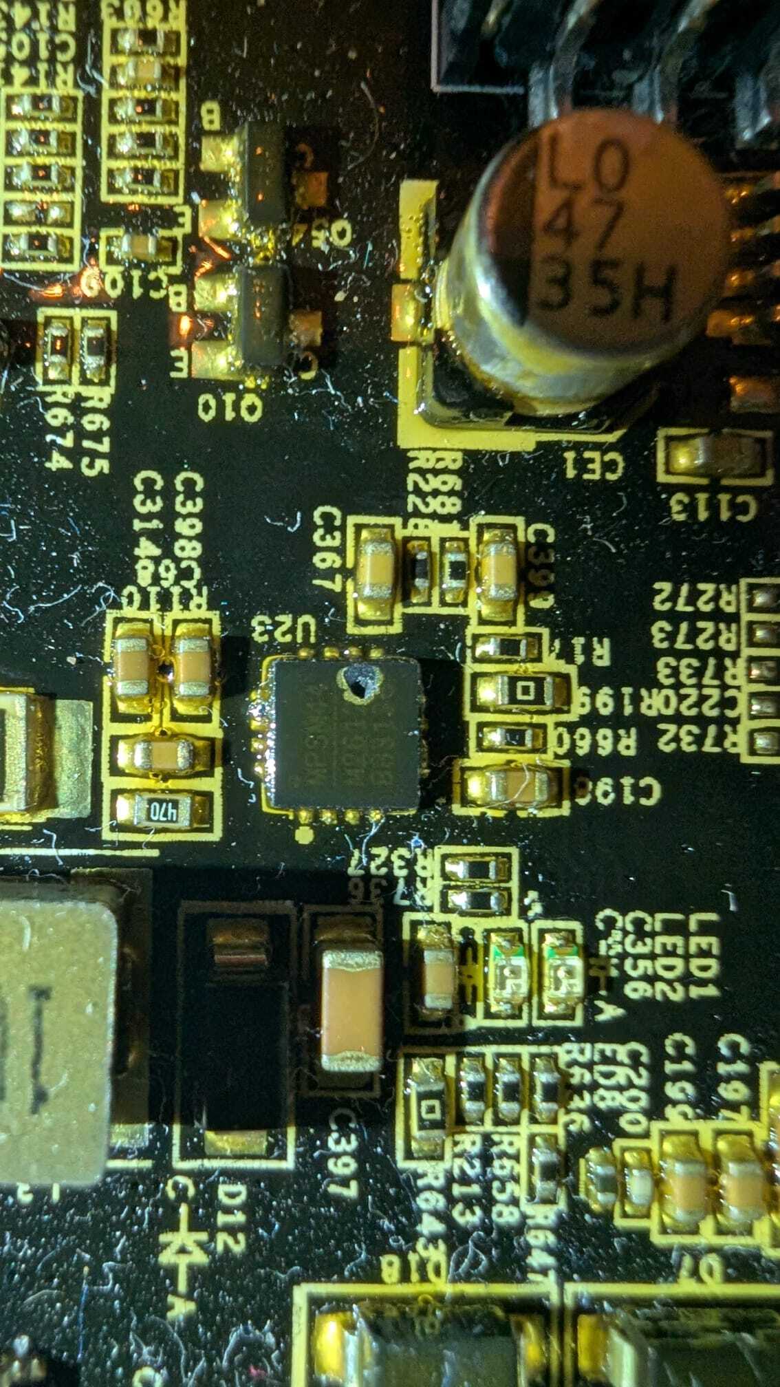

    I have a robot vacuum cleaner here.
    An Eufy Robovac L70 Hybrid.
    A chip has burst due to a short circuit.
    The following is legible on the chip:
    Mpsm44
    m2612
    883138
    I'm not sure if there is another number after m2612, as that's exactly where the hole is.
    Click image for larger version  Name:	Eufy-Chip.jpg Views:	47 Size:	264.2 KB ID:	3704402
    Can anyone help me identify what this component is?
    Unfortunately, I couldn't find anything.
    I also don't have any plans or board views of the board.

    Might be an MPS MP26123DR or MP26124, looks like the ic might depend on how many battery cells are in the unit

        It is a 4-cell battery pack.
        Then it is the MP26124.
        Thank you very much.
        I couldn't find it yesterday.
