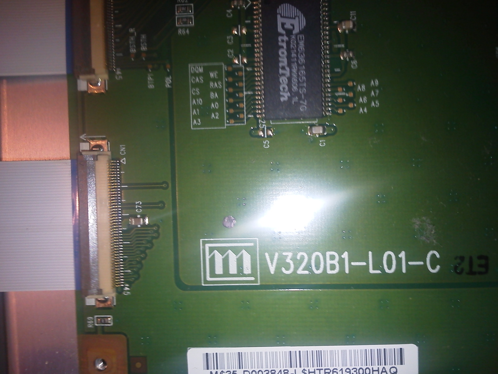

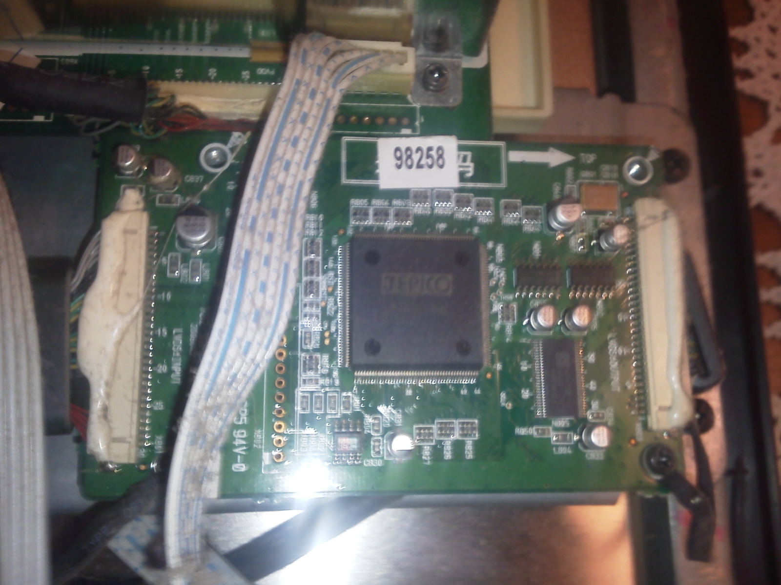

          • nosaj
            • Dec 2014
            • 44
            Re: Insignia NS-32lcd washed out colors
            Originally posted by neilc6
            AS15F failure on Tcon board. Post picture of your tcon to confirm.
            Here it is I believe.
            Thanks,
            Jason
              No that is not it. Please show the pictures of the whole back side of the TV showing all the boards.
              T-CON board will be under the metal shield.

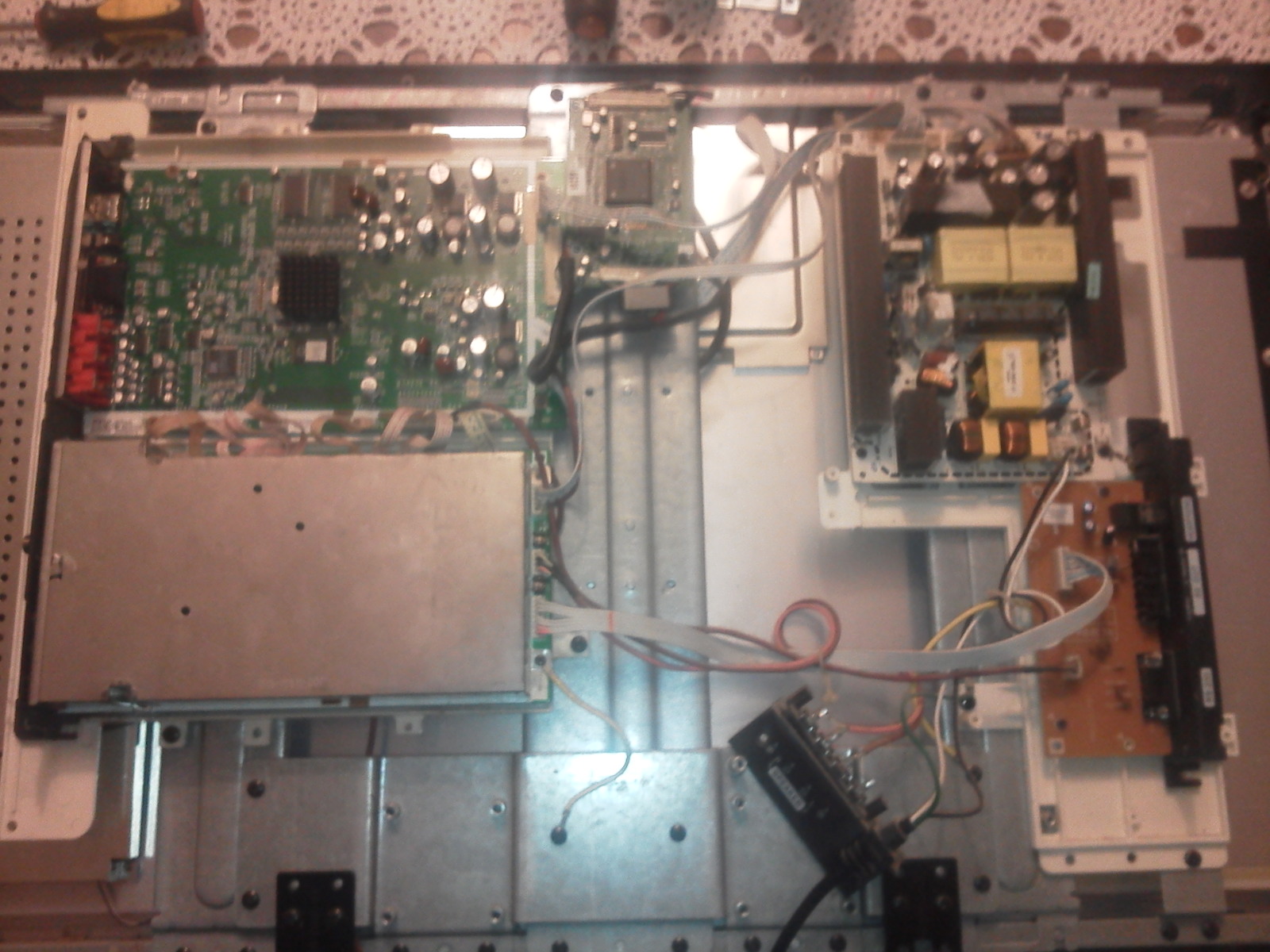

              • nosaj
                • Dec 2014
                • 44
                http://www.shopjimmy.com/catalogsear...gnia+NS-32lcd+
                So that would be the top left board?
                Jason
                  https://www.badcaps.net/forum/attach...8&d=1529195447
                  The LVDS cable on the right side of that board goes to the T-CON board which looks like under the metal cover that board is mounted to.
                  Big top left green board is the Main board.
                  Look at shopjimmy to see the board's names.
                  There are many version of this TV model.

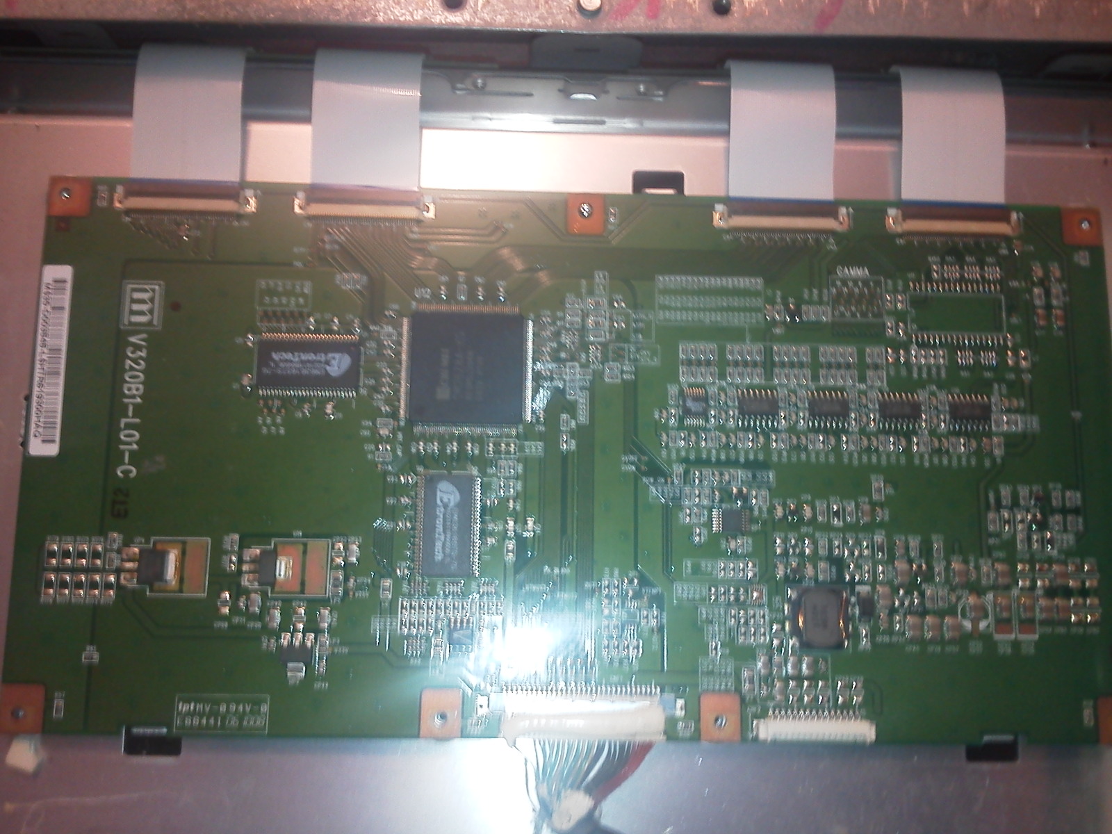

                  • nosaj
                    • Dec 2014
                    • 44
                    Here's pics included. Would this board work?
                    https://www.ebay.com/itm/Chimei-V320...-/190872683394
                    Thanks,
                    Jason
                          First one I linked was 5 dollars and change, why didn't you grab it?
                          At the time I hadn't uncovered the Tcon board and what you linked didn't look like anything I could see. Budm told me where it was and once I uncovered it , it was gone.
                          What is the difference between v320b1-l01-c(what I have)
                          and V320B1-C03(what you linked to)?
                          Thanks for your help,
                          Jason

                                Was wrong board.
                                • nomoresonys
                                  • Jan 2013
                                  • 12201
                                  • U.S.
                                  You need to look for the part number or substitute part number: Part Number: 35-D003848
                                  Substitute Parts: 35-D004737
                                  • nomoresonys
                                    • Jan 2013
                                    • 12201
                                    • U.S.
                                    Not all will work, a lot of them only have 2 ribbon cables, yours has 4.
                                        This should be a match: https://www.ebay.com/itm/Insignia-NS...oAAOSwWGxaz4rc
