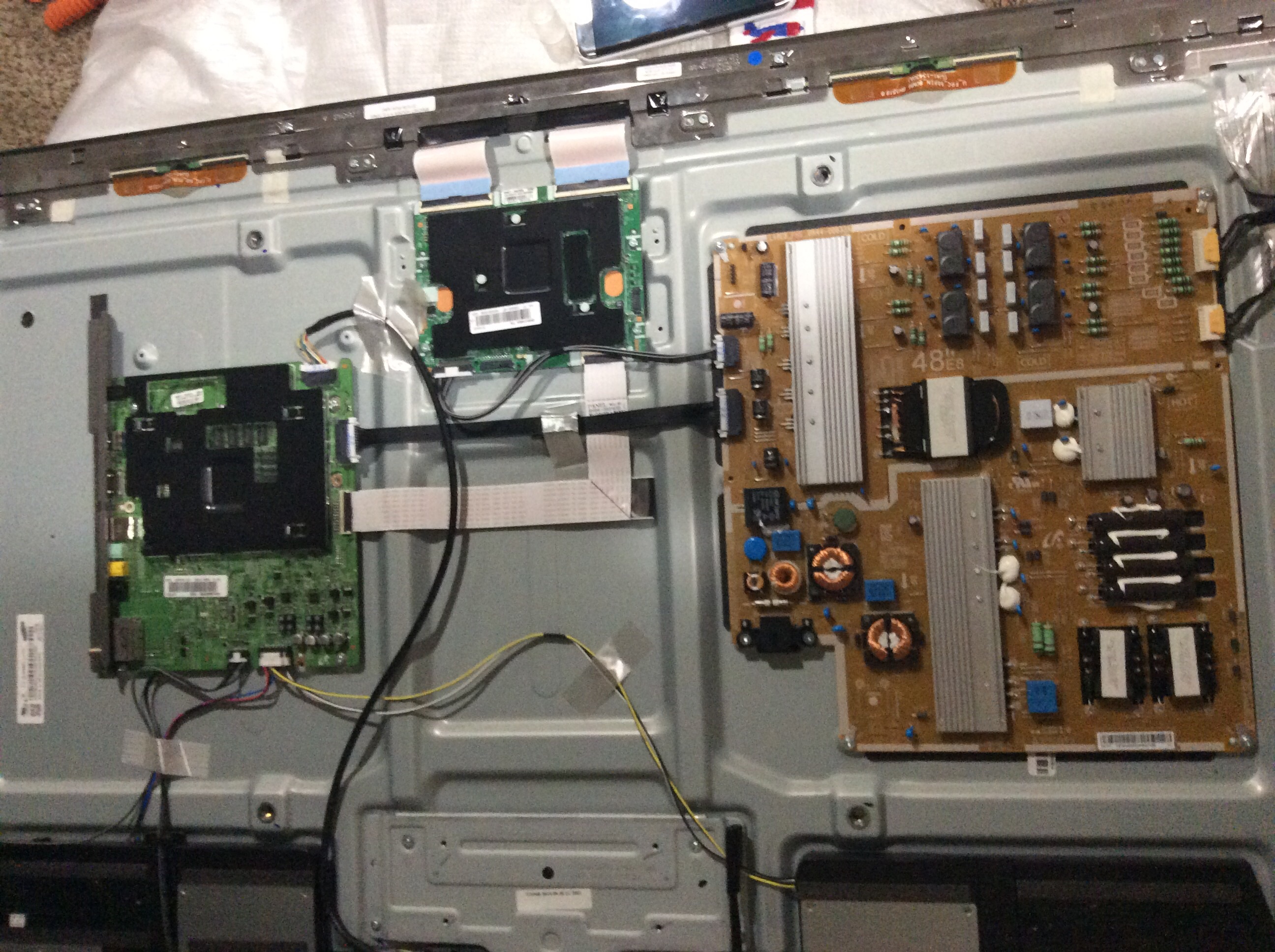

    For us to help we will need good clear pictures of the whole backside of the TV showing all the boards, and the straight shot pictures of the whole top and bottom side of the power supply board so we can read the printed texts on the board.
    It is hard to do long distant troubleshooting without seeing what we are dealing with.
    What is the history of the TV? Any works were done to the TV before?
    The more details we get the better chance of finding the cause of the problem.
    What is the power supply board P/N? BN44-?????

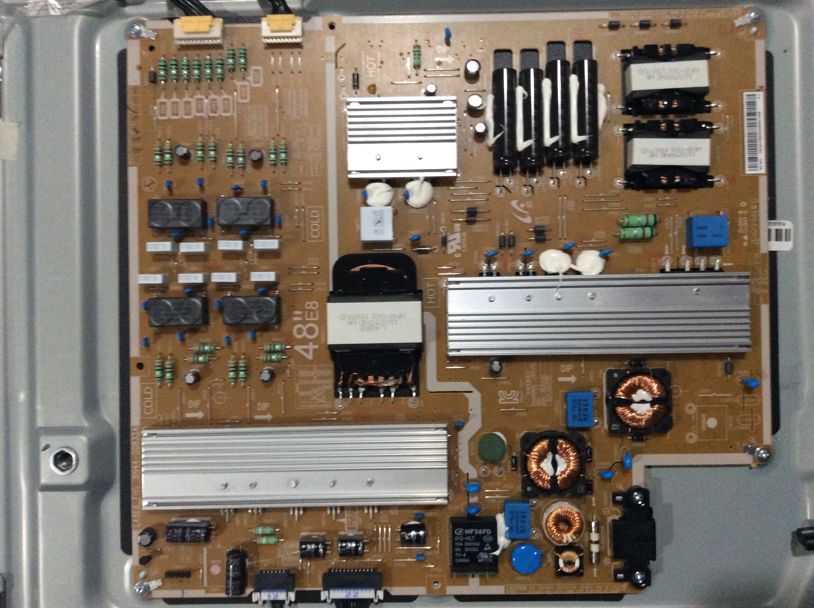

      Re: Samsung un48js8500
      Power supply board number is BN44-00833A
      • Martin0101
        • Feb 2018
        • 21
        Pic

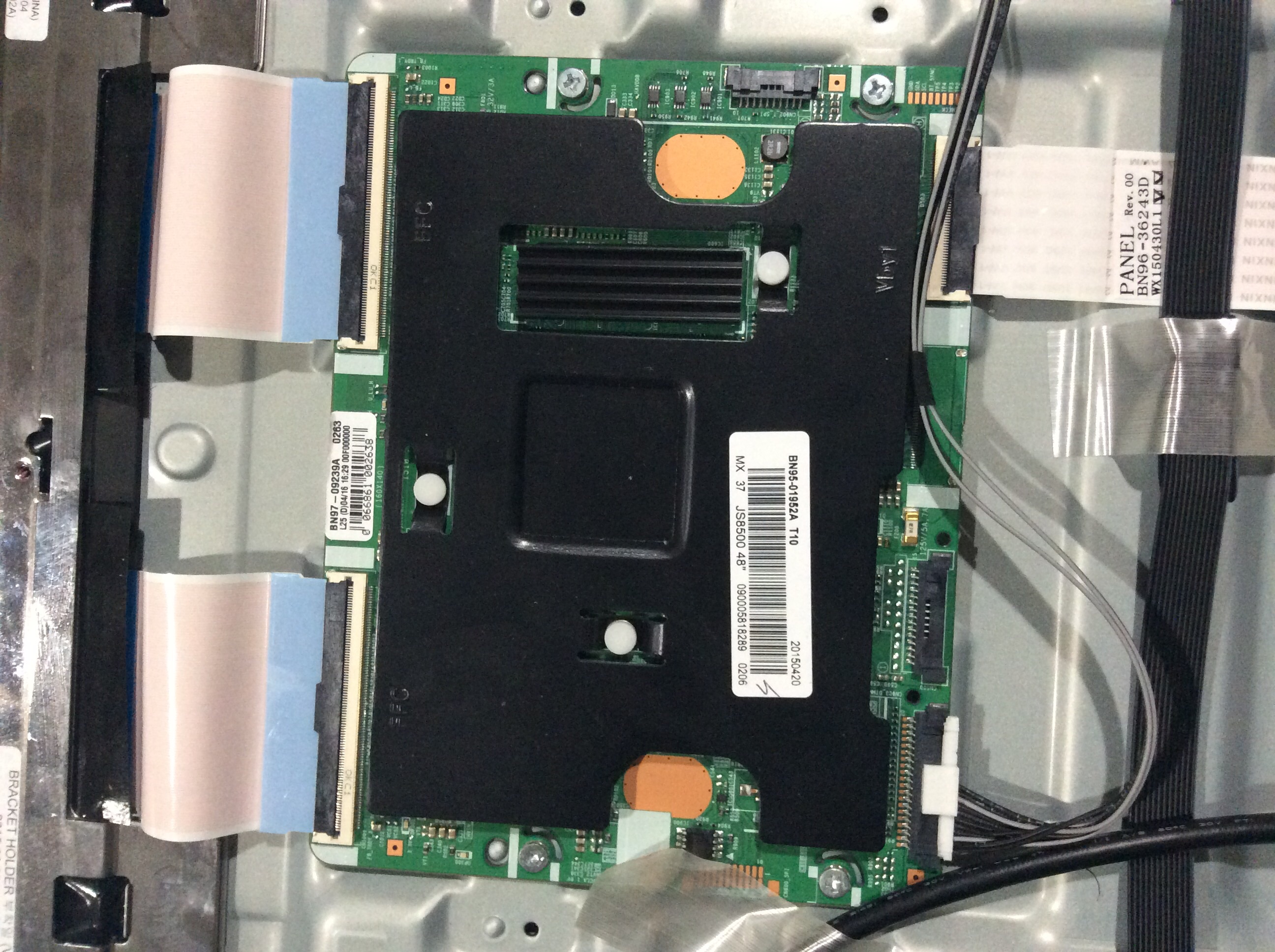

            Tcon

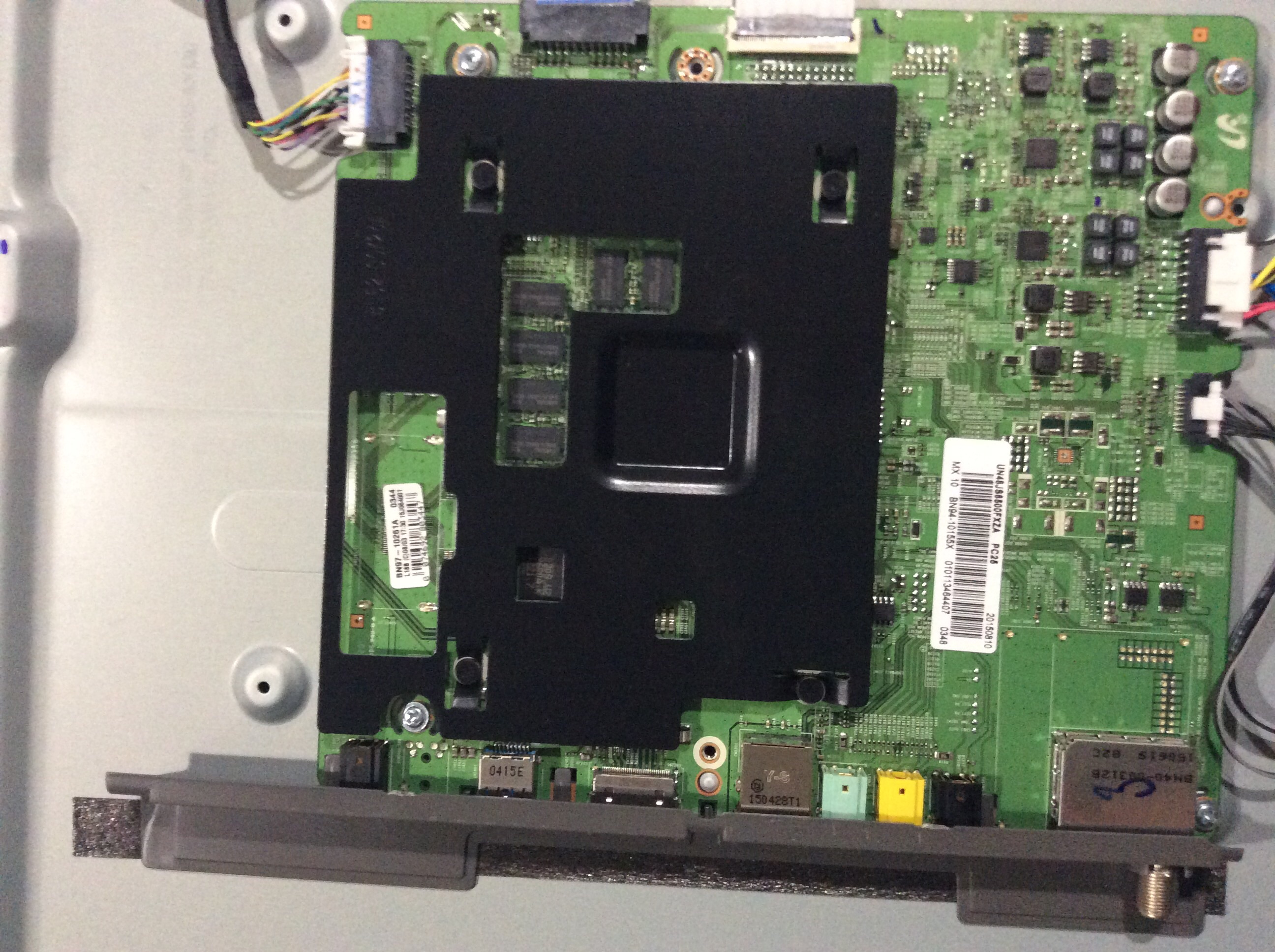

              Main board

                So you remove just the small cable from the T-CON to the power supply board the backlights come on and stay o, correct? That means at least the LED backlights and the LED driver and the power supply for the backlights circuits are OK, and at this point you can turn the TV on and off without problem, right?
                That small cables from T-CON provide the backlights dimming control so it sounds like those control signals from T-CON are stuck low ( you can verify by checking those PWM pins DC Voltages on the power supply board with and without the connector CN9003 in place.
                Did you also try replacing just the T-CON board only without replacing the Main board?
                        Pics. are out of focus.
