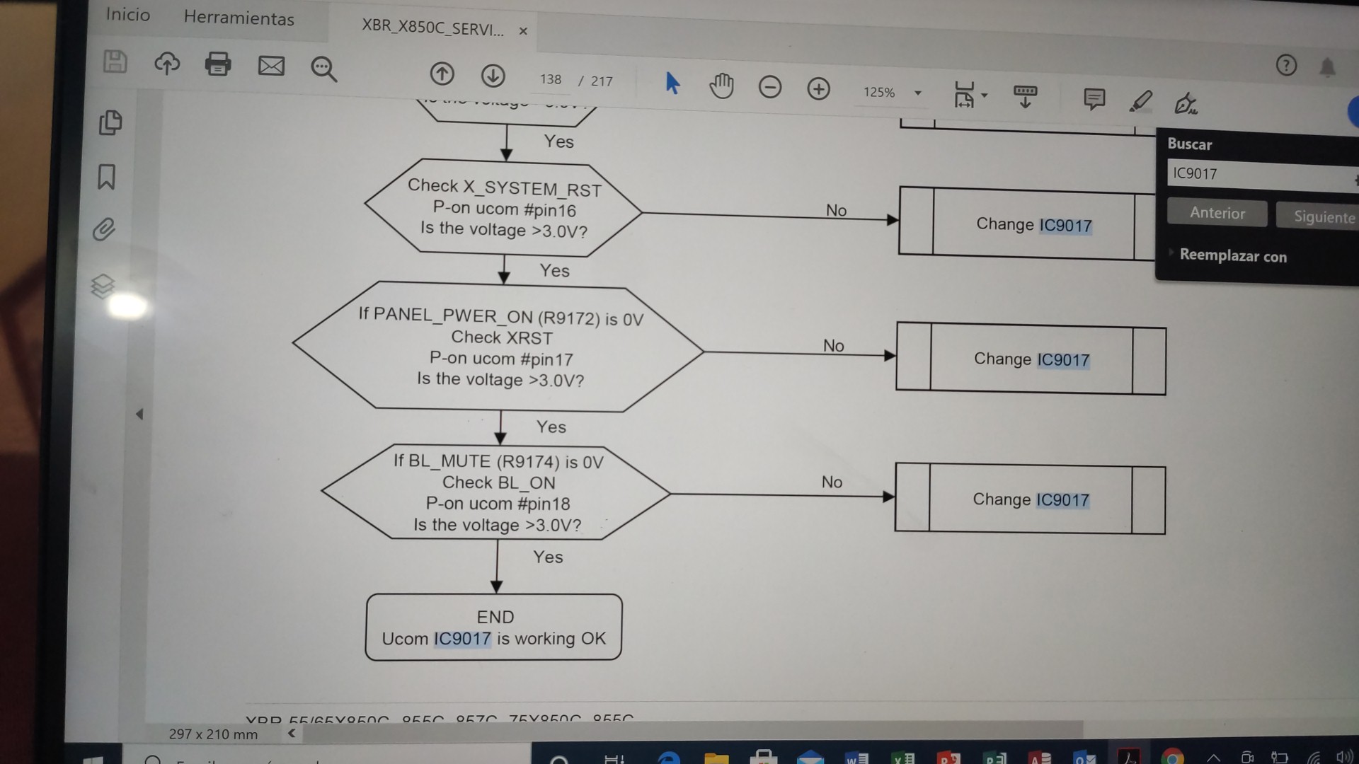

              I have a Xbr55x850c tv It does not turn on and there is no white led at the bottom which is usually white, checking the TV guide it tells me that I have to have 3 volts on pin 18 of pic16f527-1 / ss and I do not have them, according to Manuel I must to change that integrated someone can help me
              • dick_barton
                • Aug 2015
                • 6643
                • Wales
                #47
                Re: XBR-55X850 turns on but no pic no 12v on t-con
                I believe that this is a microcontroller which requires programming so even a replacement unless preprogrammed for the TV would probably be of no use.

                  Do you have a photo of the PIC16F527-1/SS
