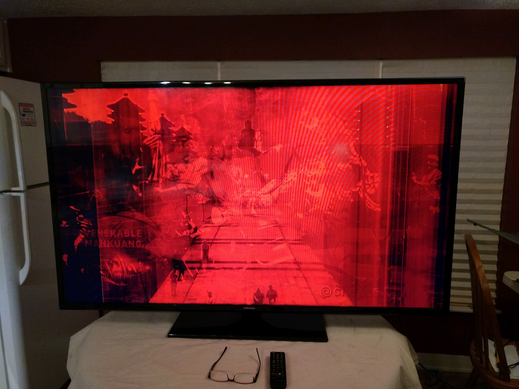

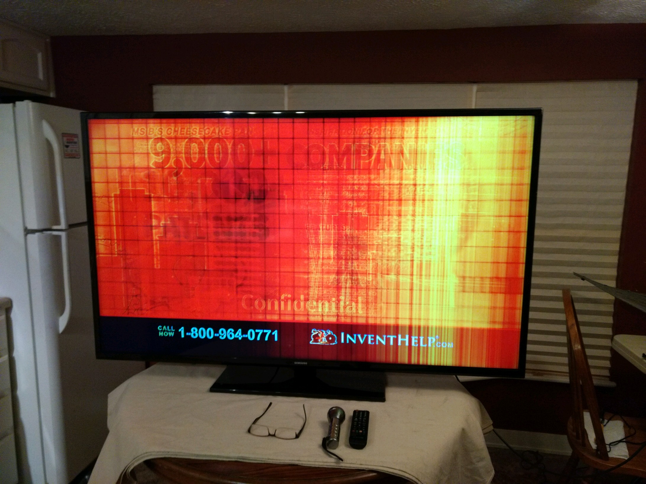

            Well the backlights are on, but here's the picture. I see previous pictures still on the screen when a new scene appears. Any ideas?
            They call me......."threadkiller"
            • CapLeaker
              Leaking Member
              • Dec 2014
              • 8005
              Re: Samsung UN60J6200AFXZA....no backlights but a picture
              if the picture is slow to react like that, it's a tab bond issue.

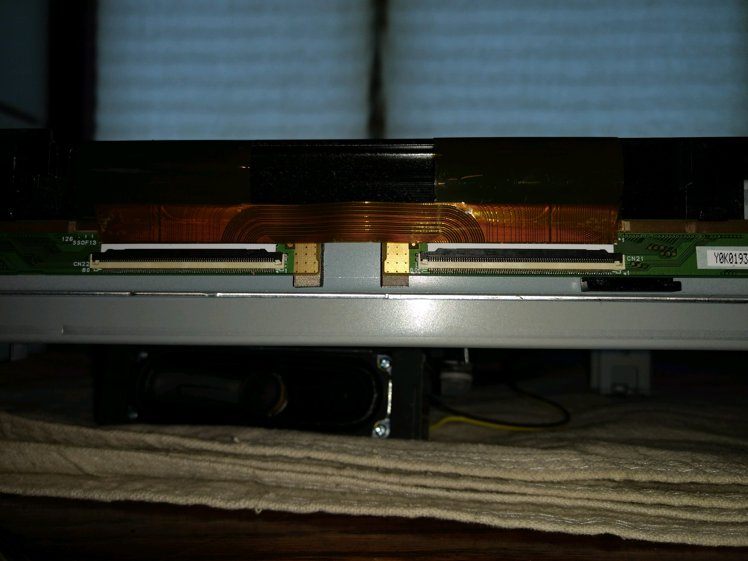

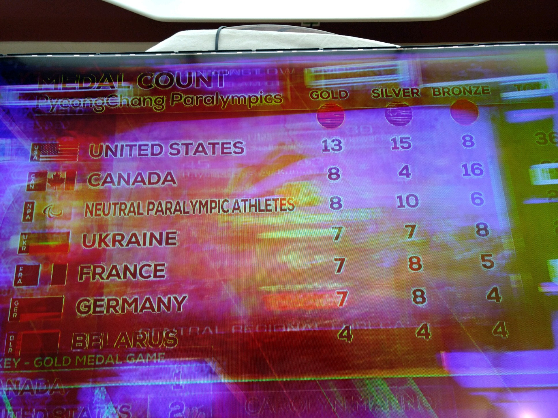

                    Okay I removed the bezel and with the TV on there is no change in the picture when I press on the bonded tabs at the buffer boards or the panel itself.
                    I removed the ribbon cables from the t-con and replaced them. The jumper ribbon cables between the buffer boards looked like they were installed upside down. It was this way when I got it. These were also replaced and re-installed in the right? orientation.
                    The end result appears to be less vertical lines and the scenes change a bit faster.
                    I would think if this was a tab bond issue I'd see some changes in the picture when I press on them?

                        Ok so the panel is confirmed bad. Saw smoke coming from one of the ribbon cables buffer board to panel. There's a metal bar across the cable. It has heat damage near it and when I touch that ribbon cable its hotter than a nun's crotch.
