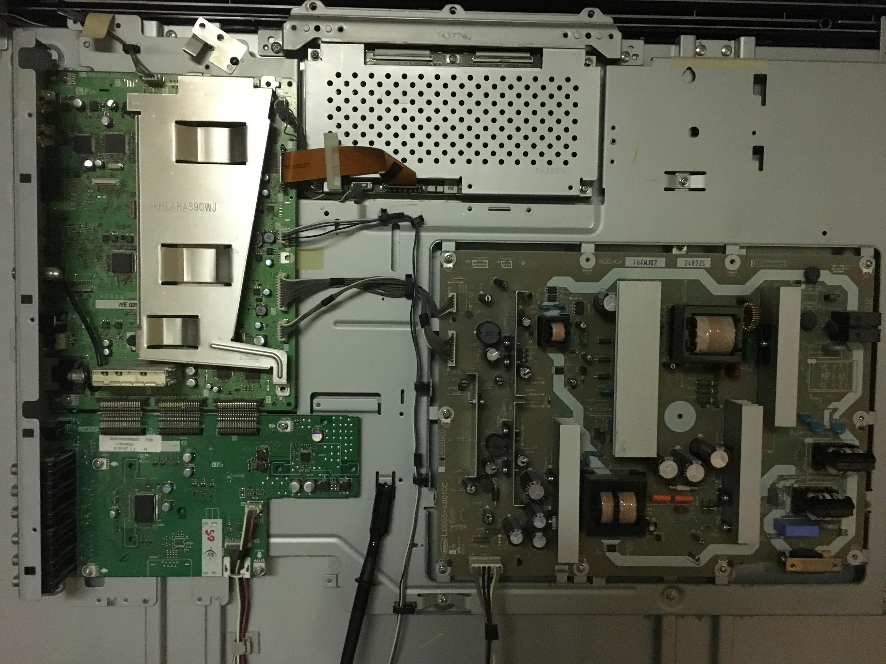

sharp lc52d62u LCD TV no 12V coming out of PSU all other voltages ok
  • frankriz99
    • Mar 2018
    • 24
    • canada
    Re: sharp lc52d62u LCD TV no 12V coming out of PSU all other voltages ok
    Also i thought 12V was the trigger to kick on the inverter boards not TCON but i could be wrong
    IC5702 is KIA 378R12PI
    other pinout on psu board connect small one is as follows
    PD cn5703
    PS_ON pin 1 2.91v
    AC_DET pin2 3,3v
    GND pin3 0V
    PNL_POW pin4 0V
    BU5V pin5 4.98v
    GND pin6 0v
    also on main board 4pin connector that goes to inverter to trigger on has no voltage, but i suspect this is due to Main board not racing 12V power on
      If you force the PSU on, are all power rails o.k.?

                  • frankriz99
                    • Mar 2018
                    • 24
                    • canada

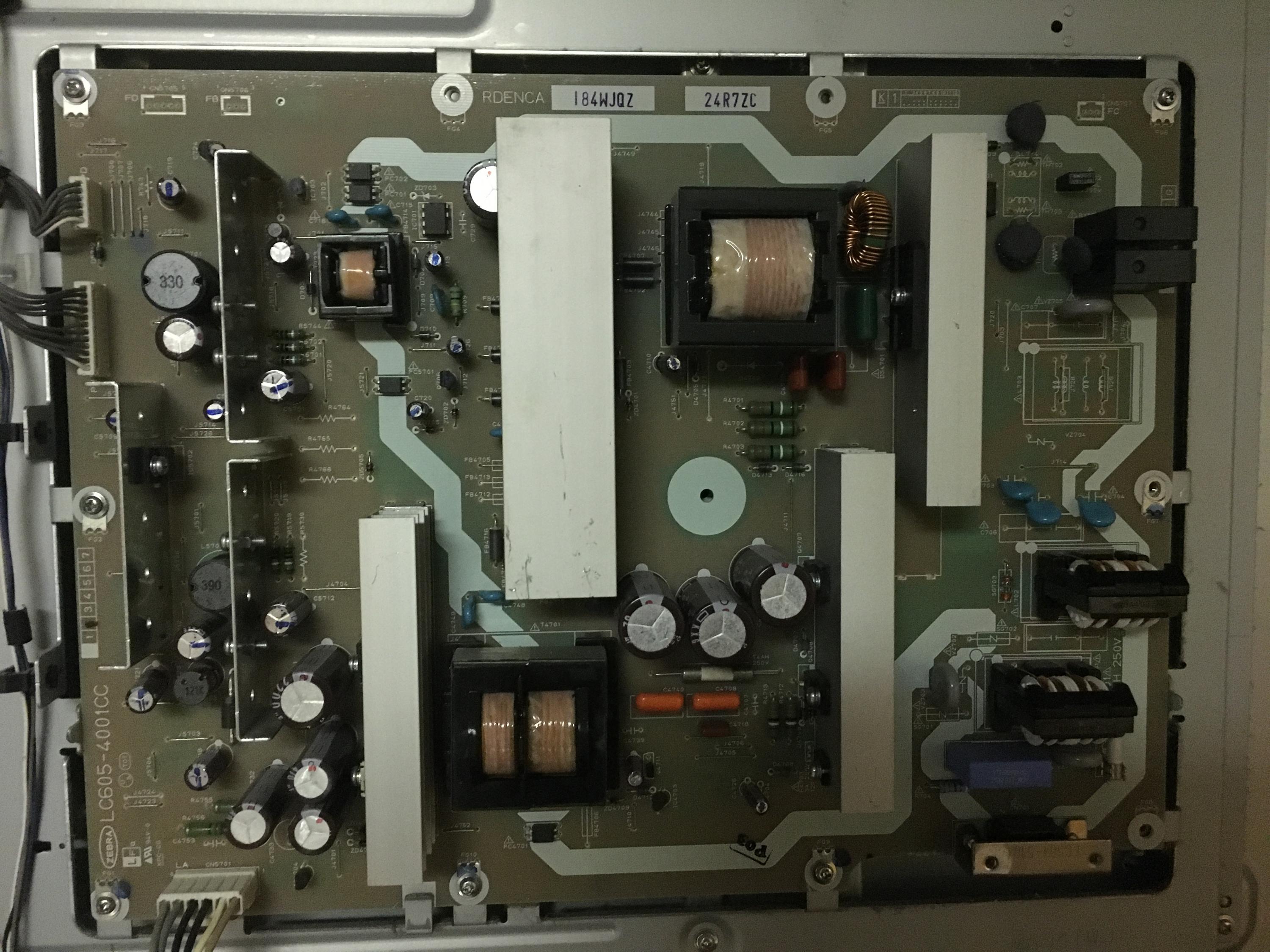

                    #29
                    ok took whole new PSU out of tv and put it on the bench shorted PS_ON to ground.
                    PSU became active here are my voltage (note 12V still not there)
                    13.45v
                    13.45v
                    0V
                    0V
                    10.21v
                    10.21v
                    0v
                    0v
                    0v -should be 12V
                    0v - should be 12V
                    0V
                    5.99V

                      #30
                      you always need put the pin out name with the voltages measured. Is there a BL_on?

                        #31
                        CN5702
                        13.45v pin 12 AMP_13v
                        13.45v pin 11 AMP_13v
                        0V Pin 10 GND
                        0V Pin 9 GND
                        10.21v pin 8 10V
                        10.21v pin 7 10V
                        0v pin6 GND
                        0v pin5 GND
                        0v pin4 PNL 12V (-should be 12V)
                        0V pin3 PNL 12V (-should be 12V)
                        0V pin 2 GND
                        5.99V pin1 6V
                        CN5703
                        Pin1 PS_ON 2.91V
                        Pin 2 AC_DET 3.29V
                        Pin3 GND 0V
                        pin 4 PNL_POW 0V
                        pin 5 BU5V 4.98V
                        pin 6 GND 0V
                        also i notice on main board (not PSU) there are 2 solid RED led on, and one constantly flashing red led

                          #32
                          Looks like it may be right, does not look like you activated bl_on, right? you just jumpered ps_on and ground if that's correct theory then it looks like the powersupply is ok.

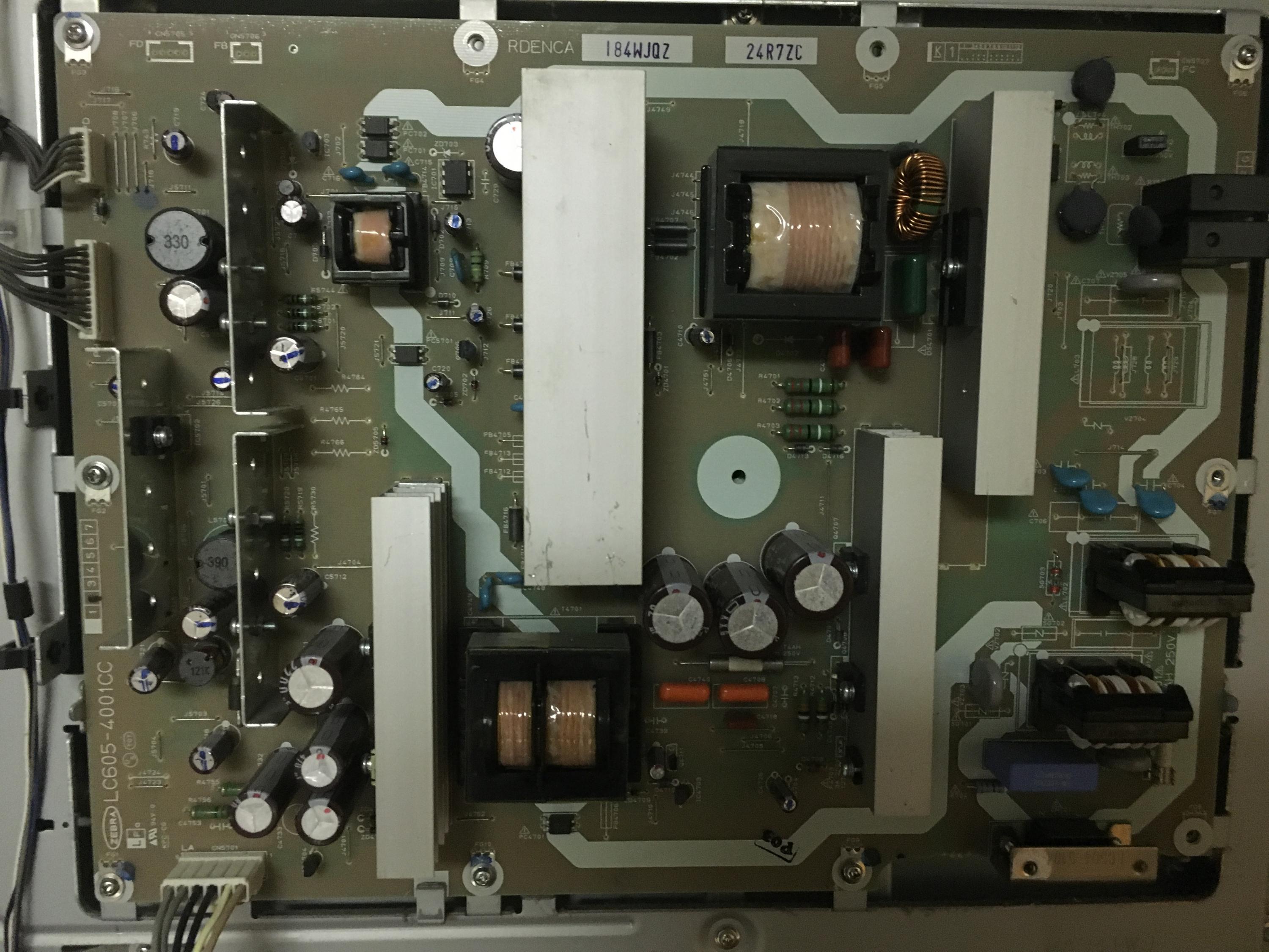

                            http://www.shopjimmy.com/sharp-rdenc...pply-board.htm pic. of powersupply if that's it.
                              #34
                              'pin 4 PNL_POW 0V' Main board is not sending the control signal to run on PNL12V which is supplied by the switched 12V LDO IC5702 KIA 378R12PI.
                                #35

                                Are these Voltage you are showing are done with all the connectors back in place? Or it's done with PS-ON pin connected to GND which then doe not make sense since you still show PS-ON 2.91V. Please clarify.
                                It looks to me the PS-ON has to be high for the rest of the power supply to be turned on based on your Voltage readings.
                                  #36

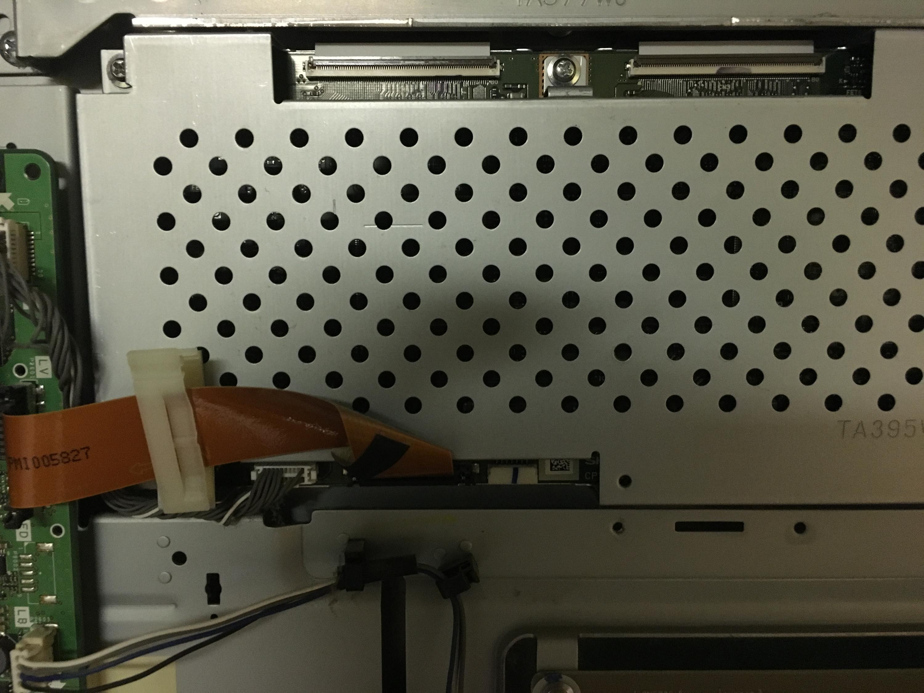

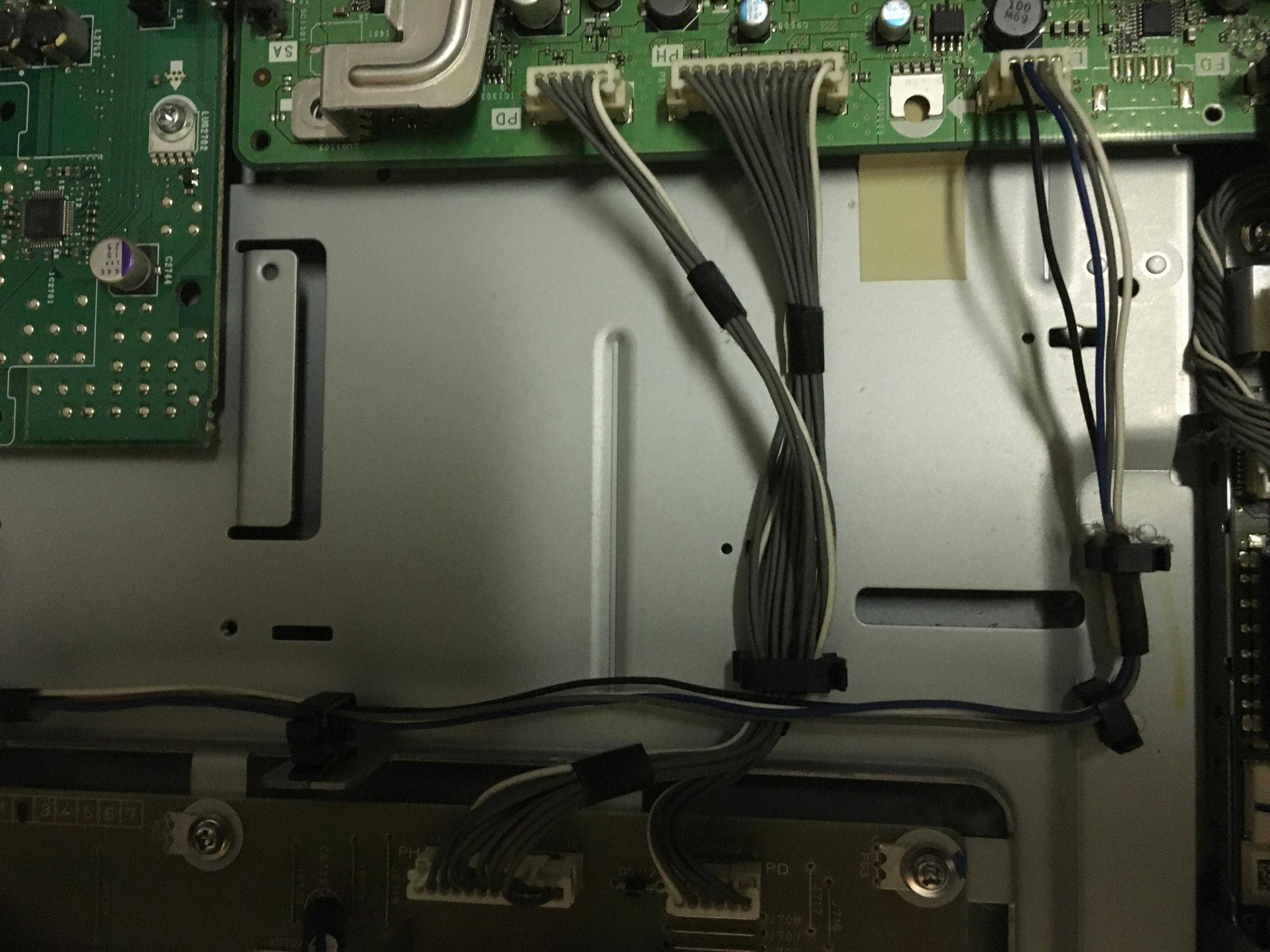

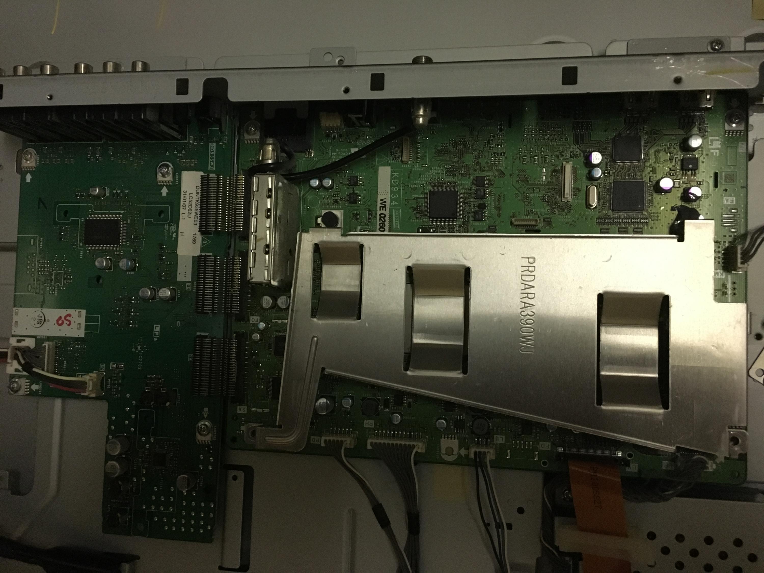

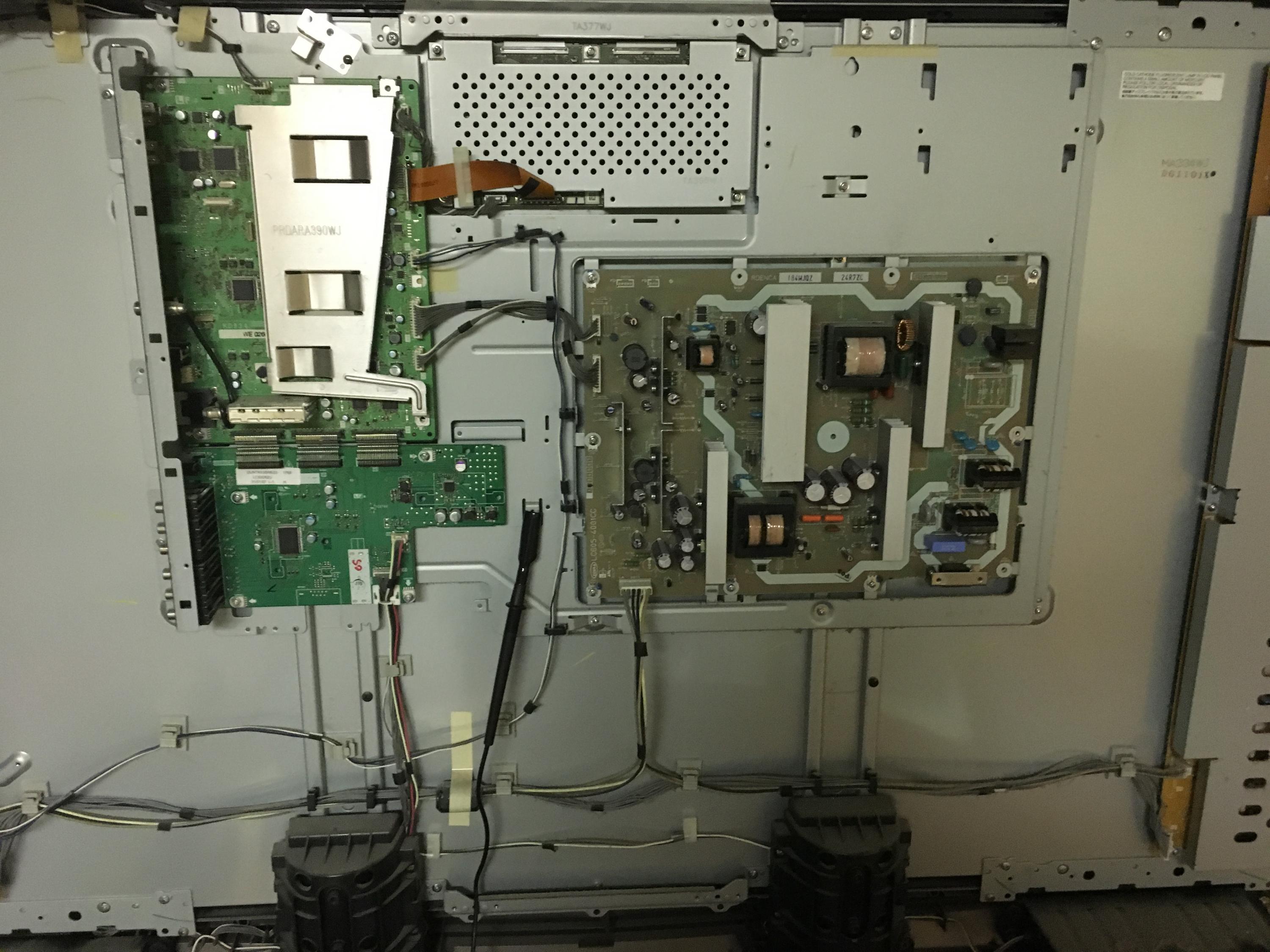

                                  BTW, we still need to upload pictures of the whole backside of the TV showing all the boards, the other thread you made the Photobucket had blocked your pictures.

                                    #37
                                    is there anyway to assert the PNL_PWR to see if inverter will fire up.

                                      • frankriz99
                                        • Mar 2018
                                        • 24
                                        • canada
                                        #39
                                        here are pics attached again
