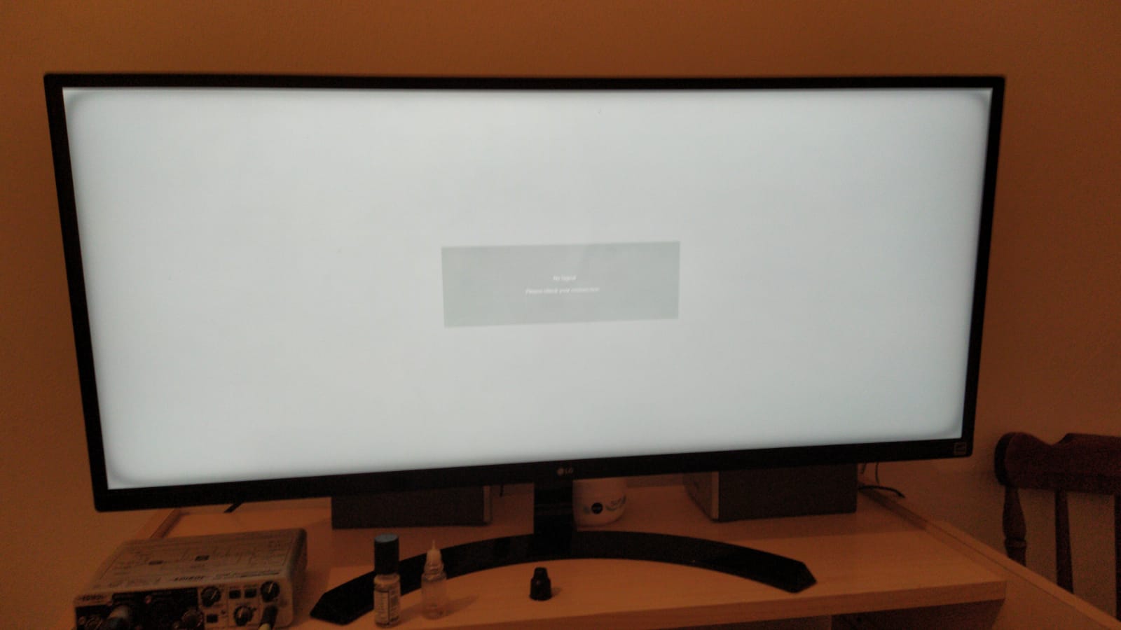

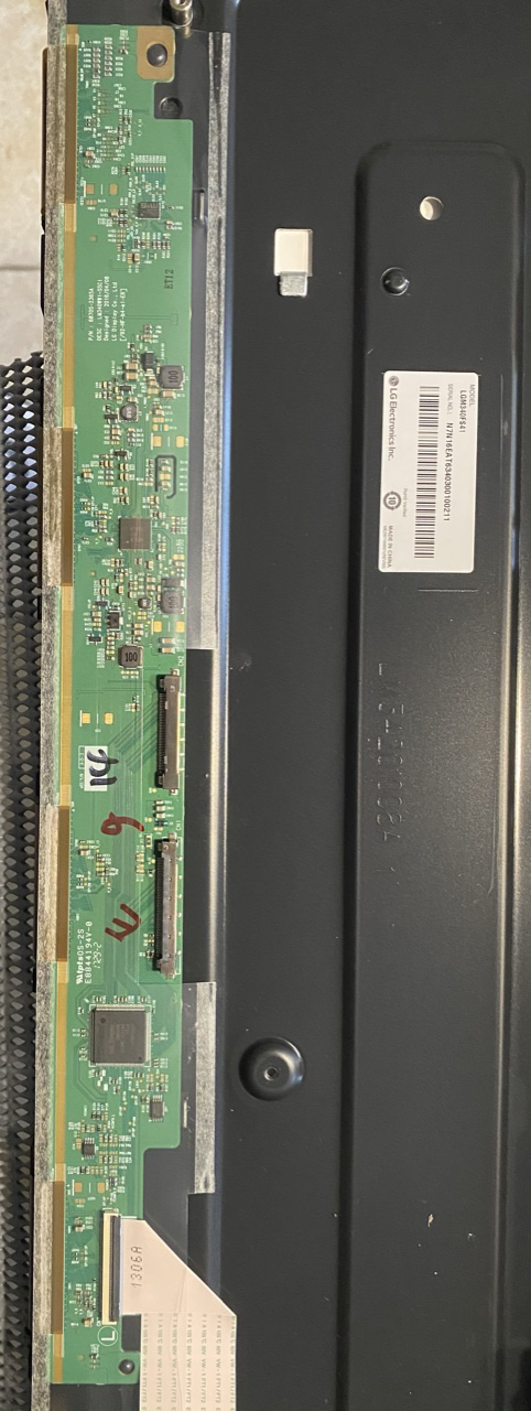

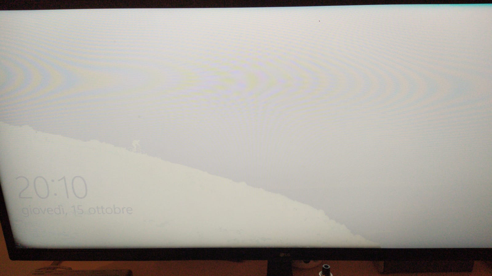

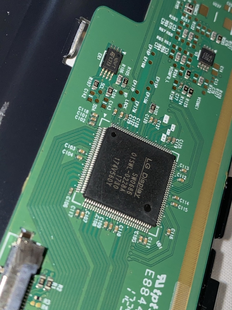

                  Hello everyone and thanks in advance for the support!
                  I have an LG 34UM59 that has the same exact defect (see picture).
                  I was in a hurry and ordered already the mainboard to try the replacement (hoping that the fault is there...)
                  But I have a question.. I disassembled all the monitor and found the tcon board ( which in my case is divided in the segments, linked by a flat cable. On the first segment there are some chips similar to the A15 you spoke about and which I found on various threads on internet. But they all have different names from A15.. if the new mainboard won't fix the problem, what chip do you think is responsible for the white image fault? I attached the photos of the board and the chip..
                  Thank you very much in advance!!!

                      occhia.....
                      Use your meter set to ohms and check there are no short circuits across any of the capacitors on that circuit board. I am sure that someone recently had a washed out picture that turned out to be a short circuit smd capacitor.

                        Re: Screen white Samsung LE37B550A5W
                        One problem occhia, is you have a similar problem but a different tv than this thread is about, which can be confusing, you would be better off opening a new thread with your tv brand, model and details. Add some good clear straight on pictures of each board and one of the whole back as to show how they are all connected. You can add pictures by clicking go advanced then manage attachments.
