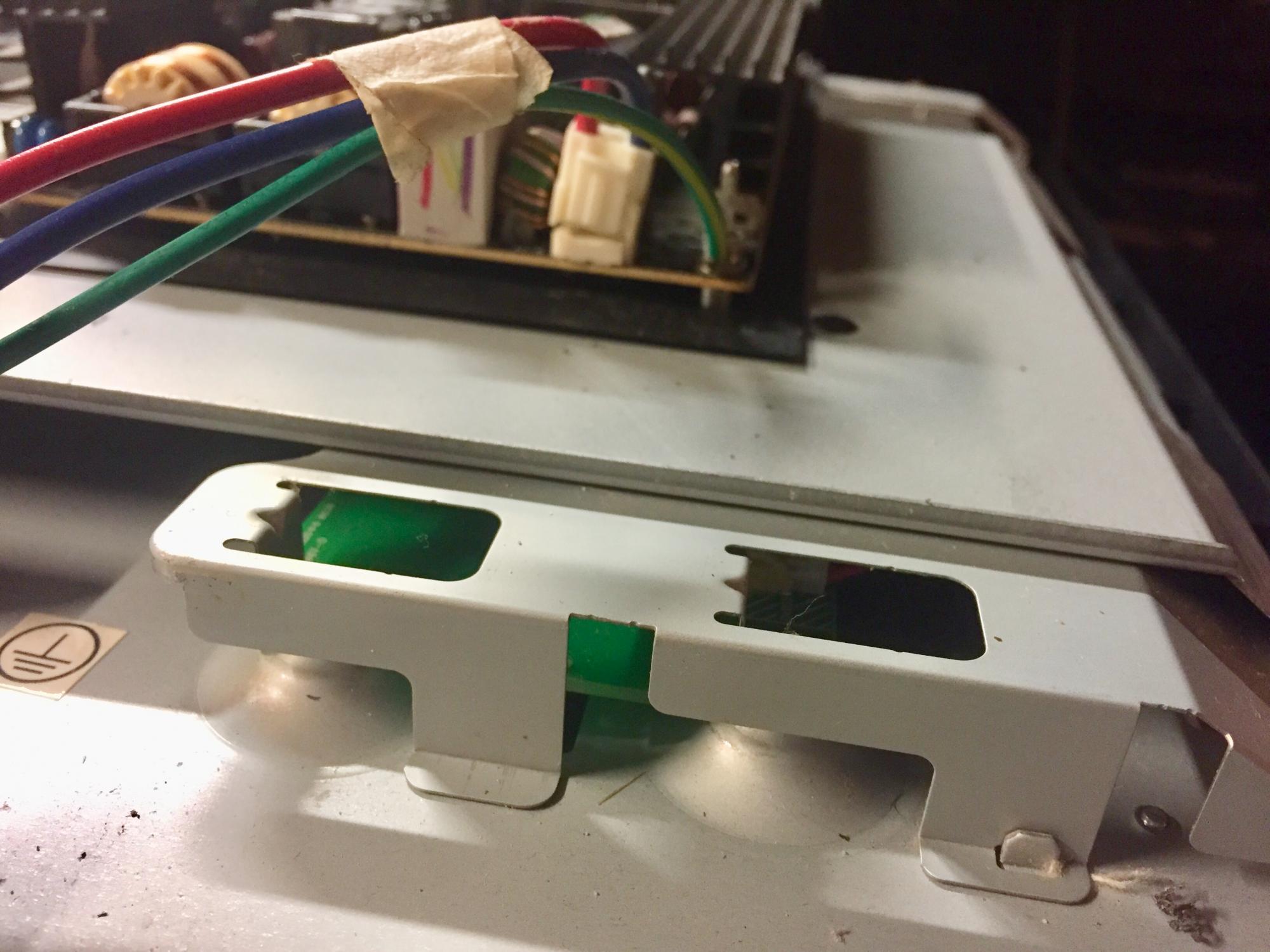

      Re: Akai LCT37Z4AD Has very dim backlight
      I've looked at the Service Manual and can't figure out the location to check the dimmer voltage supply. I've looked at the power supply board also, and can't locate it. I did check the voltages on the cable going from the power board to the Slave inverter board, and only the first red & white wires has voltage. That first red wire has 5.03vdc, and the white wire has 2.95vdc.
      The master inverter board has the power supply board minted directly on top of it , so it's about impossible to check it's voltages. Thanks for your reply budm
        OK, this looks like one of those Polaroid/Westinghouse chassis, it does not have the BL-ON or the DIM control passing through the power supply board.
        Can I see the picture of the whole backside of the TV?
            I can see the inverter board under the metal shield, there may be pin lable on the inverter connector to tell you which one is the Dim control pin.

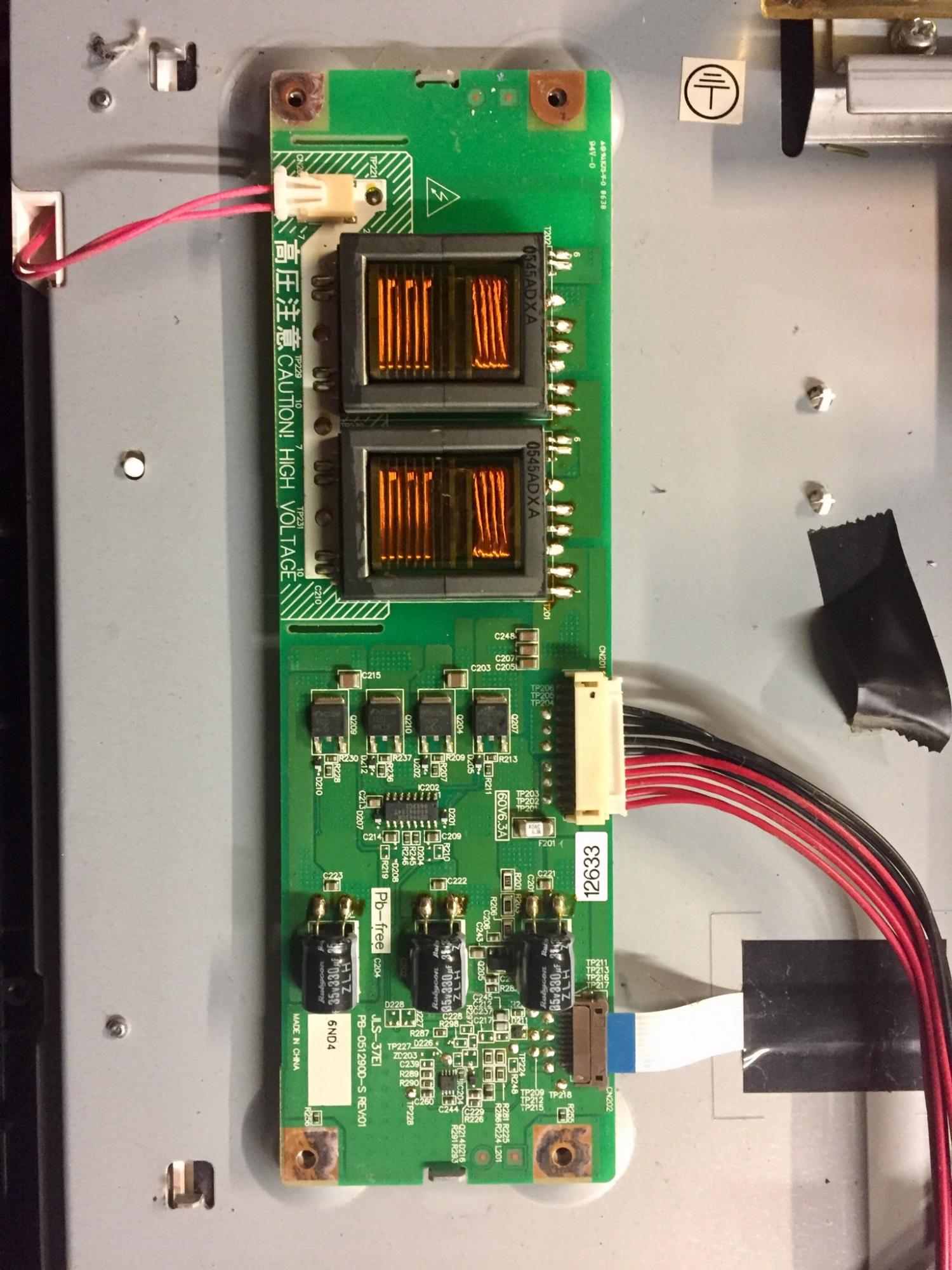

              Here's a picture of that inverter board that's mounted under the power supply board. I didn't see anything marked dimmer or dim. I did notice the copper ground contacts (screw points) we're corroded, so I cleaned them. But didn't make a difference. This inverter board is smaller than the other one. So I'm guessing it's the Slave.
                Look like you need to look at the Master inverter board.
                Can we see the pictures of the Master?
                Is this the Master Inverter board you have?
                http://www.shopjimmy.com/akai-pb-051...t-inverter.htm
                If it is, then check the DC Voltage on TP7, TP8 and report what it has.
                      Hi budm Here's the voltage checks and a pic of the master inverter board. And Yes, that's the same board on ShopJimmy. Is those voltage readings ok? Or does that tell us the master inverter board is the problem? Thanks again for your help.
                      TP7: 5.0 vdc
                      TP8: 3.0 vdc
                        OK, they look OK.
                        TP7 looks to be for BL-ON
                        TP8 looks to be for DIMMING, at 3V the backlights should be quite bright. 5V = Max Brightness, 1V (typ.) = minimum dimming.
                        So you do have 24Vdc on both ends of the fuse with ref to GND on the MASTER and the SLAVE inverter?
