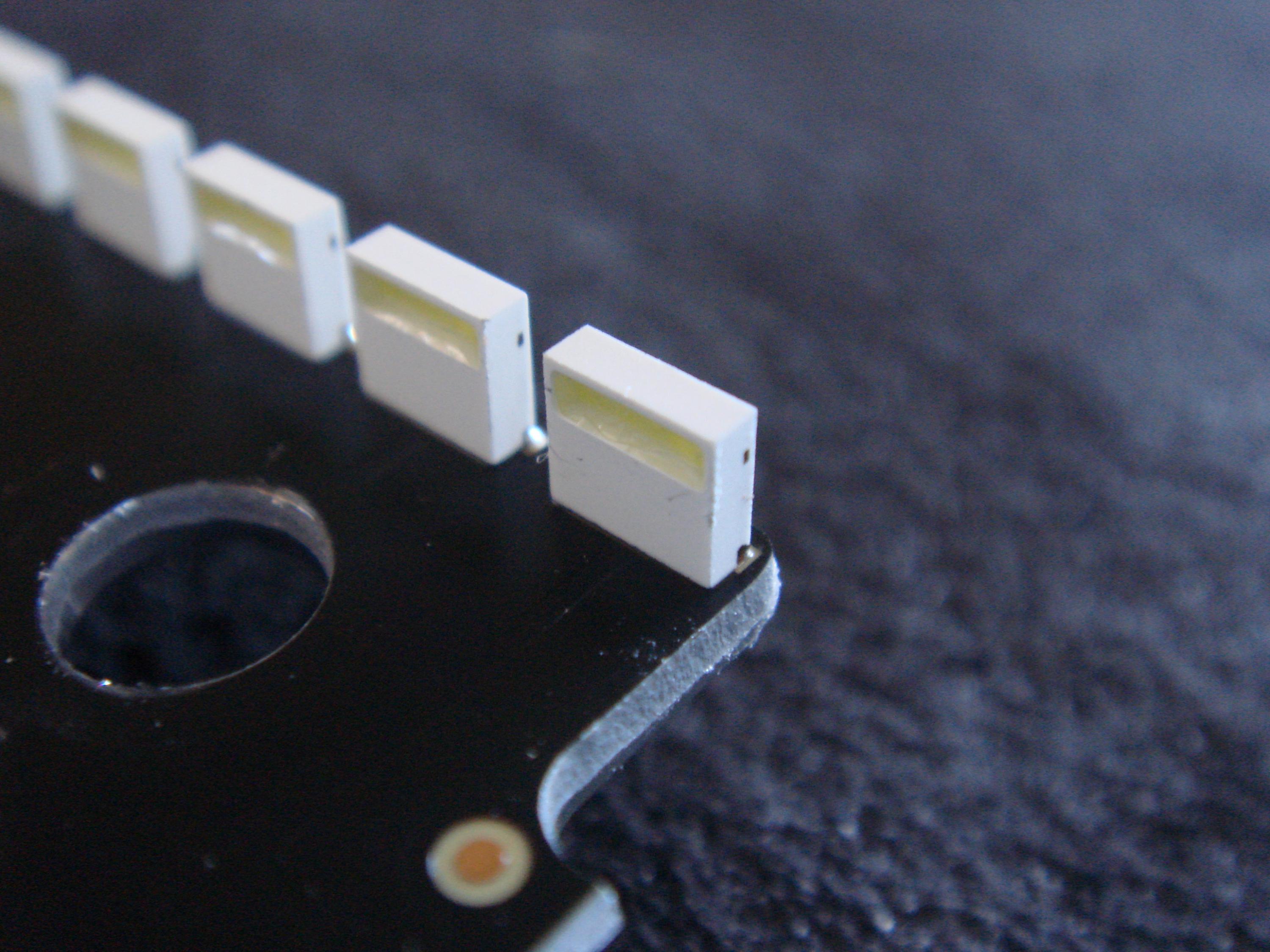

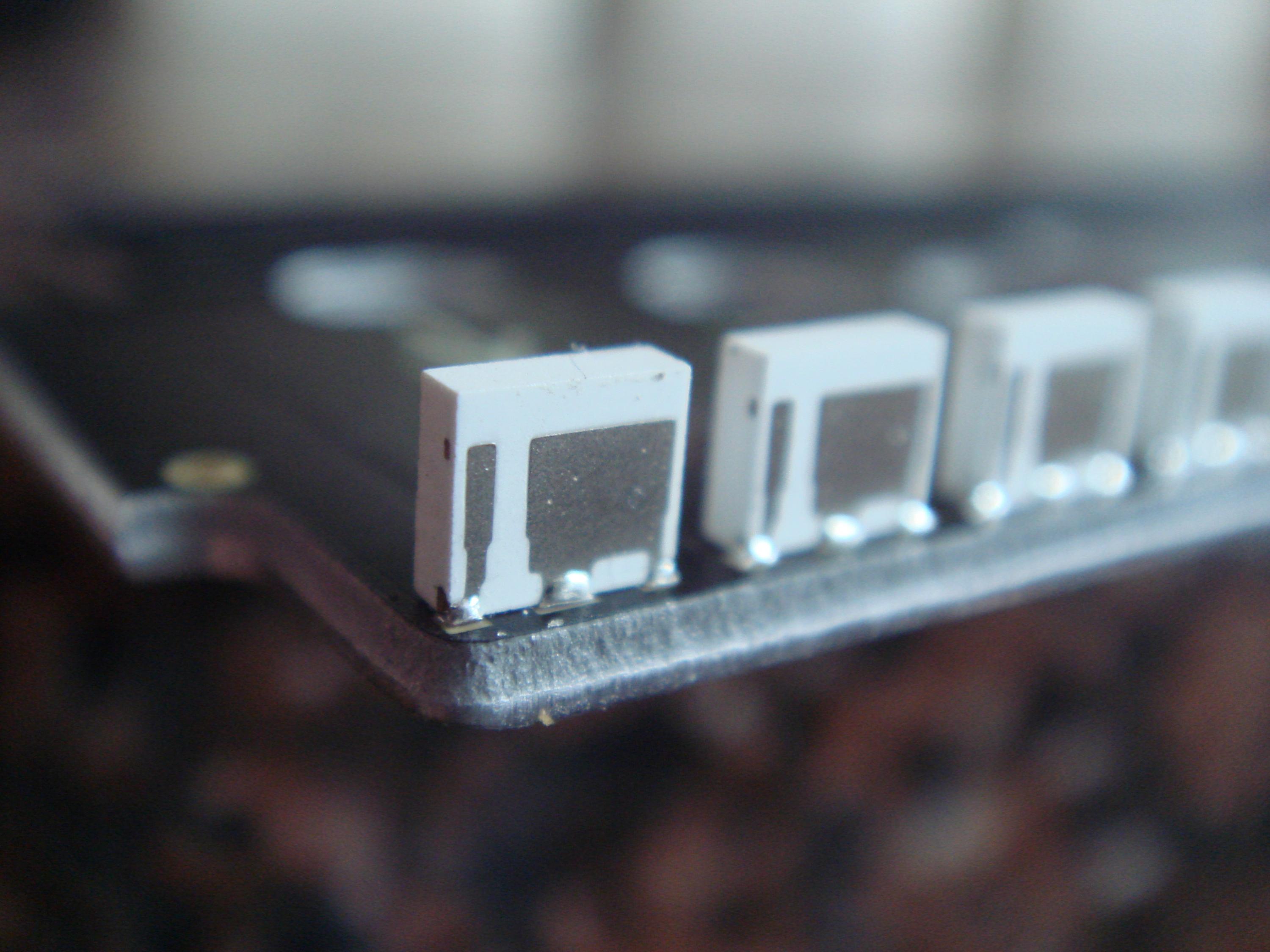

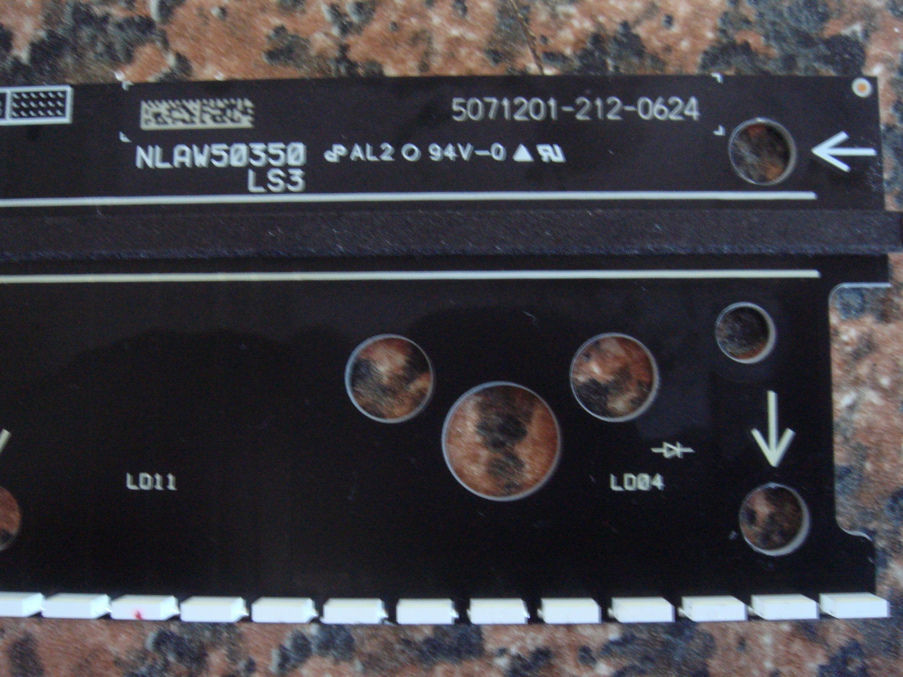

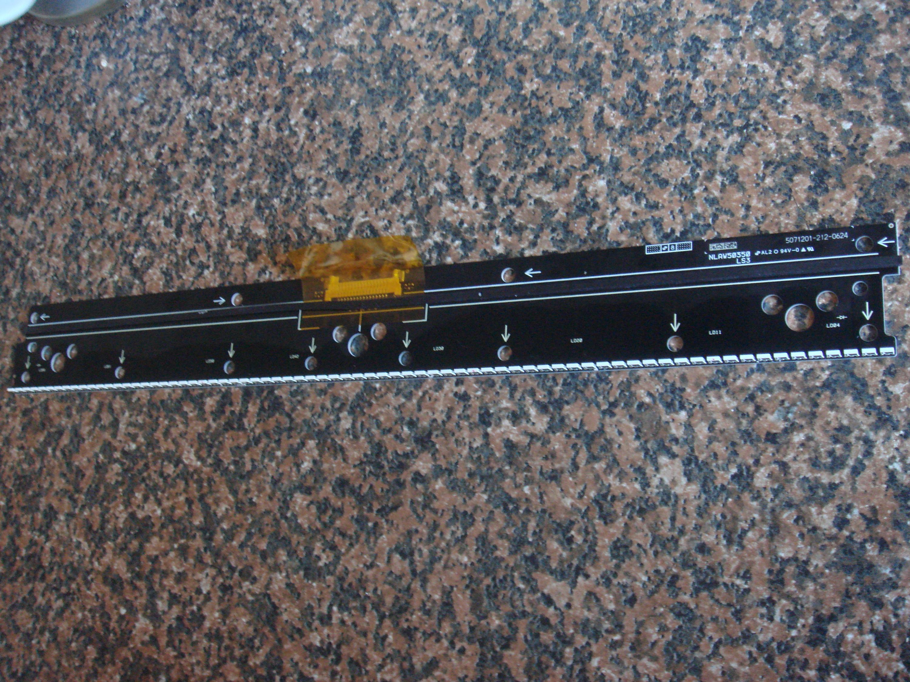

    Hi folks, Try again (last post was hi-jacked - my fault, insufficient detail in header)...
    Long story short, need either 3 X full LED strips or individual LEDs to repair this T.V.
    Has anyone seen them before....
    Does anyone have a supply of them that would share (for payment obviously)....
    Can anyone point me in direction of manufacturer - Sony approval repair centre tells me they are NOT exclusive to Sony....
    Seems that I would be easier searching for Holy Grail ;p, possibly lack of info and/or sources of these parts is down to fact T.V is just over 2 years old....
    Photos show individual LED chips, a loaded board and part identification, chips are an unusual config - 4236 (by 1.3mm thick) and are side soldered to PCB (just visible in photos)
    Any info or assistance would be greatly appreciated....

    I had a look at a few sites and was unable to find any that looked like these, I found the complete strips but they are out of stock.
    Any info on who made the actual panel? I doubt it was Sony.

        Hi RJ/Dick Barton, Yep, you and I have found traces of the elusive chip, but no actual chip. RJ - I am still corresponding with Sony on forums, but they have offered only a "chargeable replacement" - I queried this - they will supply a "new for old" t.v. for only £1200 (yes seriously - they want what amounts to a large deposit for a newer/better t.v) to replace my current one, that (now) has question marks over its reliability - rather than supporting me with either new components (at my expense) to repair and extend this t.v. a little longer than its current age!!
        Will endeavour to remove a chip (without damage) in the off-chance a part number or manufacturer info. is there - will update later, its getting dark and I've just typed up a letter (in draft form) that I propose to send to Sony.
        They do commit to customer support in the form of replacement part provision - see their UK website, I only want them to honour that policy statement - it's a cheaper option, if they supply parts or point me in right direction, that will suffice....Can only try.

                    what lcd panel number is used in your tv

                              SUCCESS!!!
                              Parts arrived afternoon 23rd, installed them yesterday (24th) - what I received was full aluminium panel (yep - all 1.3m X 0.5m) with LED panels and their connection ribbons (to the LD Driver board). I used a full panel (72 LED's on board) to replace the faulty board on mine - removed and replaced the thin (felt?) strip that is located full width above the three LED boards (light isolator or what?) ensuring that the thin heat transfer strip behind the panels was firmly against each of the (216 LED's) and the aluminium panel.
                              After re-assembly (no screws left over!!!) I stood the T.V up and switched on....white light....green light....green light.....(repeat...) no screen activity - switched it off tried again (repeat last symptoms...) - green light appears to indicate a software error, so, having a spare A/V (main) board - swapped them over and.....white light - swirling coloured orbs (holds breath...) then "Android" appeared.
