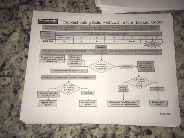

    I thought that might be a problem but since they had the same suffix, I thought it would work. The P50ST30 has a AC version of the board according to various sources. The P55ST30 does use the AD version. How the AD got in the P50 is a mystery to me. How does the manufacturer keep these straight if they are not interchangeable between models?
      Re: Panasonic TC-P55ST30 Interpreting SU-SD tests
      The 50" and 55" panels are different. The A board controls the plasma discharge; with the wrong board, problems could happen, such as maldischarge (misfiring pixels) or SC/SS failure. I can't be sure if your 14 blink symptom is caused by it, though.
      • FastEddie52
        • 18
        This is actually the "Solid Red LED Failure (Locked Mode) that was was implemented for the 2011 model. Attached is the troubleshooting flowchart. So you disconnect SC2, SS11, and SC20. Is the led blinking? Yes then is it blinking any other number times beside 6? Yes (8). Then Replace A boardand check Vsus and P15v for short circuit. (The flowchart is attached) This is what led me to replace the A board in the first place. I am going to get another one since nothing else shows up as a fault.
          I bought a new main board for the TV and installed today. Nothing has changed, so I am at a loss for what is wrong
            Based on my limited experience with a 50s30, how about trying just an sc2 disconnect with everything else connected.... what is the result? I guess the question is... are you counting your "toes" correctly? :-)
            • FastEddie52
              • 18
              With SC2 disconnected, I get 7 blink error

                        #31
                        Update on my TV. I sent the SC Board out to be repaired, but the repair shop could not find the problem. So I bought a used SC board and that fixed the TV. I bought 2 A (main) boards thinking that was the issue. I guess I will resell them on ebay. Thanks for for all your help.
