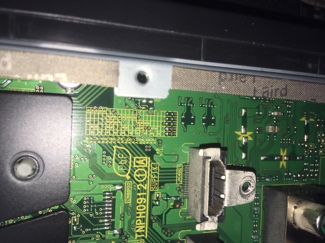

                                  The optical audio port light does come on briefly until the TV enters shutdown. The board numbers are identical including suffix. According to the seller of the board, the board came out of a TC-50ST30 where the screen was cracked, but it was working before the boards were stripped. The A board is a TNPN09121AD. This is same number that shopjimmy sells for the TC-P55ST30.

                                    Where did you get that part number from?

                                      Sorry it is TNPH0912(1)AD. Attached is a picture of the number from the board.
                                        Re: Panasonic TC-P55ST30 Interpreting SU-SD tests
                                        You have to use the exact mainboard that came out of your set. I know this because I had a panny that had 2 sets of parts, a board,sc board,and d board. Ss and su/sd boards are interchangeable. I had to buy the A,D, and SC to fix it.
