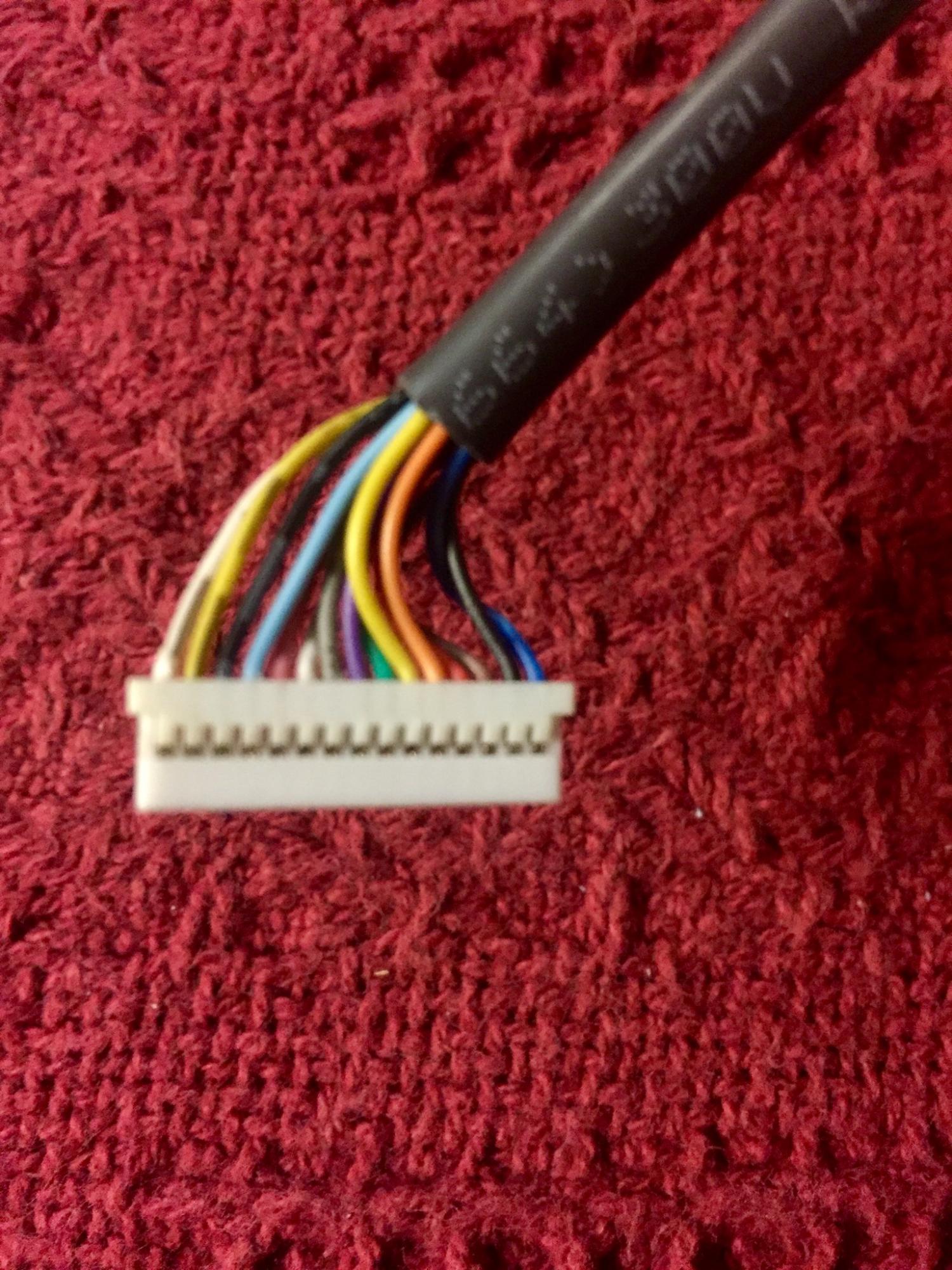

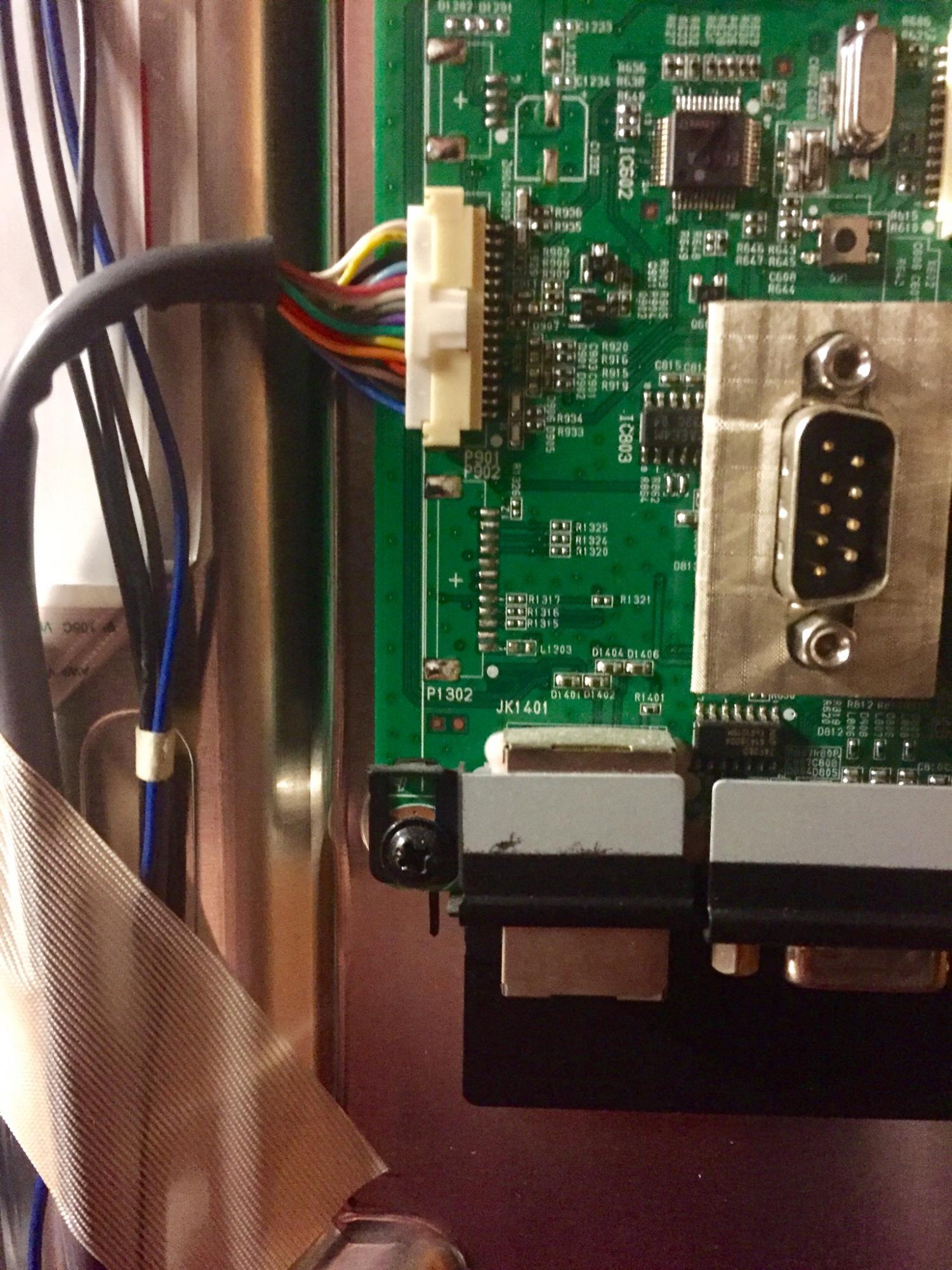

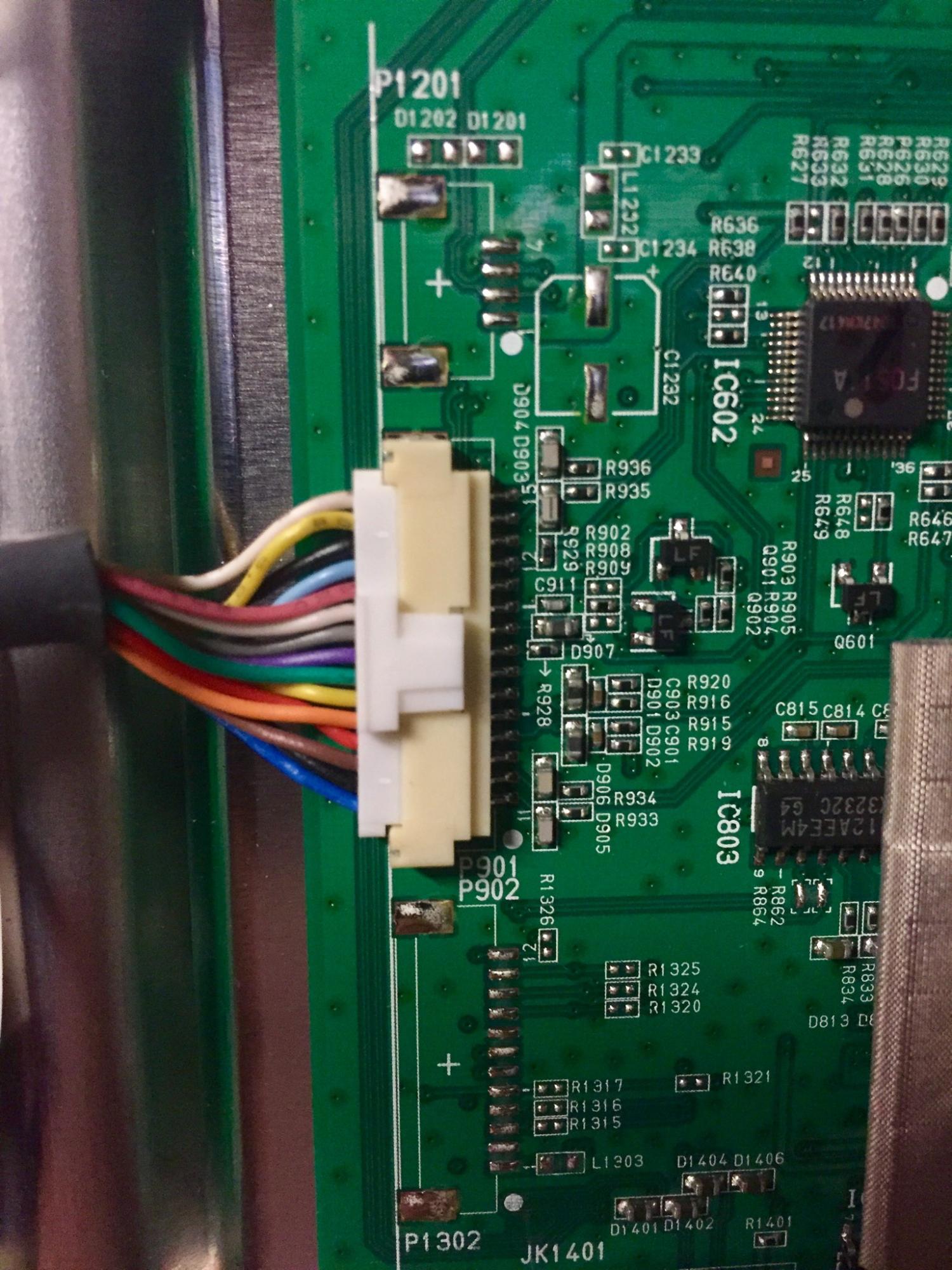

        The button board doesn't look like anything has been spilled on it, but you can't tell if Windex has been used on it. And that board is firmly attached. I tried prying it out, but it didn't budge at all. I took some voltage readings from the input/output board that the button board is connected to. Pic included. I get 3.4 vdc on all pins except the following colored wires .From top of pic. No voltage on: Black, blue, white, gray, purple, & green.
        I also got the same readings at the cable end that connects onto the button board.

          Re: LG 42LV5400-UB Touch panel buttons not working
          What you can do is probe any colored wire while you press on the buttons. If you are a feedback voltage (which I believe this is how it works) it may be a mainboard issue.
          Any LG or vizio remote will turn the set on and off. Wondering if IR works.

                      Should there be 3.4 volts on all pins that connect to the button board? There are six pins with no voltage, as I previously stated. I've tried looking at the service manual, but I can't tell if all pins should voltage. I know there's two ground pins that shouldn't have voltage. But, I'm just stumped right now. Someone please guide me in the right direction. Thanks
                        The 6 pins should be outputs and such. What happened with the LG remote? Any luck?
                        3.4v is about right.
                          That’s what I was thinking about the pins with zero voltage. My son can’t find his LG Remote. I’ll have to buy one, I guess. But I seriously doubt any Remote will work. I got this tv from a recycle center. When I opened it up, I noticed someone had cut the speaker wires. Probably because they couldn’t control the volume. I repaired the speaker wires. I’ll definitely try an LG Remote when I get one. I’ve read this is a known problem with this model / series of LG tv’s. I’m not a fan of the Soft Touch button deal! Now, more than ever! Lol
