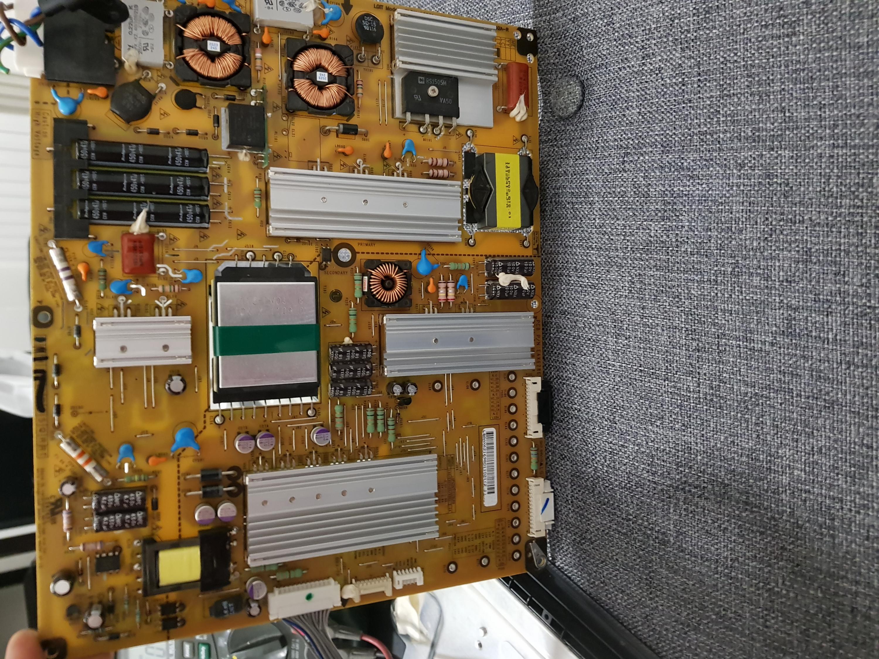

lg tv 42lv450 does not start
  • Moddingscreen
    • Dec 2017
    • 65
    • Italia

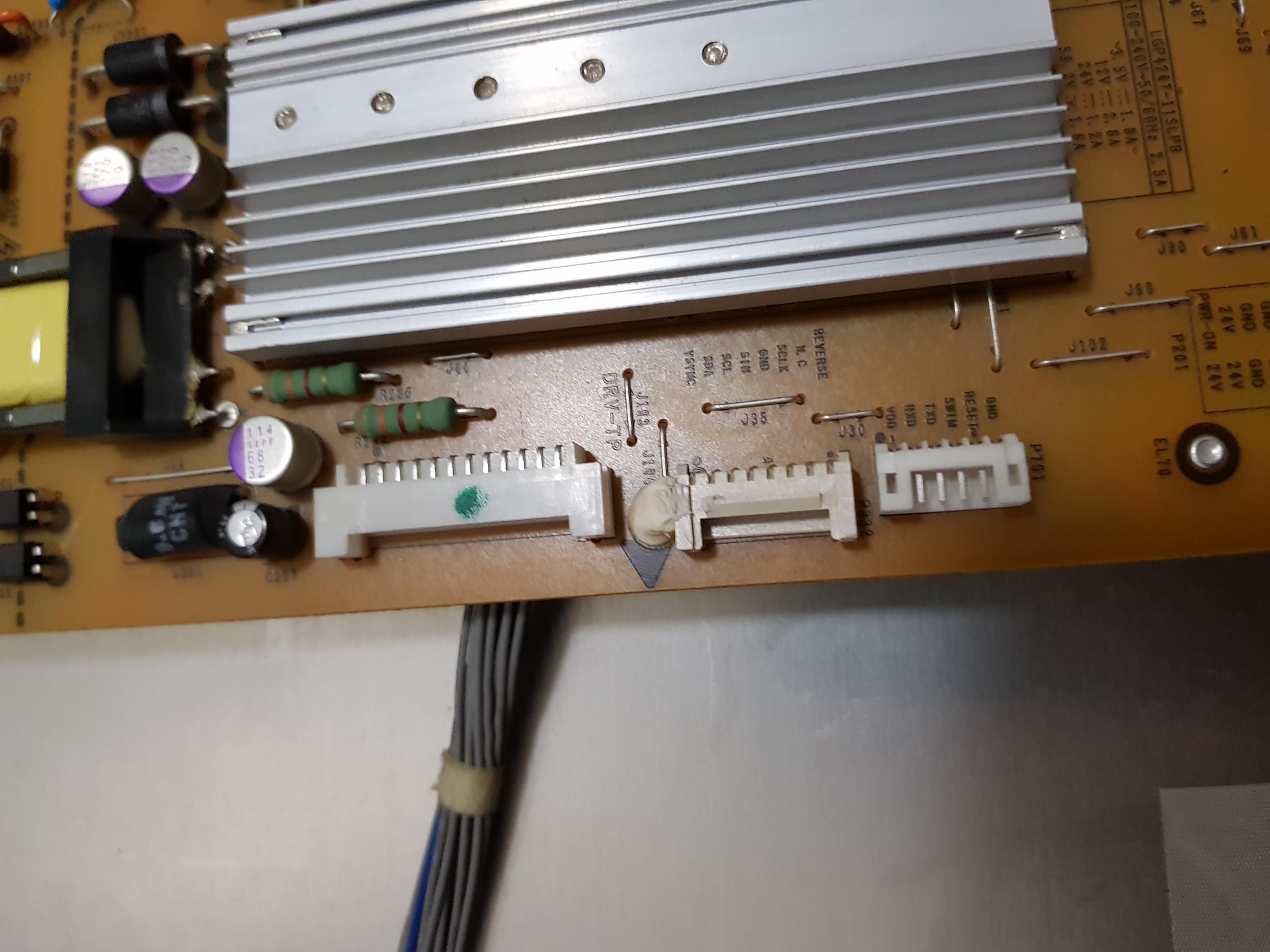

    Good morning everyone is a new user of the forum, I have a small problem with the power supply of a lg EAX62865401 tv, the tv flashes the standby LED and subsequently also the white led and then turn off totally, I checked the voltage 3.5v and it is present but the relay does not attack, what can I do?
    Thank you all for your valuable advice, and excuse my English

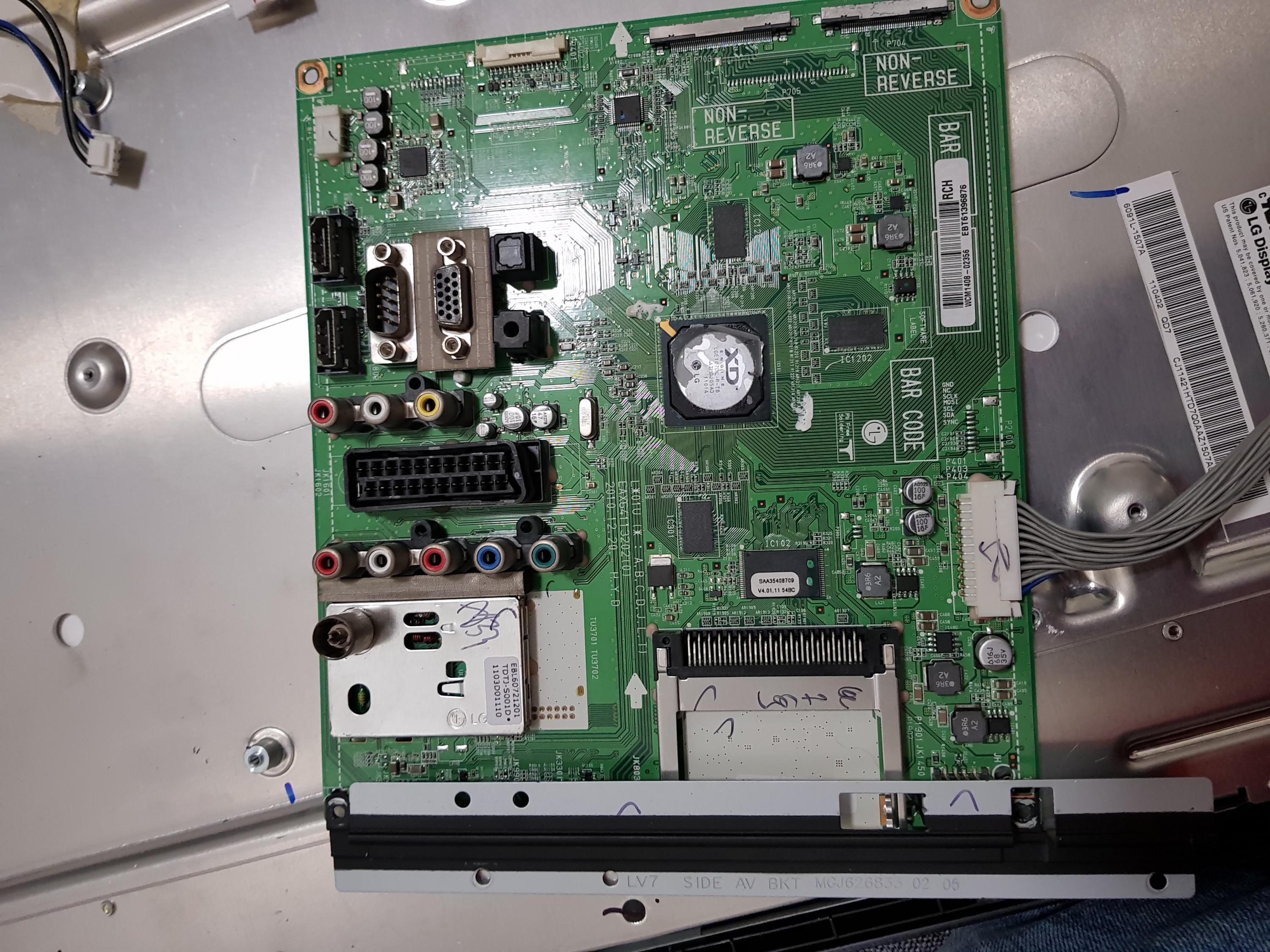

    Re: lg tv 42lv450 does not start
    could it be the motherboard?
      Need voltages from connector that goes from power supply board to main board. Will need pin#- PIN DESCRIPTION -Pin voltage in standby-Pin voltage when pushing power button and picture of connector on power supply board.
      Format:
      Pin# - Pin Description - Pin Voltage standby - Pin voltage power on
      1 - XXXXXXX - XXv - XXXv
      2 - XXXXXXX - XXXv - XXXv
      3 - XXXXXXX - XXXv - XXXv
      4 - etc.

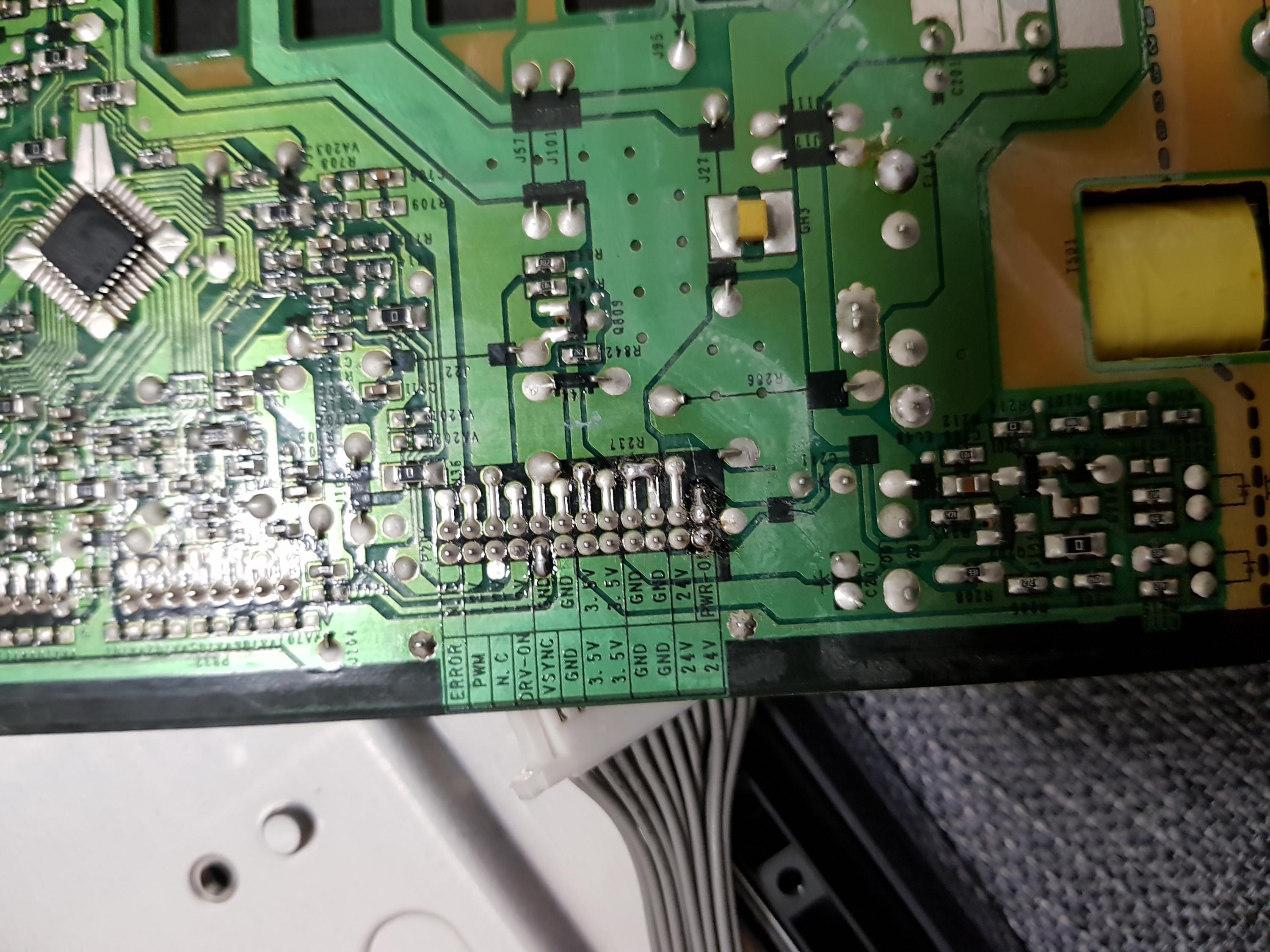

          Here is the pin situation:
          ERROR 0V
          PWM 0V
          NC 0V
          DRY ON 0V
          VSYNC 0V
          3.5V 3.5V
          24V 0V
          PWR ON 0V
          I forgot to tell you that the relay does not attack
            What are voltages when you push power button?
            • freakaftr8
              • Oct 2012
              • 3743

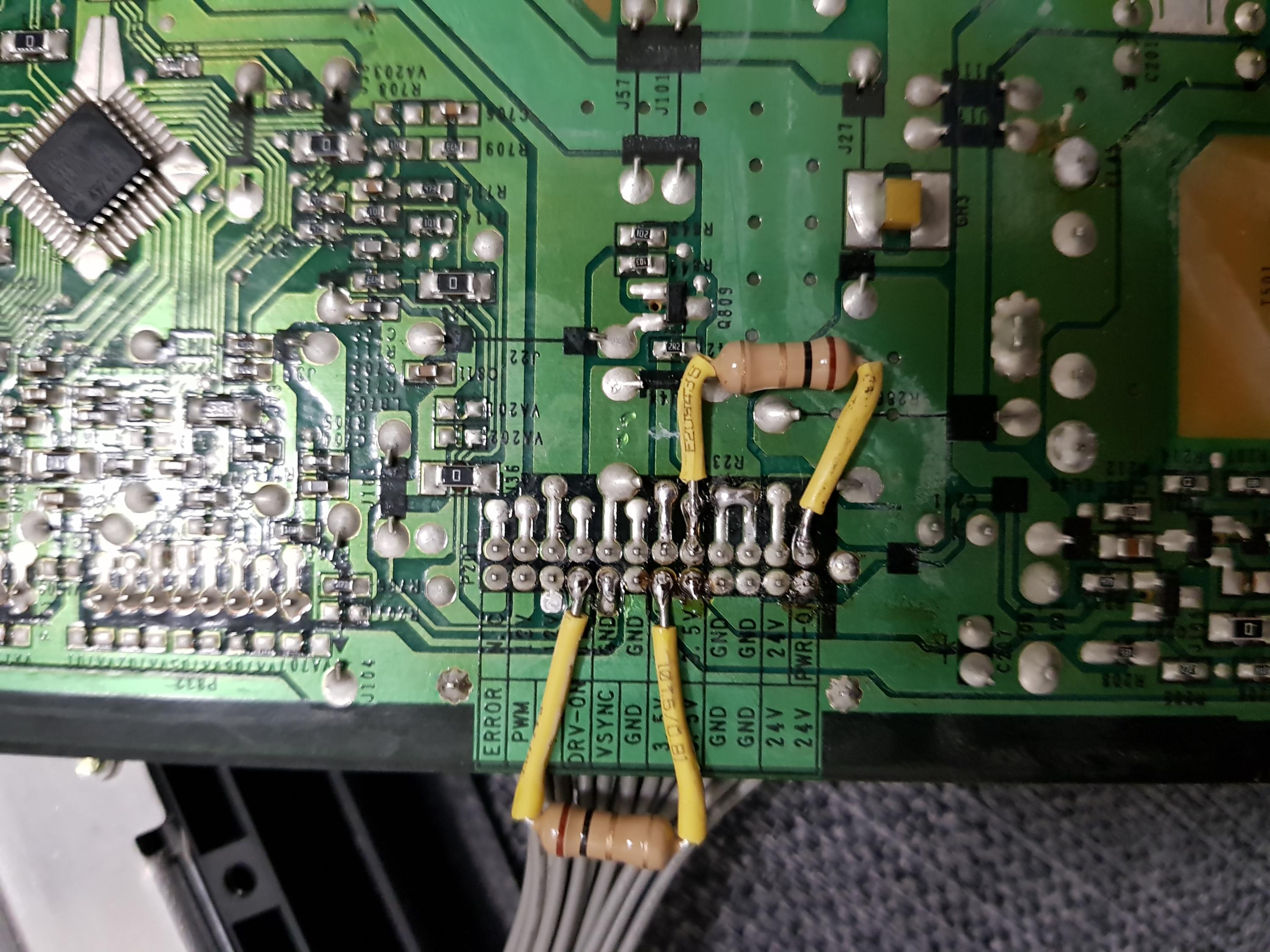

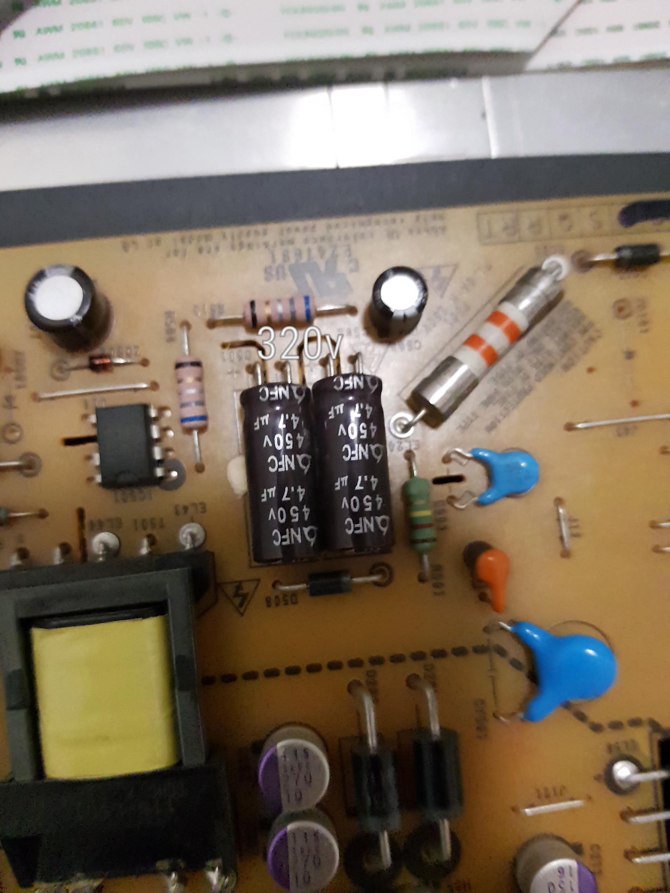

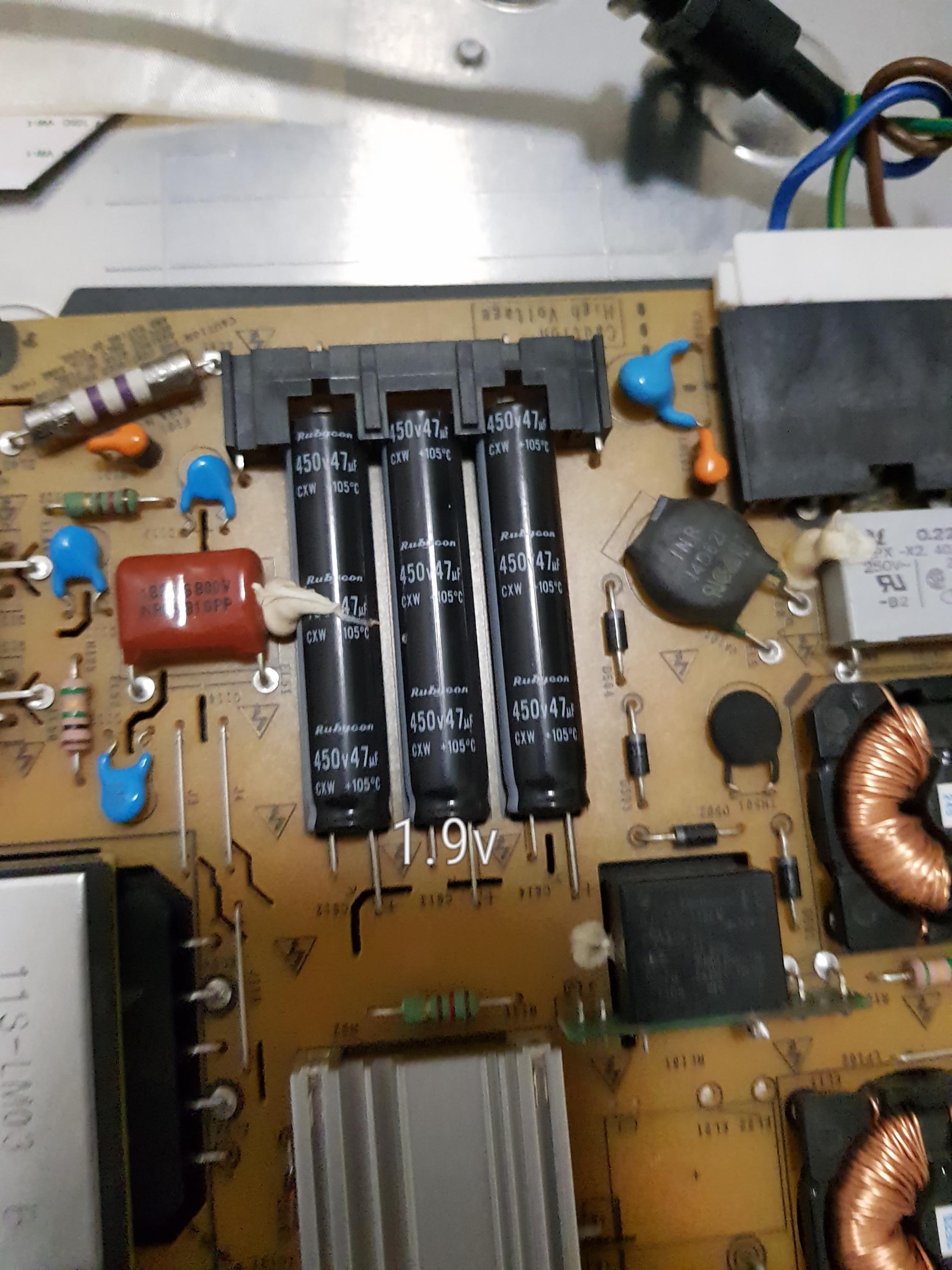

              What is voltage at the main capacitors on hot side of power supply upon pressing power button?
              Link PWR_ON to 3.5v with a 1 ohm resistor on th e P201 connector. You should have relays click and energize power supply. Check capacitor voltages again.
                I measure 1.9v and 320v in attached photo

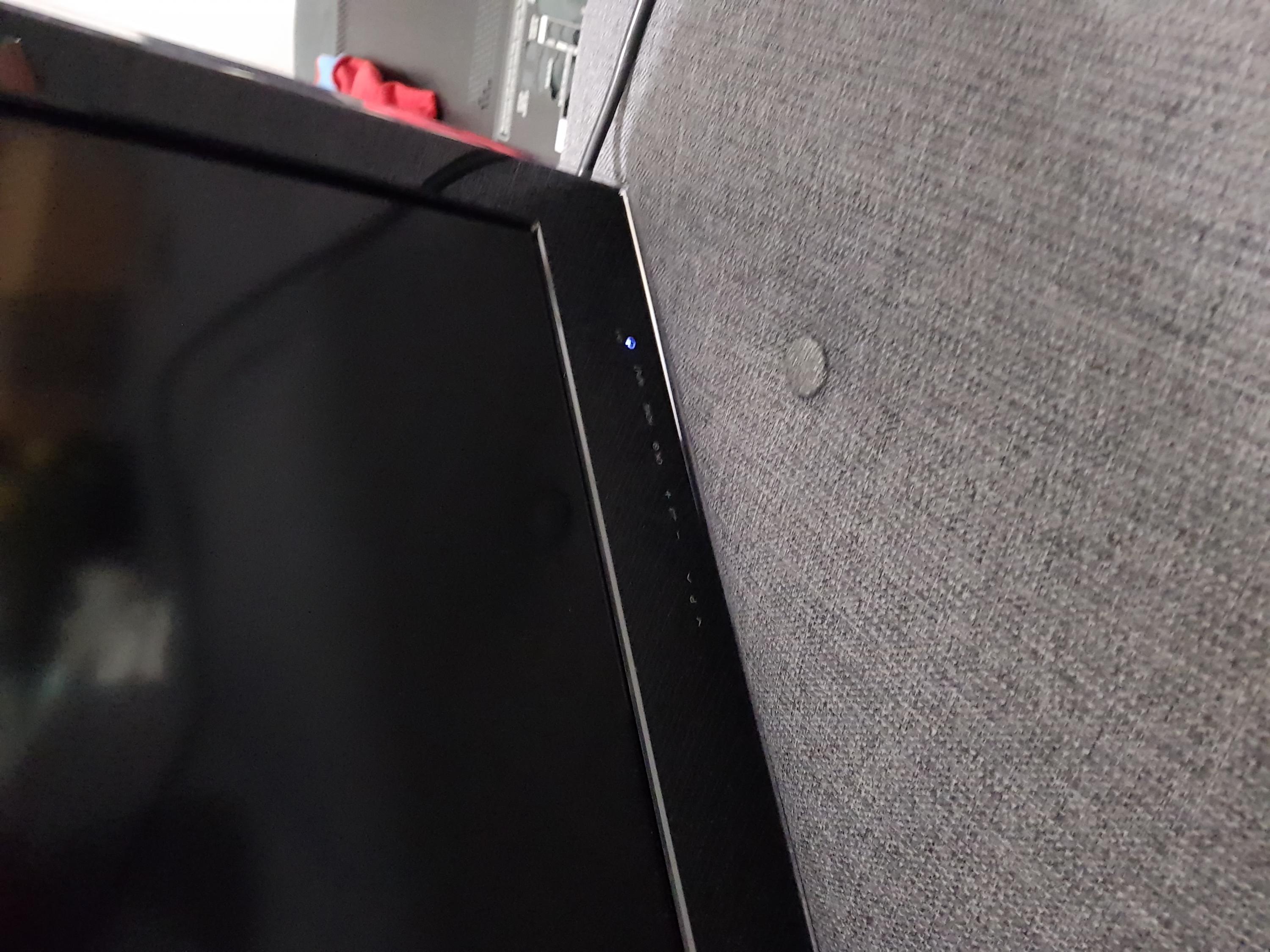

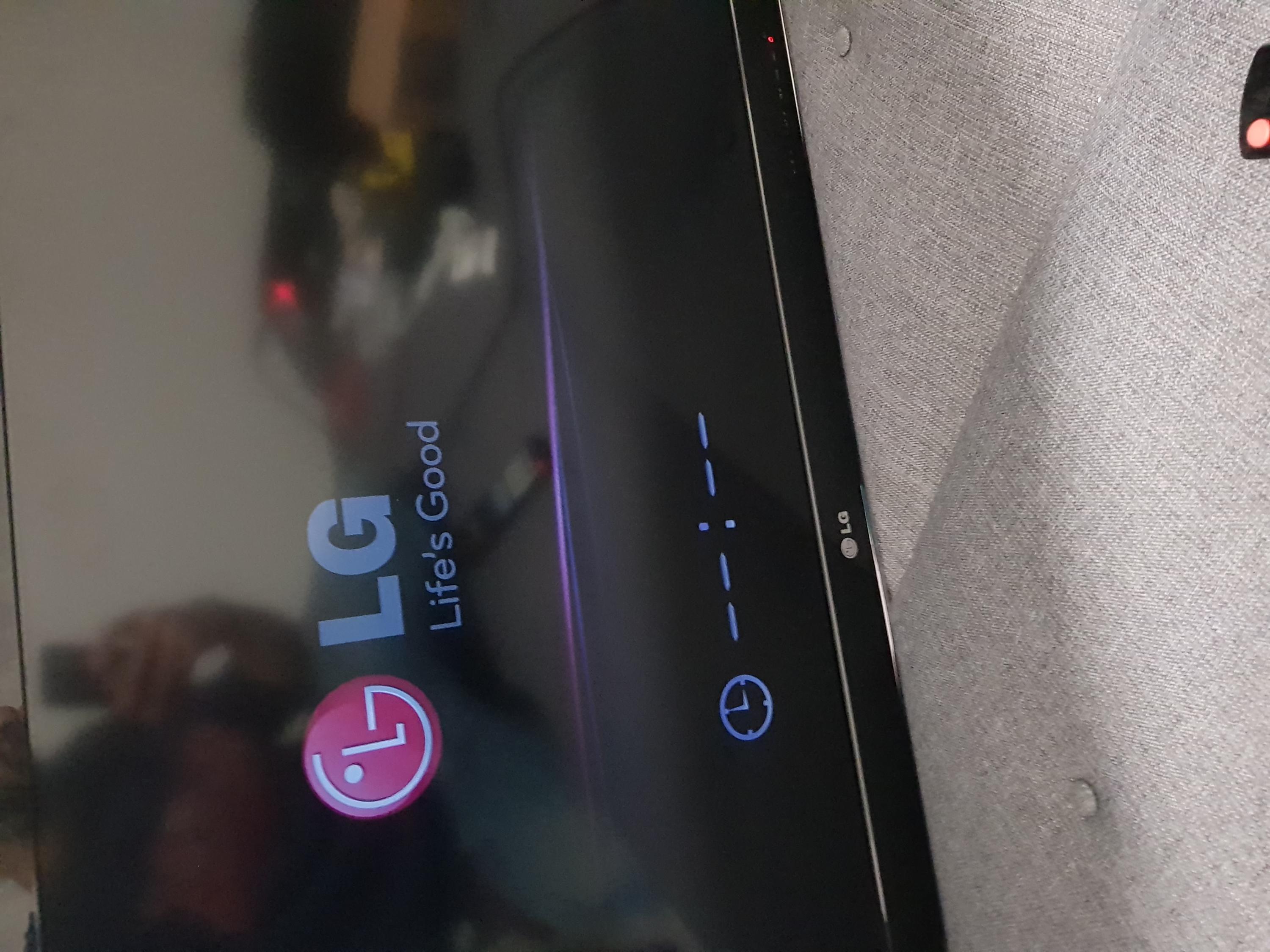

                  connected resistance as mentioned, the TV now turns on appears the logo lg and then the display remains black
                    Screen remains black because you also need to jump PS on to DRV on. If that works and turns on backlights, your mainboard is bad.
                    If back lights come on do you have a blank picture?
                      what is ps? I have DRV-ON where do I have to connect it?
                        Also to the 3.5v
                          Nevermind. Your picture shows that it's lighting up is it is stuck on the logo?
                          * Before you had mentioned that it was just blank I didn't see you added the fact that you have a logo and backlights.
                            then, without connecting DVR ON at 3.5v the TV turns on shows the logo and then remains black without backlight, now I try to connect the DVR ON at 3.5v and I'll let you know
                              I'm sorry I changed after the message, proceed with connecting the DVR ON to 3.5v?
                                Yes try connecting DRV-ON With 3.5v also. It should cause of backlights to remain lit even with a blank screen if it's trying to blank out after the LG logo
                                  You MUST disconnect the DRV-ON wire going back to the main board first otherwise you will damage the switched Transistor on the main board that is in the full on mode right now.
                                  I always use resistor in case you make wrong connection or forget to disconnect the wire back to the main board first.
                                    in this way right?
                                    • freakaftr8
                                      • Oct 2012
                                      • 3743
                                      Yes you will want to remove the drive pin from the connector at the main board side Before powering up
                                        with the connection as above, the TV turns on but does not show anything even the logo that I could see for 10 seconds before
