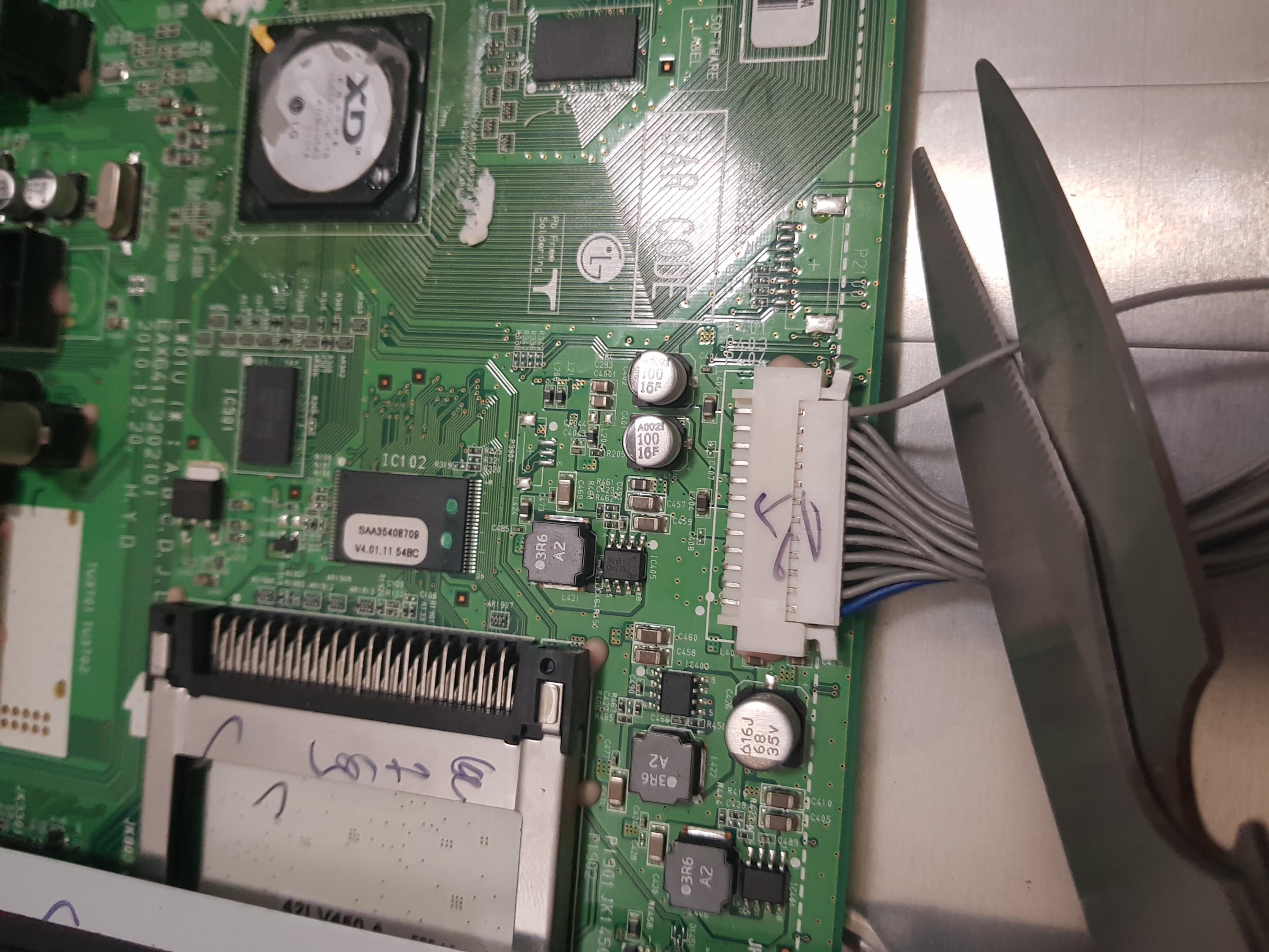

    You did remove the Pin from the connector at the main board 1st right for DRV-ON?
      Re: lg tv 42lv450 does not start
      but if I unplug the connector from the motherboard how do I turn on the TV?
        You will not be unplugging the whole connector just the individual pin for that DRV-ON. You can use a knife tip To pull up the plastic tab what that will allow the pin to come out
          I did not understand, do I have to cut it?
            now I understand sorry, but the DRV is not the first to the right does not do anything? Here's the picture
              I tried to disconnect the pin as pictured and the TV turns on and remains the black screen, if I try to disconnect the 1st right from the motherboard the TV does not turn on has the initial problem or red led flashing white flashing and then nothing

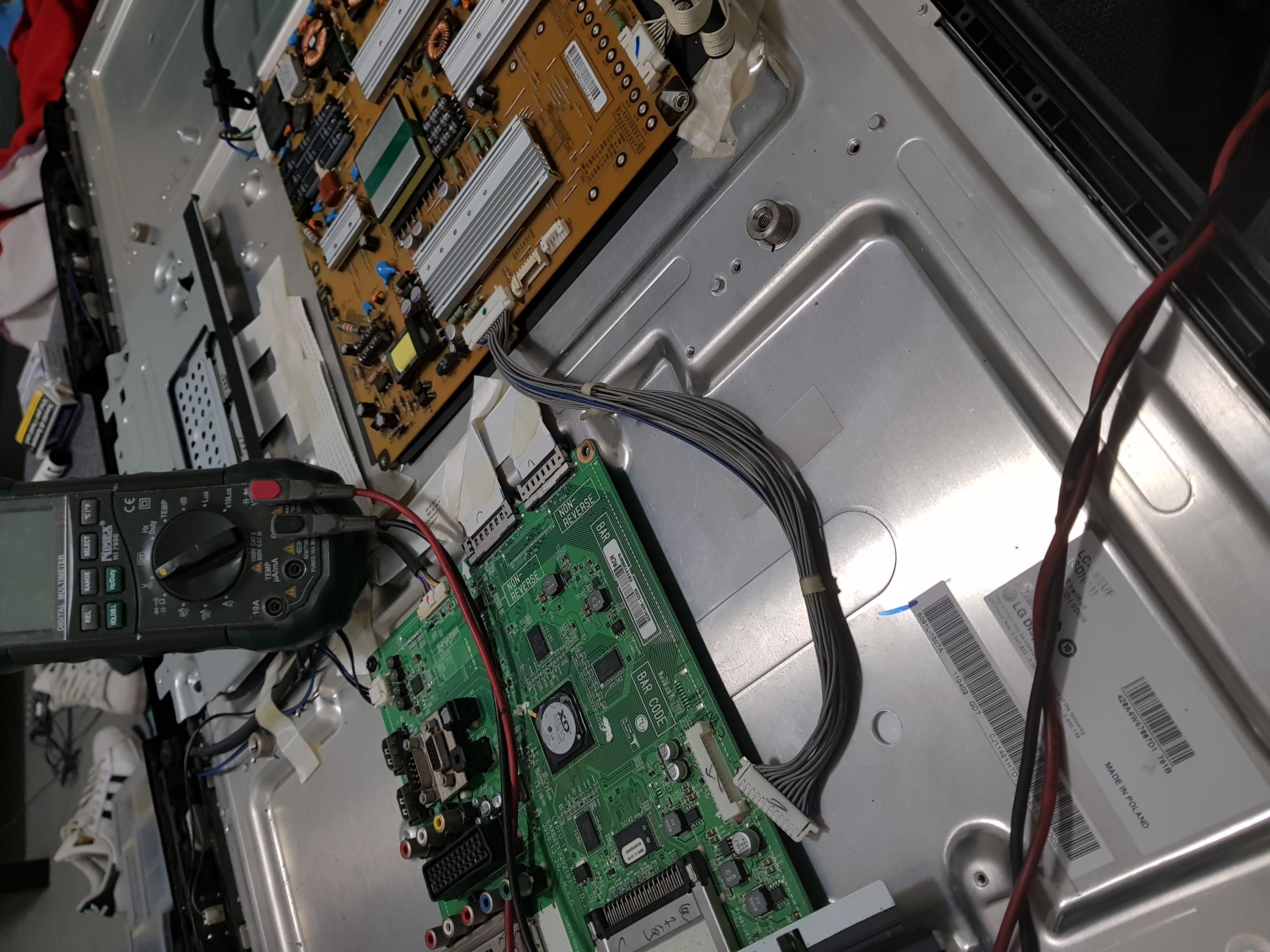

                    So what your saying is back to trhe way it was with no DRV-ON connected and pin back the way it was your not getting any backlights?

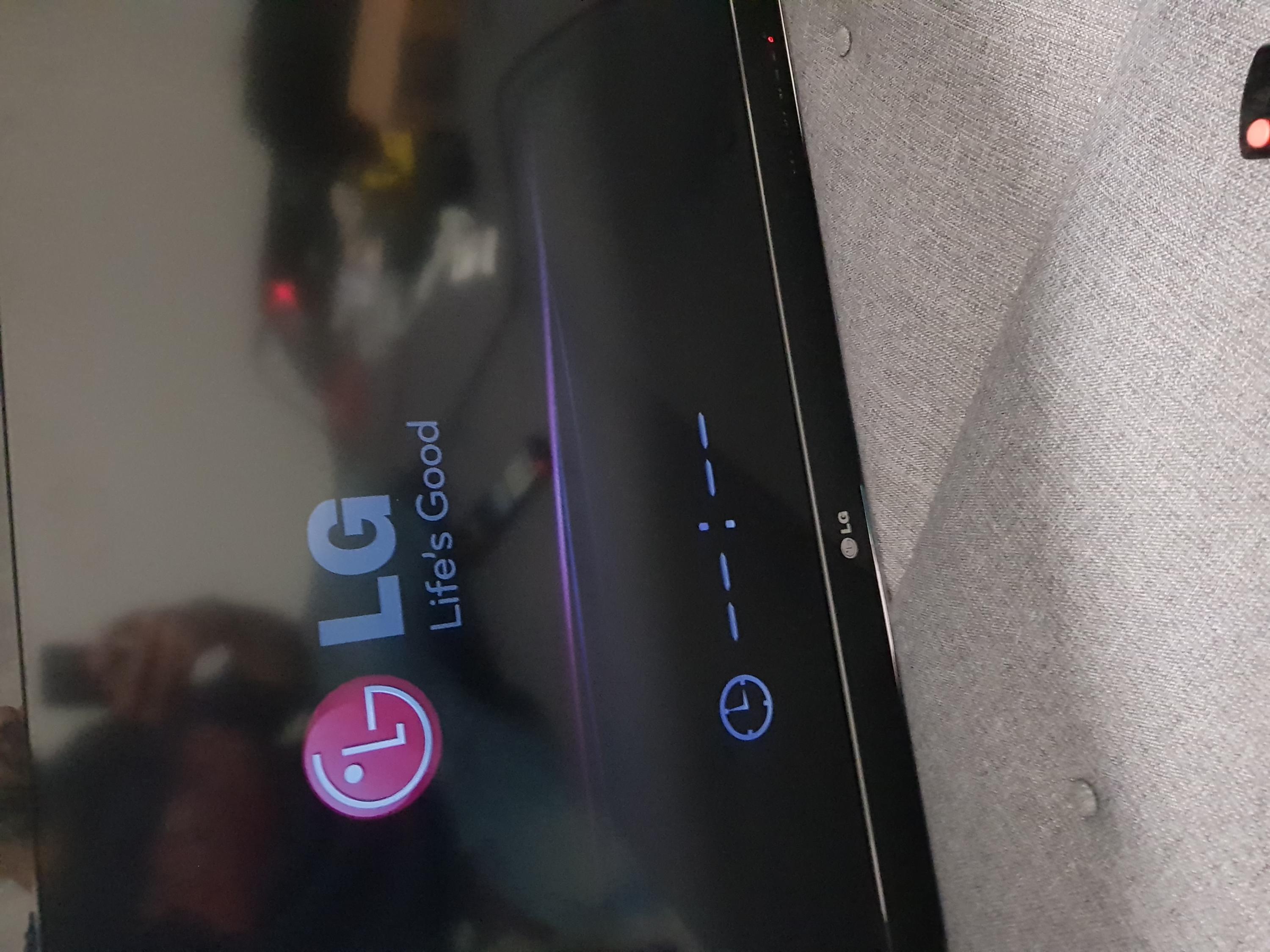

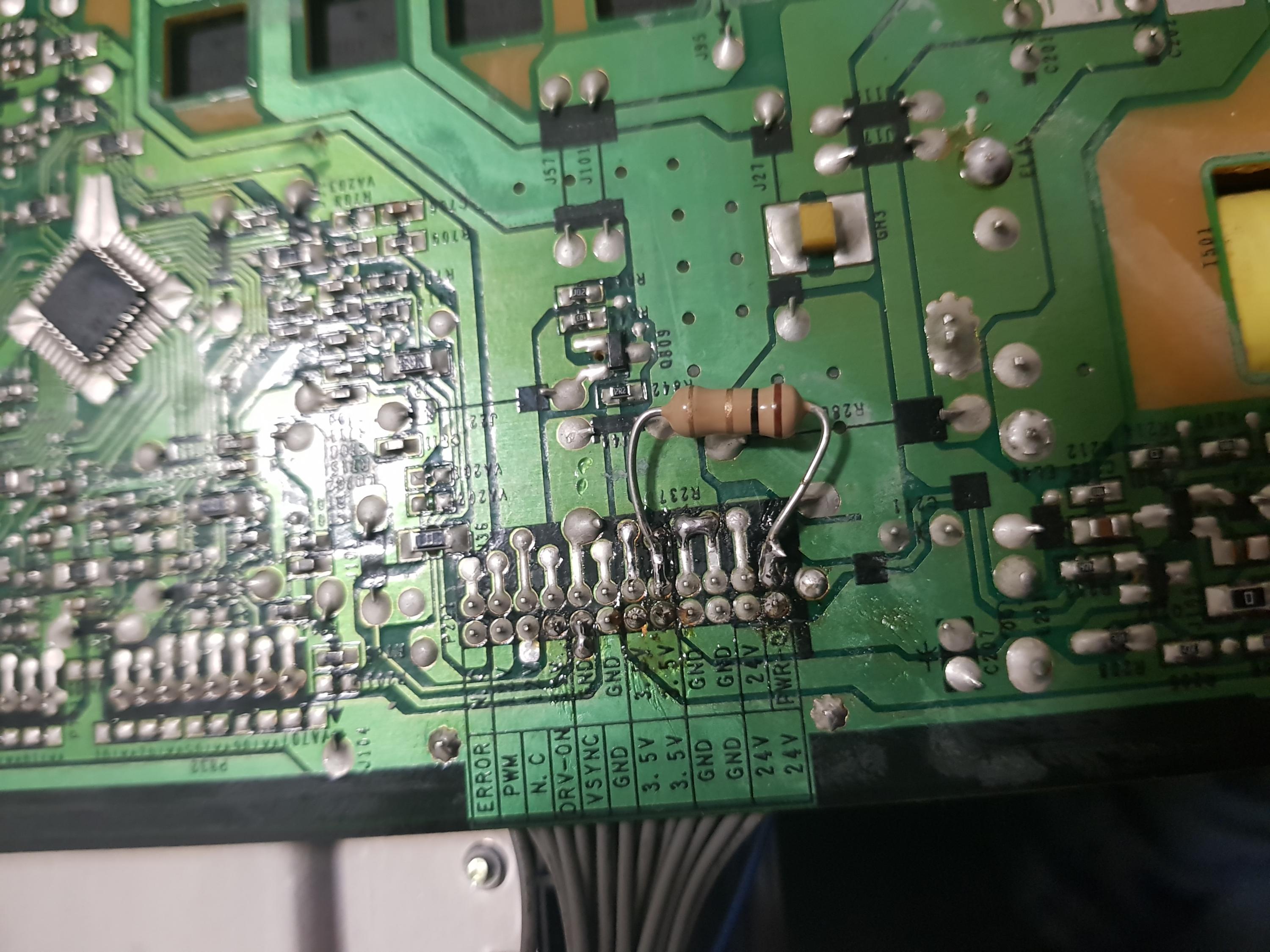

                      practically with the jumper between pwr on and 3.5 volts the tv first showed the LG logo. Now always with only the jumper between PWR ON and 3.5 volts the TV does not start, the red LED flashes, the white flashes and then goes off
                          with only the PWR ON at 3.5v the TV turned on and for a few seconds showed as photos
                                          but the power on in this way is not bypass?
