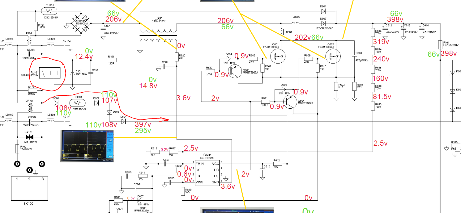

LG TV 49LW5700 does not power no Standby Voltage(PSU EAX62865401)
  • mohsinrizwan
    • Aug 2020
    • 25
    • Pakistan
    I have LG 49LW5700 which is not turning on, when I checked there was no standby (3.5V) can anyone guide how I can trace which component is faulty.

    Re: LG TV 49LW5700 does not power no Standby Voltage(PSU EAX62865401)
    Need good pictures.
          If you have no voltage, check for voltage at one of the 3 main caps. If voltage then check ic501 for vcc voltage, datasheet.
            Check if F501 is ok or open.
              F501 is OK
                Main 3 Caps has no voltage, IC501 not seeing any VCC voltage.
                but 2 Caps near IC501 has 280V
                  Not sure. Ic501 may be driver for backlights. I'm no expert. I would need to see datasheets for driver IC's.
                      my bad, VCC on IC501 is 9V which should not exceed 3-5V
                        Power Supply LG LGP4247-11SLPB
                        EAX62865401/8 EAY62169801
                          So thanks to LOTAS, vcc should be 16v.
                              Check these diodes for a short circuit.
                                both are good, not short.
                                Also I am not getting 220V and on stand by bridge should generate 66V which its isn't
                                  You will not have power on the diode bridge until the relay turns on (transition to operating mode), now power is supplied through these diodes D501-D504 (standby mode).
                                    With ic501 vcc at 9v, this suggests the startup cell internally is working. I suspect C508 and C507 could be bad, I would first replace C508 and see if the vcc comes up.
                                    I would also check the voltage on pin4 FB/OLP
                                      Replaced both caps but no luck still 9V on VCC
                                        any possibility I bypass standby and give 3.5V externally?
