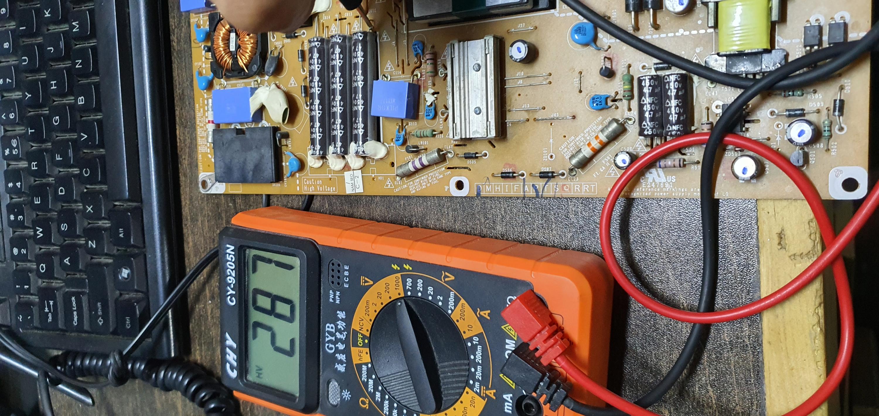

                  Re: LG TV 47LW5500 does not power on (PSU EAX62865401/Main board EAX64405501)
                  all three caps has 275V and fuse it fine

                    That is very low.
                    What is your AC line Voltage, 230V? If it is 230V you should have about 325V when not force on, about 380 ~ 400V when forced on.
                    Are you sure you're only getting 275Vdc?
                      yes its 275V (sometimes it goes to 278/285) and yes I am on 230V
                      with force off I am getting same 275V

                        275VDC on the main caps is not right all.

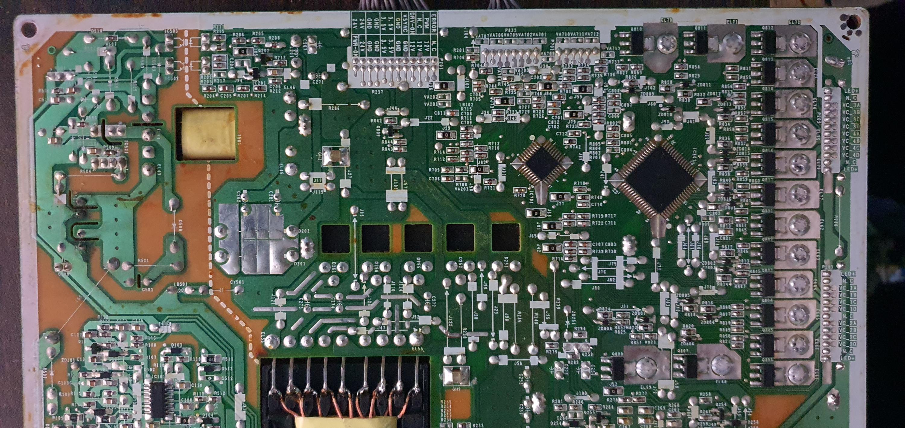

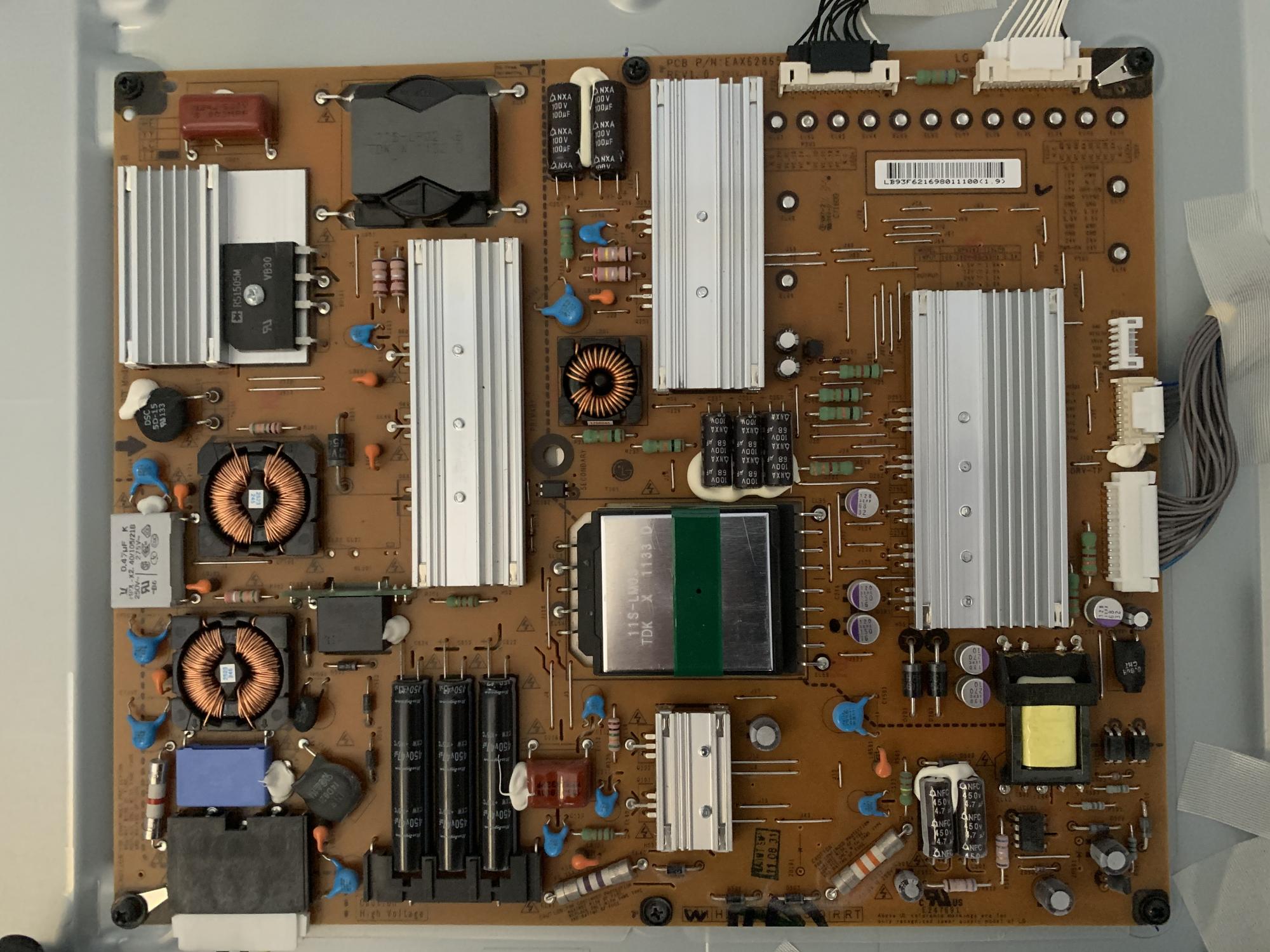

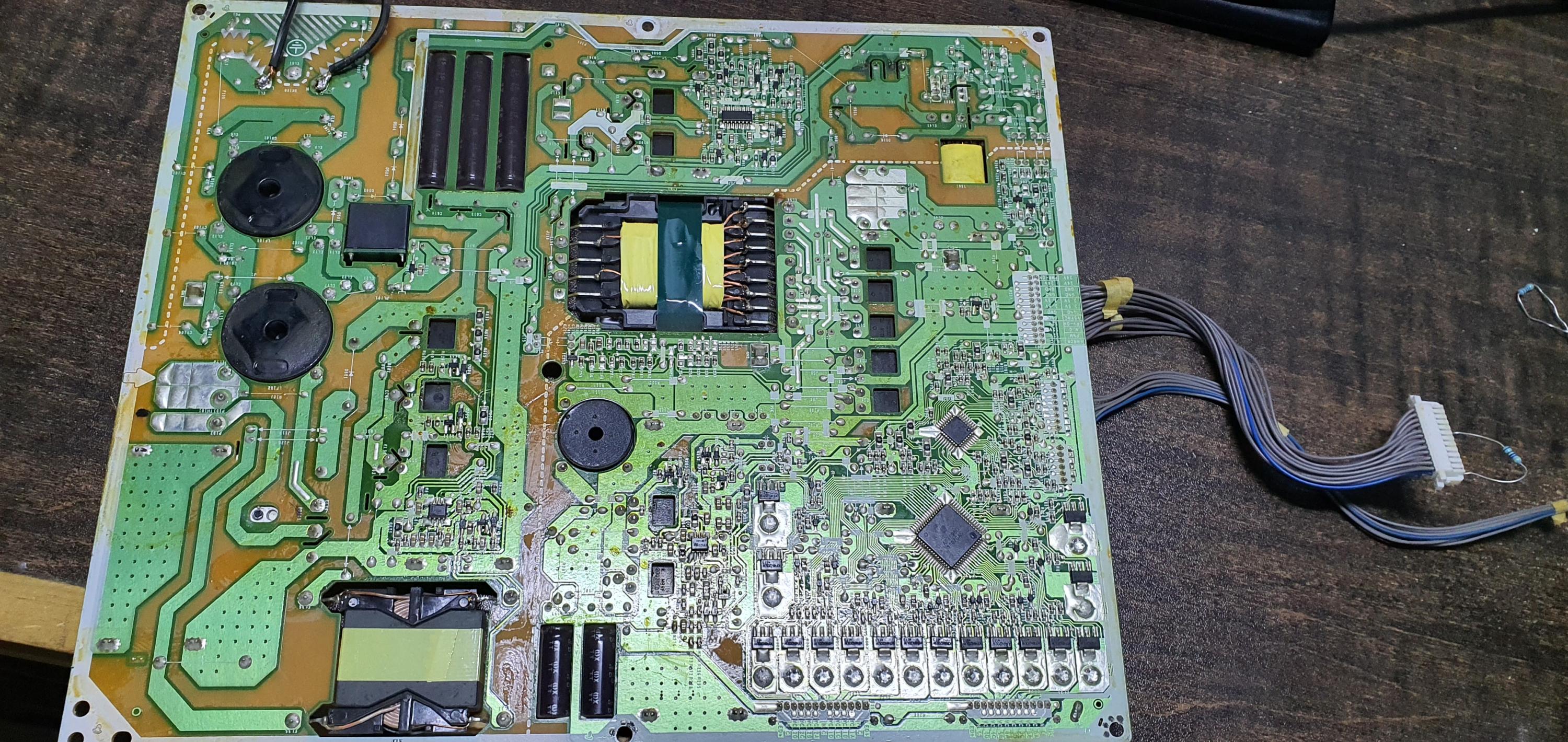

                        Can I see good clear straight shots of the whole bottom side of the power supply board?
                        BTW, do you hear the power relay clicks on when you apply the force on (jump)?
                          attached

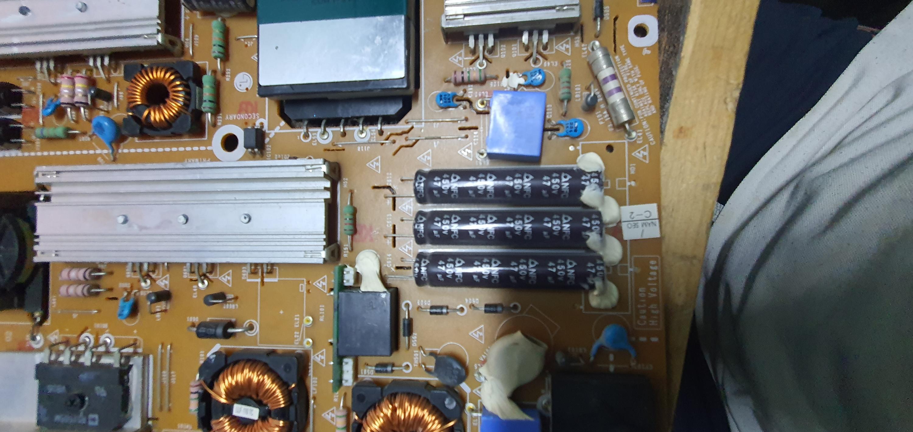

                              https://www.badcaps.net/forum/attach...8&d=1596433739
                              I only see Black probe on Neg. leg of the cap. Where did you put the red probe at?

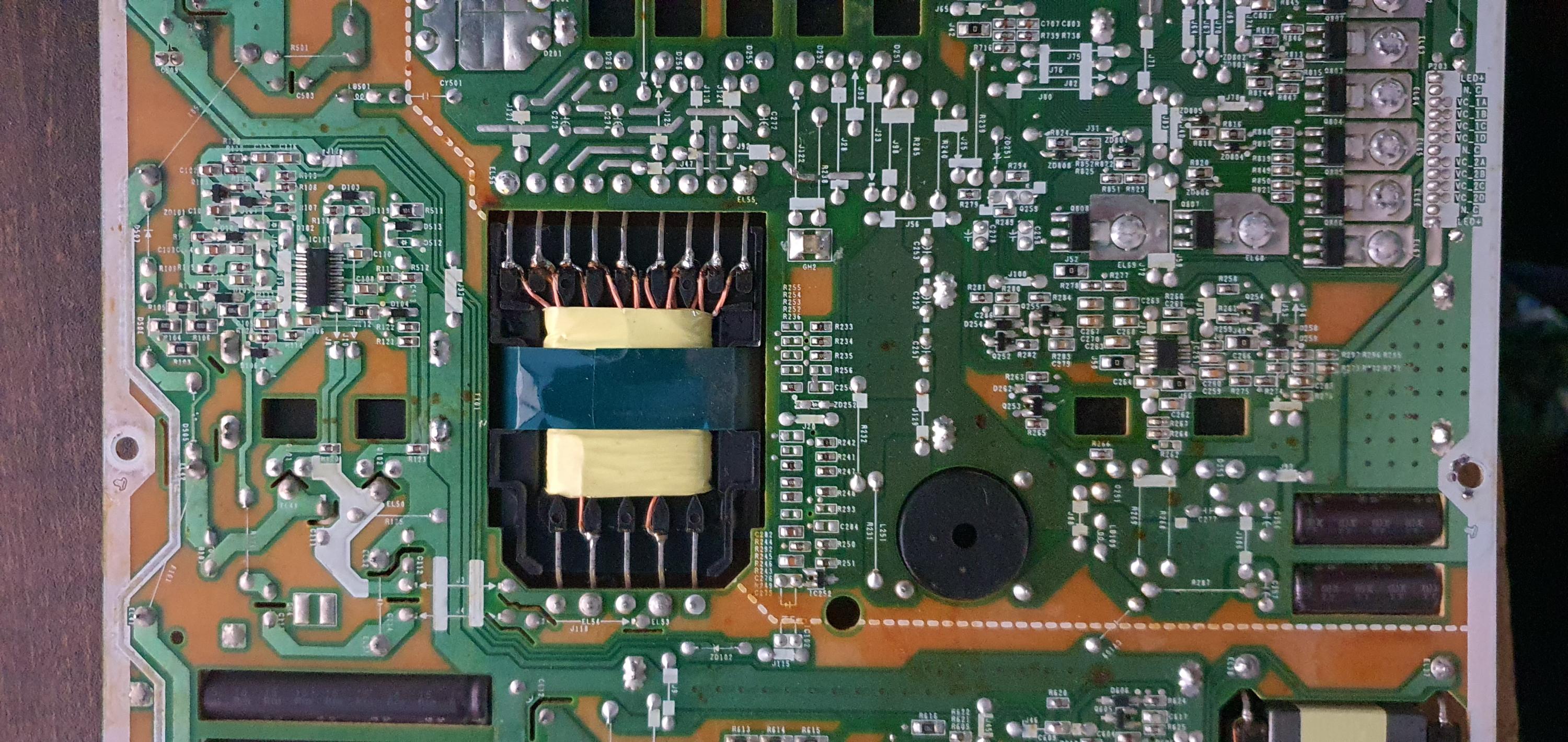

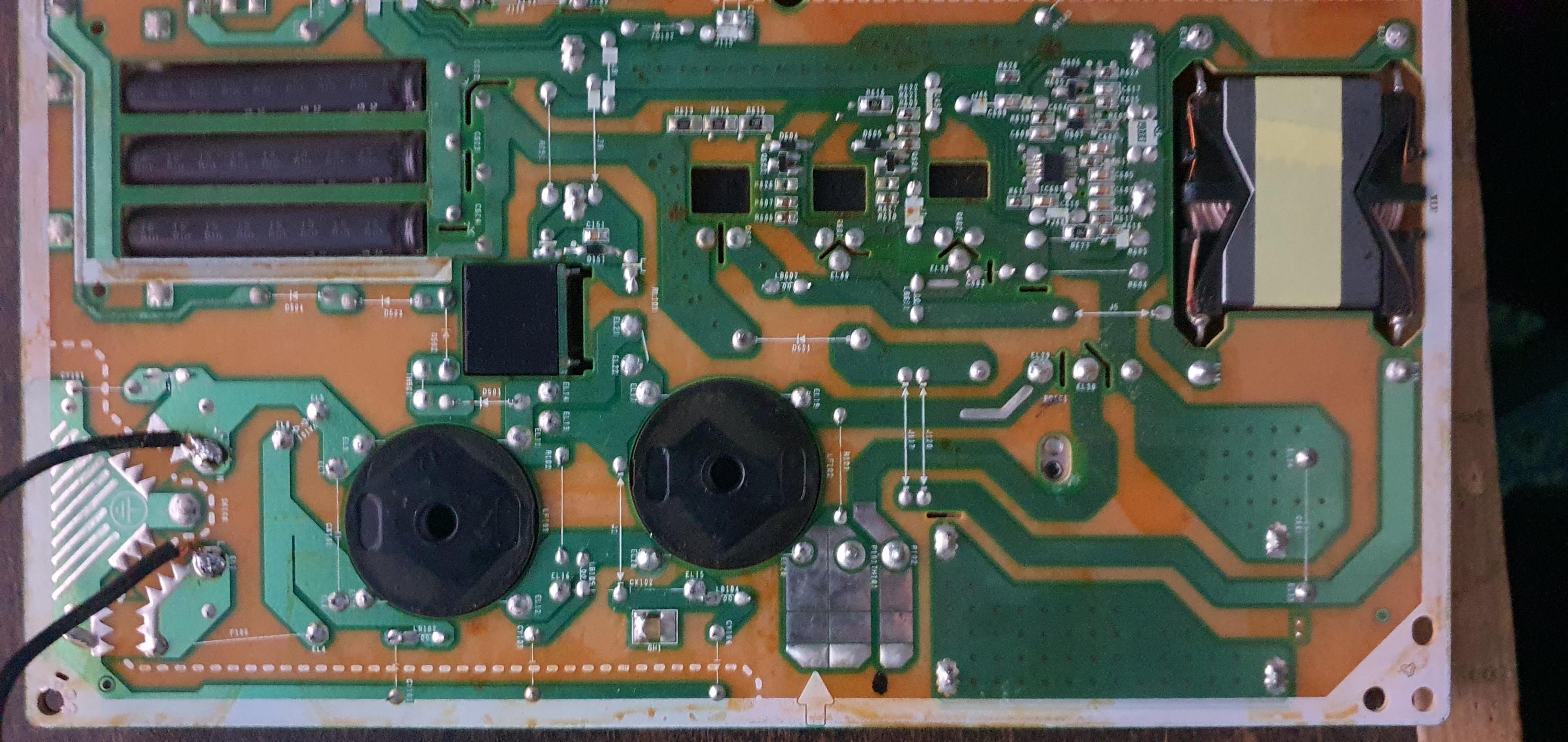

                                https://www.badcaps.net/forum/attach...9&d=1596433739
                                I need straight shots pictures of the board, not in angle like that, because I need to be able to trace out the traces on the board to see what is going on.
                                  I put red prob on positive of cap
                                  I hope these pictures are usefull

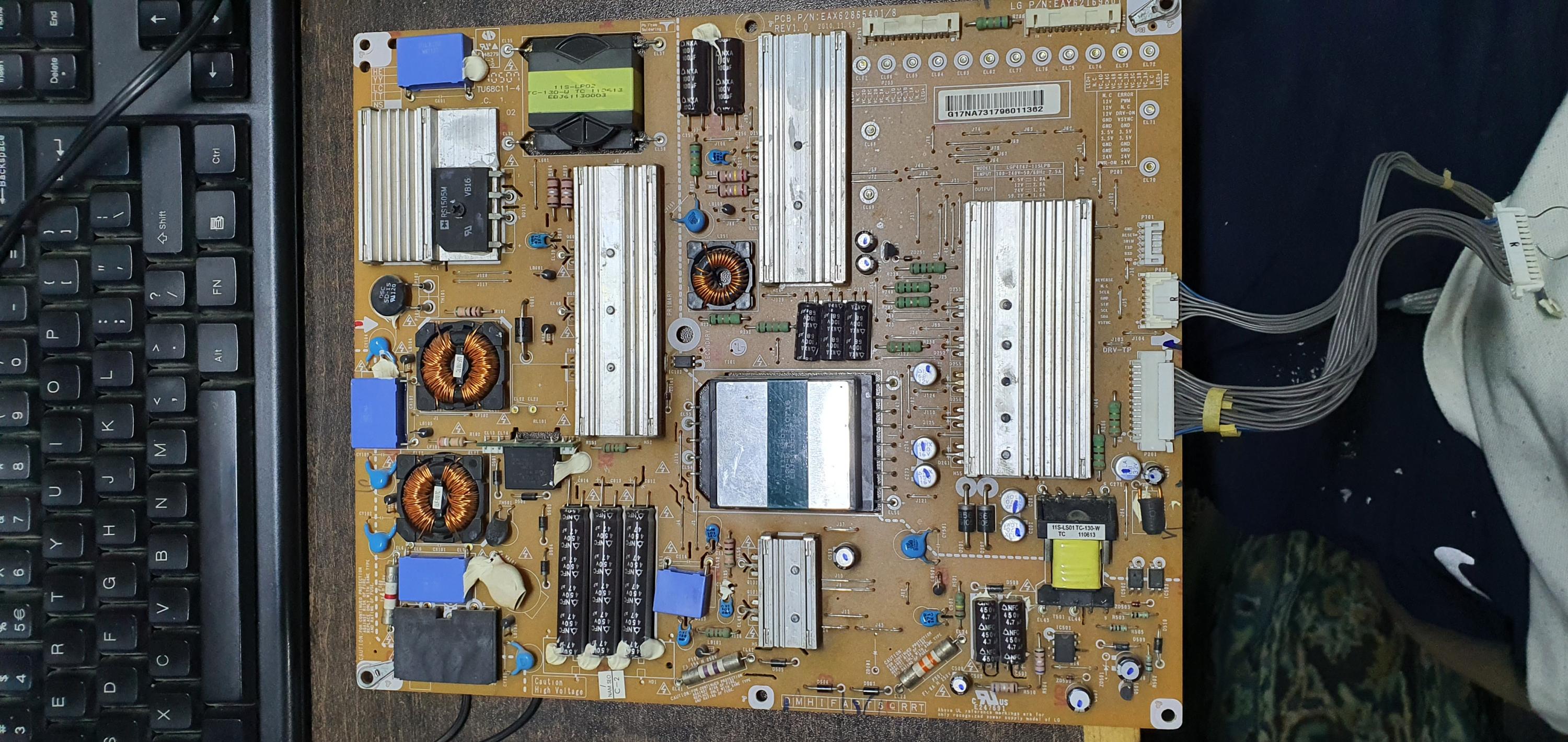

                                    Are you sure the meter is good on 1000V scale?
                                    The pictures are much better but can you show the whole board, it is hard for me to trace out the circuit without seeing the whole board.
                                      BTW, check the AC Voltage on the two inner legs of the bridge rectifier to see what you get.
                                        sorry I went to sleep, i'll post whole board pic shortly.
                                        Bridge rectifier had 220V in inner legs, that was first thing I checked after relay click.
                                        i'l measure reading again with different meter.
