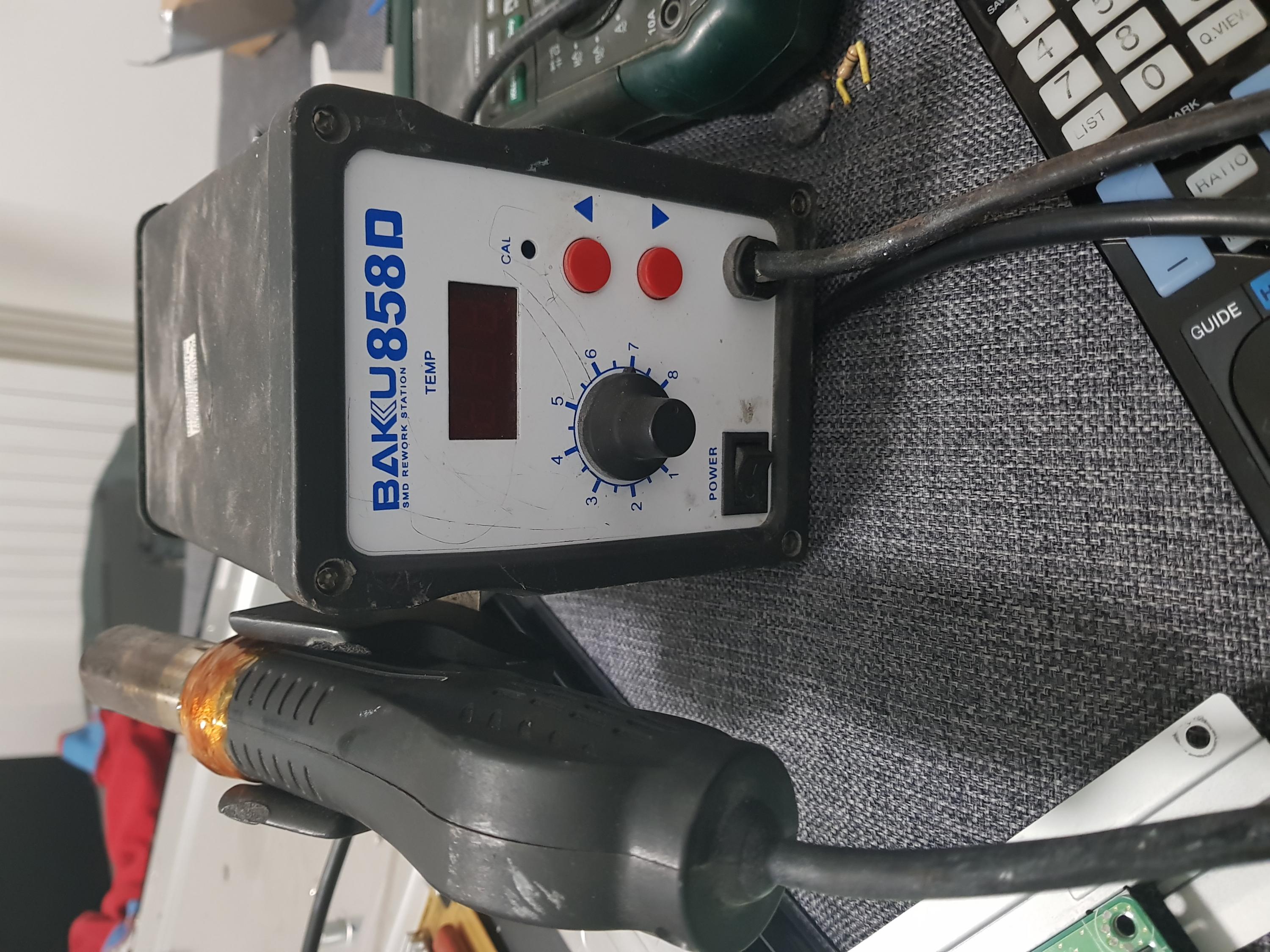

            Re: lg tv 42lv450 does not start
            Reflow bga?
              #46
              You could try before ordering a new board
                #47
                do i have to remove the power on from 3.5? after reflow?
                  #48
                  Yes if you like. But maybe leave it for now to see if you get a picture.

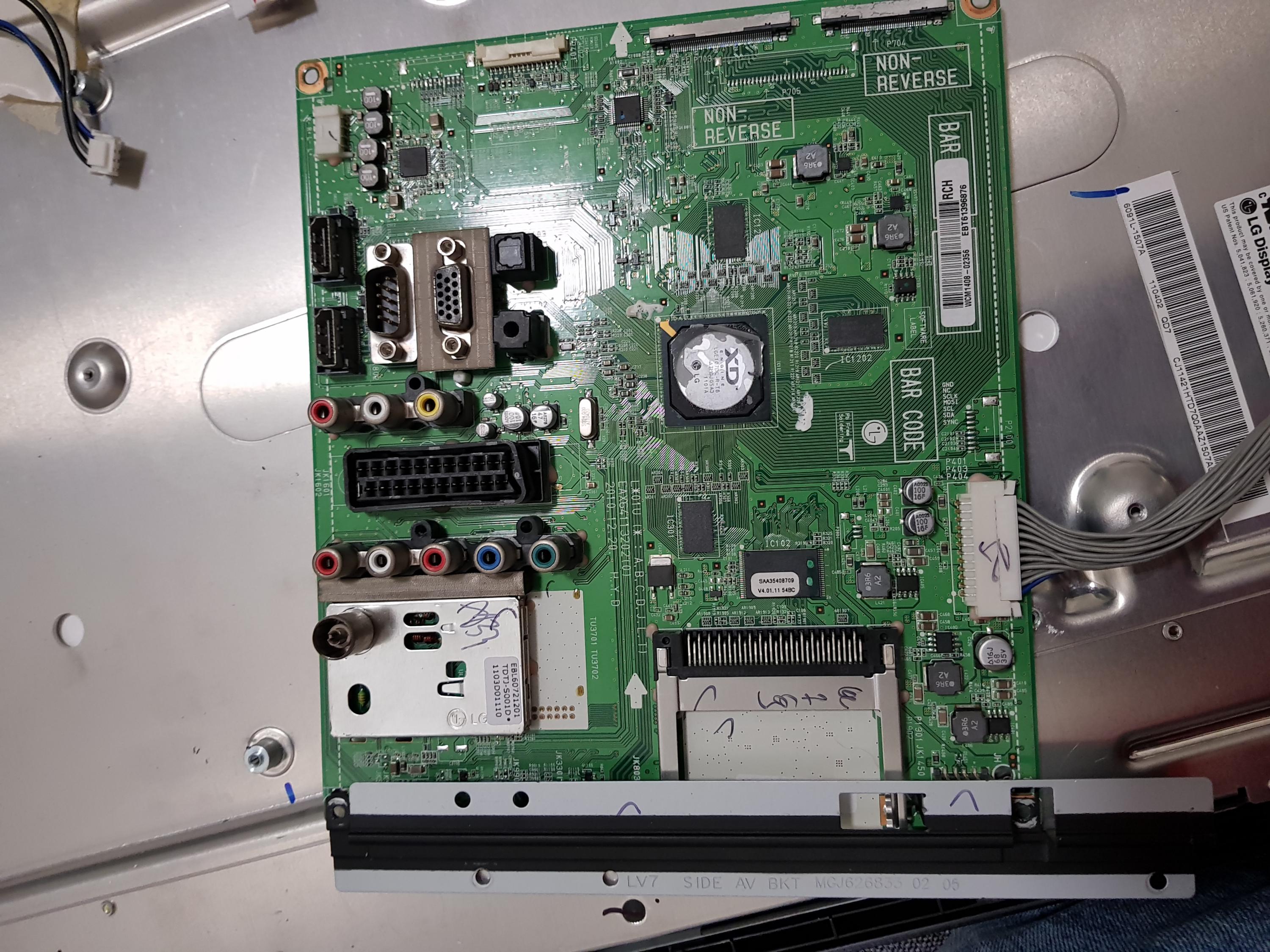

                              can I install this main? the product code is different but the data is identical
                                #55
                                  #56
                                  I'm not to sure I can't read the data on the 2nd picture. If they have a return policy could probably get away if it doesn't work
                                    #57
                                    thanks again for your help, the original card has the following serial: eax64113202 (0). I would like to mount the following model: eax64290501 (0). what data do you need?
                                      #58
                                      Sometimes even if the model number of the TV is the same they may have changed panels or some other significance throughout the model year. Sometimes those numbers change sometimes you get lucky and it works anyway
                                      So the model number of the TV the board is coming out of is the same as yours?
                                        #59
                                        the model of my tv is the following: LG 42LV450A-ZC. while that of the card I would like to buy is this: LG 42LV450U-ZC. practically changes (A) and (U)
                                          #60
                                          That's interesting that it's in front of the character designator after the- Usually anything That has to do with the model number before the hyphen usually means a product change. Like I said before the least you could do is try it if it doesn't work return it.
                                          I have used Samsung main boards that were for a year difference same size and swapped T cons between 2 different models with no problem before so you may get lucky
