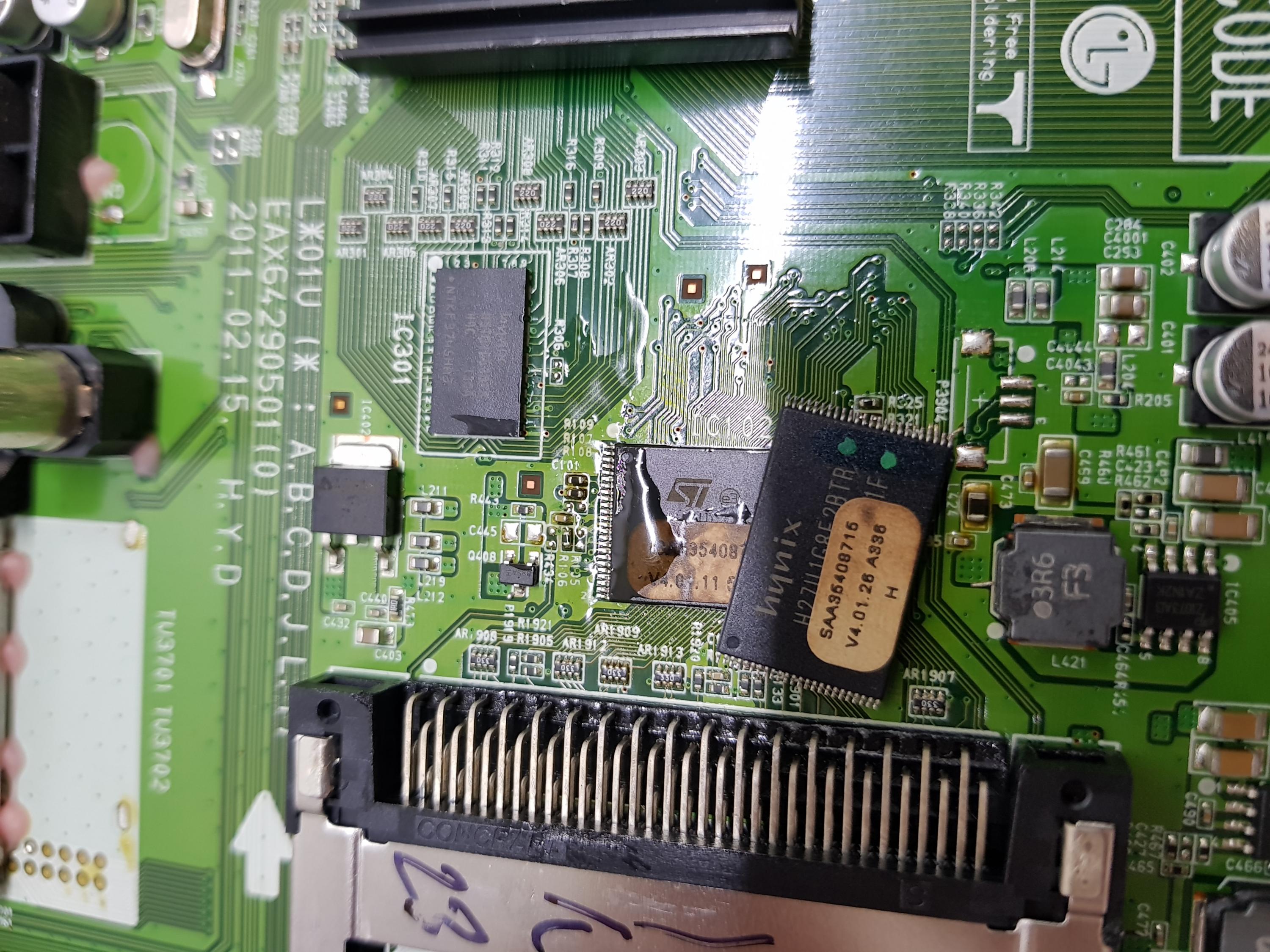

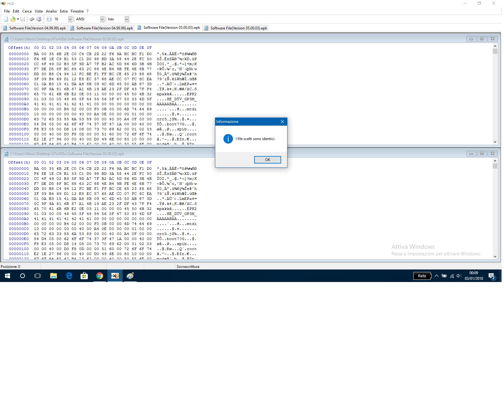

      It should and I say it should work, I do not know much about TV, I usually repair consoles and notebooks, but if my theory is the right one the card in question, even if it has a different code should work, I extracted the software for the 2 tv:
      LG450A-ZC part number EAX64113202
      LG450U-ZC part number EAX64290501
      I passed them in hex editor is compared and to my amazement the 2 files are identical. attached photo,
      what do you think?
      is my theory right?

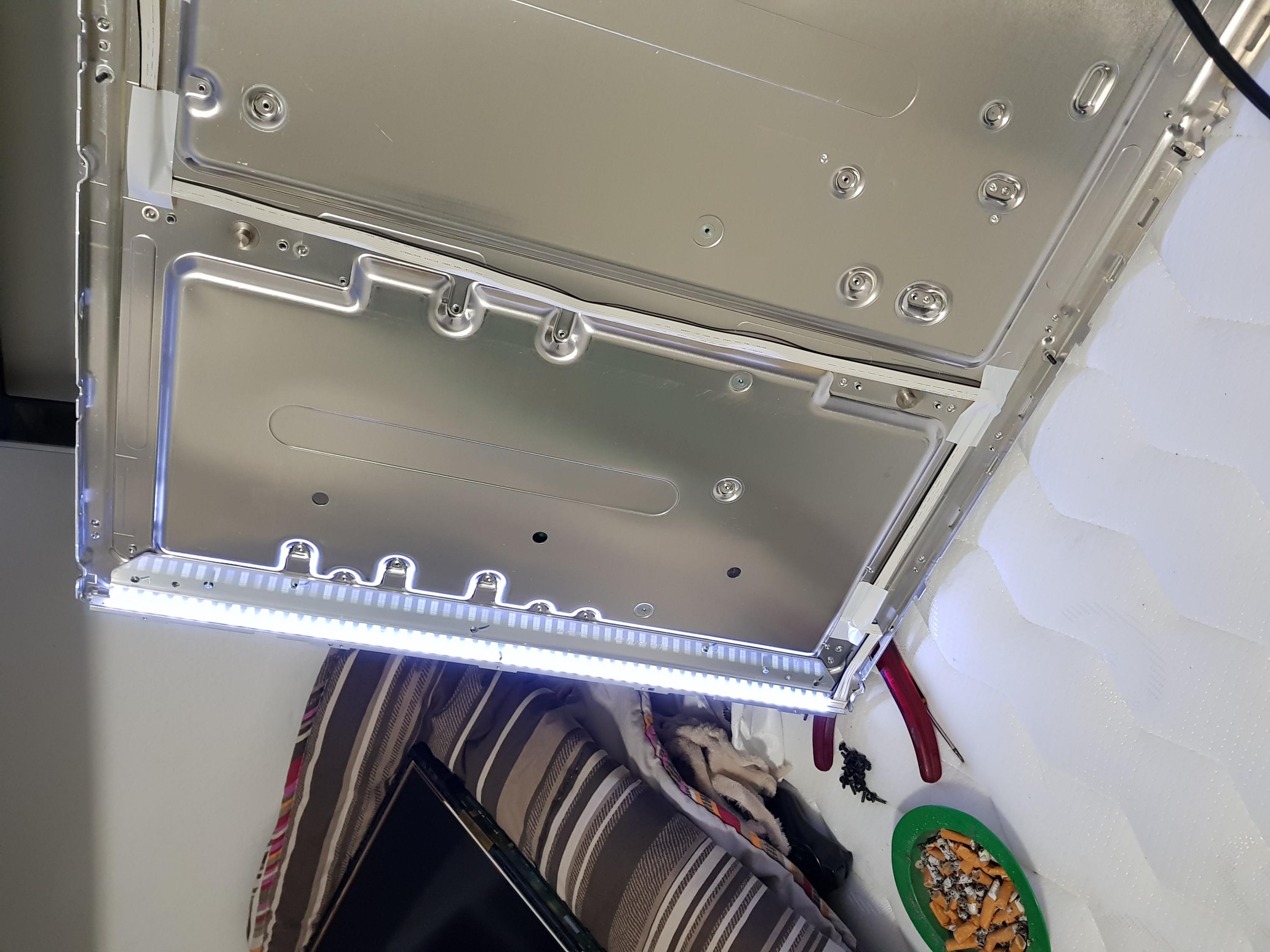

            #65
            Re: lg tv 42lv450 does not start

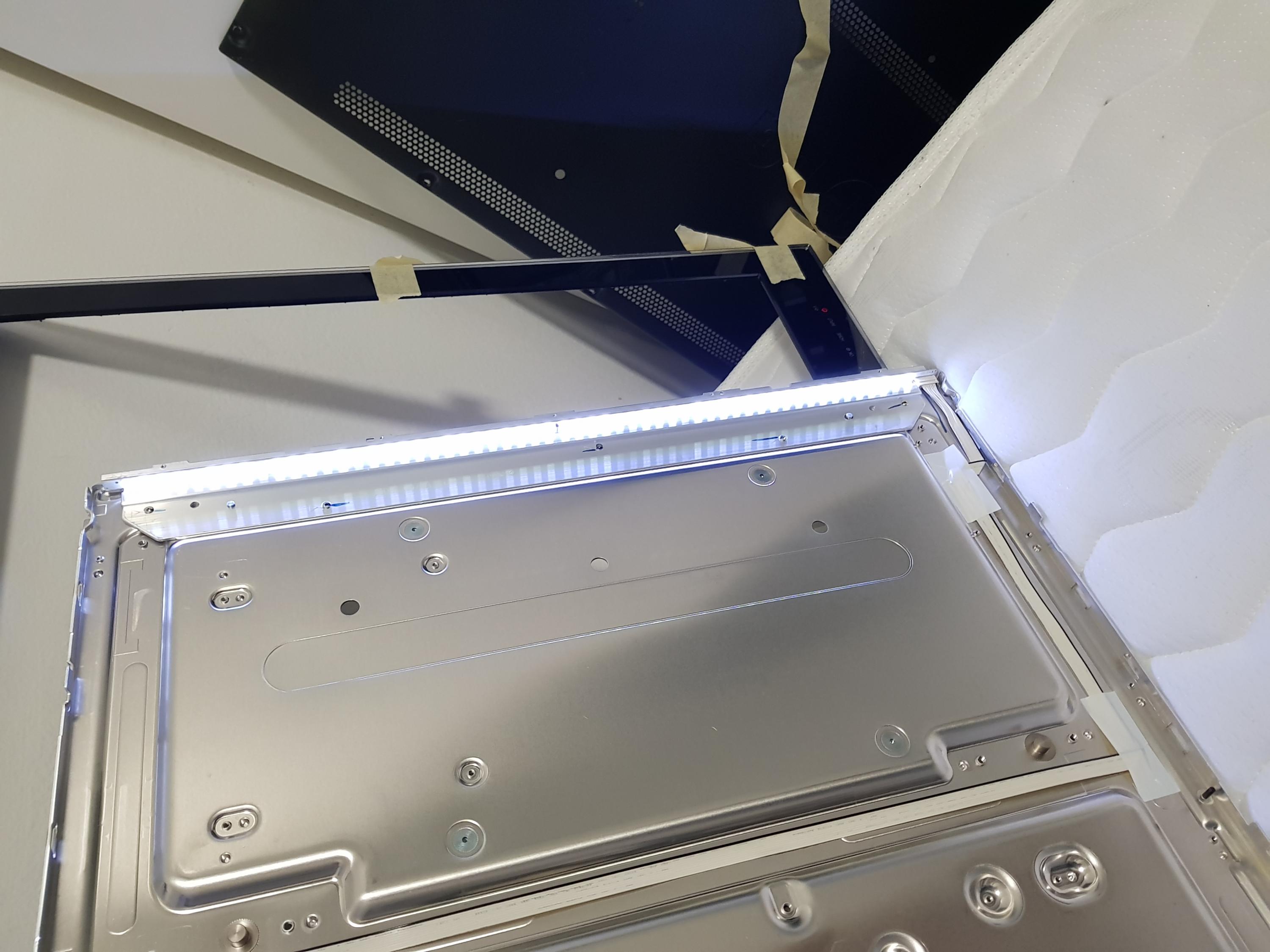

            I removed the LCD panel up to the LEDs, I started the TV and all the LEDs light up, only one LED is less bright than the others may be the problem?

              #66
              the power supply delivers 36.7v on both led strips
                In this case I would say that your back lighting seems OK Did you have a chance to look at that the DRV on signal?

                          • Italia
                          #72
                          how much I get home control, but it has happened to me a problem, a LED does not come on anymore. that bad luck, that's why I wanted to go for 12v strips

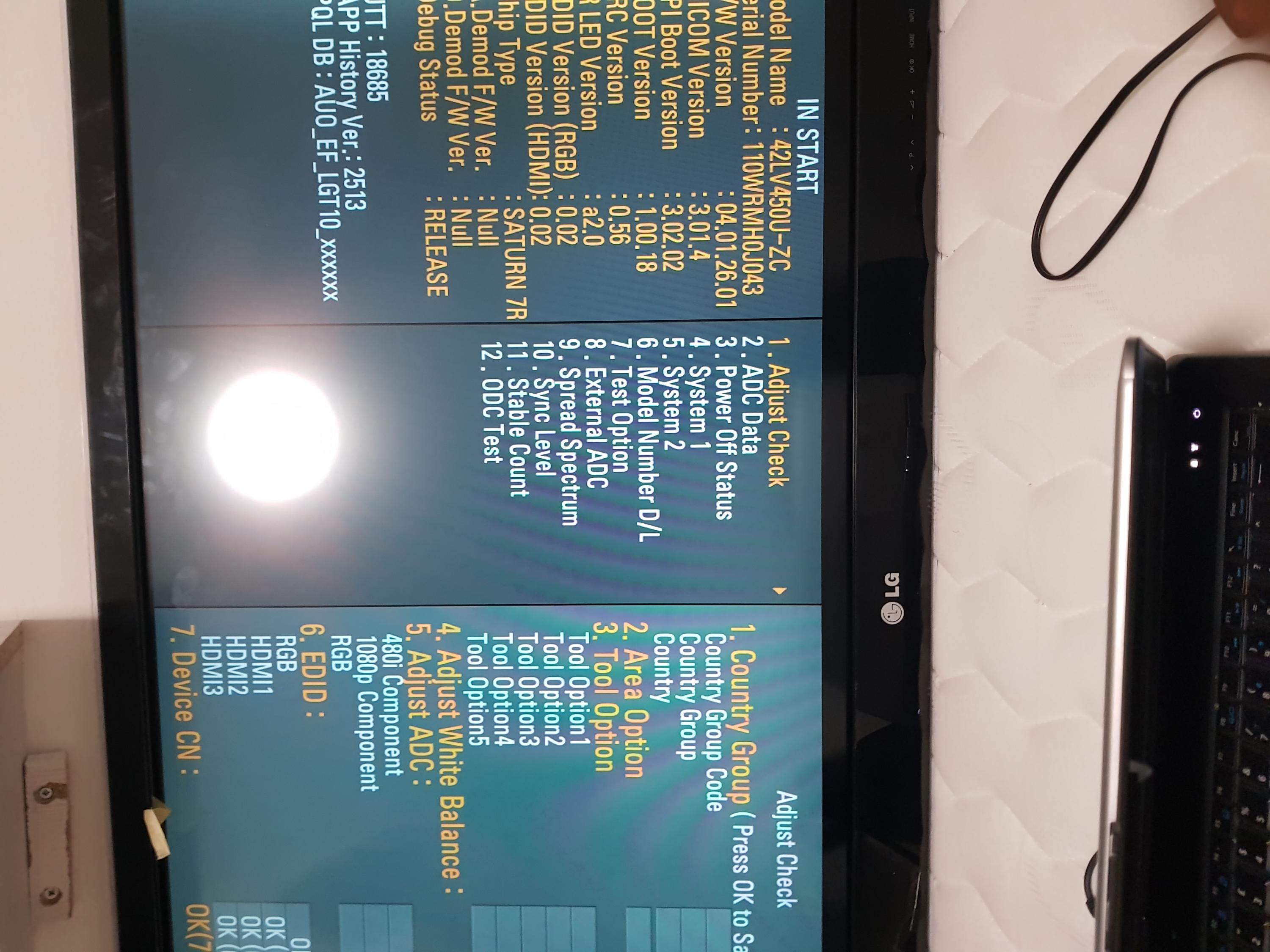

                            #73

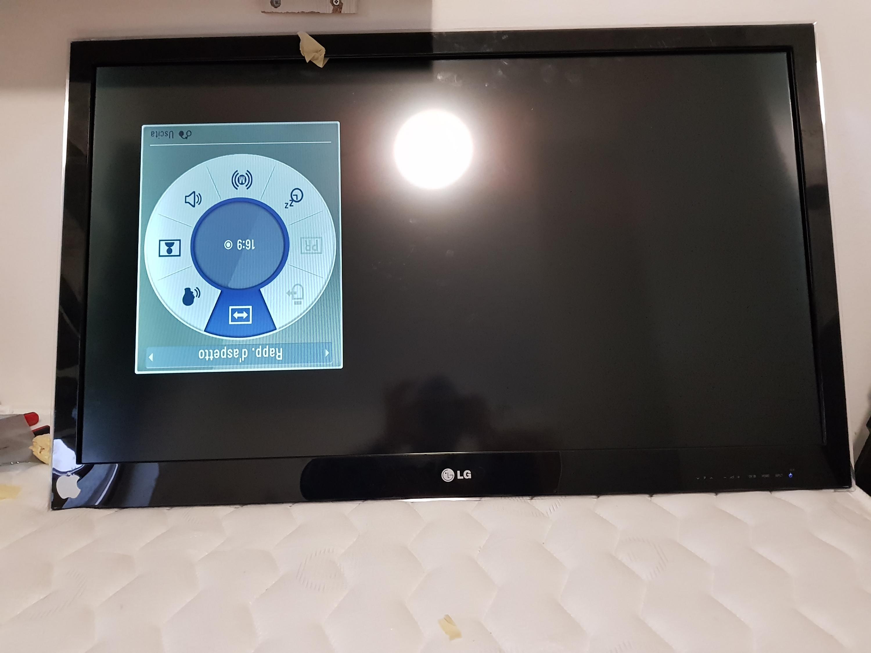

                            help me, I solved the problem of the backlight, I reassembled everything and I have the image upside down what I can do
                              #74
                              So how did you solve the backlights problem?

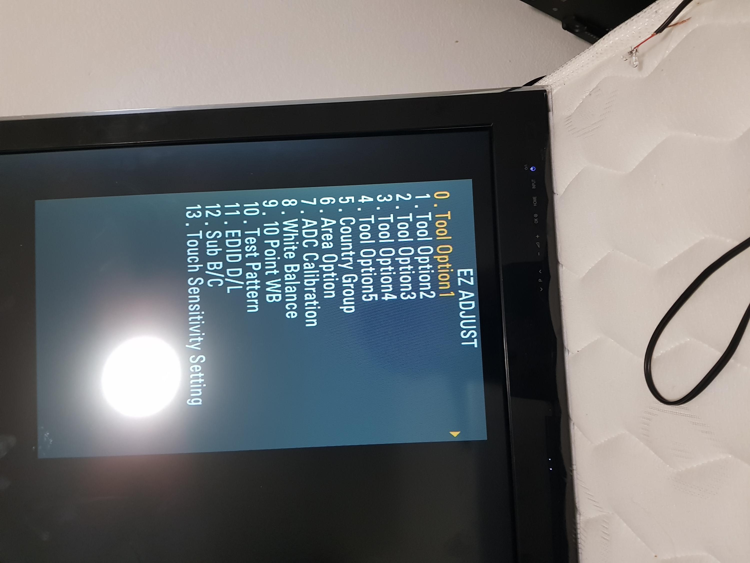

                                #75
                                I changed the entire right LED bar, and the power pcb, but how do I now turn the screen upside down?
                                • Moddingscreen
                                  • Dec 2017
                                  • 65
                                  • Italia
                                  #76
                                  from these 2 menú I can not do anything?

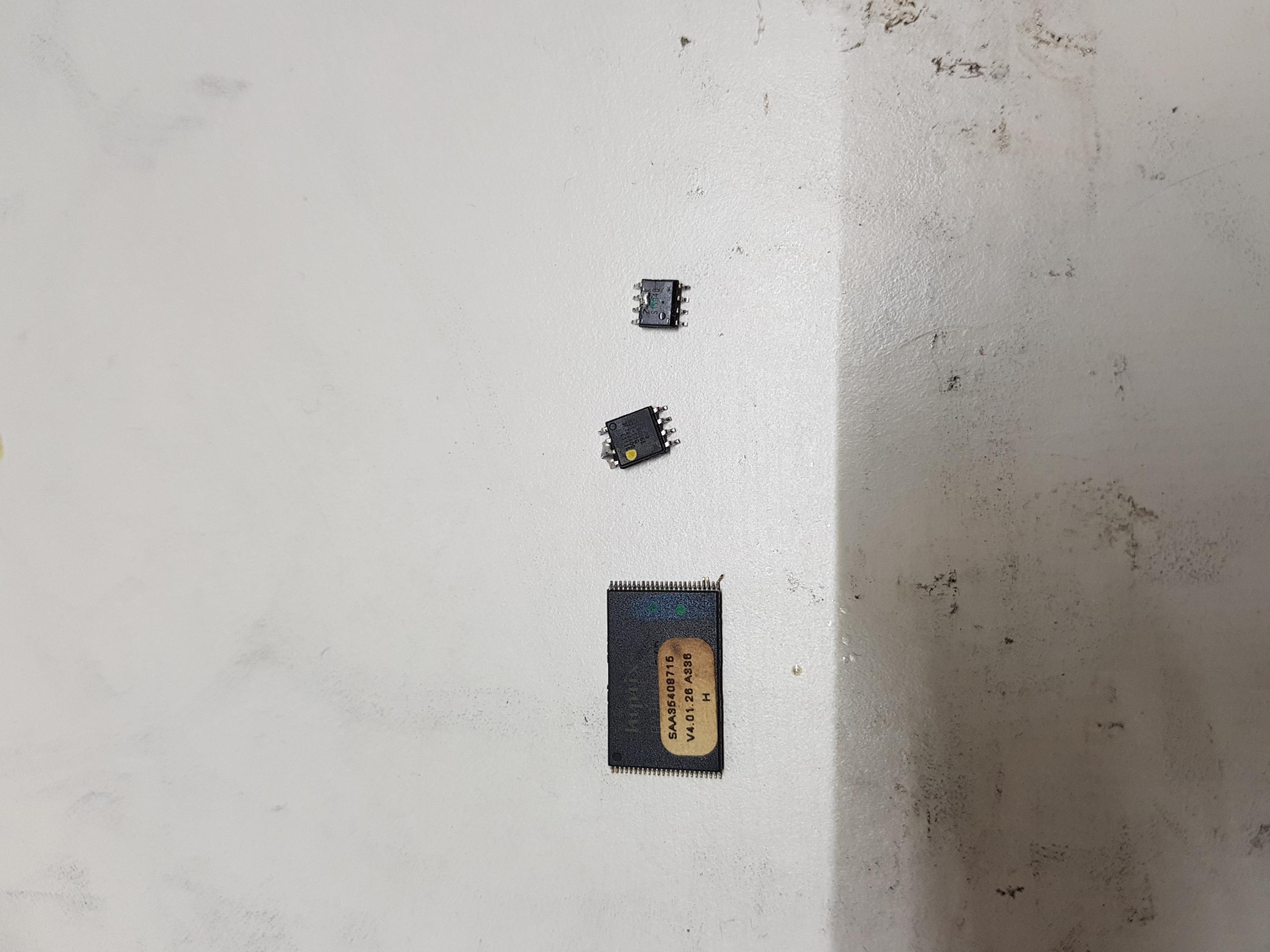

                                    #77
                                    I thought it was the flash to give me problems on the screen, I tried to swap, but I always have the screen upside down

                                      #78
                                      This is not flash problem. This is eeprom issue. Do you have eeprom. Sop-8 style ic?
                                      • Moddingscreen
                                        • Dec 2017
                                        • 65
                                        • Italia
                                        #79
                                        this is all I swapped
                                        • freakaftr8
                                          • Oct 2012
                                          • 3743
                                          #80
                                          That's odd. What you changed should have been it.
