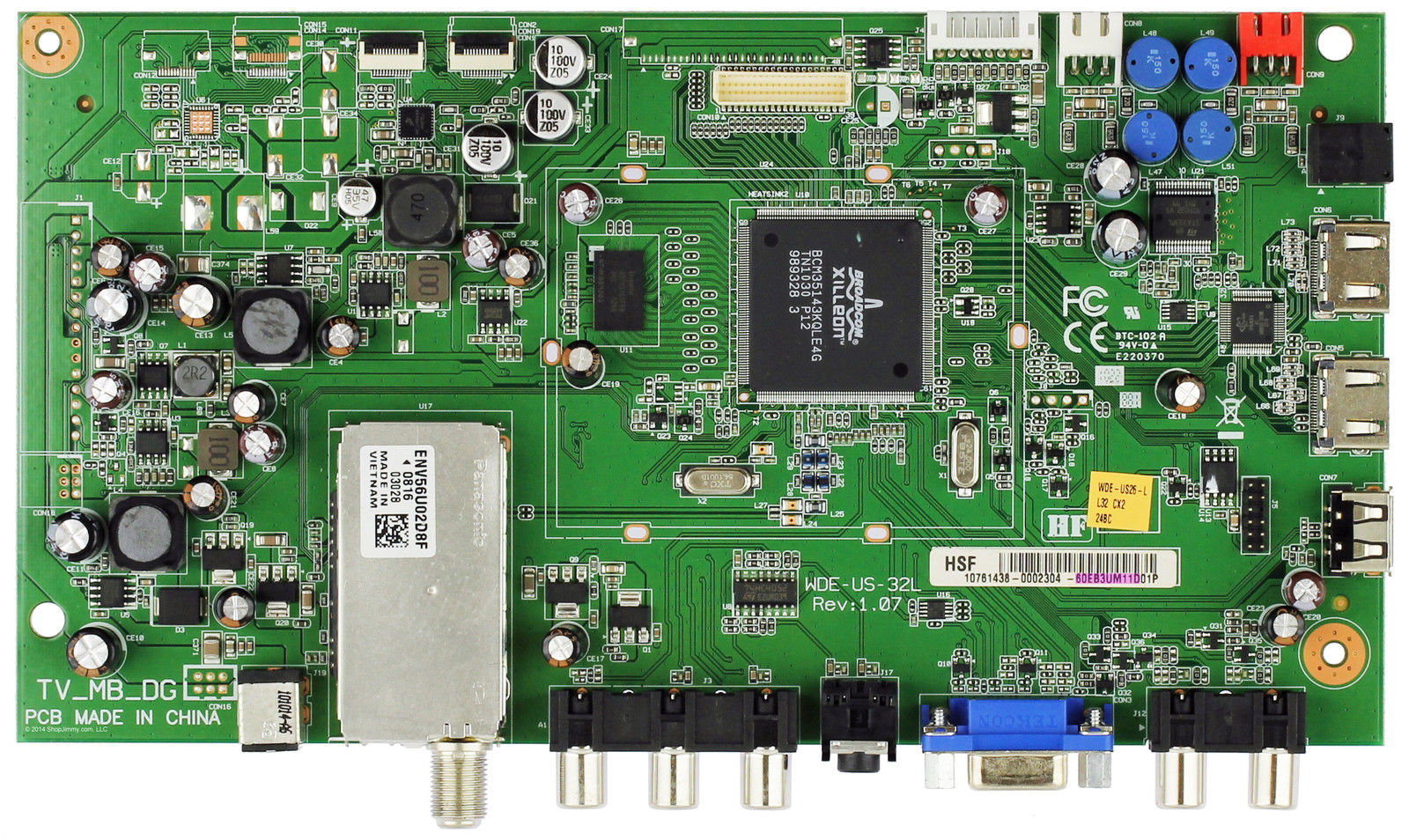

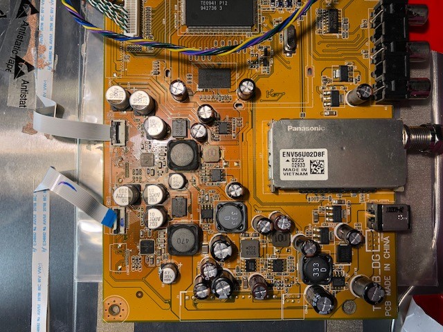

    Hello: As the title says I have acquired a Westinghouse LD-3255VX for free with the issue that the right LED (looking at it from the front) will not illuminate. I have narrowed the issue to the Main board. It is not the LED strips. How do I know (I think), I swapped the LED cables for the left and right LED strips and both LED strips will work if I source the output from the left output (CON2,CON19,CON1)). Other than the right LED channel not working, the TV works fine, but dim on the right side.
    I have attached four pictures. 1) is of the left half of the board, 2) the right half, 3) a close up of what area I think is having issues and 4) the entire board.
    Looking at the third picture "Close up", The cable connector labeled CON2,CON19,CON1 works. If I run either the left or right LED cable to this cable connector the corresponding LED channel will work. But if I try this with CON15,CON14 either of the corresponding LED channel will not work.
    From this I deduce CON15,CON14 channel is out. In the picture I have the LED cable removed but showing for the bad channel.
    Anyone want to provide some guidance on what and where I should try to get some readings? I can not source this board as they are not available.
    Can I move the cable connector attached to CON15,CON14 over and resolder it to CON11 as a work around?

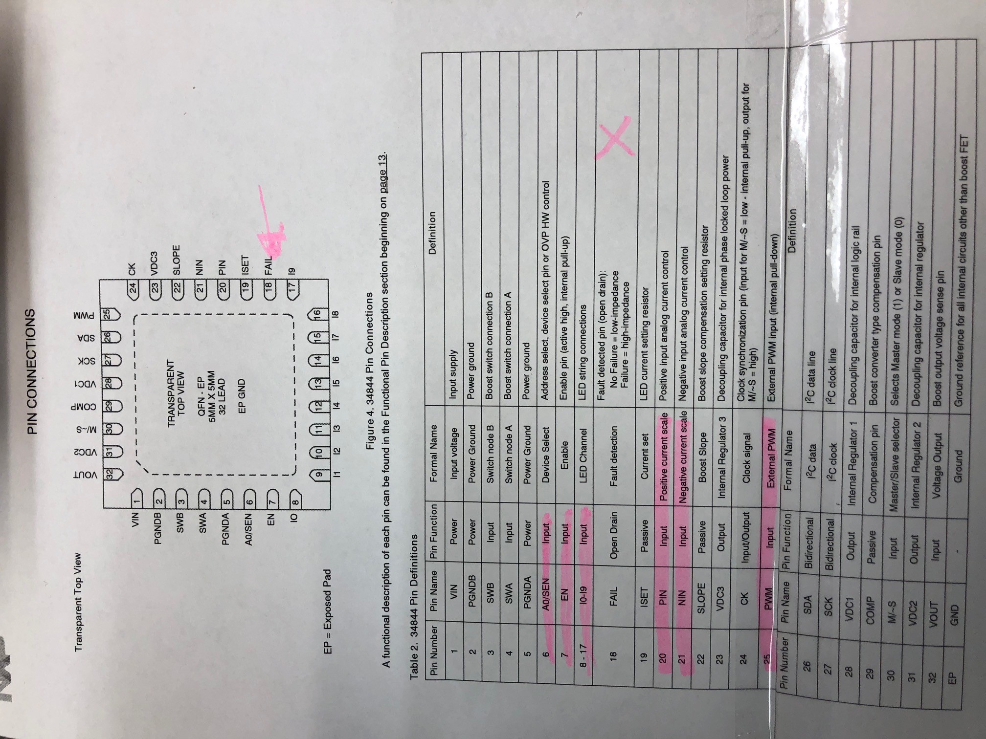

                  I am back and the MC34844A replacement was not a success. I managed to mangle the board pretty good in the process and lost a few pads.
                  I have attached a copy of the MC34844A Pin Diagram and have questions regarding Pin #32. These were some of the pads I managed to mangle on both sides. After looking at the board extremely carefully under my scope and probing all over the place I could not find where Pin #32 was suppose to go. I did not see any signs of a copper trace coming or going - it was like a "dead end" pin pad.
                  The Pin Diagram says:
                  "Pin/32 - Pin Name/VOUT - Pin Function/Input - Formal Name/Voltage Output - Definition/Boost output sense pin"
                  As I couldn't find anyplace the pin could go to as it appeared it was left blank, I left it without a pad.
                  One additional item - I read the diagram as if the logo and writing on the chips orientated the same way as the diagram. Is this correct?
                  Any ideas?

                    Re: Westinghouse LD-3255VX Right LED issue
                    You cannot rely on the writing for orientation of the chip. They will have some marking or indentation on one corner. Then you read pins counter clock wise
                      Thanks for the information. I have attached a photo of the chip on the board. The blue spot is the mark on the chip. The red numbers I drew in per your description.
                      I started Pin #1 on the bottom (of the photo by the blue dot) and went CC as you described so Pin 1-8 on bottom, 9-16 on right side, 17-24 on top and 25-32 on left side.
                      Is this correct?
                      In my picture 8-17 go to the LED connector which is consistent with what you say.
                        Blue dot may or may not mark number one pin. Usually there is a physical mark. Usually round indentation or something permanent

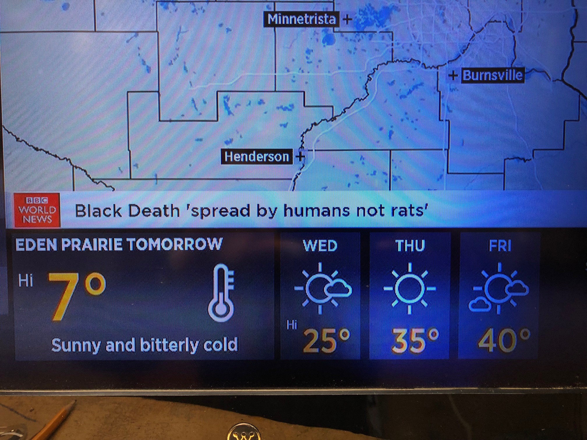

                            Update: The TV is working, but I now have a bright spot on the bottom center right side. It was not there before so I think my LED string is not the issue. As previously posted only the right side was originally working and my mishaps began when I tried to replace U6 which controls the left side per suggestions.
                            Backing up as the path to working has been long. As I destroyed the first Main Board and couldn't source another I purchased one for a 26" set from ShopJimmy. I have attached a picture also from ShopJimmy. The main boards are 95% the same. All I had to do is take out and/or move some SMD components and add a channel. This included moving over all of the missing components, removing some that were not on the original Main Board, and adding an MC34844A (U6) which was not present on the 26" main board. I also swapped the EEPROM and one or two other items. In the end the new modified Main Board is the same per my visual inspection.
                            TV works, but as mentioned above I now have a bright spot on the bottom center right. This was not there when I started. Note my theory is this is most likely related to U4 (MC34844A) and not its sister chip U6. U6 which I added is working fine visually.

                              Can we get picture of problem?
                                Thanks for the reply. The Westinghouse Logo on the Bezel is the screen's center. In the picture you can see how the temperature 35 is brighter than 25 and how it also bleeds into the 4 in 40. It goes up to the Sun symbol.
                                  Hard to tell. To me looks more like a dark spot
