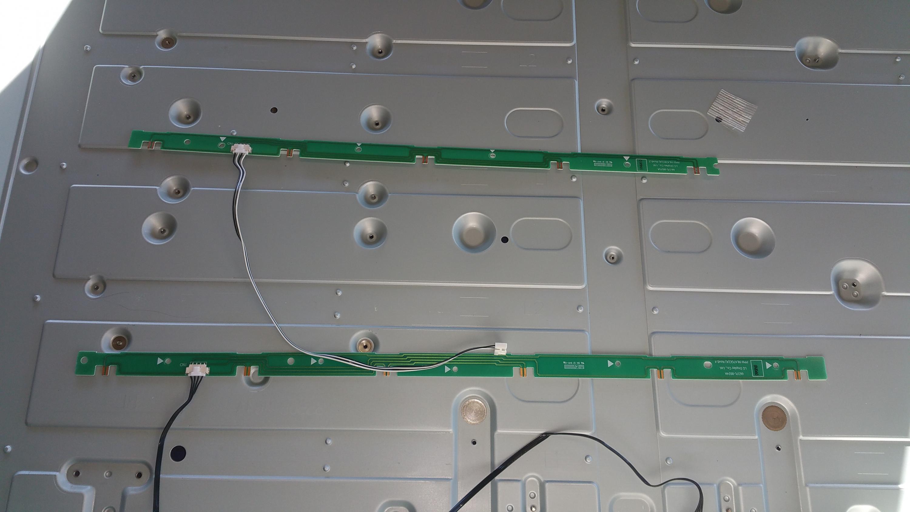

    This seems to be my month for weird LED Strip issues..
    I have this Sanyo that I broke down to the bare strips and discovered that the LED assembly is identical to some LGs and some VIZIOs I worked on..
    I used my LED tester to find the bad strips and LEDs and was able to create an array that was fully functional.. No bad LEDs at all..
    STILL wouldn't come on...
    So I cracked open a 47" LED that had a bad display panel. At least I HOPE it did..
    Anyways, long story short (too late!) I have confirmed that the following parts of the LED TV are fully function..
    Power PCB
    Main Video Board
    ALL LED Strips
    Cable that goes from the Power PCV to the Array board..
    The "array board" (green strip that all the LED Strips plug into) seems to be the culprit.. But, near as I can tell, it's just traces and I can't find any breaks...
    Voltages at the 4 pin connector on the array board are solid.. 200v at one testing....
    I am thinking I need to check the voltages at the point where the LED Strips plug into the array board but I wanted to get guidance on what voltages should be present...
    Thanx
    FURTHER INFO: Regarding the pic, the upper array board is from the Sanyo and doesn't work. The lower array board is from the LG and it works fine.. It should also be noted that, lemme see if I can explain this right, the connectors that go from the Power PCB to the array board are inverted.. On the LG, the connector tab on both ends face the same way.. On the SANYO, the connector tabs are opposite..... If that makes any sense

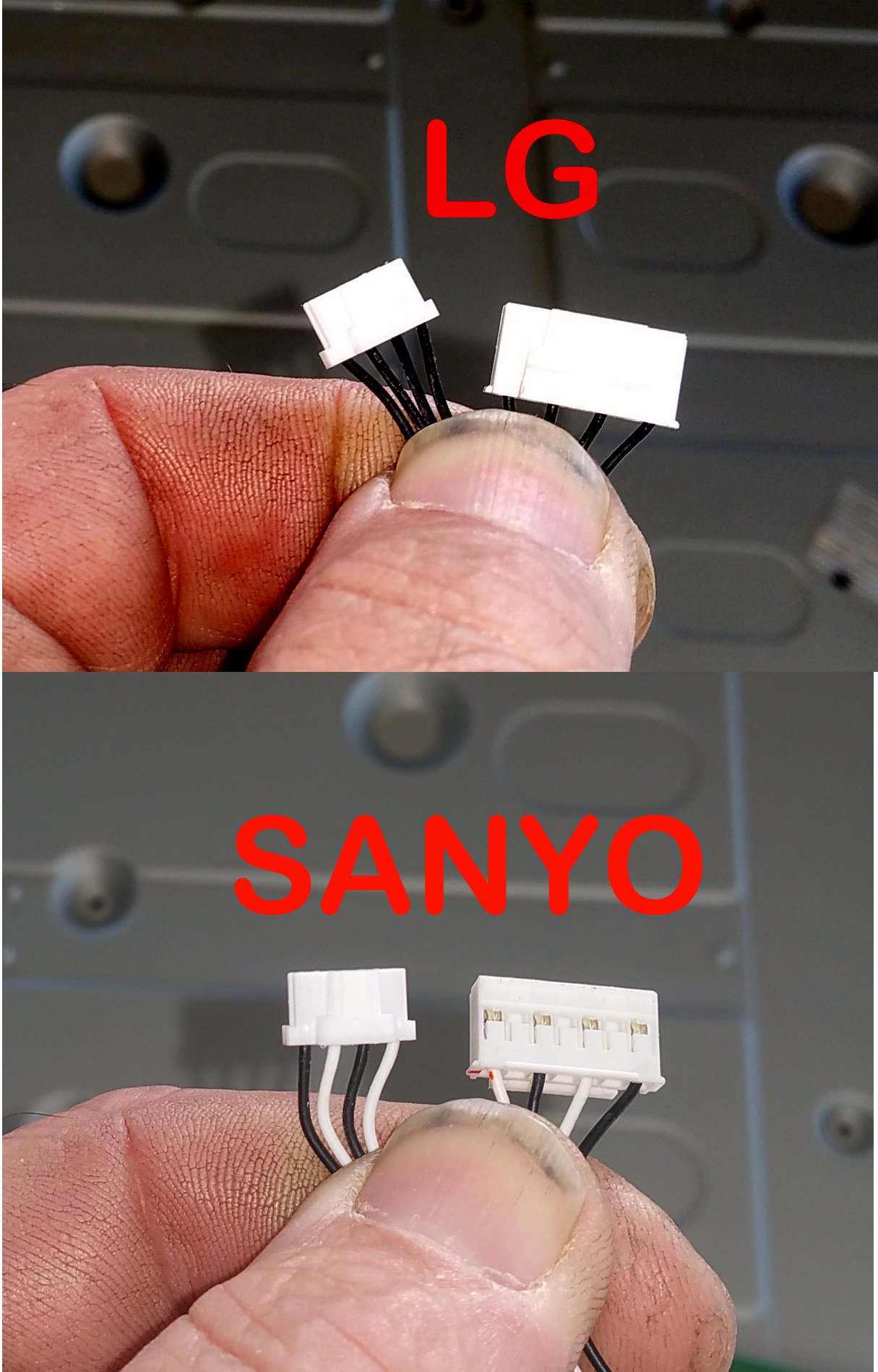

    Here is what I mean about the Power PCB/Array connectors...

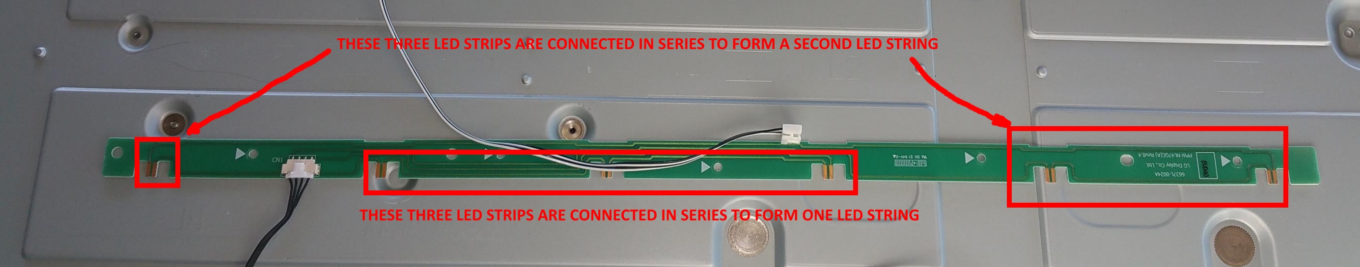

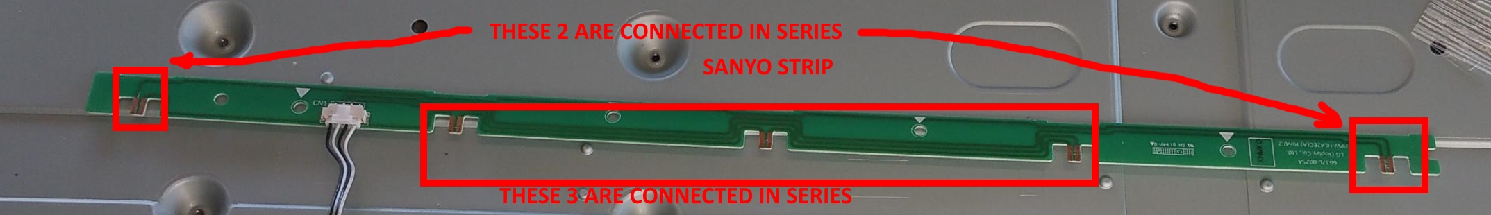

      Can we see good clear pictures of the whole power supply/LED driver board?
      The SANYO one: the black wires are more likely to be the Anode of the LED string, the white wires are the Cathode returns.

                      Thanx for the replies, guys.. Turns out that it WAS a bad cable connector from the array board to the Power PCB...
