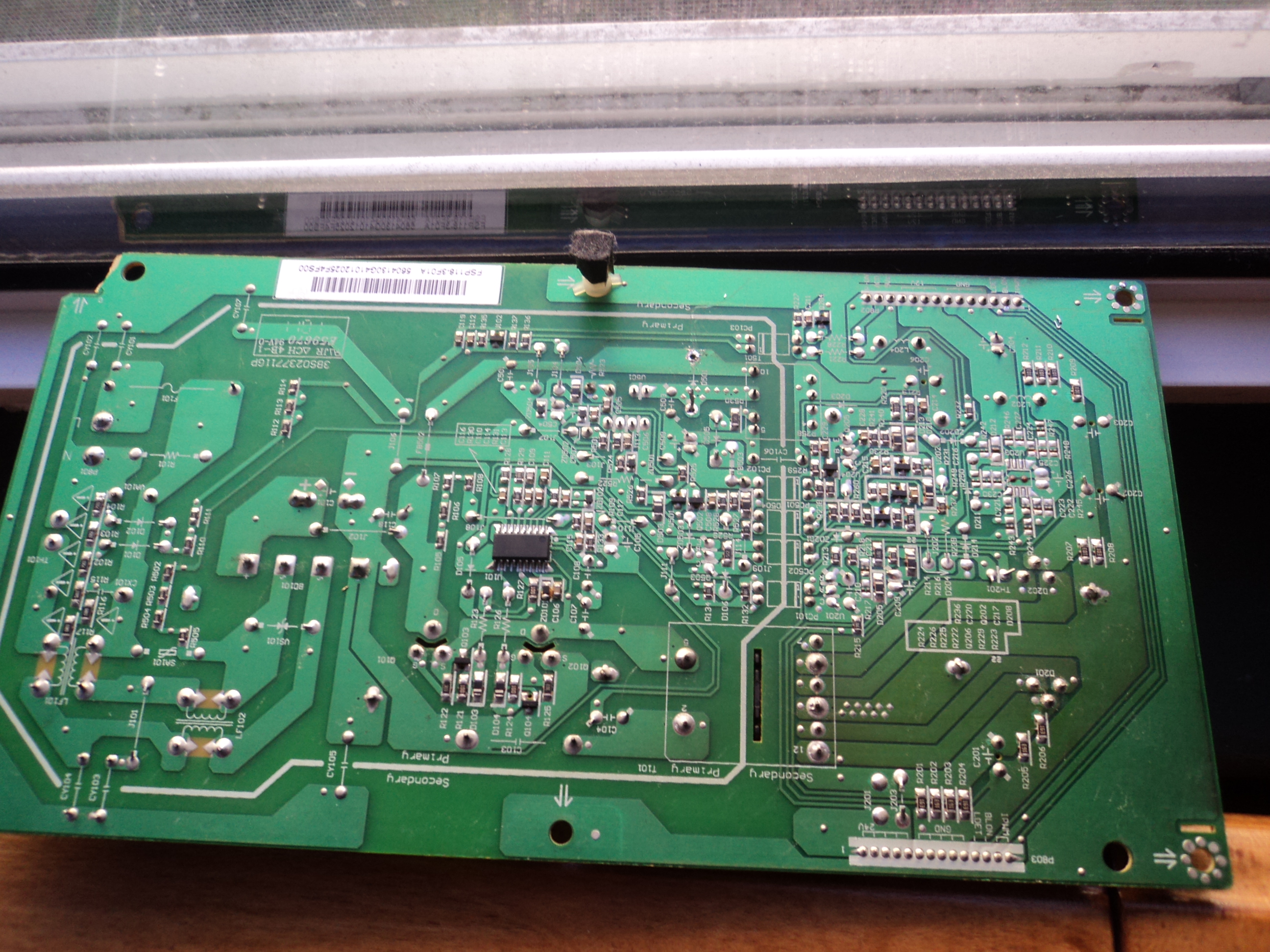

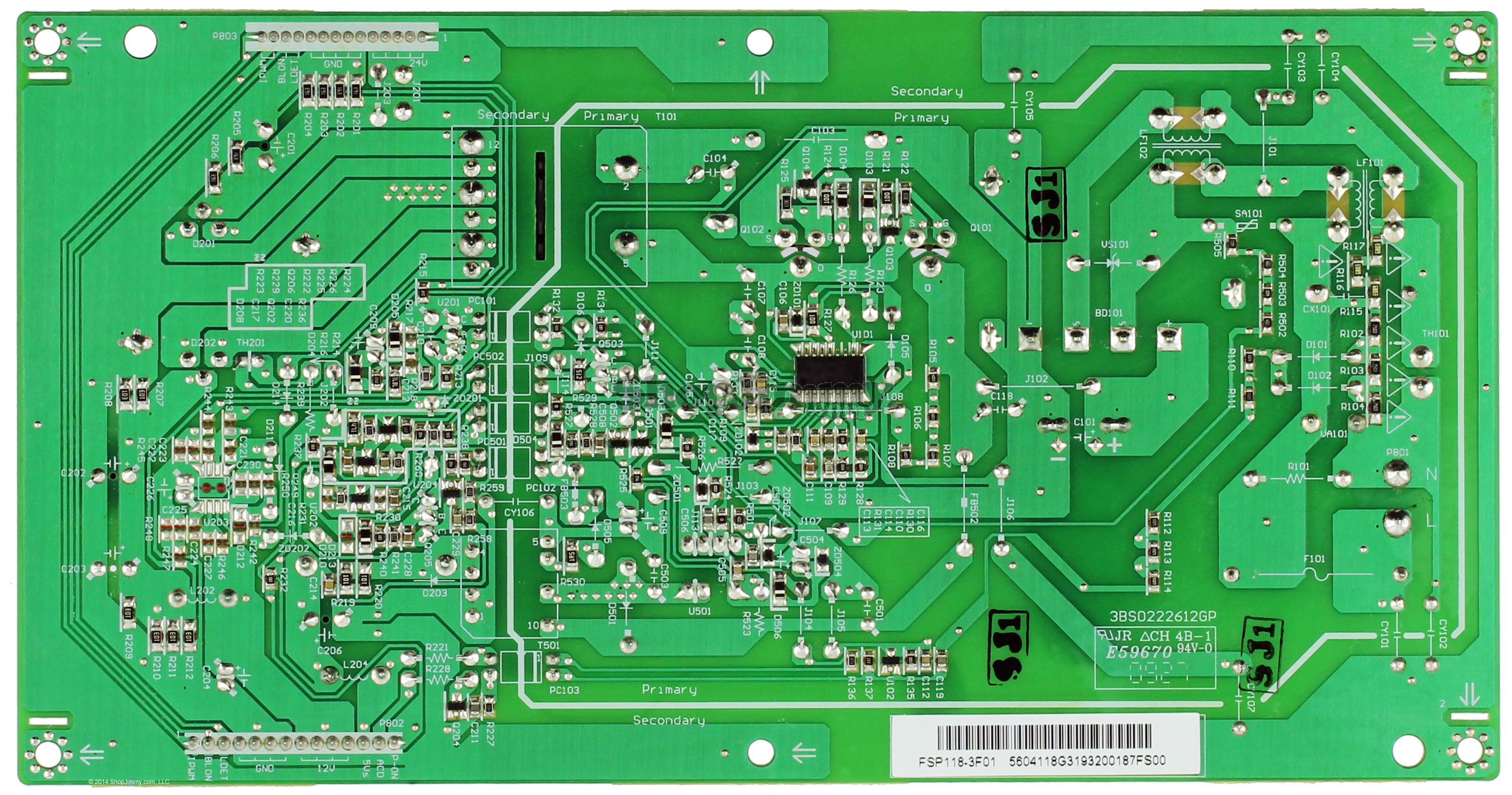

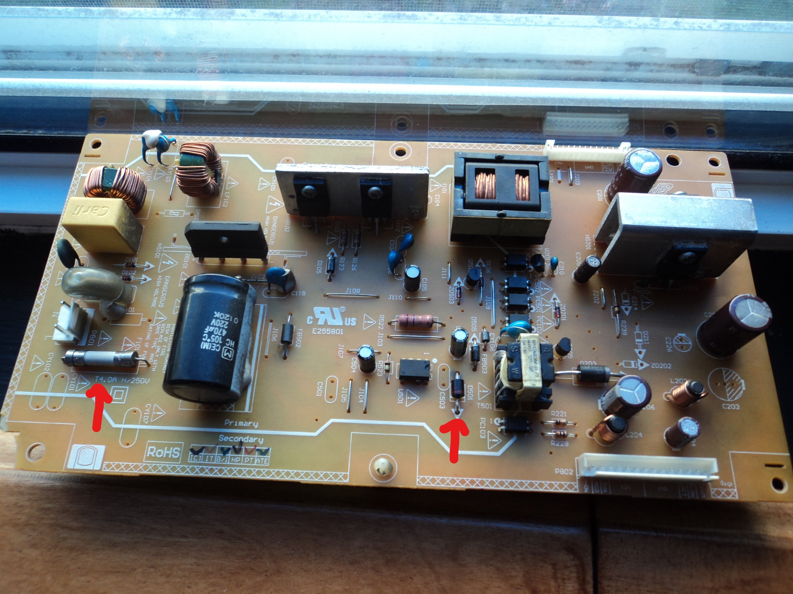

    Hi guys; i picked this tv up and opened it up and found out Fuse and a Scott y Diode short circuit and out of the circuit it's Open,could it be more parts bad? send you Pic of Power Supply,and the Diode Sckoty it's T2D- 02,what other similar can i use?Thanks

    Hi folks I've red these two threads bellow and does this Diode T 2D 02 will measure open out of the circuit ?and in circuit short ,is it OK?

            Thanks J_R; you were right it blew the fuse again,and i checked Q101,Q102 and i think they are OK both measure same ,check the pic attach.

                          Thanksguys ; VS101 is short in circuit and out of circuit,i thought vs 101 was a fuse! sure looks like one ,but looking at it on the other side it has a symbol of a zener diode,i also took out CX101 in circuit it shows short but out of circuit it's not short,

                                  On the S.J. picture I can make out "E2"
