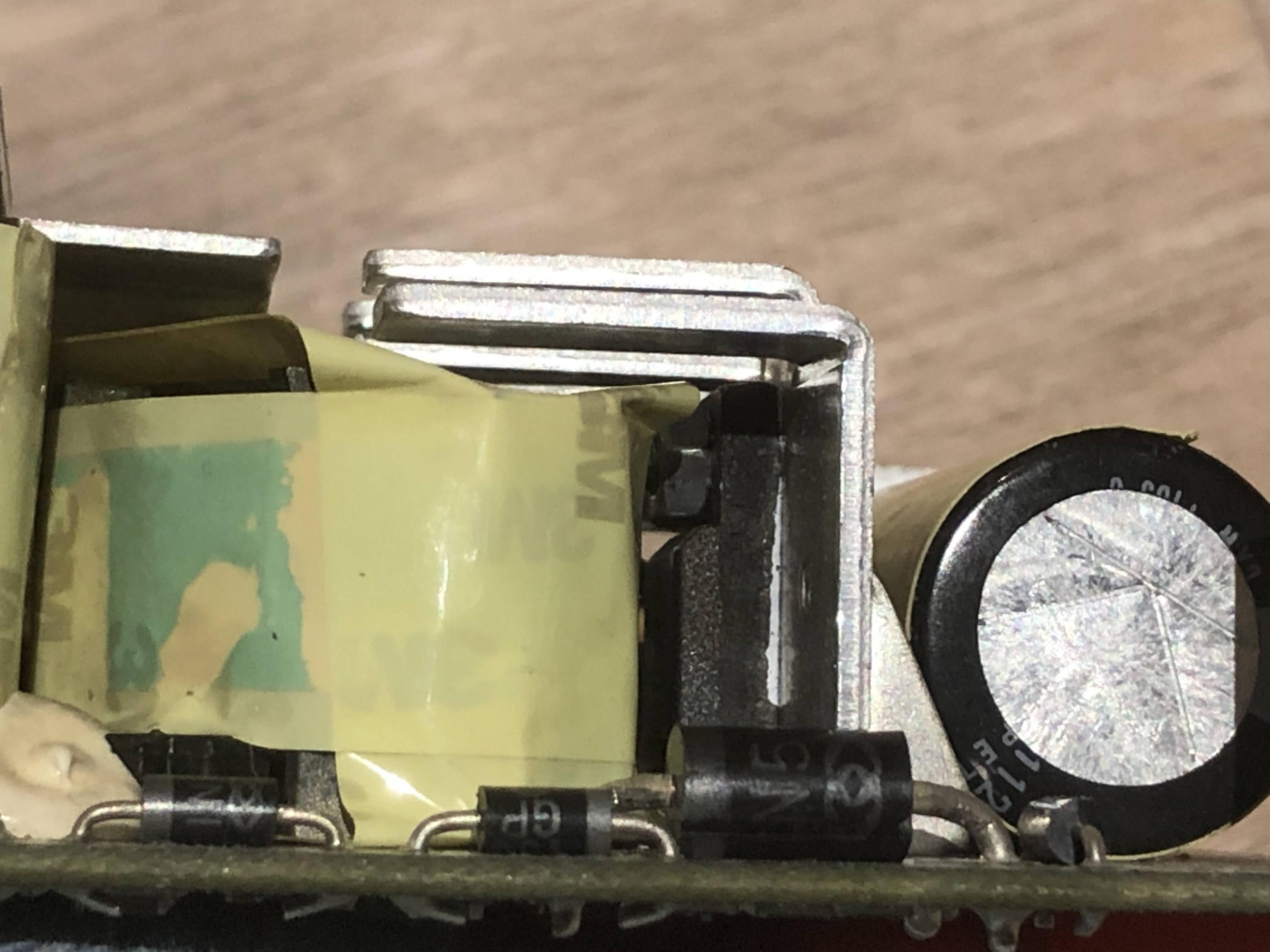

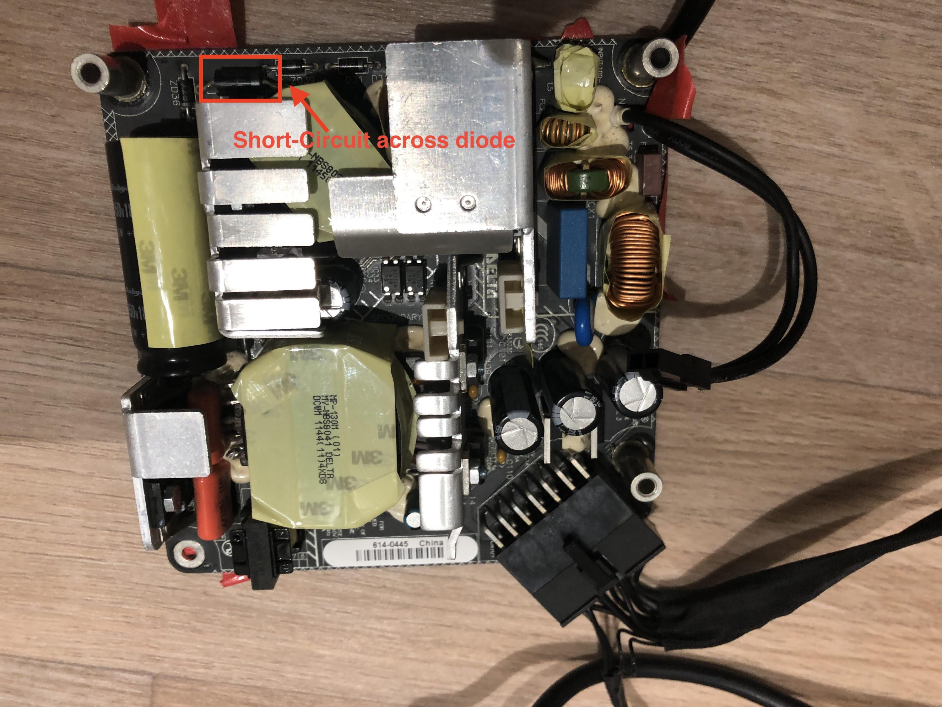

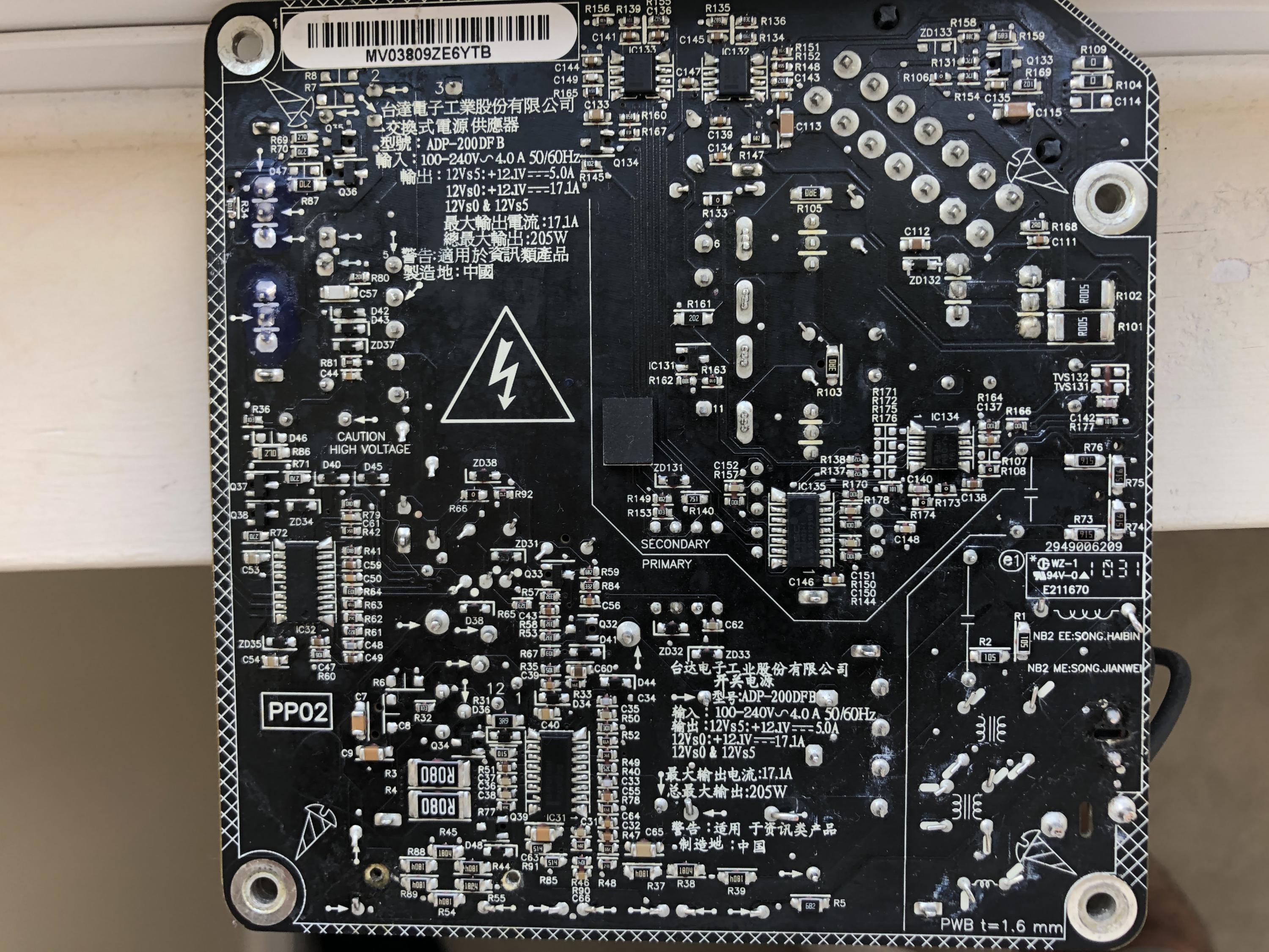

    I have an iMac with the power supply reference: ADP-200DFB.
    This power supply is not working and when trying to debug the problem with a multimeter, I found what I thought to be a short circuited diode (the short-circuit is to ground).
    With the continuity test it beeps both ways, so doesn't block current flow at all then reverse biased. But after removing the diode the beep continues and the diode seems healthy. It seems to exist a real short-circuit.
    As I have another ADP-200DFB power supply (faulty one as well), I have checked the same diode and it seems to be short-circuited as the first.
    I don't know if you agree with me, but there should be another component which is connected to this diode, which is faulty and creating this short-circuit to ground.
    Any ideas on how to debug this? Where should I start?
    Thanks in advance.

    Is the short on the secondary side of this switching power supply
    If so start removing parts one at a time until the short is gone
    If it is on the primary side of the switching power supply then you for a part with 5 or more pins that the data sheet says that it is a regular of some type and check it for short

      This diode is on the primary side, but I could not really understand your last sentence. Could you, please, re-phrase it for me?

        You should look and if you find an ic chip that the part description says that it is some type of online switcher or off line switcher or some type of PWM controller chip for switching power supply
        Here is an example “TOP246” or TOP247

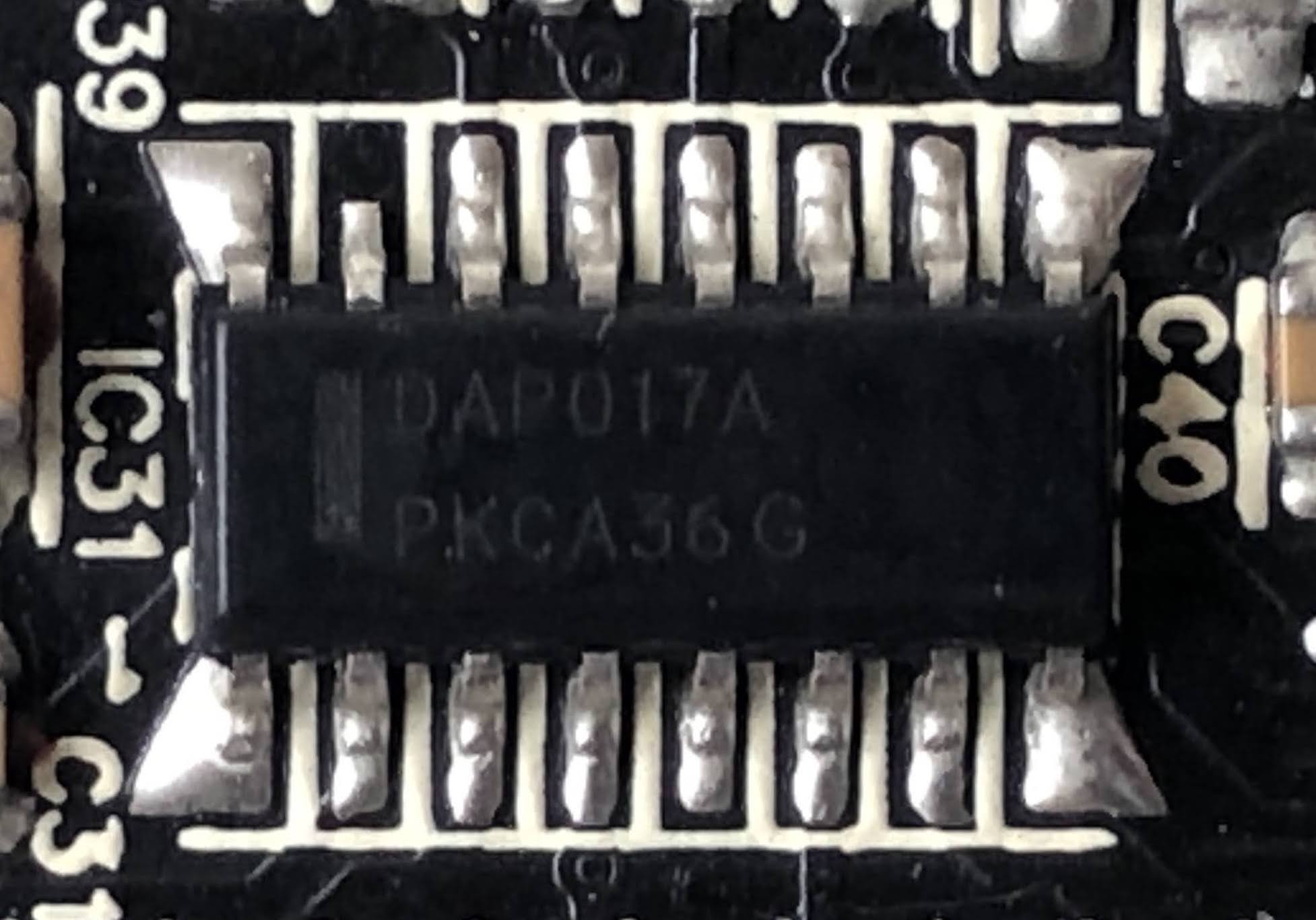

          The ICs nearby the diode are the DAP017-AH, for which I cannot find a Datasheet and I don't even know what it is, and the DAP015-AD (some kind of oscillator/pwm generator).
          Could one of these be the culprits?

            It look like the data sheets for this device has been pulled for some reason
            The part can be found but I do not know if it is becoming obsolete and that why you can find the data sheet
            Is where the short is coming from if so just replace it and see if the short is not there any more
            Can you please show a clear picture of this part so the information can be read

              Please find the picture attached.
              As I have 2 PSUs with exactly the same problem, maybe this IC had a fundamental problem and was removed from the market.

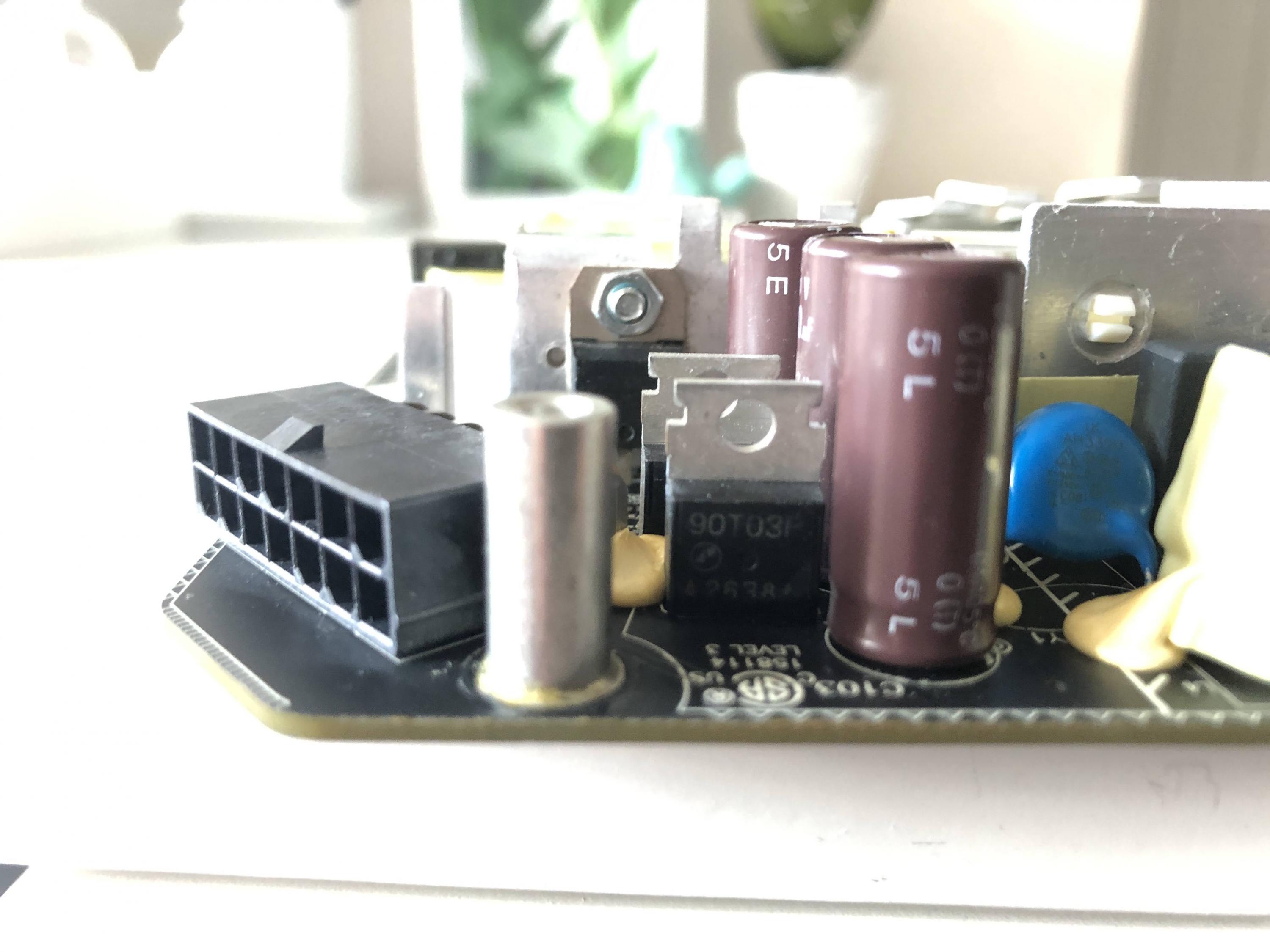

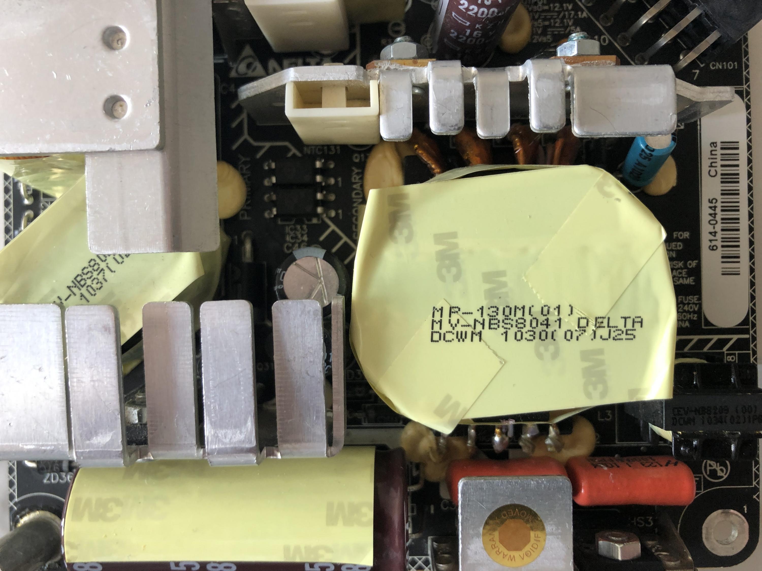

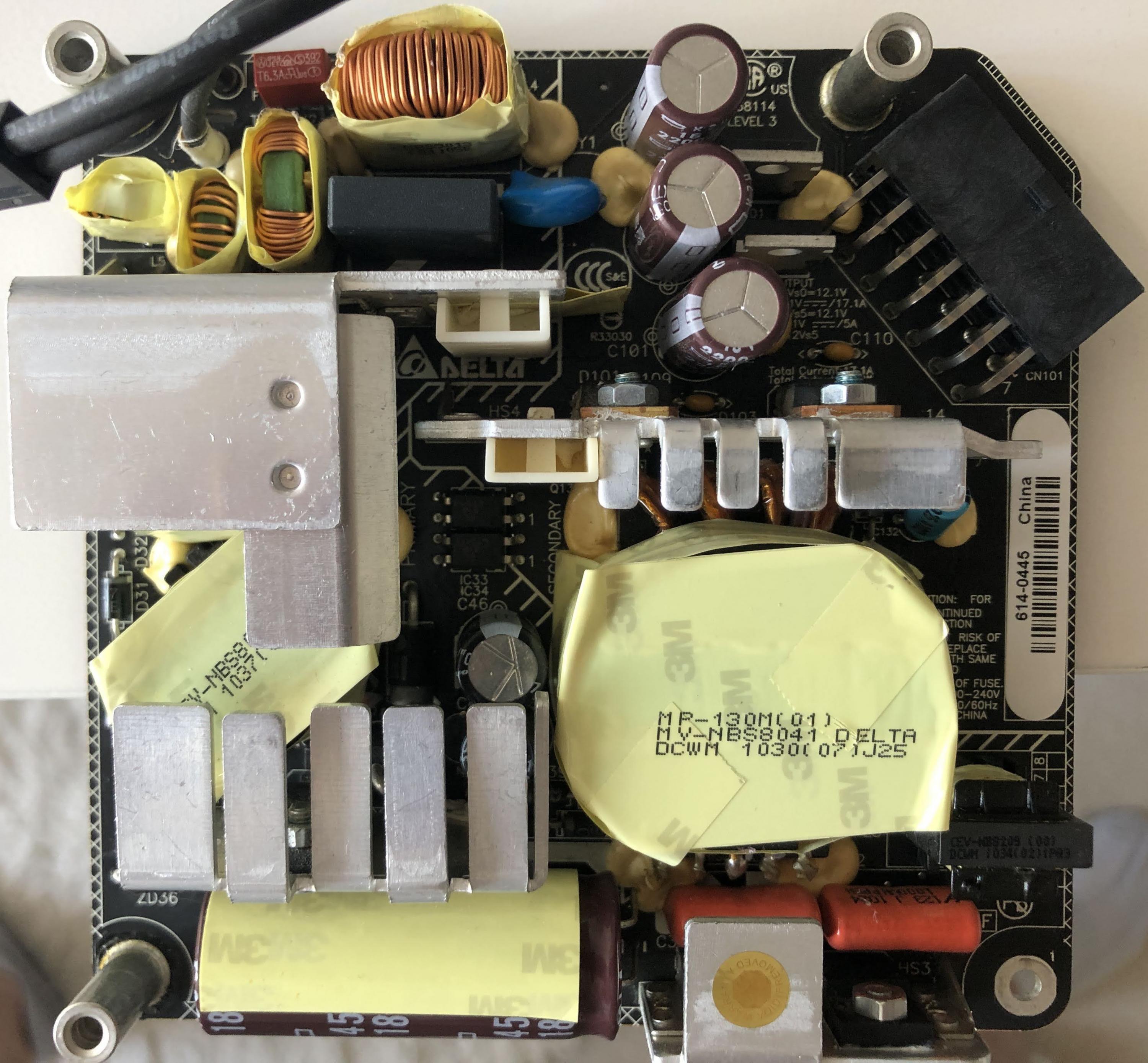

                Can we see good clear straight shot pictures of the whole top and bottom side of the board, pictures must be clear enough to see the traces?
                That diode may be snubber Diode that is connected in parallel with the primary driving winding of the power transformer so that is why it shows low resistance reading, we need pictures to verify since it can also be connected in parallel with low Ohm resistor.

                  Thanks for your reply. I've taken some pictures and I hope they are good enough.

                    Forgot this picture.
                      Re: iMac power supply short-circuit diode to ground
                      I look at the bottom side of the board but unable to trace out the diode connections due to the black solder mask, I cannot see the traces.

                        I bought another power supply, which works. As I have 2 power supplies from DELTA, this time I used another brand (ACBEL) and it works fine.
                        However, I really want to fix the other 2 or at least one of them.
                        I can try to clean it, so you can see the tracks, but even looking at it in my hand I cannot see much.
                        Maybe this PCB is multi-layer, since there are few tracks visible.
                        I am feeling tempted to sacrifice one of them, removing all the components, and try to draw a schematic from there, so I can fix the other.
                        I would like to take the components off the sacrificed board and design a PSU myself. In principle, I should have good quality components there.

                              Most likely it is just a dual layer PCB, the problem is the black solder mask.
                              Try to get sunlight through the PCB, or a really strong artificial light.
                              That may reveal the tracks...

                                I tried both sun and a lamp, but I can't see anything.
                                The board is very populated, so it is difficult for the light to pass. I think it will be possible to do that if I start desoldering heatsinks, transformers, inductors and large components.
                                As I have 2 identical power supplies maybe I will do that to one of them.
                                However I think it is a multi-layer PCB and I will tell you why. Maybe I am wrong.
                                When I test the diode, as referred in the beginning of this thread, the multimeter shows a short circuit. After removing the diode, the diode is ok and the short circuit remains.
                                When I put the test probes in the hole where the diode was, the multimeter beeps but I am touching the inside of the hole.
                                You see, my soldering iron is not very good. It is a 15w one, which has no thermal capacity to unsolder thick solder balls. To desolder the diode I had to keep the iron there for a long time and apply lots of pressure. With that, the pads lifted from the pcb. So, now the only tracks I have are possibly tracks inside that hole. I don't know it is just a thought.
