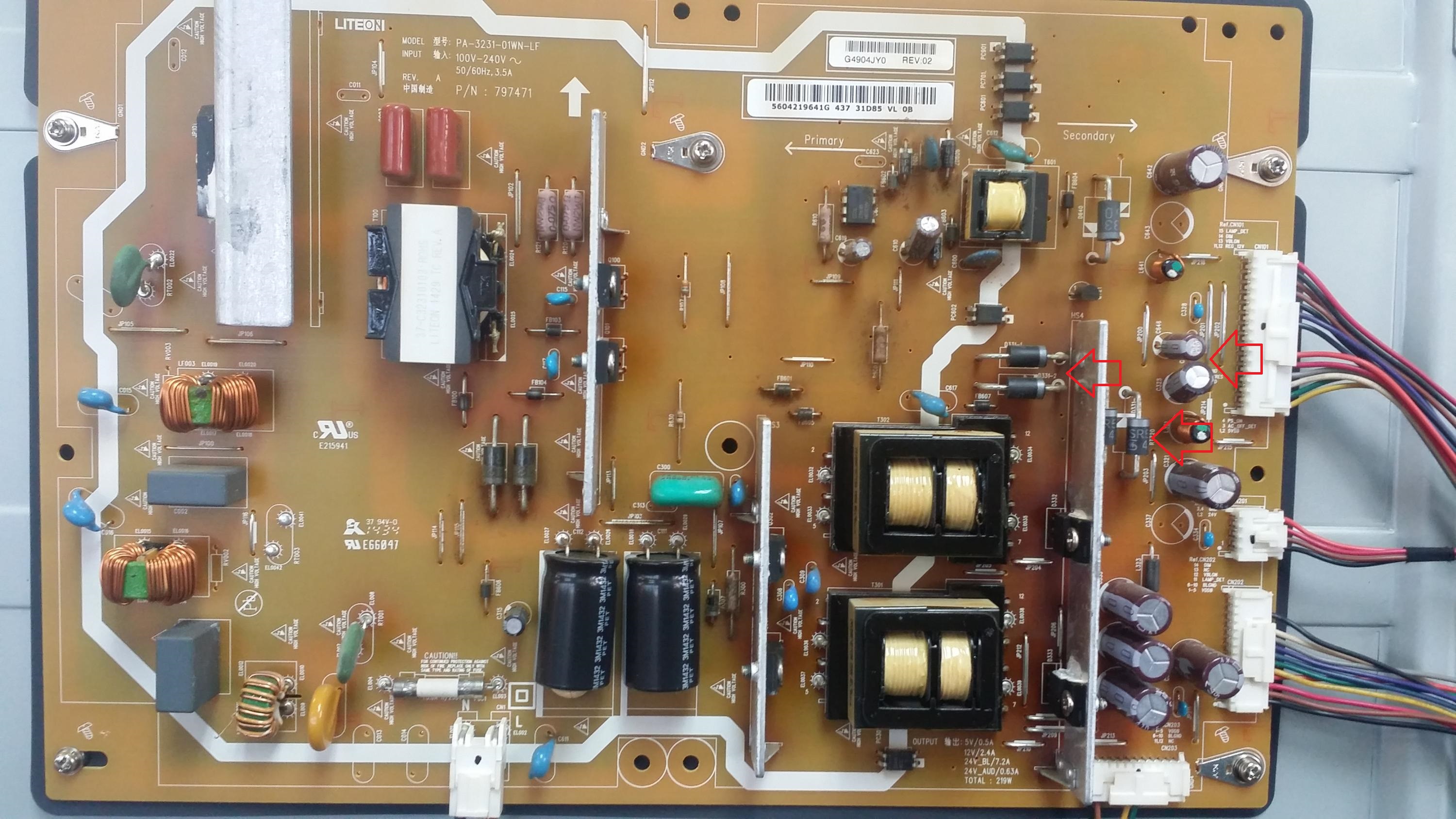

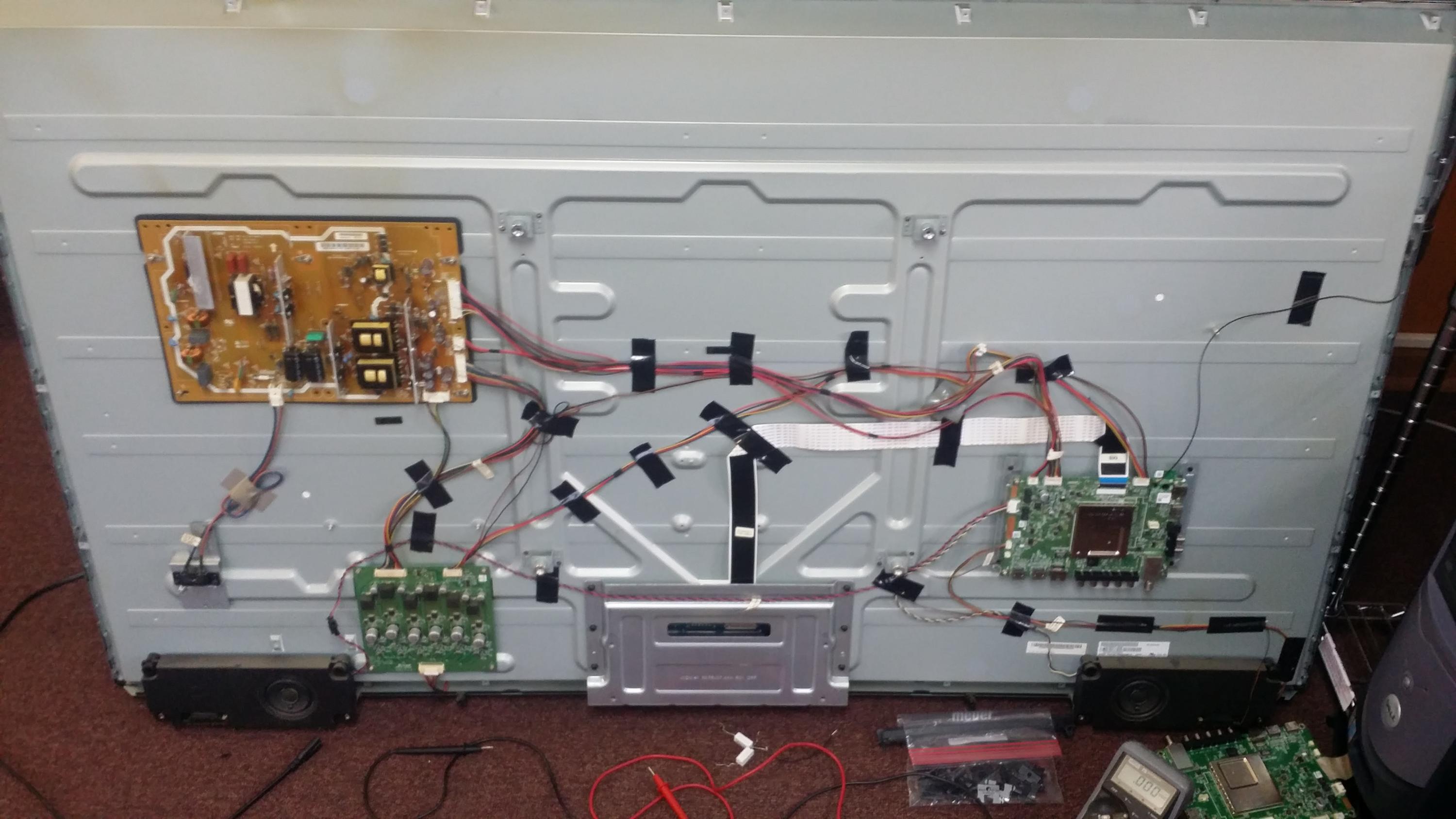

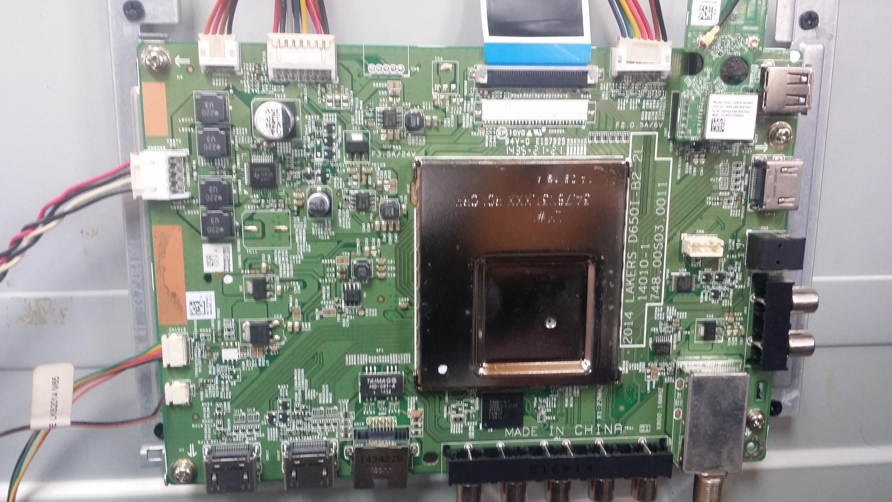

                        with the main board connected to the PSU, the 5VSB is still down? Can we see pictures of your PSU and main board?
                        • heavymachines
                          • Mar 2011
                          • 1028
                          Re: Vizio D650I-B2
                          yeah 5vsb is still down to like 1.4 to 1.9 fluctuating.
                          Pics coming soon
                          • heavymachines
                            • Mar 2011
                            • 1028
                            Re: Vizio D650I-B2
                            Here are the pics

                              I will check the power supply the +5 volts. your main boards fuse isn't blowing so there is no short. you could have bad diode or a bad caps on your power supply board.
                              check out those diodes and caps on you power supply board
                              • heavymachines
                                • Mar 2011
                                • 1028
                                Re: Vizio D650I-B2
                                they're fine
