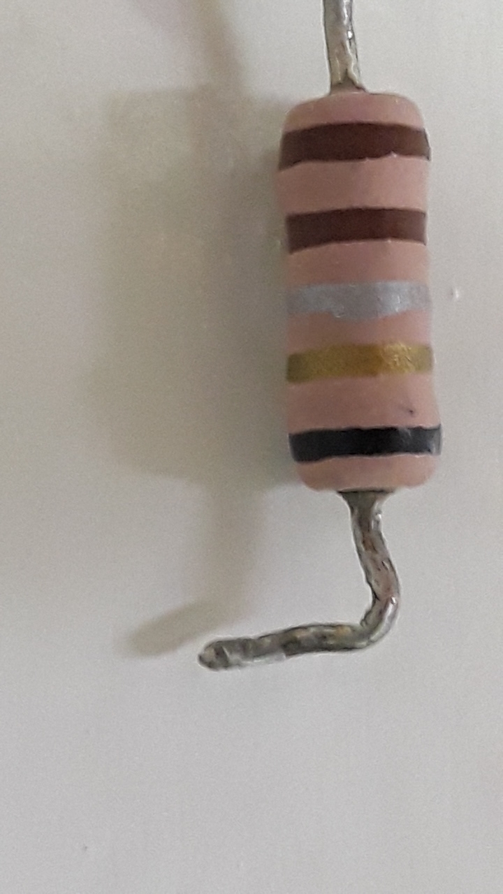

                        I have attached a picture of 1 of 2 resistors that are shorted. They both show a dmm measurement of 0.3 ohms that fluctuates from 0 to 0.3 ohms. Doing a continuity check they measure shorted. When I look on a resistor calculator (like the one on digikey) they don't have a black stripe as a choice on either band 1 or 5. I think this is a 1 watt resistor due to it's size compared to others I have. What I am trying to figure out is what is it's true resistance so that I can replace these 2. Also if I can't find that resistance what can I replace it with. Can I go up in resistance and or wattage etc.?
                        More info. If the 1st band is not black then band 1 and 2 both appear to be brown. Also the 3rd band looks silver on the resistor but the only choice on the calculators is grey.
                        I have been replacing bad diodes and mosfets (having to wait for orders etc.) I had all of them replaced and was checking voltages at the cable connectors to the main board I actually got a 6.5v and 12v reading but the 3.4v was low at about 2 volts. I was searching for what might be causing this low voltage when I shorted a large mosfet near the bridge rec. That shorted the bridge and the two resistors and the two fuses. So I had to order a new bridge and was trying to find the resistors when I encountered the problem described above. Should have come back to you guys for help with that instead of my trying to search blindly.

                        • vinceroger69
                          • Mar 2012
                          • 6714
                          • uk
                          #52
                          Re: LG47LC7DF Fuse Blows
                          0.11 ohm?
                          https://www.hobby-hour.com/electroni...calculator.php
                          • killian6pk
                            • Apr 2010
                            • 502
                            #53
                            Ok thanks, what about the going up or down in ohms and watts?
                            Have you ever stopped to think and then forget to start thinking again?
                            As a very wise man once said on this forum: "Of all the things I have lost I miss my mind the most."
                            • R_J
                              • Jun 2012
                              • 9535
                              #54
                              The resistors are ok, they are very low resistance (.1 Ω) and will check like a short
                              • killian6pk
                                • Apr 2010
                                • 502
                                #55
                                Ok thanks,
                                So could they be showing up in circuit as a shorted component? I was testing them out of circuit when they tested shorted. The reason I ask is that I saw a guy on youtube who was checking a tv power board for shorts by setting his dmm on diode mode and putting his leads on the ac power imput pins (no ac going into board) and he said if it had a reading there was a shorted component and if it read OL then there were no shorts. Does that make sense?
