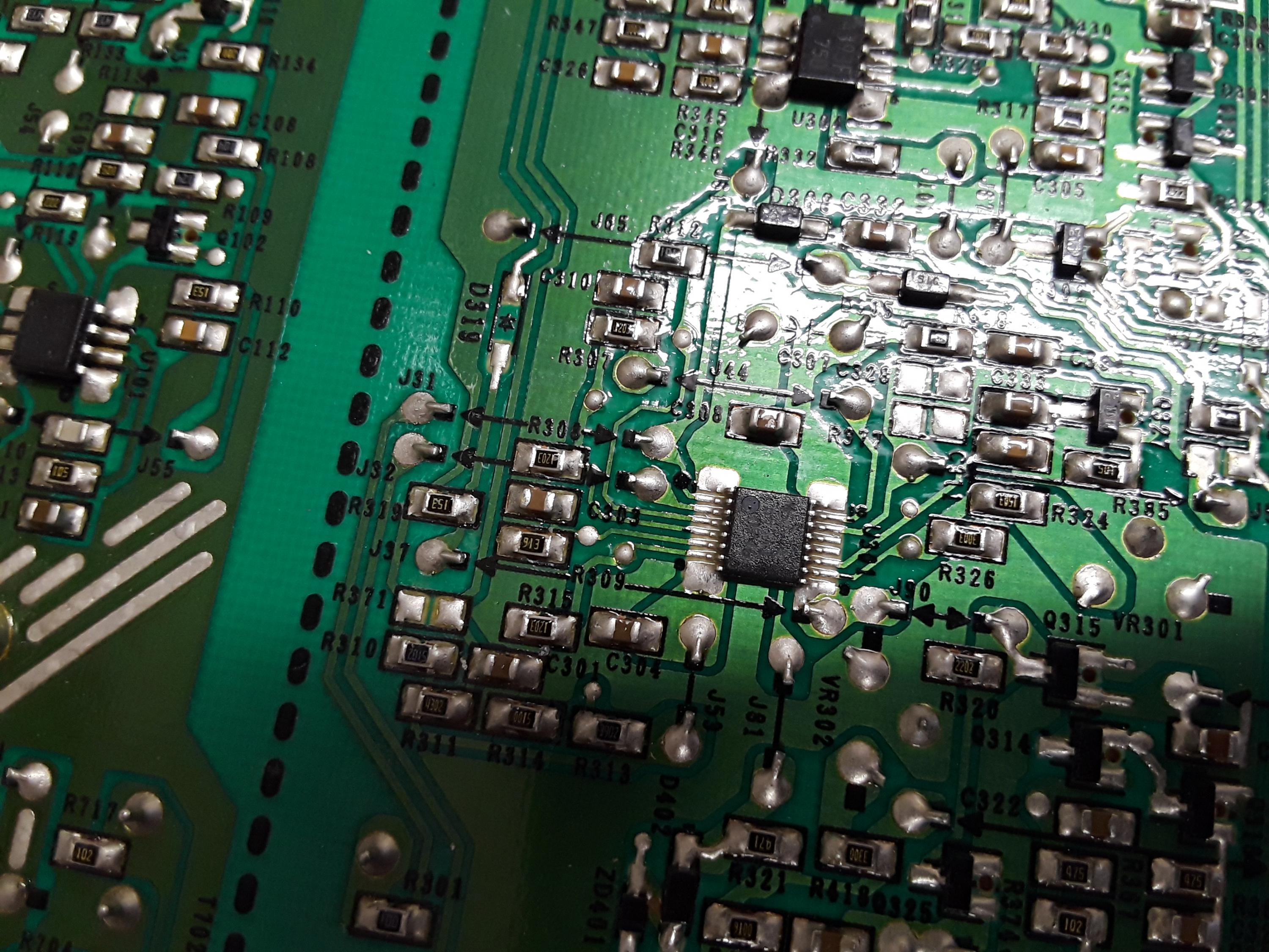

    can you double check the numbers of that ic as no hits when looking on google for it

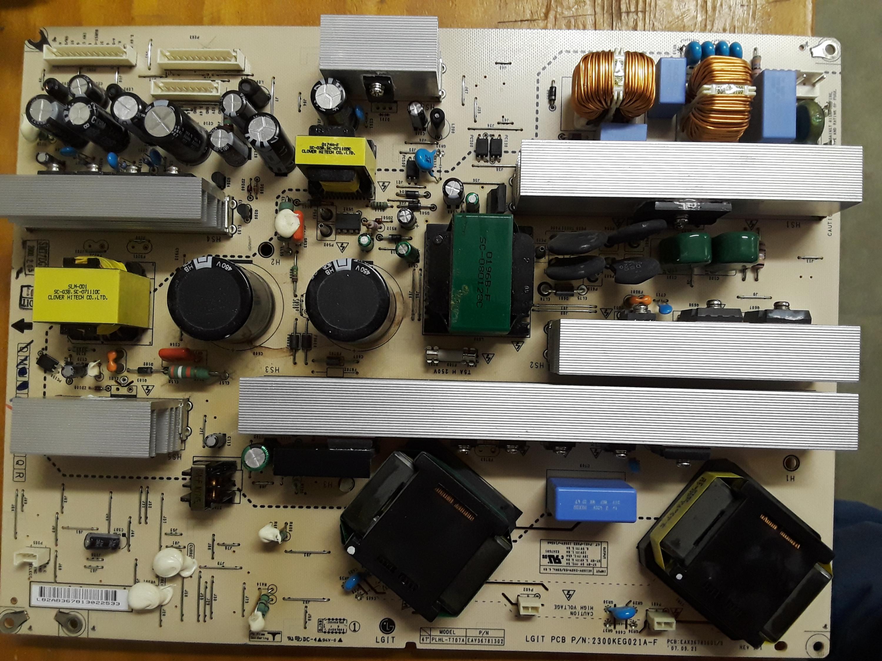

      I need better straight shot pictures of the top and the bottom side of the board, right now I cannot really read the designators as printed on the board.

        I rechecked the numbers on the small chip. The first line reads 0001 the 1 is very faint but readable after cleaning the part, The second line does not have a small o like I thought that is the number one pin designator. The second line reads just H48. I can't find that number in google or on digikey.
        I will get better pictures of both sides of the board.

          Re: LG47LC7DF Fuse Blows
          http://www.semicon.sanken-ele.co.jp/...etail/SFA0001/

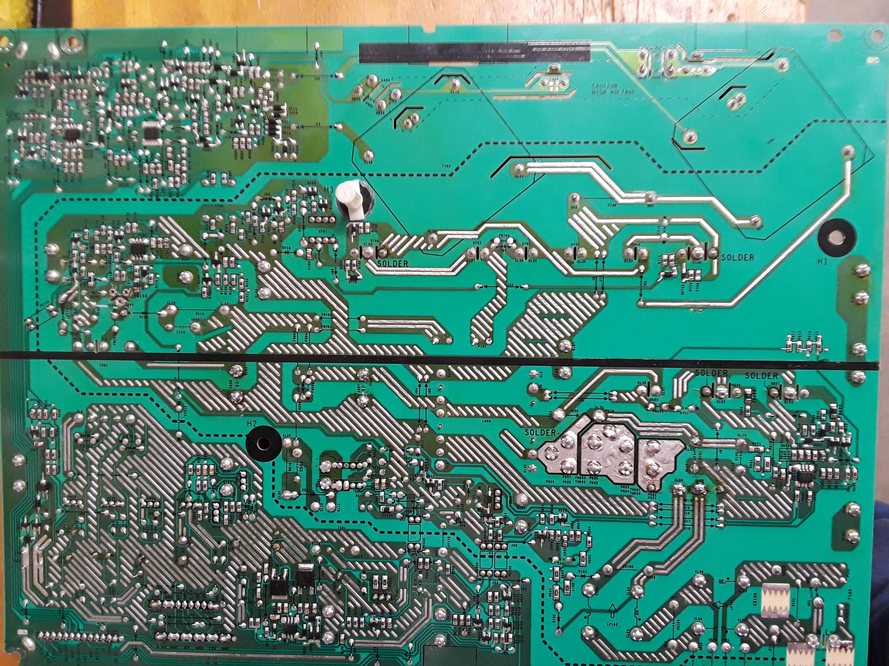

            Better pictures. Front and back
                    Q103 is not the PFC IC, that is the MOSFET for driving the power transformer for 12v and 24V? (I cannot read the connector Voltage labels).

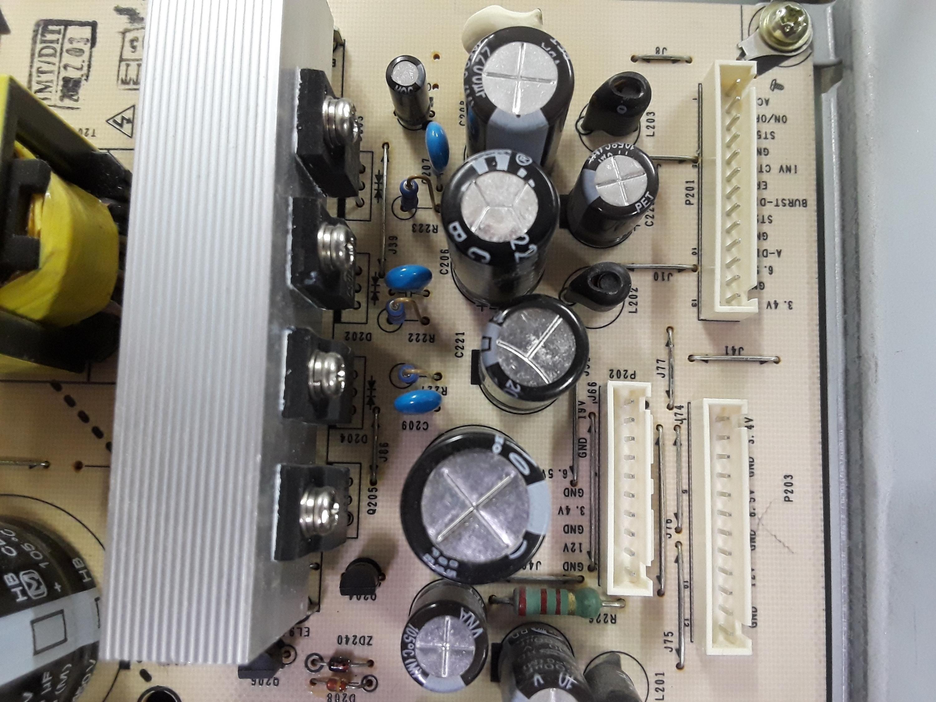

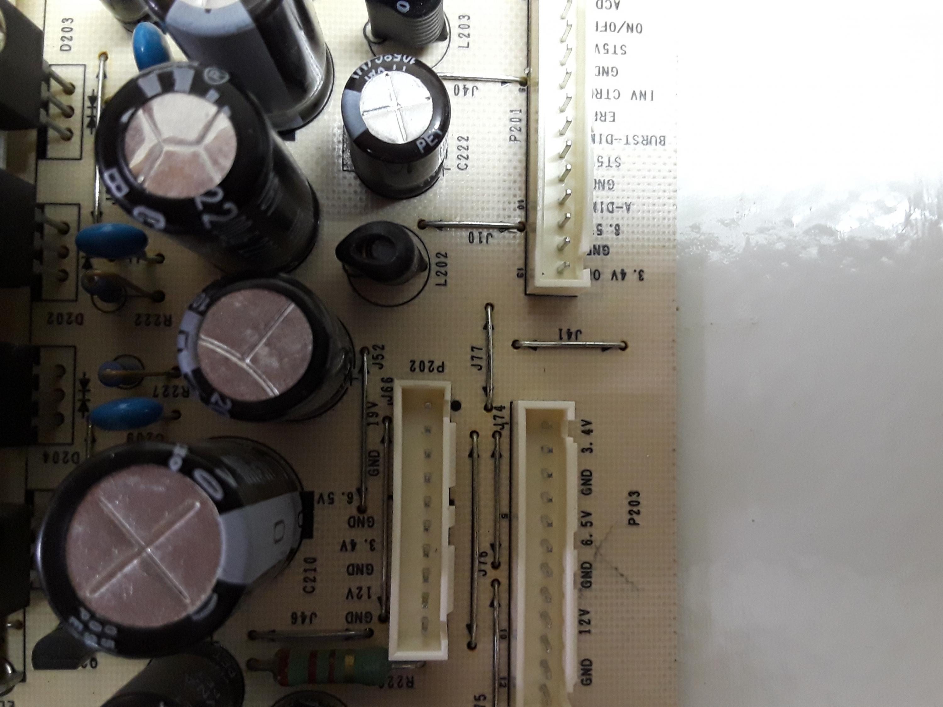

                      The picture of the back of the board shows a small IC labeled U301. That is the one that I think is the PFC IC.
                      Also picture of the cable voltages on the front of the board. Two pictures to make sure I got all three connectors where you could read them.

                        #31

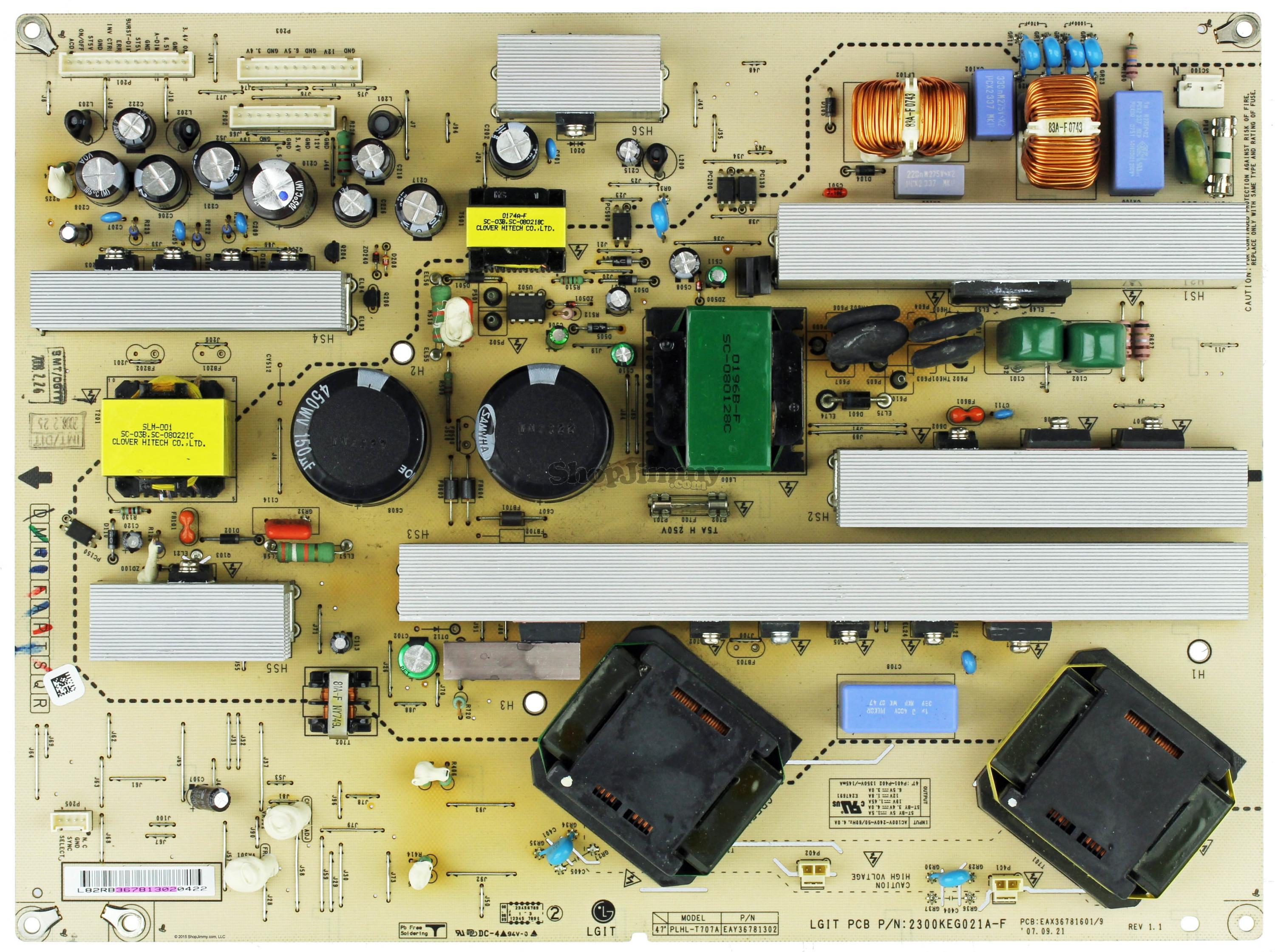

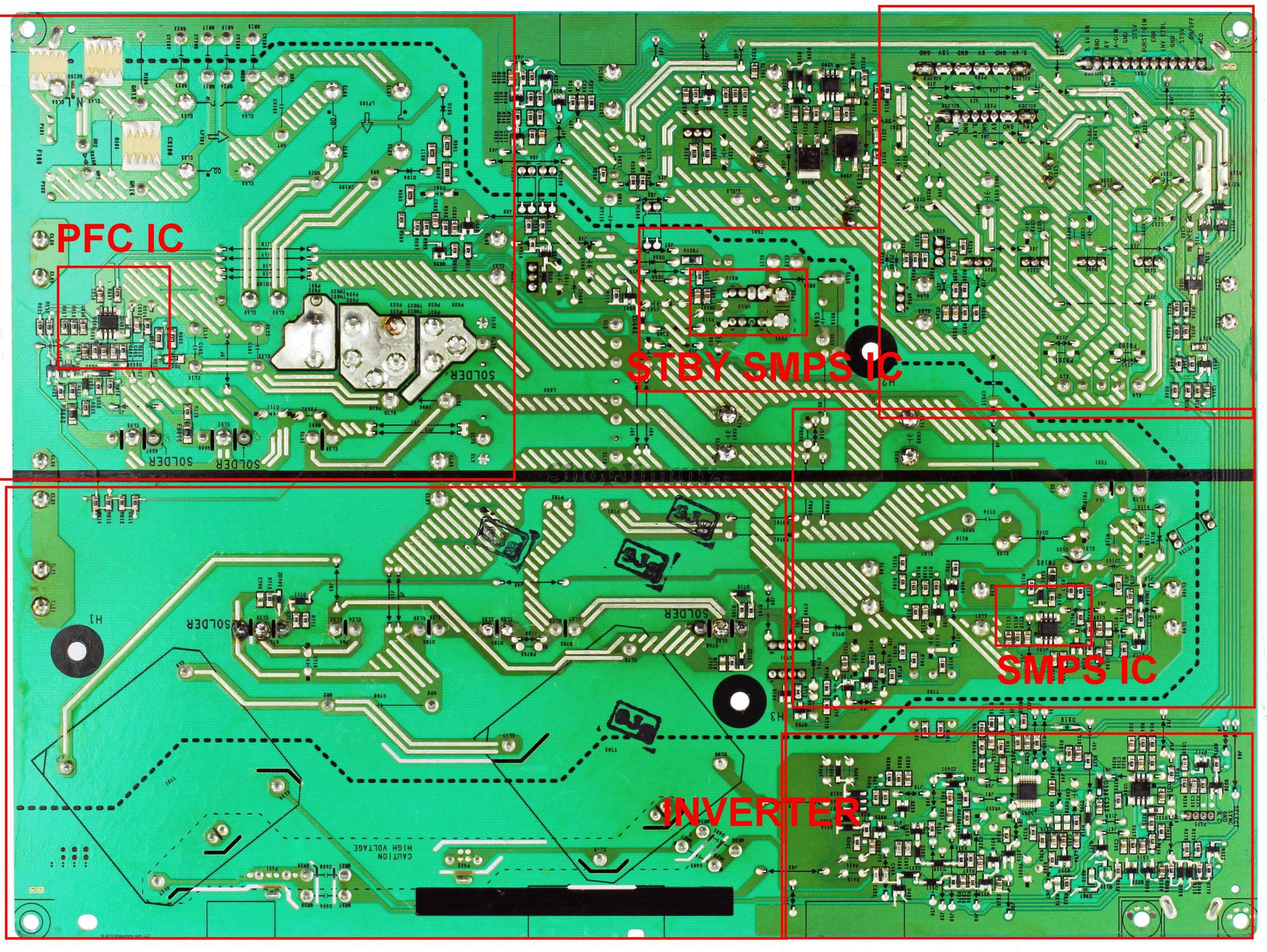

                        Circuit function blocks.
                        Pictures provided by shopjimmy.
                        LG EAY36781302 Power Supply / Backlight Inverter
                        http://www.shopjimmy.com/lg-eay36781...pply-unit.htm#
                        The SMPS IC that drives the shorted out MOSFET needs to be replaced.
                        You also need to to test ALL the component that are connected between the GATE of the MOSFET and the output drive pin of the SMPS IC.
                        The very low (<1 Ohm) OHMs resistor that is connected between Source and GND also needs to be checked including the Zener diode that is connected in parallel with the that very low Ohm resistor.
