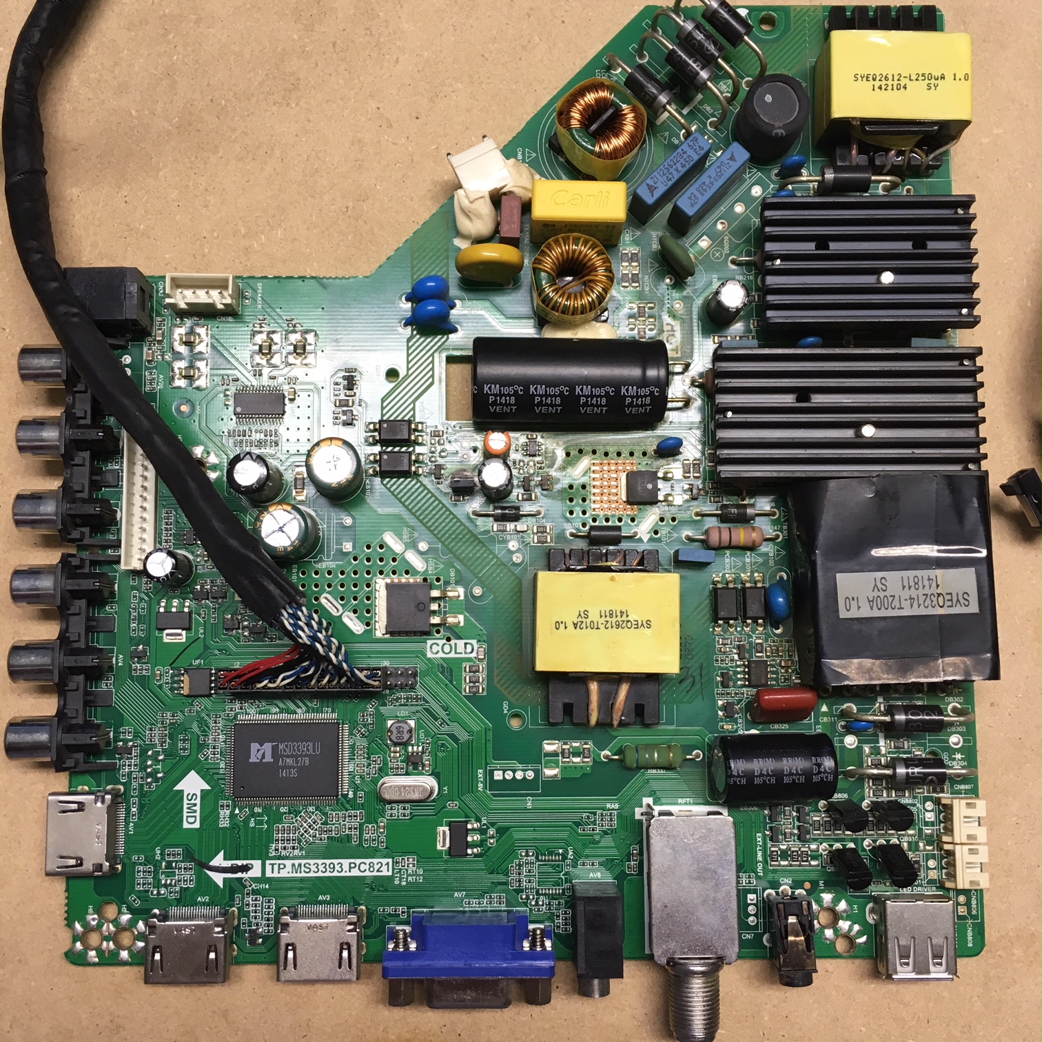

    Main board: TP.MS3393.PC821

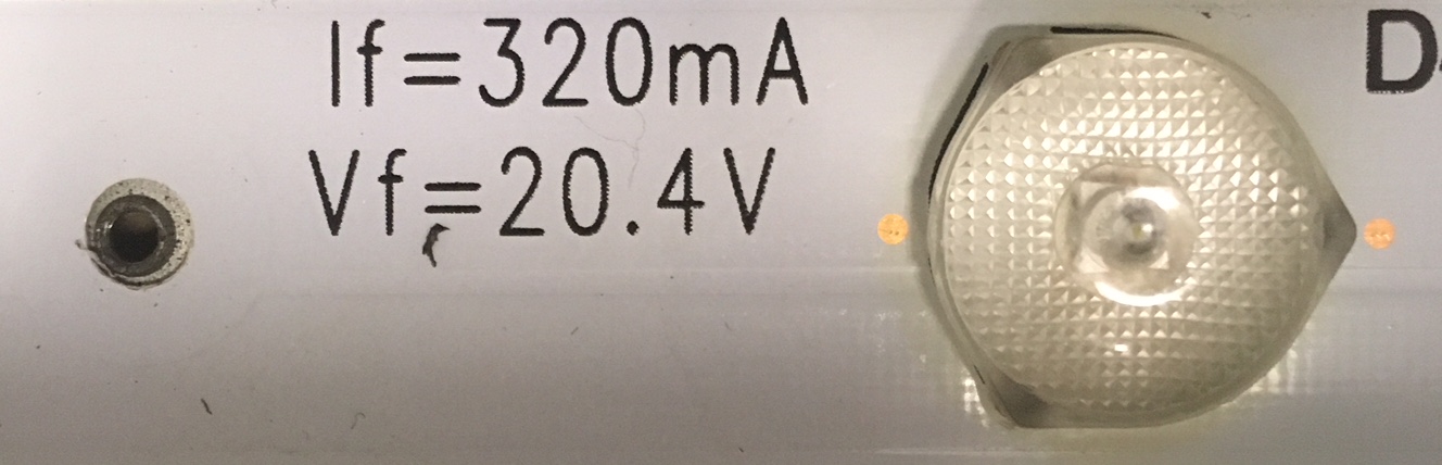

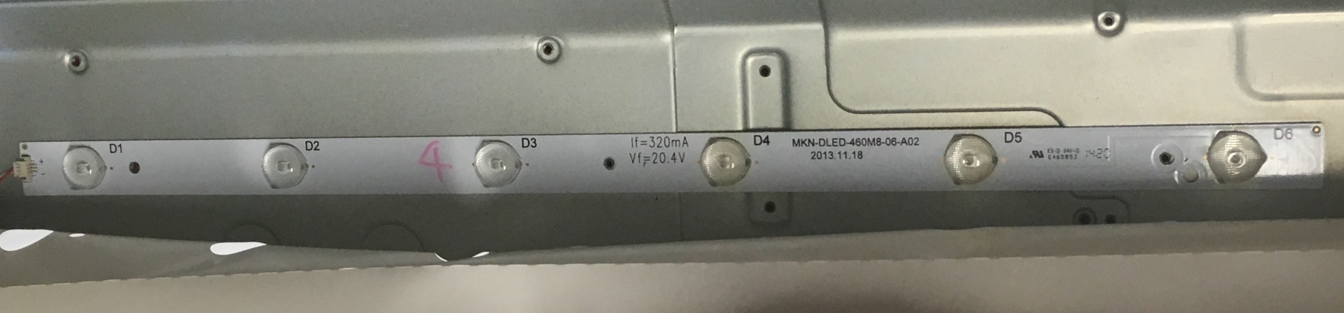

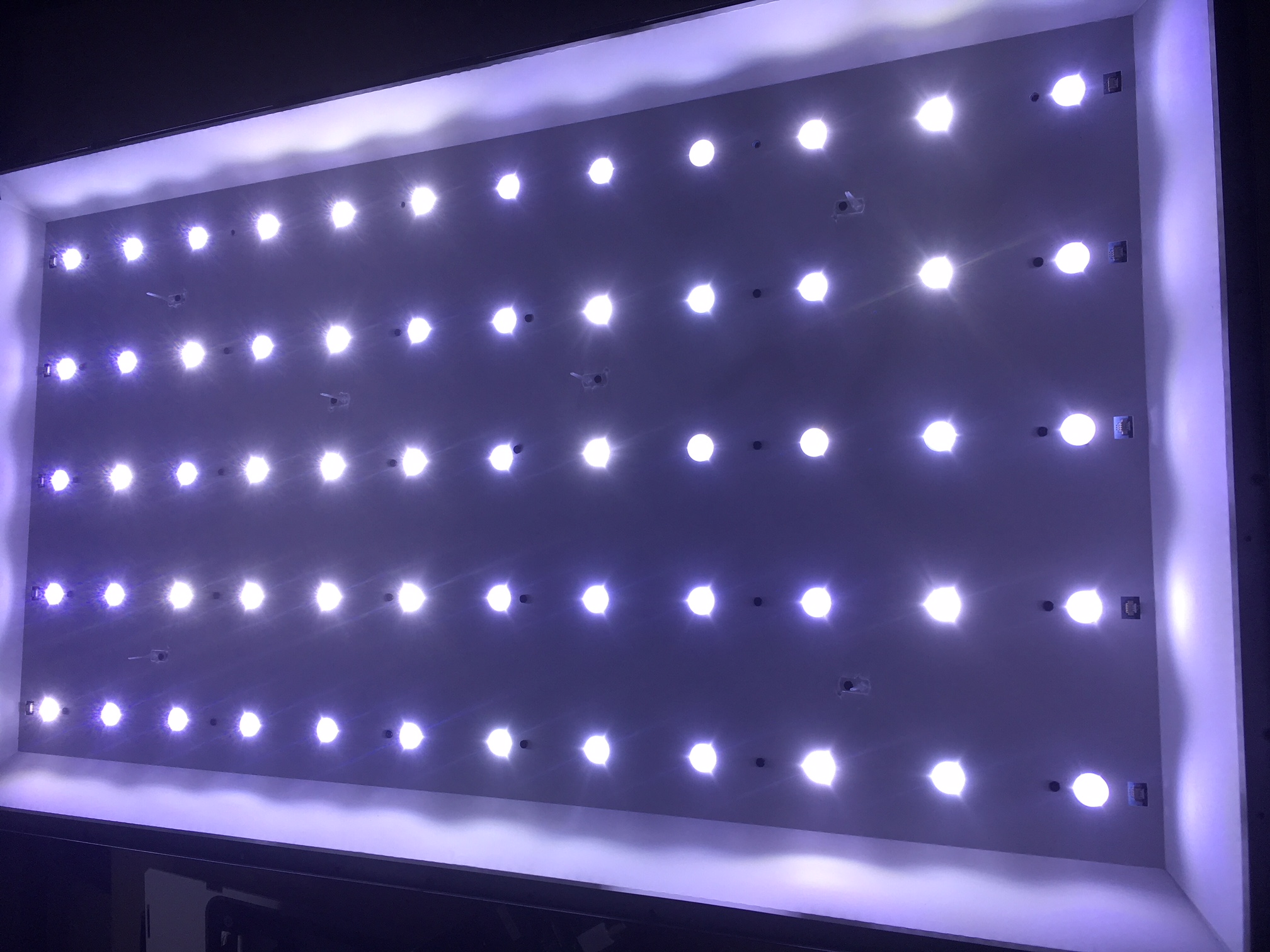

    There is 10 led light strips with 6 led on each divided between two connectors/lines, so 30 on each connector/line in series, total of 60 led. 21 of these led were open. I changed all open ones. Now I got backlight for about 2 sec. It measures about 145V on two white connectors for led lines for a second without load and climbs up to 75V and slowly drops with them connected when they all briefly come on. I tried checking all strips separately with a power supply applying 20.4V to each and each read about 200mA on my ammeter.
    Any suggestions on what the next step could be would be greatly appreciated.

    Not sure, but on your last picture is seems to me that some 20 or so LEDs are brighter than the others? The LED backlights are driven in current mode. So if the LED controller sees a mismatch in current on what the LEDs should draw and what they actually do draw, the LED controller senses that there is an error in the circuit or with the LEDs and it will shut itself down. Above that red cap CB325 is a little IC. What is the number on it? Should have something similar like OB3350CP. Pull up the spec sheet and see what happens around the pins. These have OVP, OCP, UVLO etc.
    Something else you could try is to turn the backlights waaaay down to next to nothin and see if they stay on. The problem is that there still could be a bad LED hiding, that works for seconds and measures good, but once it gets hot it fails. That's why when that many LED's (like 20 of them) fail, replace them all...

      On some of the strips I replaced just one of them and on some as many as four but testing them individually they all lid up evenly and draw same current. That little IC is AS358M.
      "Something else you could try is to turn the backlights waaaay down to next to nothin and see if they stay on." - maybe not exactly smart question but how do I do this?
      Thank you CapLeaker for you help

        Well... that's the wrong IC... that would be a dual op amp. I am looking for the backlight PWM.

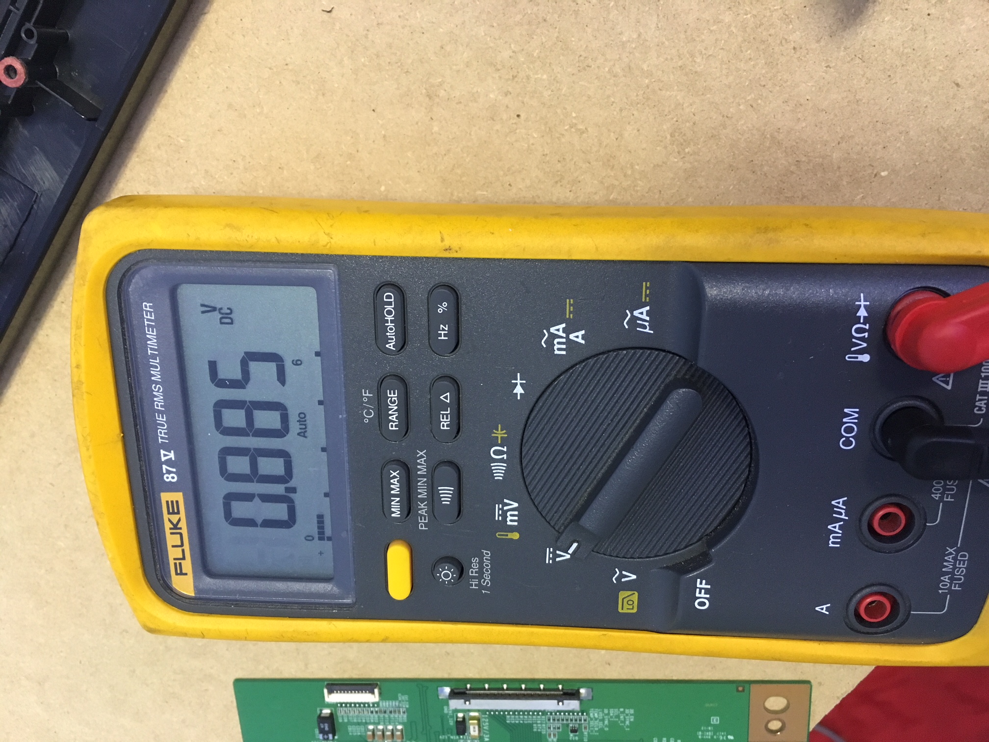

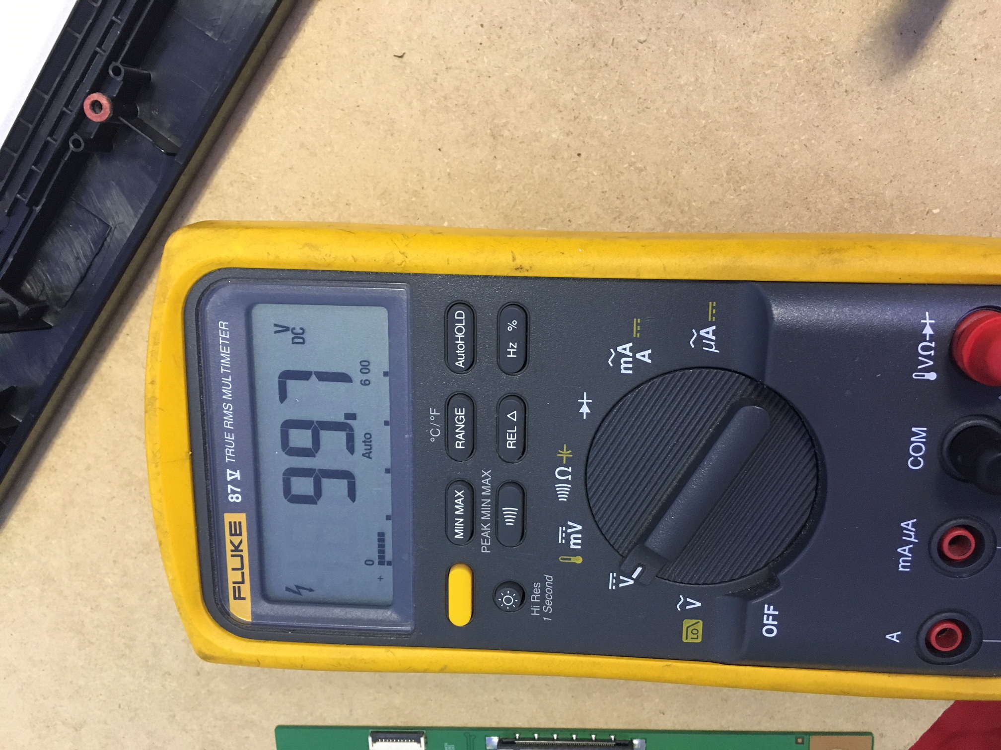

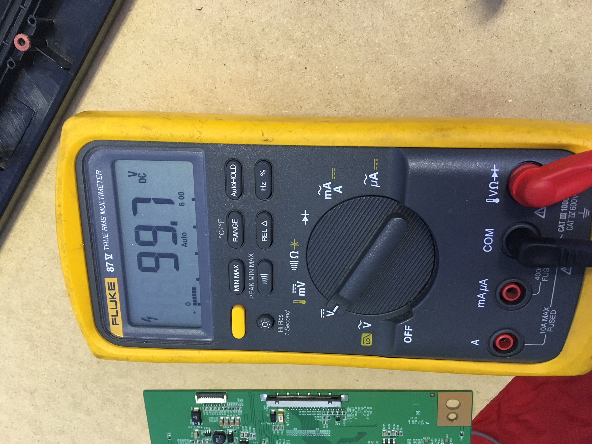

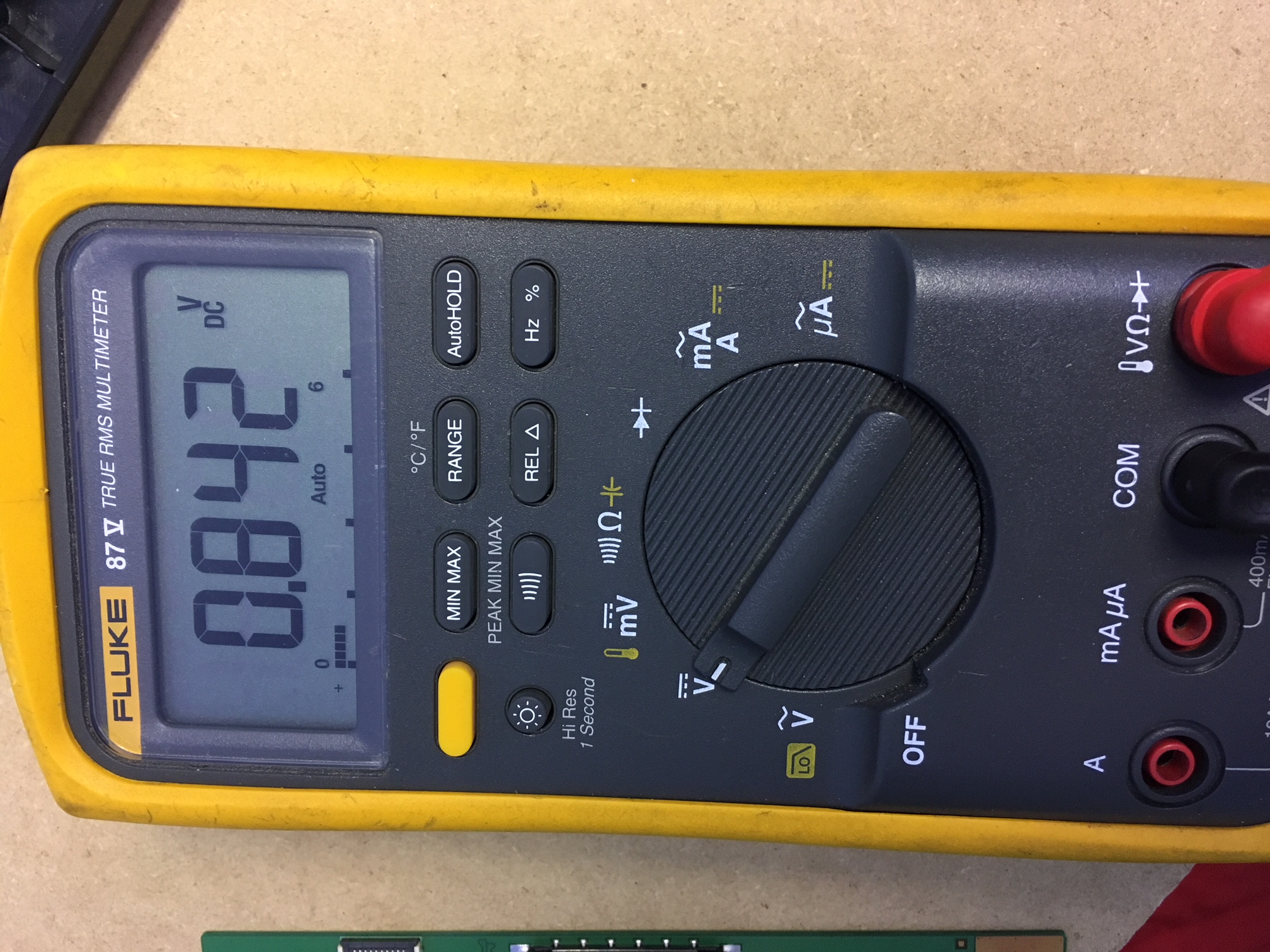

            So I went to check voltages on LED- (cathode) against chassis. I don't believe in magic but it does work now. Here are voltage readings after TV powers on:
            Connector 1: LED- 0.842Vdc; LED+ 99.7Vdc
            Connector 2: LED- 0.885Vdc; LED+ 99.7Vdc
            So the question is what did happen that it works now after a day of rest?
