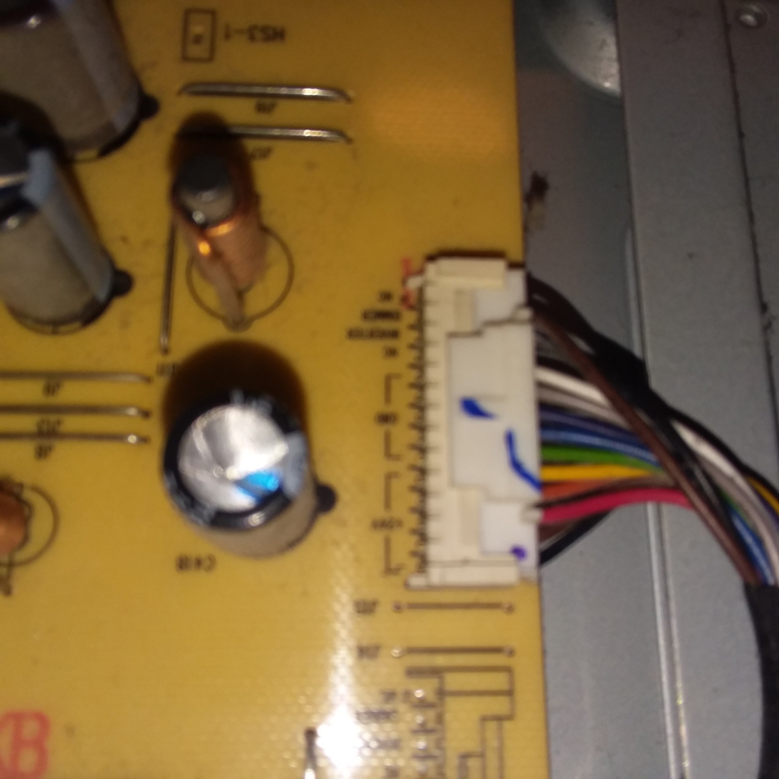

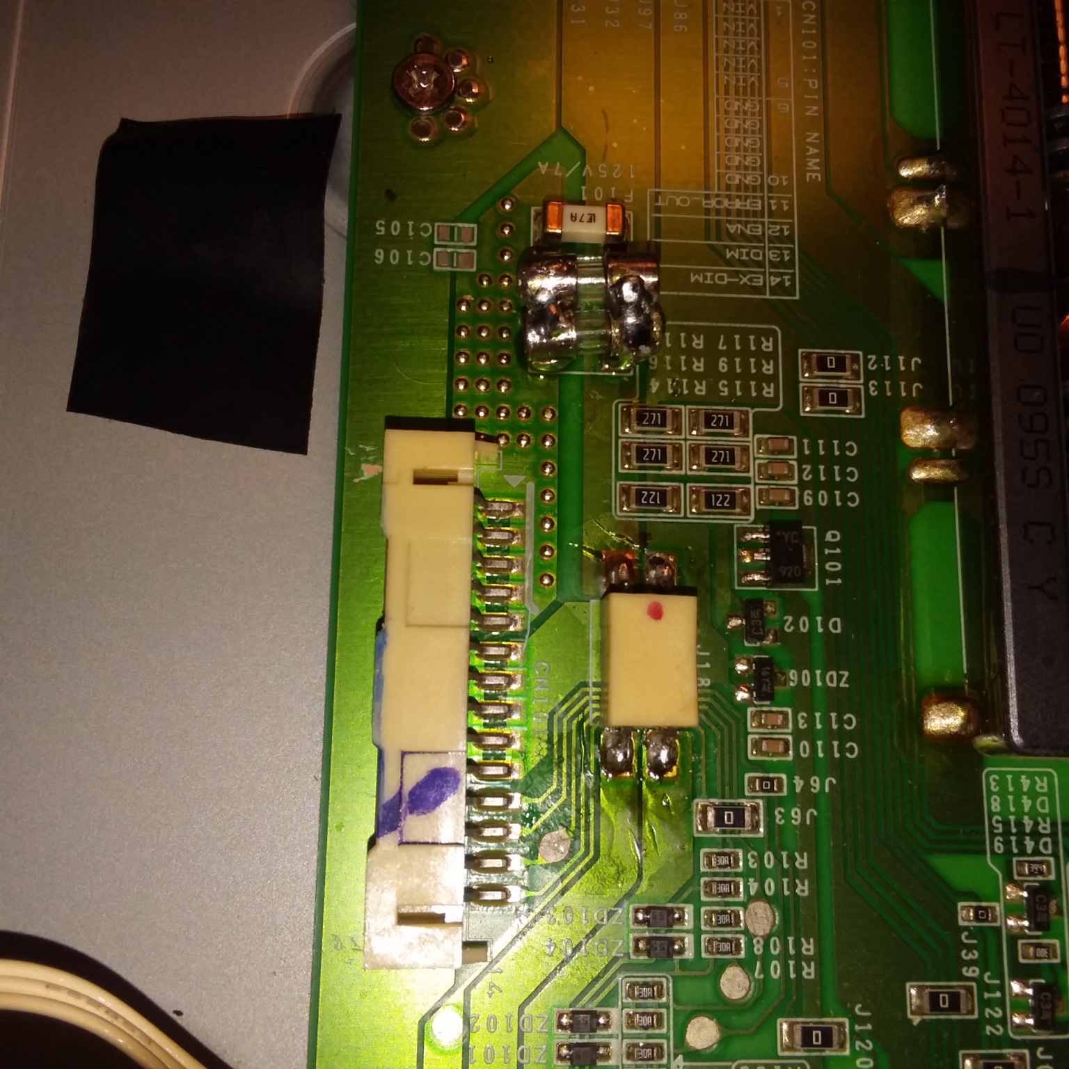

    Im working on a toshiba(samsung) board.
    I think a cap is shorted to ground.
    But the "inverter" wire has 3 volts coming out of it. I assume this is just the on signal. Since it is just one wire. while the 24v/ground have 4-5 wires in common(connected to each other on the inverter board.
    I'm going to upload some photos.

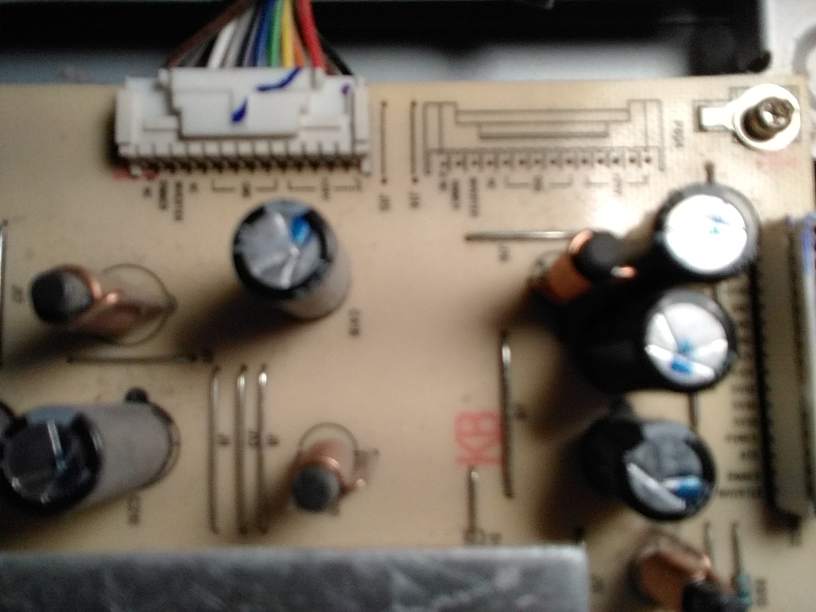

      Re: Short to ground, or low inverter voltage?
      The important one is blurry, this should be clearer.

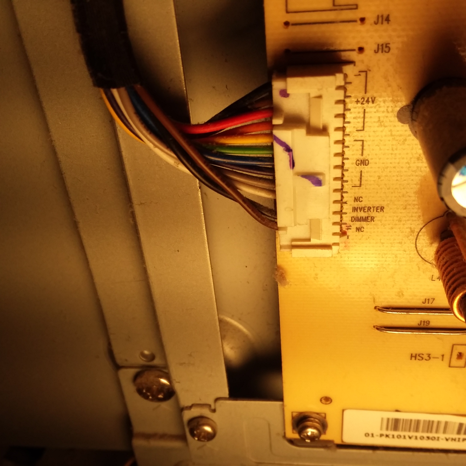

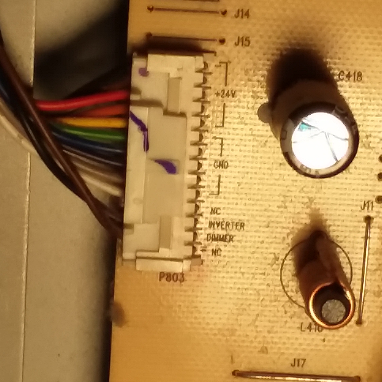

        Oh well, its clear enough to see the wire that I am talking about. the longest name printed on there says inverter.
        Am I supposed to only get 3 volts?
        This is on a LCD with CCL/CFL(?)

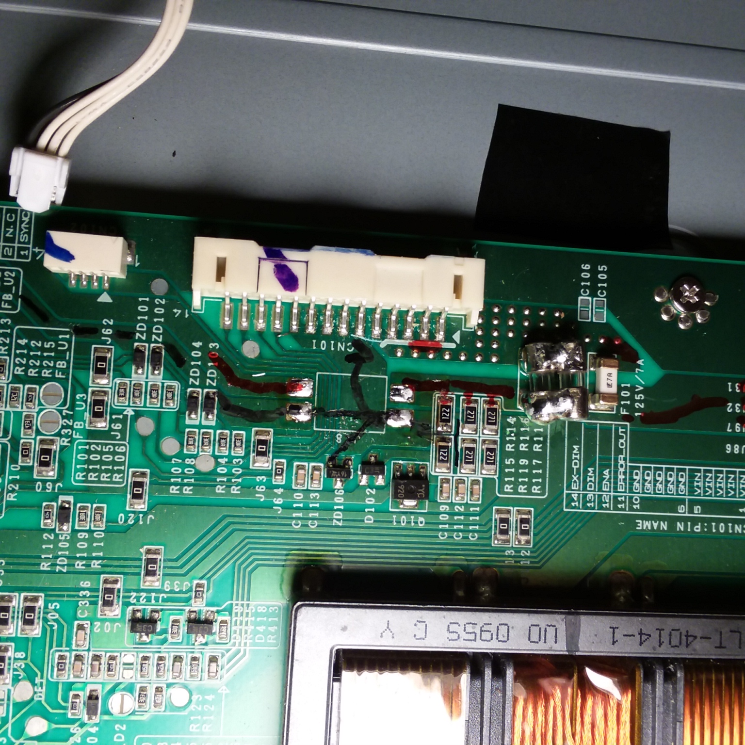

                After replacing the blown fuse I have 0 volts!
                If I unplug that wire I have 24 volts...
                Perhaps I should run 24 volts through it and see what smokes
                Oh and the connector flips upside down on the receiving end-inverter board.
                  Originally posted by NeedsMoreFlux
                  Ka-CHOW!
                  https://www.badcaps.net/forum/attach...3&d=1510870051
                  Inverter pin = BL-ON command from the main board
                  3V = Backlights ON, <1V = Backlights OFF
                    Which blown fuse? On the power supply board? On the Inverter board?
                    • NeedsMoreFlux
                      • Oct 2017
                      • 121
                      • California
                      this is the fuse, I had 2x3amp fuses.
                      This is on the inverter board.
                      Disclaimer: Don't trust a thing I say-I am frequently wrong!!!
                      I have tons of spare parts, some used, some N.O.S. ham transistors and caps. Message me if you need any parts.
                      Some of the things I've fixed:
                      60" Vizio-bad LED's. iBook G4: Resoldered VCC Plug. Geo Tracker ECU: Swollen / Leaking capacitors. Windows Laptop: Soldered broken LVDS wires. Dryer: Burned contact on temp switch. Oven in R.V.: Bad contacts in relays-Exploded by the looks of them! Samsung Oven: Burned contacts on Relays. MSI Motherboard: BSOD-Swollen capacitors, bad graphics card, Moved SATA Input from SATA 1 to SATA 2 plug
                        You need to check all the power MOSFET's that drive the primary side of the Inverter transformer to see if any one of them has very low resistance between the S and D pins of the MOSFET's.
                        Also look real close at those Inverter transformers to see if any one of them has sign of over heating or not, look at both dies of the board to see if there are any brown spots where the transformers are.

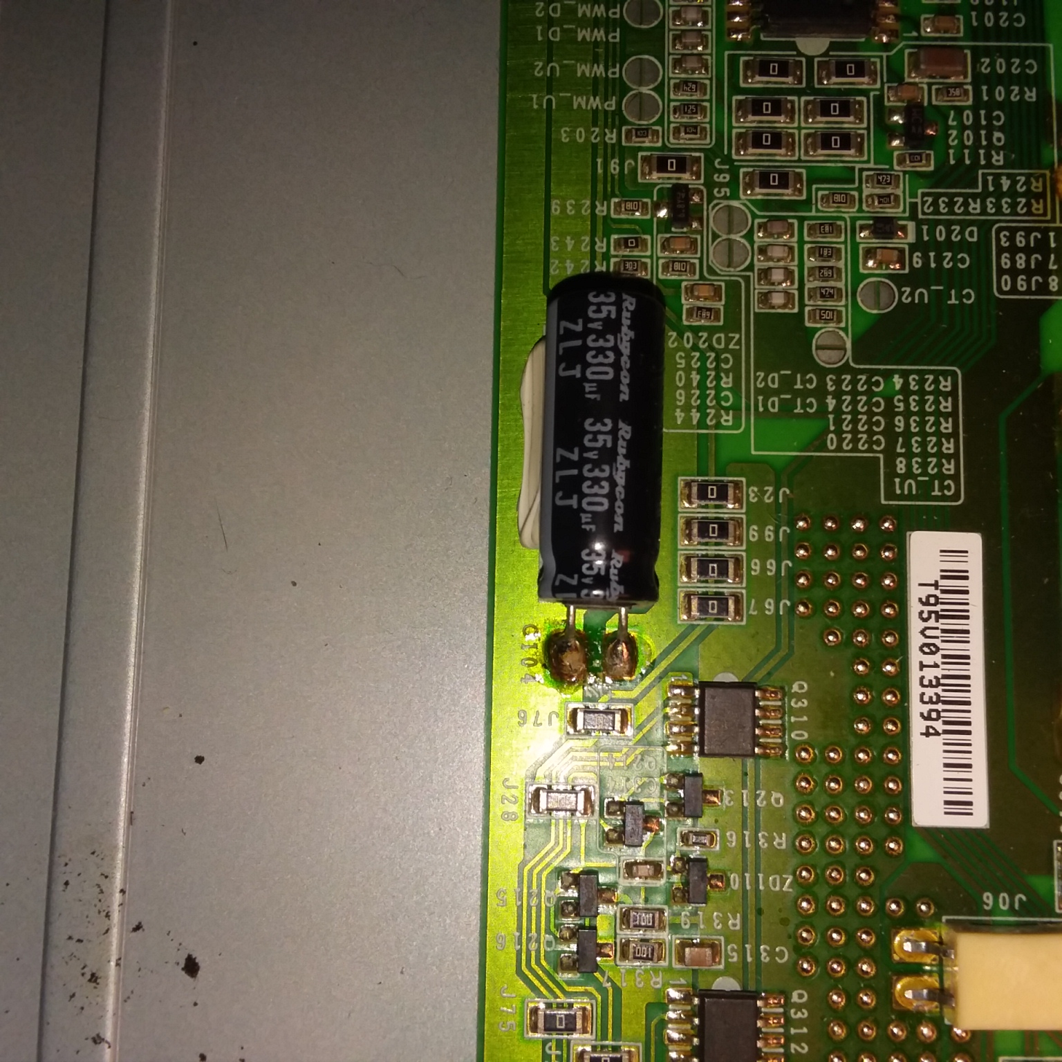

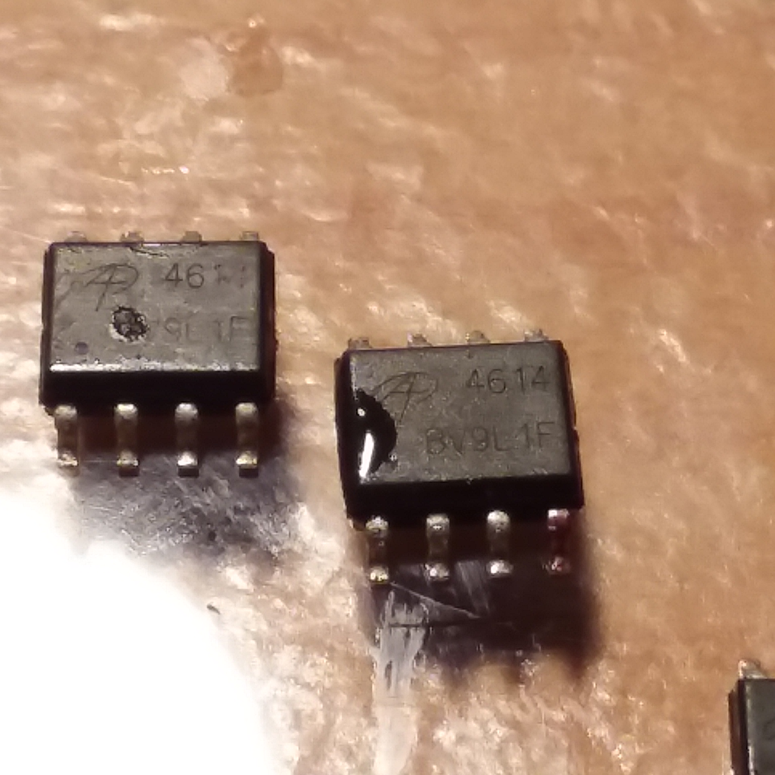

                          I think I found the short!!!!!
                          A 6 legged smd mosfet(?)
                          I will take pictures and when I finish testing I will post the results!
                          I need to buy a q600 microscope so I can get better pictures!
                          • NeedsMoreFlux
                            • Oct 2017
                            • 121
                            • California

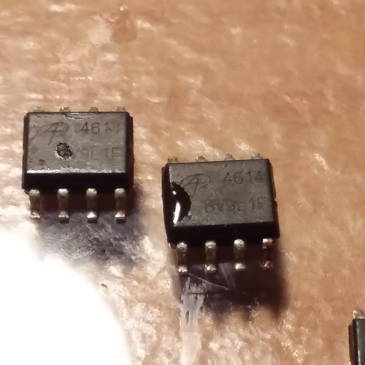

                            I gotta find some of these 6 legged ICs. I've been looking and haven't found any yet.
                            4614 BV9L1F
                            I'll try to get some good pictures.

                              And if anyone can identify that brand my thanks go out to you!
                              looks like it's "AO" brand(?)
                              But I'm not finding anything with the same second number.
                              Perhaps the second number is just the manufacturing date(?).
                              • vinceroger69
                                • Mar 2012
                                • 6714
                                • uk

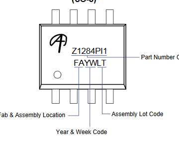

                                maybe this
                                I think the numbers on the second line is a date code etc
                                • diif
                                  • Feb 2014
                                  • 6978
                                  • England
                                  Alpha and Omega Semiconductors.
                                  AO4614 is not hard to find.
                                  • NeedsMoreFlux
                                    • Oct 2017
                                    • 121
                                    • California
                                    Agreed, diif. But what about the second number? Is it just a manufacturers date code?
